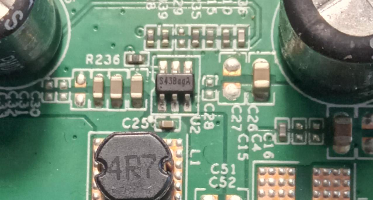

    Does anyone know what these two components are?
    First one is SOT23 marked LPS 6CB
    The other one is SOT23-6 marked S43BbbA

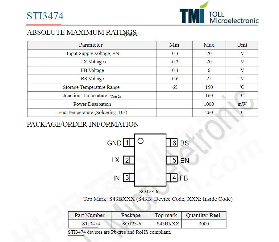

        sot23-6 = TOLL Microelectronic STI3474

            STI3474 No datasheet but this might help https://antenna-dvb-t2.ru/show_dcdc.php?id=430

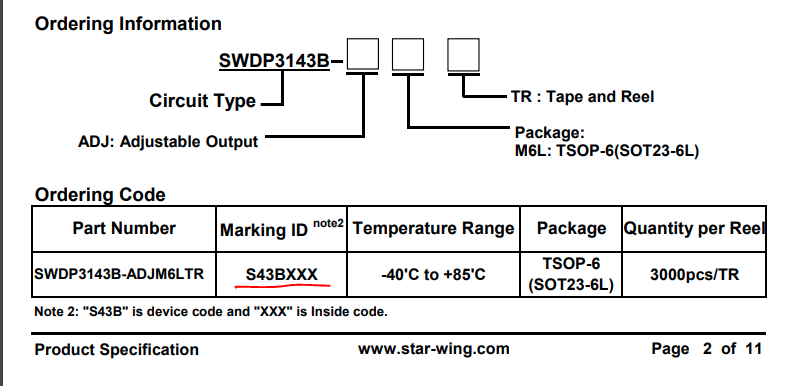

              "S43B" is device code - SWDP3143B
                SWDP3143B has the same pinout,but 20V maximum voltage. There are no pictures of the SWDP3143B so can`t check how they write the xxx code ,the STI3474 has upper case and lower case letters for the xxx code
                  Re: Trying to identify two SOT23 SMD codes, devices from mining PSU
                  So everything is in the datasheet.
                  S43 - STI3474
                  S43B - SWDP3143B
                  But we can say that they are interchangeable.
                    Yes, and here is the marking on the STI3474, the same as that of the SWDP3143B.
