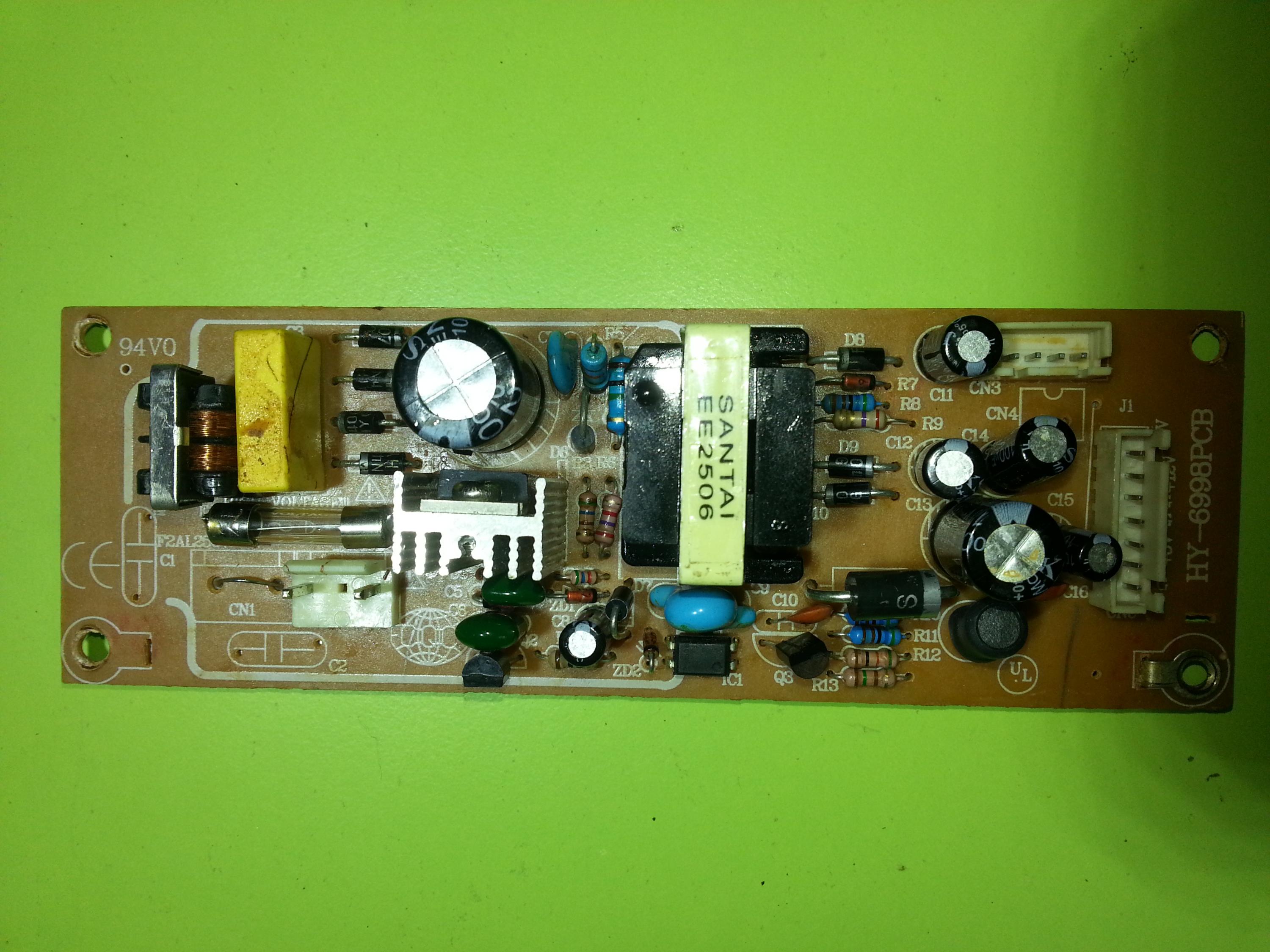

    Good day folks. I'd like some advice on this little PSU I'm working on: it's out of a DVD player and I managed to only partly fix it.
    When I got it, the transistor was shorted and the fuse was blown. Simple job, I though, I'll just replace the transistor and I'll be back in business. Now because I don't have new replacement parts readily available at this "professional" shop of mine, I dug through some ATX supplies and found one which used STP13007 as the main transistors. I removed one and installed it. The PSU works, but the regulation is rather poor: when unloaded it overshoots, so instead of 12v I get around 14-15. When loaded, the -12v bus drops to around -10v, while the 12v bus goes to a more normal 11v. Same goes for 5v. DVD still didn't power on though: initially, the blue backlight for the display came on but nothing else. Suddenly, as I was measuring the output connector, the PSU started making a faint whistling sound, so I unplugged it immediately. When I plugged it back in, funnily enough the display was showing nonsense on it: dashes and numbers and stuff....true, this could very well be a logic issue and not a PSU issue, however the reason I'm pushing on is because this is a very small and nasty device, yet my STP13007 got rather hot during the short time it was plugged in...
    Point is: in the past, I successfully replaced the MJE13005 with MJE13007 or even 13009 and it worked. Could it be an issue here though ? Caps checked fine with my capacitance meter...should I bother to replace the transistor with a 13005 ? That would involve extra digging in the junk box...cheers and thanks.
    Wattevah...

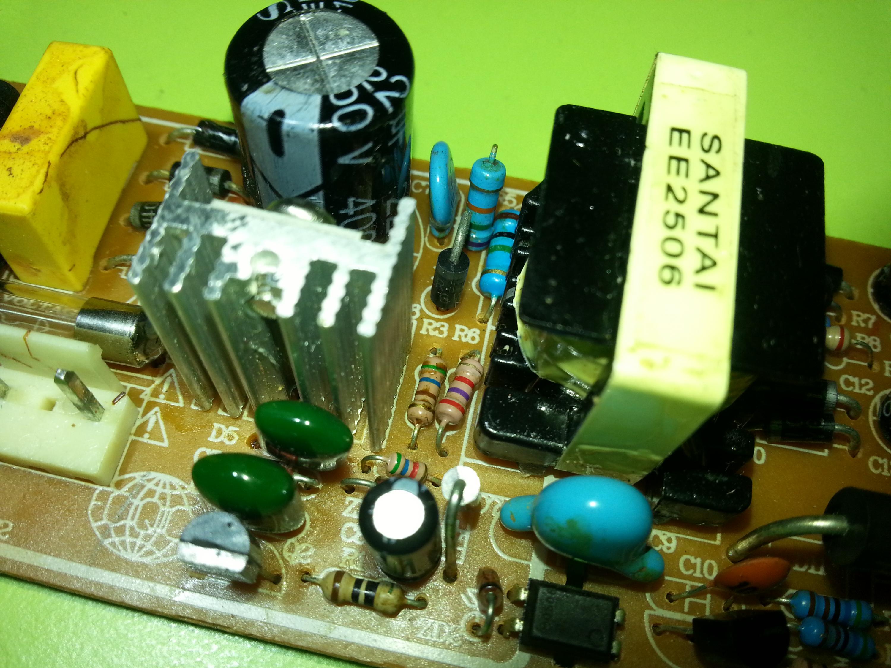

    well i doubt nothing else was damaged,
    and you may want to consider what killed it the first time.
    start with the feedback - suspect the tl431, the opto and the small electrolytic that dampens it.
    and check the snubber diode on the primary side - it looks cracked in the foto

      Probably a bad logic board: I managed to get it more stable by changing some of the caps, including the one on the primary, so the TL431 is fine. Still, the -12v rail overshoots dramatically when unloaded - close to 20v ! The regulation is done by the 5v output, given that the 12v output is just a diode with a capacitor straight to the output connector, nothing between. Only the large connector is used - the other one isn't, it's for a different model presumably. No on/off command on this PSU, so it's a simple thing to troubleshoot.
      Now it just went back to showing a blank display, so that instance where it displayed something was just a one-off or it was already on its way out. The overshoot could've killed it, for instance when it lost its regulation...just a hunch...either way that thing isn't worth more than 20 bucks on any auction site, so I don't think it's worth digging into the logic board to find out what is or is not working. It's like the thing is on all the time, just not doing anything.

        MJE13005, MJE13007, and MJE13009 were part of Motorola's "Switchmode" series transistors, designed for use in switching power supplies. These three parts have the same voltage rating, but different current ratings (as listed above, lowest to highest). So the substitution you made should be safe, possibly improving the heat dissipation slightly (larger die, lower thermal resistance from junction to case).
        That power supply looks like a self-oscillating flyback design. Probably the 5V output is regulated, and the +/-12V outputs are determined by the turns ratios and loading. Leaving one of the 12V outputs unloaded lets it peak-charge to whatever voltage spikes there are on that output.

          At least replace the output caps, preferably the bias and main filter cap on the line side also.
          At least pull them and check for electrolyte leakage or corroded-off leads.

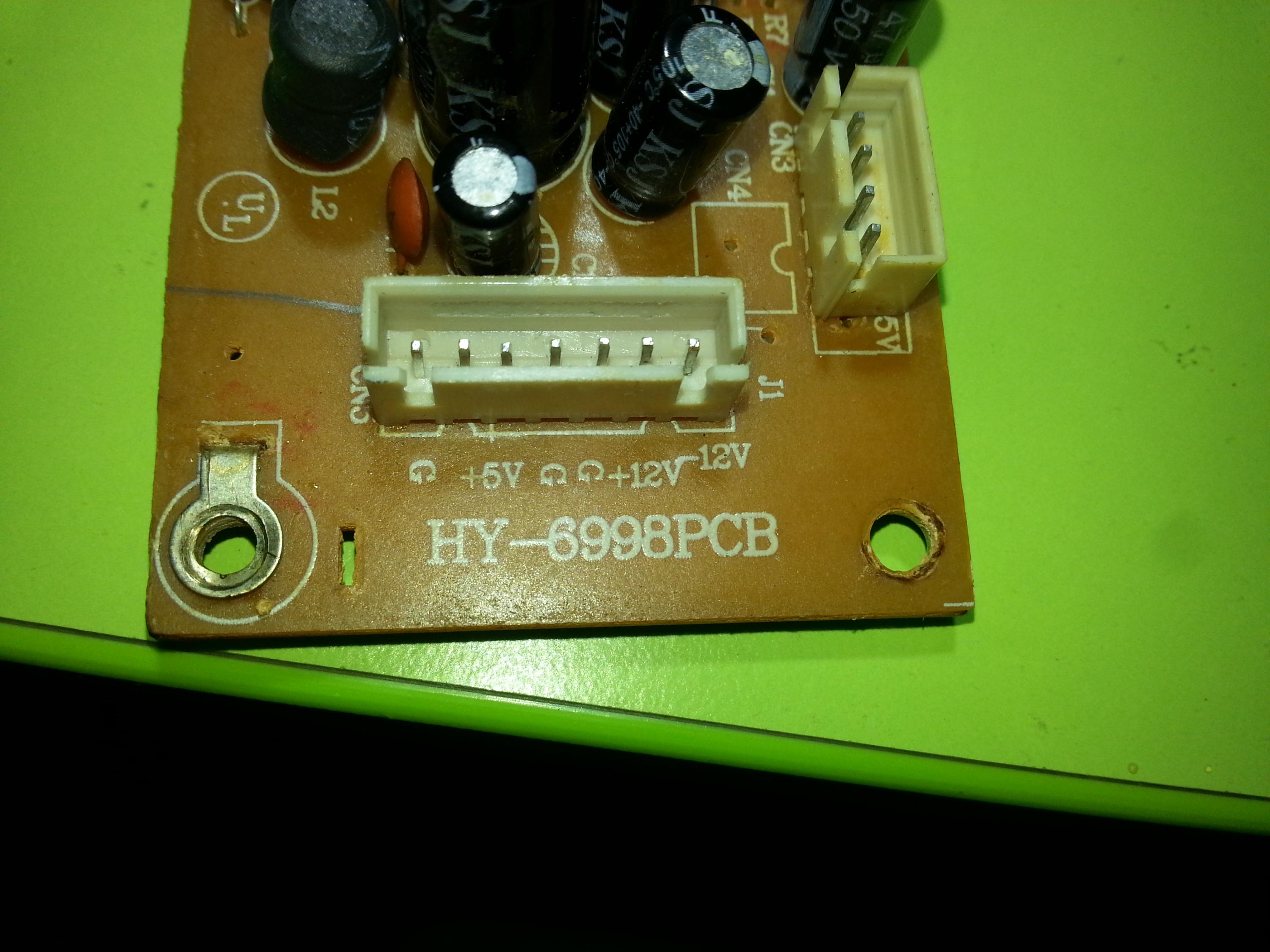

          The first cap on +5 is either open or greatly decreased in value, causing low average voltage; duty cycle goes up to "compensate."
          You see this as -12 running away.
          Having recapped several of those "square" DVD players, I can tell you the caps were always trash.
          This can sometimes damage components in the player.
          Test it with a PC PSU before dealing with the units SMPS.
          The snubber resistor won't get too warm if the caps are good.

            I replaced just about every cap, except the main one and another small one on the output on the other -12v line, since there's two of them and that one is not connected....true, these "replacement" ones were not new, since this wonderful shop of mine doesn't keep a stock of basic parts - you have to pull them off donor boards which means they're going to have service hours behind them. This is the no.1 thing I hate about this place: recovering parts that should always be new...imagine paying like 100$ for a repair and discovering the parts aren't new...someone should really call consumer protection on these fellas, maybe then they'll get their sh!t together so I won't have to bring my own parts from home to fix stuff FOR the shop...:|
            This introduces even more variables and frustrations, because you're not sure if the part you've replaced is good or not. True, the caps I put in were checked with my capacitance meter and they weren't out of whack, but still, not ideal.

                              The 13007 in place of the 13005 isn't the issue.
                              As PeteS and kaboom mentioned, this is flyback design likely with regulation only on the 5V rail. So it's normal for the other rails to go a bit "wild" if they are not part of the flyback. Last month for example, I war recapping an LCD monitor PSU and thought I could get away with using 16V caps on the monitor's "13V" rail. The monitor originally had 25V caps. Well, I'm glad I decided to check the voltage on the caps before doing a recap with my 16V caps - it was close to 20-21V when fully unloaded.
                              That said, bad caps on the output and any "start-up" caps on the primary could cause the voltage on the unregulated rails to drift even further (higher), especially if the PSU is a 2-transistor design - which yours appears to be, at a quick glance.

                                Re: MJE13005 vs STP13007 in SMPS
                                IS it a 2 transistor setup ? That is only if you count the small one in the TO-92 package which I believe drives the bigger one. Other than that, there's only one transistor there really.
                                    Well, you're right to wonder.
                                    Technically, there really is only *one* main switching transistor (that drives the transformer). And that smaller TO-92 transistors simply drives the big transistor Off when needed. Nevertheless, with *flyback* (discontinuous) designs, this is known as a 2-transistor setup.
                                    This is different from the 2-transistor forward topology you see for the main PS inside PSUs, where both transistors are involved in the switching of currents to the transformer.
                                    And half-bridge also uses 2-transistors... but half-bridge is half-bridge.
                                    Did I manage to confuse you now?
