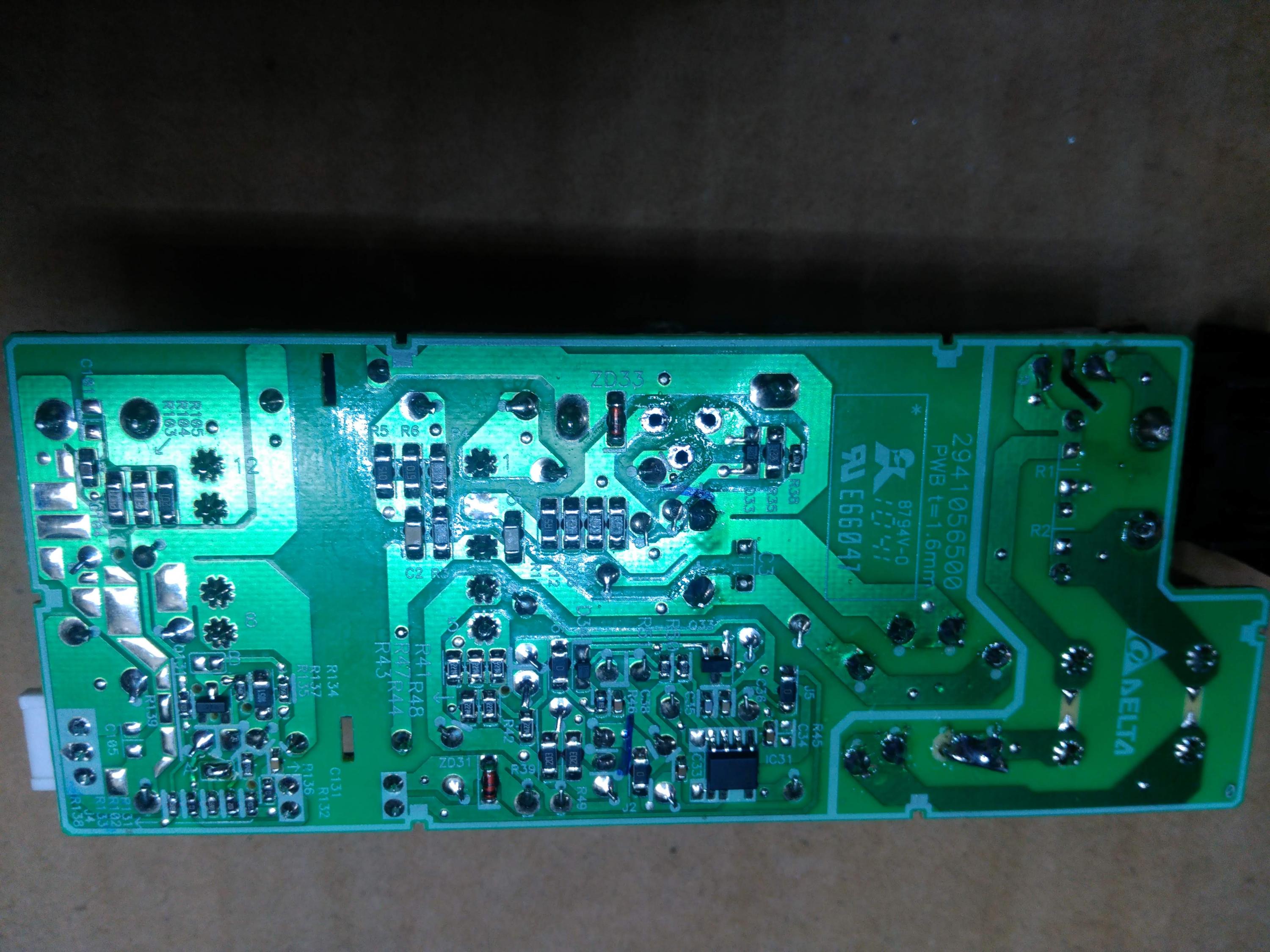

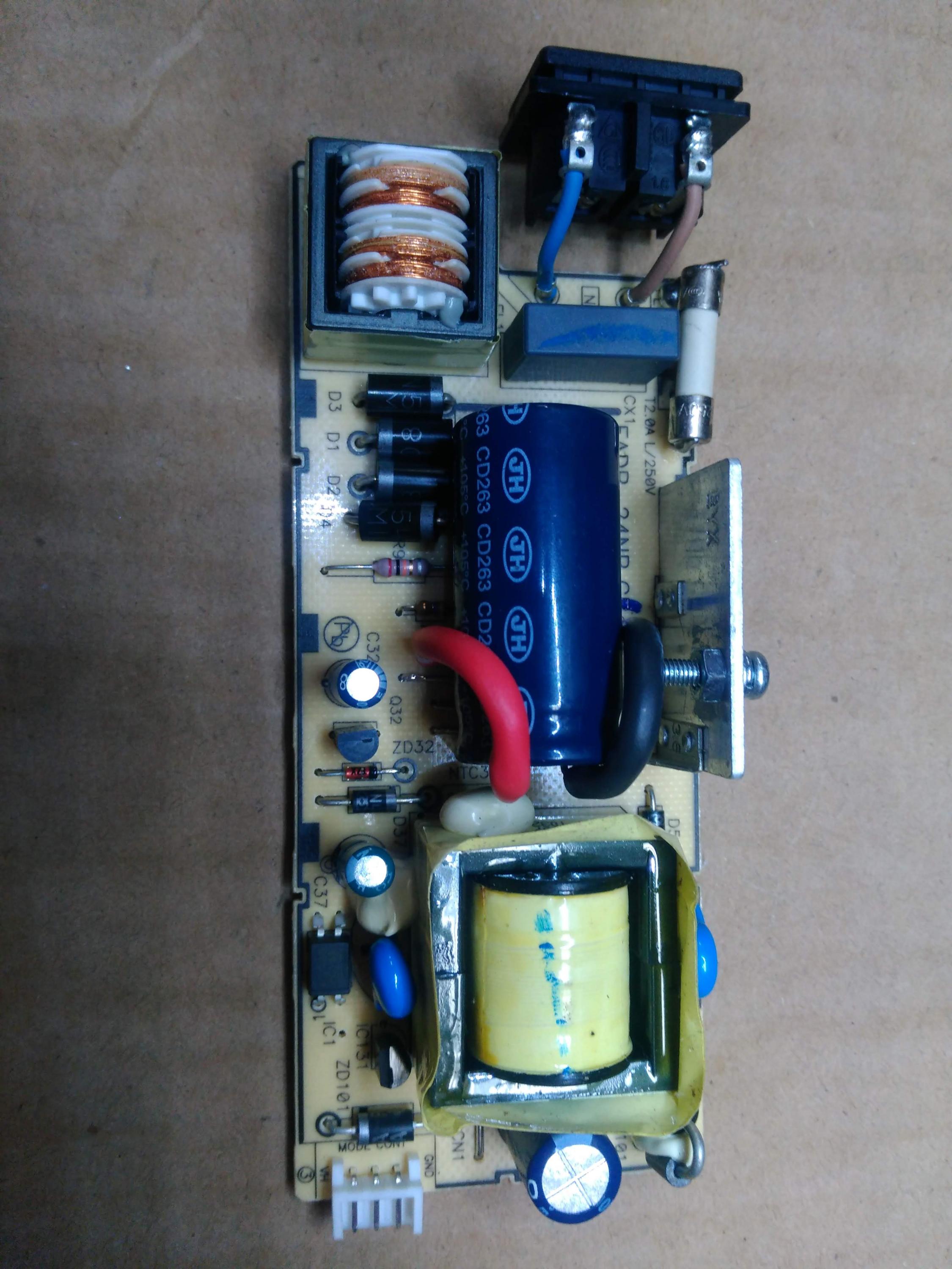

    Used in a Canon printer to provide 24V supply.
    Printer was dead and I could measure no voltage out of PS so I opened it up. Was presented with a main electrolytic which had electrolyte crystals coming from its base (and a leg which subsequently fell off), a blown 2A fuse, 2 power diodes short and the main switching FET was short.
    Replaced all components and expected it to work. With no load I get ~8VDC which I assume to be correct for standby mode. However, plug in the printer and the main FET blows short circuit and takes out diodes and fuse. (I've since put an incandescent lamp in series with the input supply to limit short circuit current and replaced all components and repeated. Again it took out the main FET again once connected to the printer.)
    I'm substituting the FET with a 13NM60N, which by my reading of the specs, should be a suitable substitute for the 2SK3567 used in the original circuit.
    The schematic I've posted is not exactly the same as my circuit but close enough to understand how the circuit works.
    Any suggestions much appreciated.

          The schematic I've posted her (for a different Canon power supply) and the actual board I have are actually quite different once I started to analyse the circuit.
          Anyway, there is a zener marked ZD33 on the board. It sits on the source of the FET and appears to be in parallel with the current sensing resistor. Anyway, it is short circuit and looks like it overheated by some discoloration on the board. I can't read its type number no matter what mag lens I use; I think it's been burned to the point of being unrecognisable. Anyone want to guess what value it might be?

            Whats the number on the ic? is it a fa5528 like the schematic? or maybe a DAP8E ? If I had to guess it would be around 5.1 volt zener its there to protect the IS input from voltage spikes.

              The SMT controller chip is marked 1219A6. I've attached the spec sheet for this device.

                Recently i had to fix this PSU with the same syptoms as the OP described, in my case the main cap was leaky, fuse was gone and 3 diodes of the bridgde recifier were damaged (2 shorted and the third open), main mosfet was Drain-Source shorted and ZD33 was shorted too, i've replaced it with a 5.1v zener based on it's markigs, also D5 had failed open, after all these replacements the PSU seems to work just fine so far.
