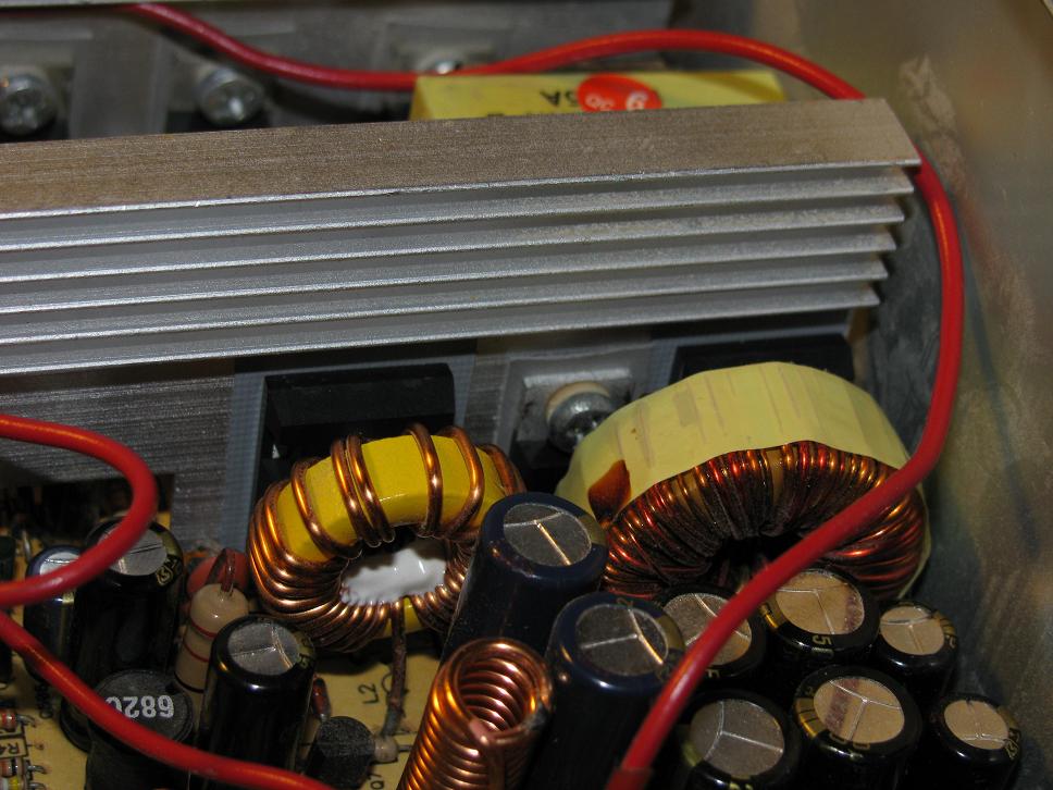

    There is noticeable heat stress discoloration around where the +12v rectifier goes, indicating to me that the original one was under a lot of stress, so I'd rather not use it again unless I have to. Unfortunately, the spot on the PCB for the +12v rectifier will only accommodate a TO-220 package. In that package I have the following options:
    40A/250V (what I put in)
    30A/150V
    60A/45V
    I could look through my stash of used parts for something else though...

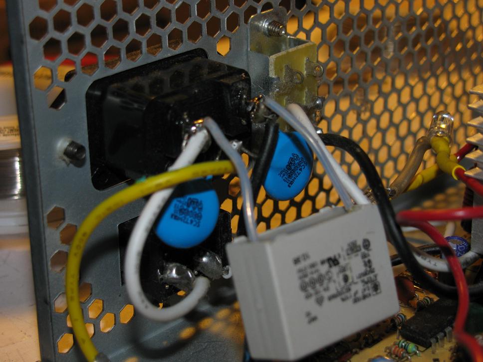

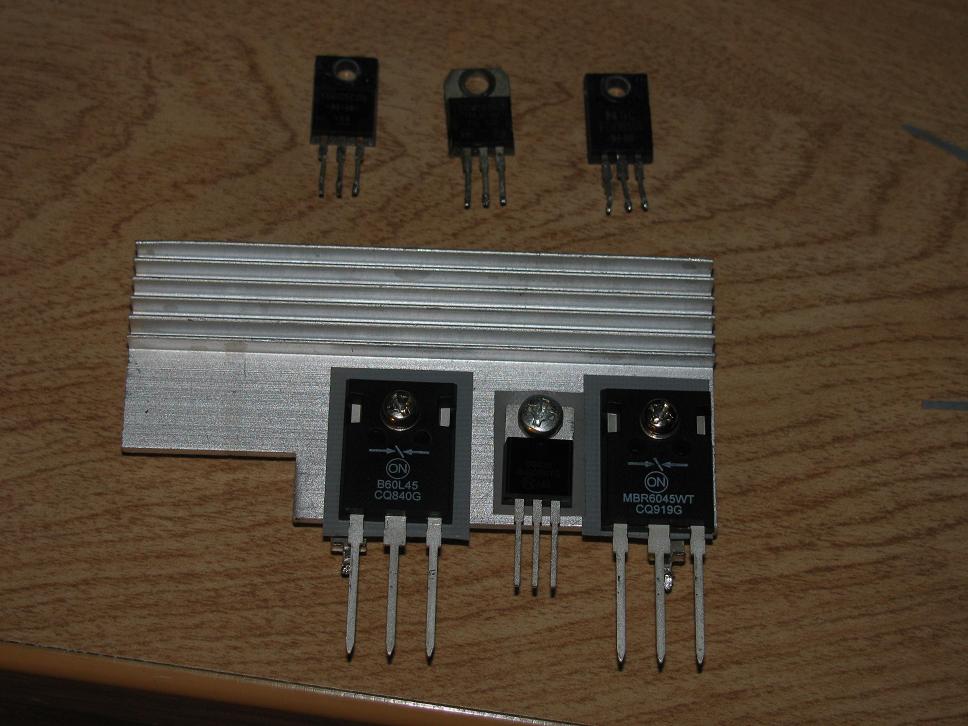

                          Re: Logisys 575W
                          Well I found some pictures I took of it after the first diode replacement - it looks the same now, except the middle rectifier is a B60L45G instead of a B40250TG.
                          But first, here's the new Y caps on the power socket:
                          And here's the secondary heatsink, with the new rectifiers attached, and the old rectifiers above. They are in this order: 3.3v, 12v, 5v
                          And here they are, almost visible reinstalled back into the PSU, along with all my Panasonic caps

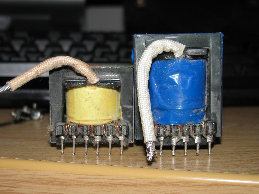

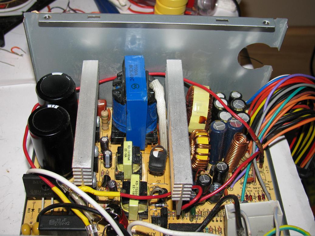

                            #93
                            Re: Logisys 575W
                            Well I took the transformer out of my 500W aspire and put it into my logisys, and my first transformer surgery was a success Here's some pictures:
                            Here's the old transformer (yellow) next to the new one (blue):
                            Here's the logisys without it's main transformer - more heat marks on the 12v line:
                            And here it is with the new transformer. There's about 1mm of clearance between it and the fan case...
                            I think now it might be able to actually put out the 330W it's rated for, and maybe more beyond that.
