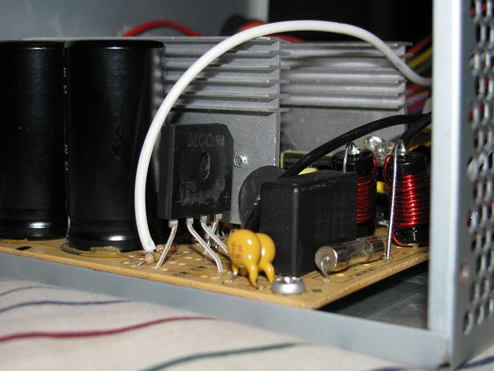

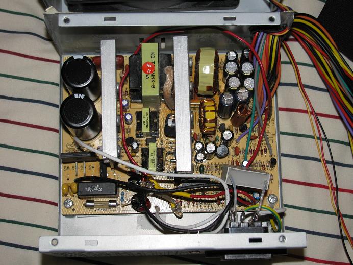

    OK here are the pictures -
    The naked bridge rectifier - with a little of the artic silver i couldn't get off
    And here's an overhead shot of the whole thing, you can see the whole input filter now, including the extra X cap I added to the power cord socket
    So now this one is pretty much done....but I bet I'll have it open again in less than a week....

      Looks professionally done there etnietering, awesome work!
      Looks very dependable for I guess 250W-300W operation, I'd say perfect for computers using Northwood Celeron/Pentium 4 or even lower-end Prescott Pentium 4 processors. Very nice primary input section, and the illusion of a big secondary side due to the large Panasonic caps. A++++++++++++ work
      If Logisys power supplies came directly from the factory looking like that then they would be an excellent value for the price.

        You have done a nice job but I'm sure something is not done in the right way:
        the input coils are usually coupled (common mode or differential mode) for EMI compatibility so I don't think that 2 separated inductors works correctly.
        Moreover the X caps are dimensioned together the input coil and only testing tha PSU with EMC analyzer you can see if the filter works correctly.
        Adding coils and caps without doing the test doesn't mean you have a good PSU respect to the noise/interference it can produce on the power line.
        I think that replacing bad caps or undersized diode can improve a PSU but adding input filter can be useless because only the designer with the right equipment can test PSU for EMI compatibility.
        So I will never try to make a better PSU starting from a "bad PSU" (w/o EMI filter).

          Well even if his filter doesn't actually work it will still be nice to make the PSU not look like a "gutless wonder".
            You're probably right. I've seen separate toroidal coils one next to another for input filtering, but not separate PI coils.
            Okay, the PI coils might not be efficient, but at least it's not jumper wire .
            Like you said, it would be interesting to test this unit and see if and how much the input PI coils improved EMI.

                I wish I had a way to measure the input to see if the EMI filter actually helped. In everything I've seen, it has one of the two line coupled coils, but I measured the holes in the pcb and searched and searched and couldn't find one that fit. So I did the best I could, and I'm sure it's better than just the lame jumper wire. Same goes for the input caps - I'm sure they're not optimal, but they beat having nothing at all, which is what it had before.
                And yeah, I've put about 15 dollars up upgrades/repairs into this 15 dollar power supply...but now I trust it to be a backup, and I have more confidence in myself to work on other power supplies/other stuff. It's been running for over 24 hours now powering a couple fans with no problems
