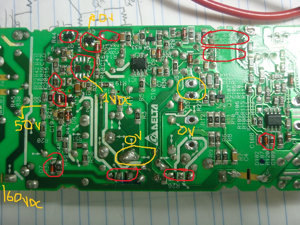

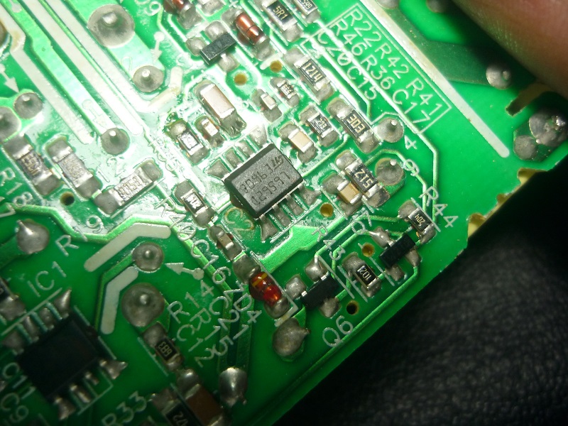

    Hello to all friends of the forum.
    I consult the following:
    I have a Sony Brand Laptop adapter, model VGP-AC19V10. Departure from 19vdc to 4.7Ah
    The fault is that it does not turn on, disarm it to verify the fuse and it is correct, I was measuring voltages and the 160 vdc that comes out of the bridge rectifier is present, after that they pass through a resistor network forming a voltage divider and I have 50vdc. of that voltage, through another resistance low to 1vdc and arrives at the integrated one that in the photo is not present (L6562 PFC).
    This integrated is not receiving the supply voltage in its pin number 8, which comes from the transistors that are up, but these transistors also do not get voltage.
    I went further to the right and I do not have any tension in the winding of the transformer.
    The large capacitor also has no voltage.
    I already take out the basic components, diodes, some resistances, the power mosfet, all are fine. They are not open or short.
    I understand that this integrated must receive voltage in an instant to activate, close the mosfet and pass the 160vdc to the primary winding of the transformer, and then feed back, but it is not doing it.
    So, my question is, really, how can I prove that chip? to know if it's okay.
    What else can I check?
    Attached photo of the card. The yellow dots are the ones I checked and I put the ones that have tension and the ones that do.
    there are 50 volts that are lost, they do not go anywhere, then there is a voltage of 1vdc that reaches IC1.
    The red dots are the components that you remove from the card and verify with the multimeter.
    Thanks in advance and I remain attentive to your valuable comments

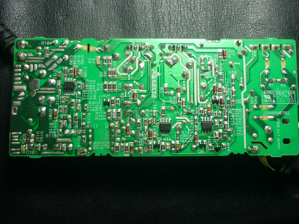

    Can you please post a photo of other side of the board
    Also can you please post the part of the IC chip that on this side of board

      Only integrated on side tracks
      • SoporteHR
        • Sep 2018
        • 80
        • Venezuela
        Re: Power Adapter Sony VGP-19V10 Not Working - Help Please
        Hello, SAM_SAM_SAM
        I post new Photo. Thanks
          Close, but it functions a bit differently.
          You should have 160V on the primary cap and on one of the transformer pins. From what I traced, that transformer pin should be the one next to the "R12" resistor marking.
          That fact that you don't have 160V going to the primary cap suggests the problem is before that, because the primary cap should always be connected to the mains.
          That said, I think your power adapter might have an APFC circuit. And if I am correct, then the APFC inductor should be L2, which I see is remove from your power adapter. Without this inductor, you will NOT get 160V on the primary cap. So make sure that is in there and report back if you get 160V DC on the primary cap and that transformer pin.
            Need clear straight shot of the WHOLE top and bottom side of the board.

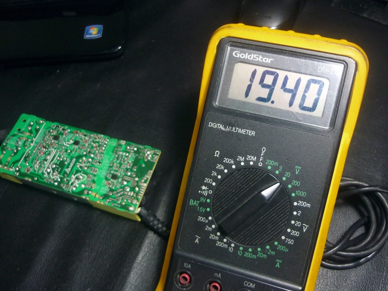

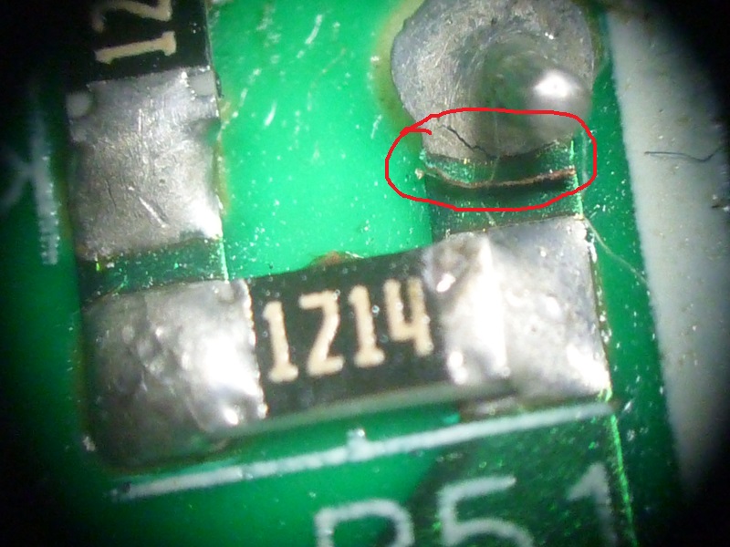

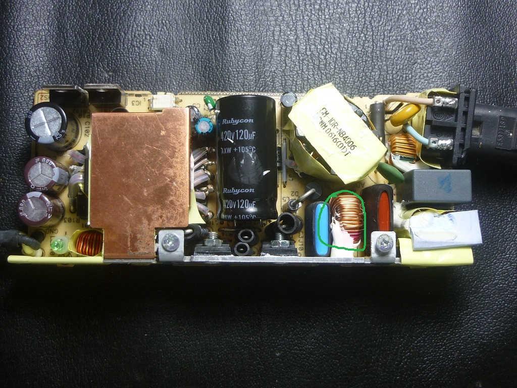

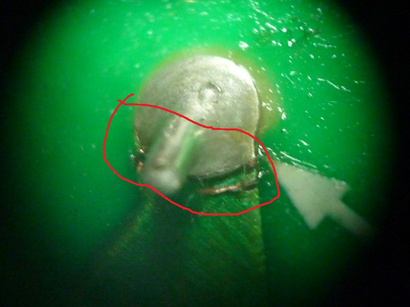

              Re: Power Adapter Sony VGP-19V10 Not Working - Help Please - Solved

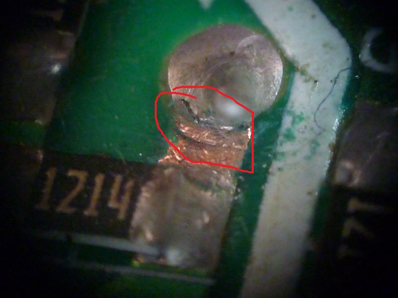

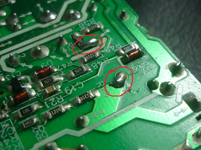

              Hi all.
              Thank you very much for the time it took to help me.
              The case is already resolved.
              The problem was coil L1 (marked in green). The PCB pad was broken, very close to the welding point, so I did not see it initially.
              When you told me to revise the energy intake stage again, I noticed that cut because the pad moved.
              I cleaned the solder mask and corrected the damage in the PAD that connects the coil L1 with the resistance R51, I did the same with the other end of L1 with R20.
              When connecting the adapter to the electrical power, the power was established at one end of the transformer and at the C1 capacitor of 160vdc.
              The output remains stable at 19.4vdc.

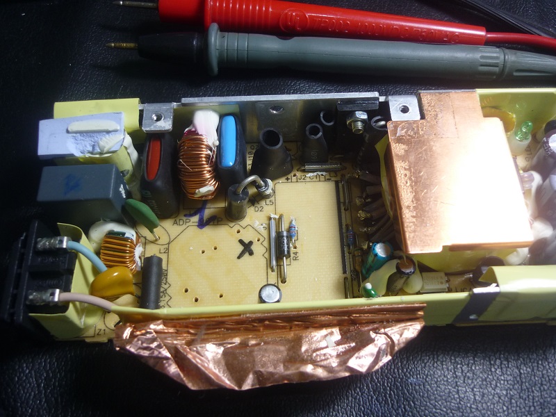

              I include photos with the voltages measured for future reference to anyone who has an adapter that is similar or similar to this model.
              Thanks again everyone for the help.
              Case closed.
              Sorry, i used google translate.
                Good job with the repair!
                And thanks for providing some voltage measurements - those could come pretty handy if someone needs to troubleshoot one of these.
                Looks like the power adapter must have been dropped for that trace damage to occur. Such things can be hard to spot, but you did it anyways.
                  Hello Momaka
                  Receives a warm greeting.
                  Thank you very much for your words.
                  It really is difficult to detect that type of failure and I agree with you, most likely it was a fall, because the L1 coil is large, it should move when the adapter fell and despite having the silicon to hold it, if I move it lightly with my finger , the coil moves.
                  I already put glue on top to prevent movement and to affect the welds again.
                  To order, it seems correct to publish the tensions, it is a great guide for future references.
                  Greetings and thanks for your time and help.
