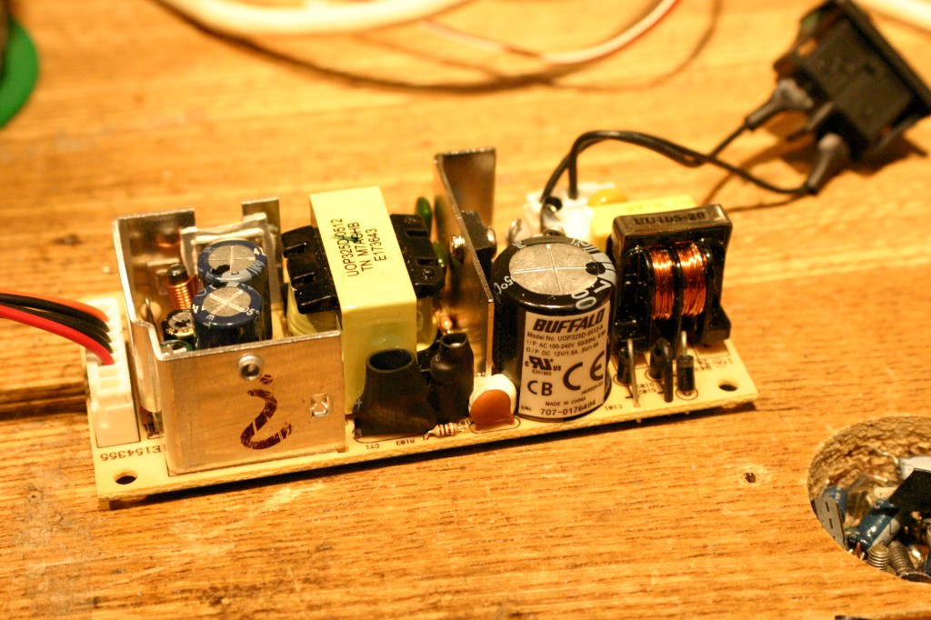

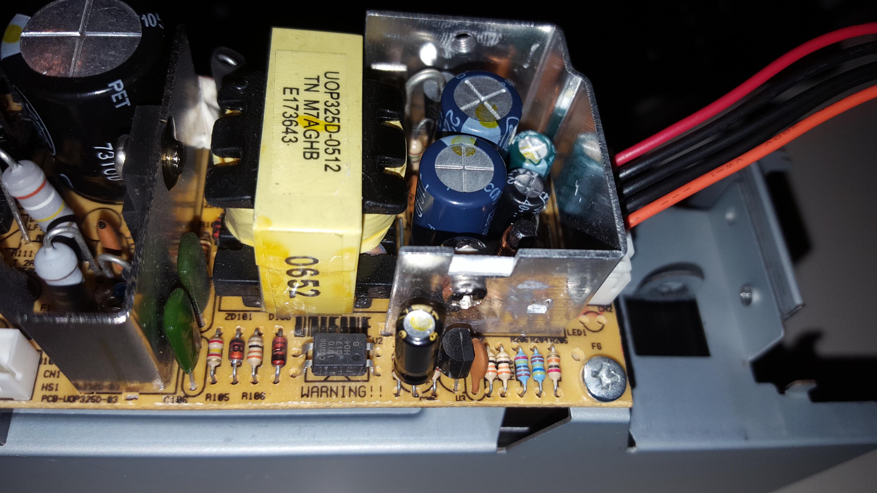

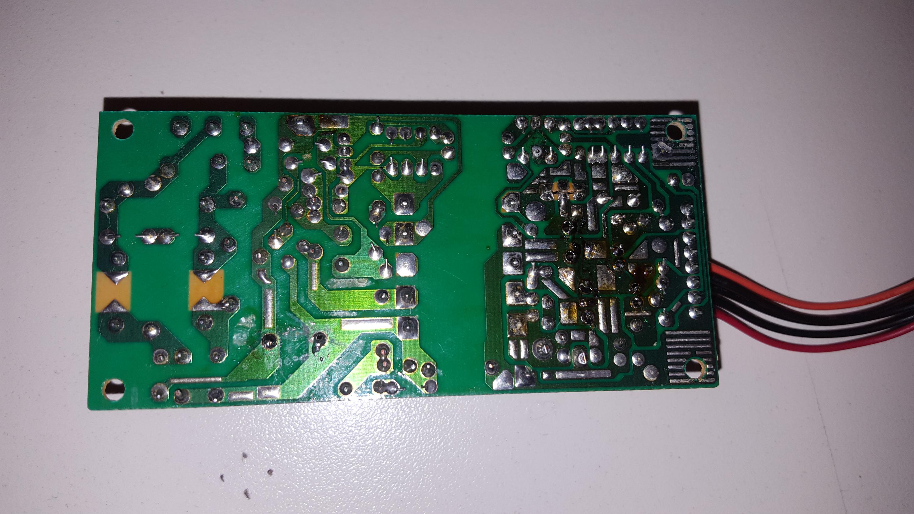

    Hi everyone.
    Can anyone help with a PSU which is making a ticking noise. The noise gets louder when load is applied ( it is still audible even with no load ).
    The PSU is UOP325D-0512-A ( still have not found schematics ) and looks like the attached images.
    I desoldered and measured all 6 electr. caps and 5 of them were fine. The faulty one was the green one ( right next to the 2 big ones on the low V side ).
    Any ideas what could be causing the ticking?

    The ticking is caused by the primary trying to start but can't usually caused by a short in the secondary somewhere.

        I thought it was not working, if the 5v and 12v are there then there is no short. The pictures are too small to really see anything.
        The ticking without a load could be normal, Was it working before you changed the cap?

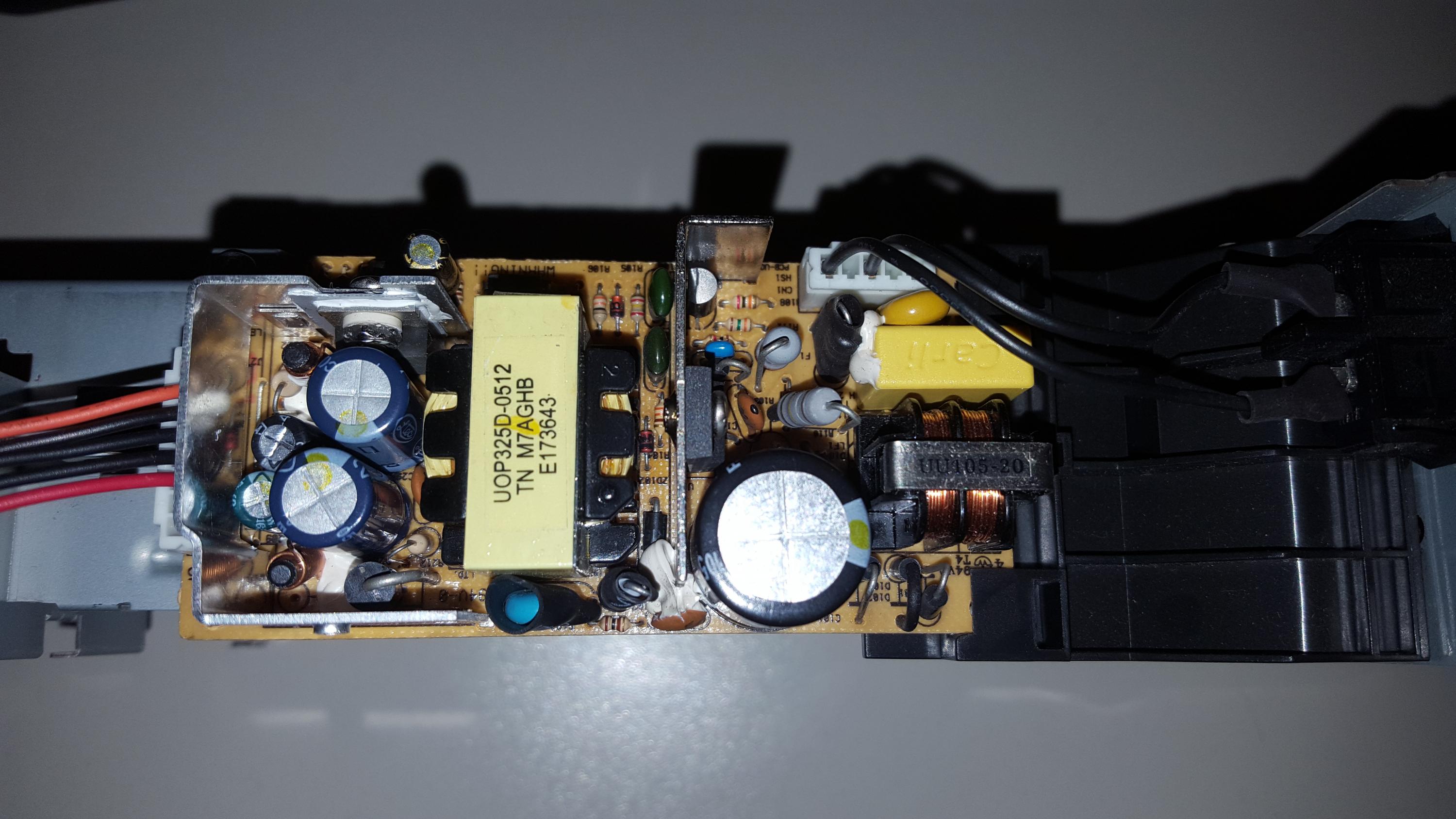

          Re: Ticking PSU
          Yes, it was working before I changed the cap.

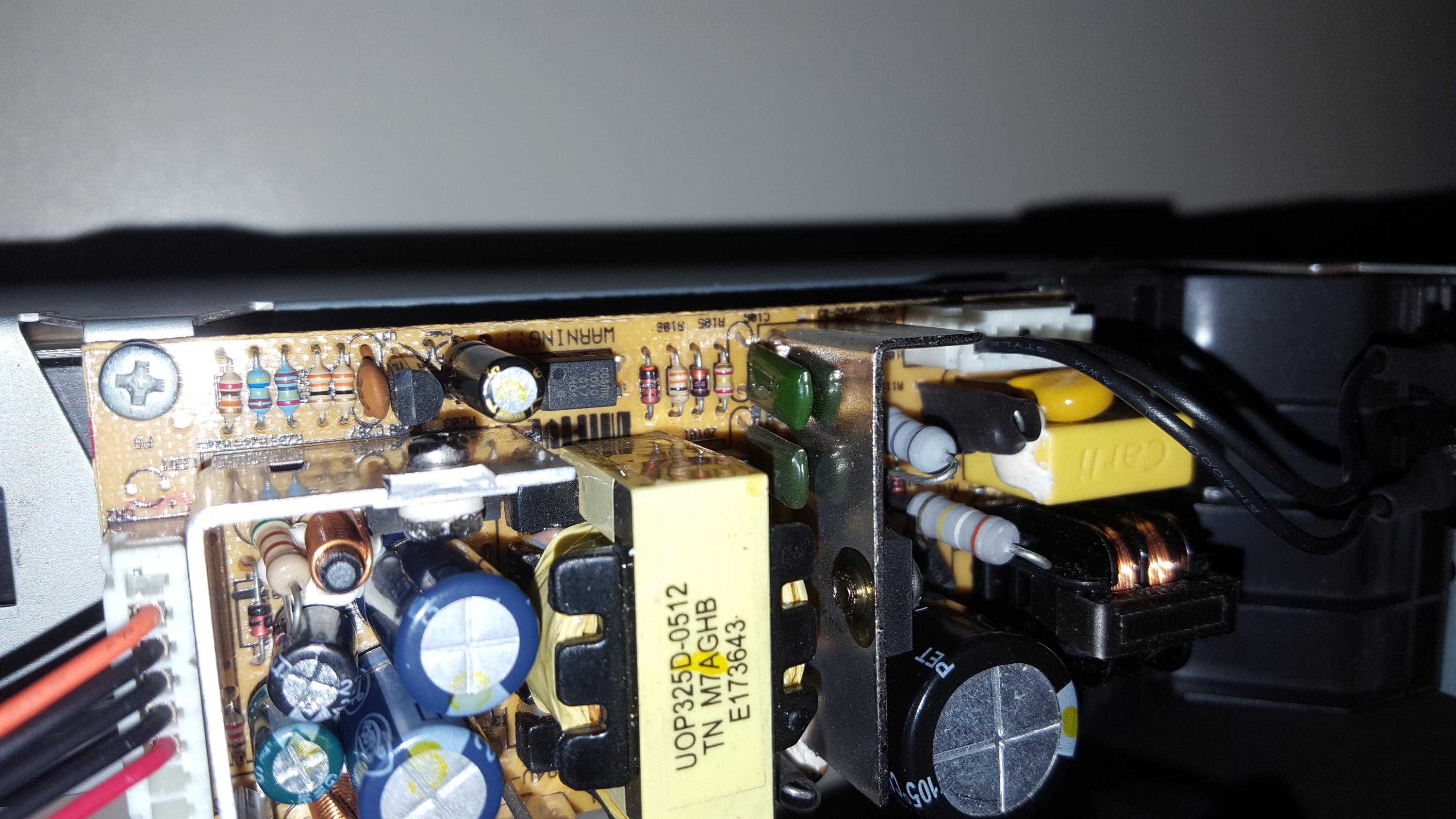

          Here are some better photos.
          • petehall347
            • Jan 2015
            • 4426
            • United Kingdom
            Re: Ticking PSU
            looks like the board needs a good clean and the dry joints attended to with fresh solder

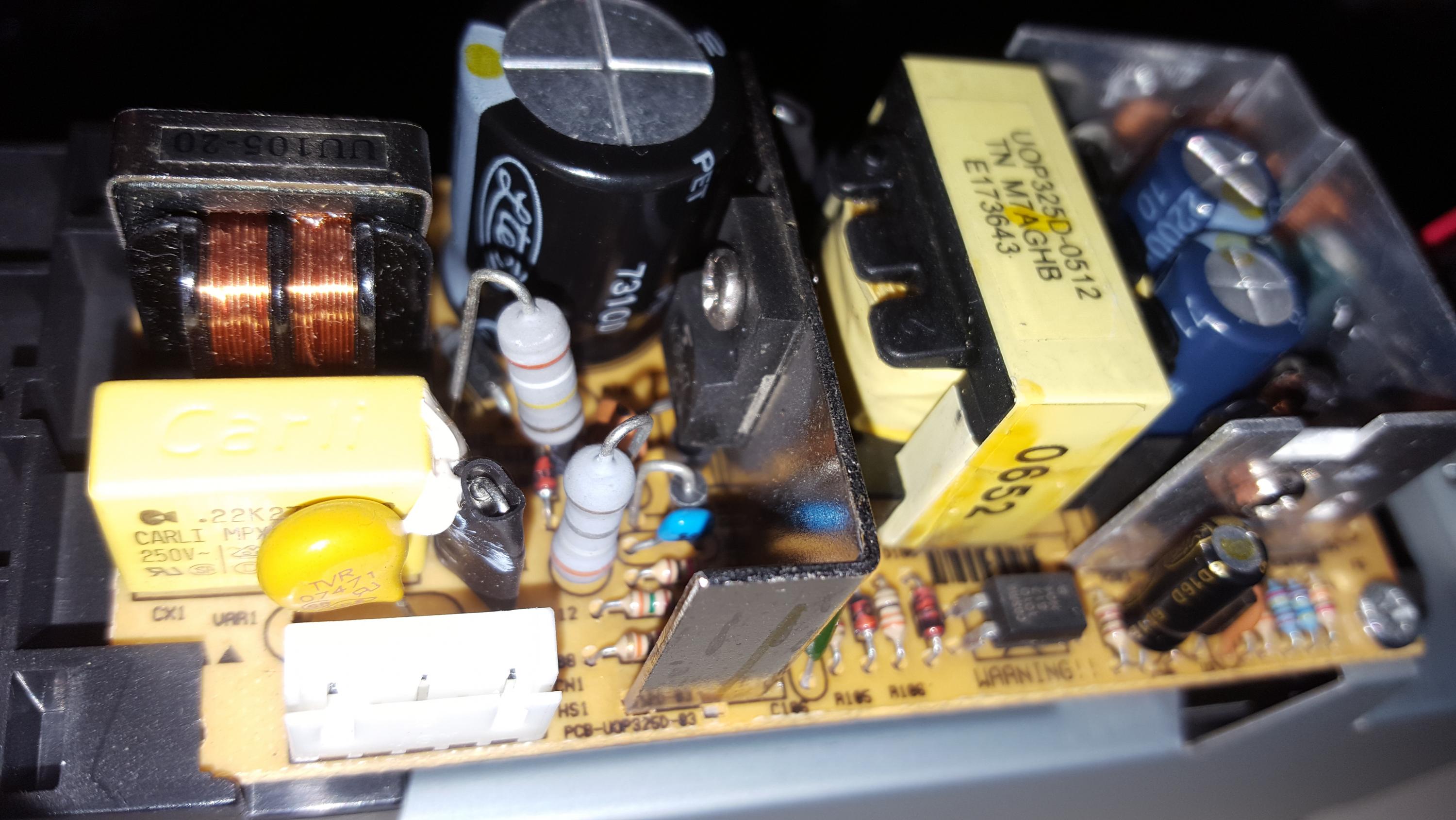

              Re: Ticking PSU
              All joints resoldered/reheated and the pcb cleaned.
              Still got the same "ticking" and output ripple.

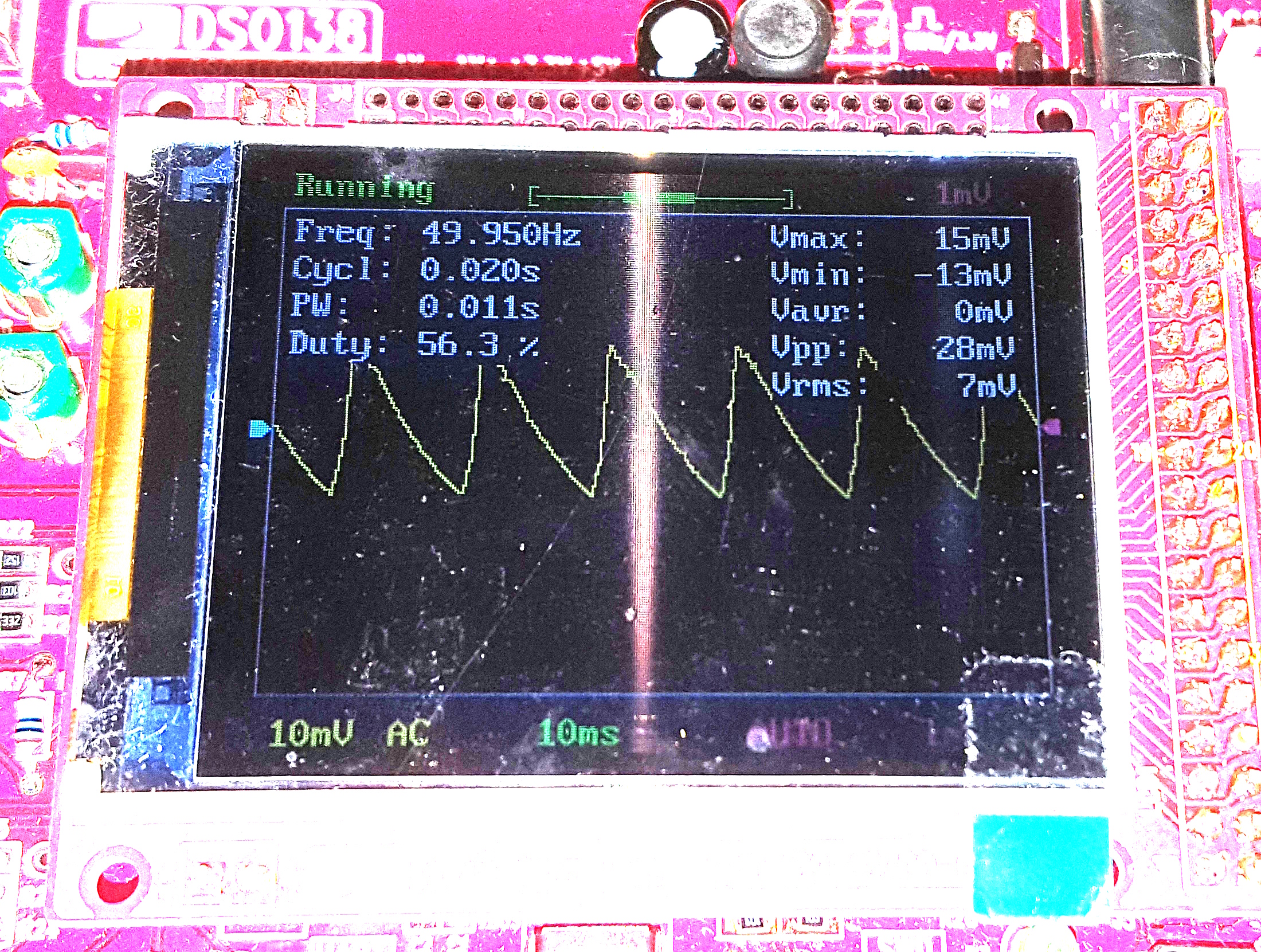

              Here is a recording of the ticking and what I have on the output. Is this ripple acceptable?
              • R_J
                • Jun 2012
                • 9535

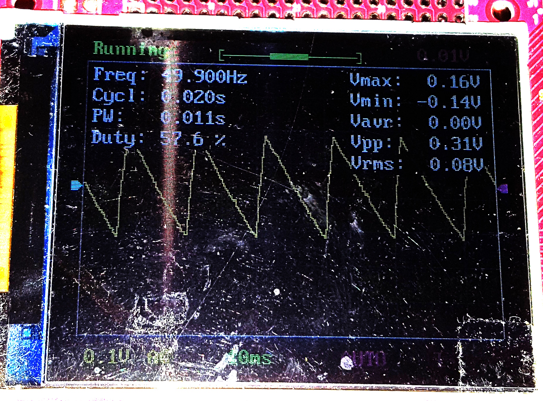

                Re: Ticking PSU
                I have no idea where that ripple is coming from but at 49Hz it must be from the primary, That power supply operates at about 30-50 Khz. So it could be that the main filter cap is bad, sometimes those large caps can't be checked properly with a meter, And it does look a little bit domed but hard to tell from the pictures.

                  Re: Ticking PSU
                  Here is the audio converted to mp3.
                  I desoldered and measured the big cap on the main side and it was within 10% of its original capacitance. Anyway, I will switch it with another one and test it again.

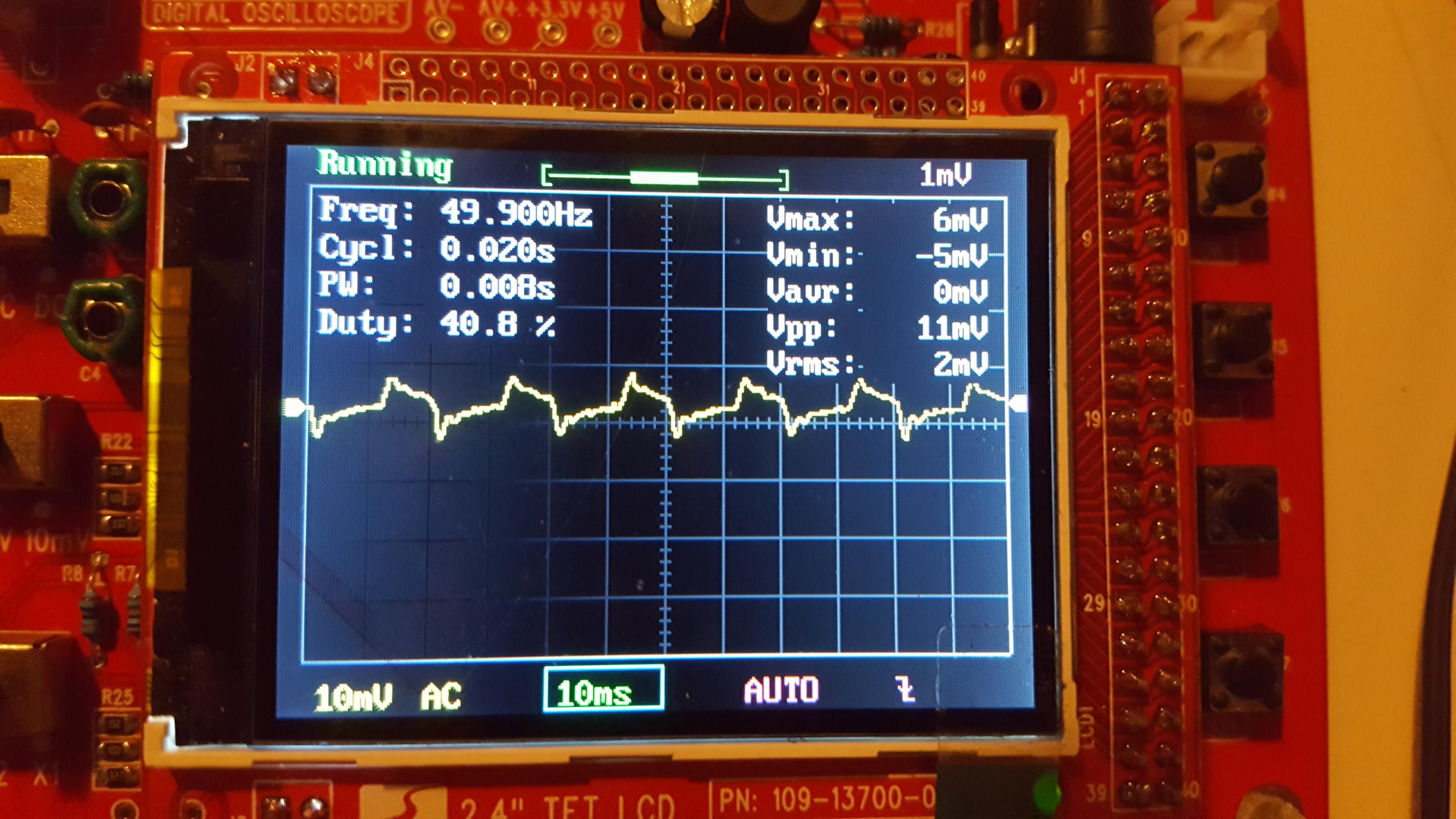

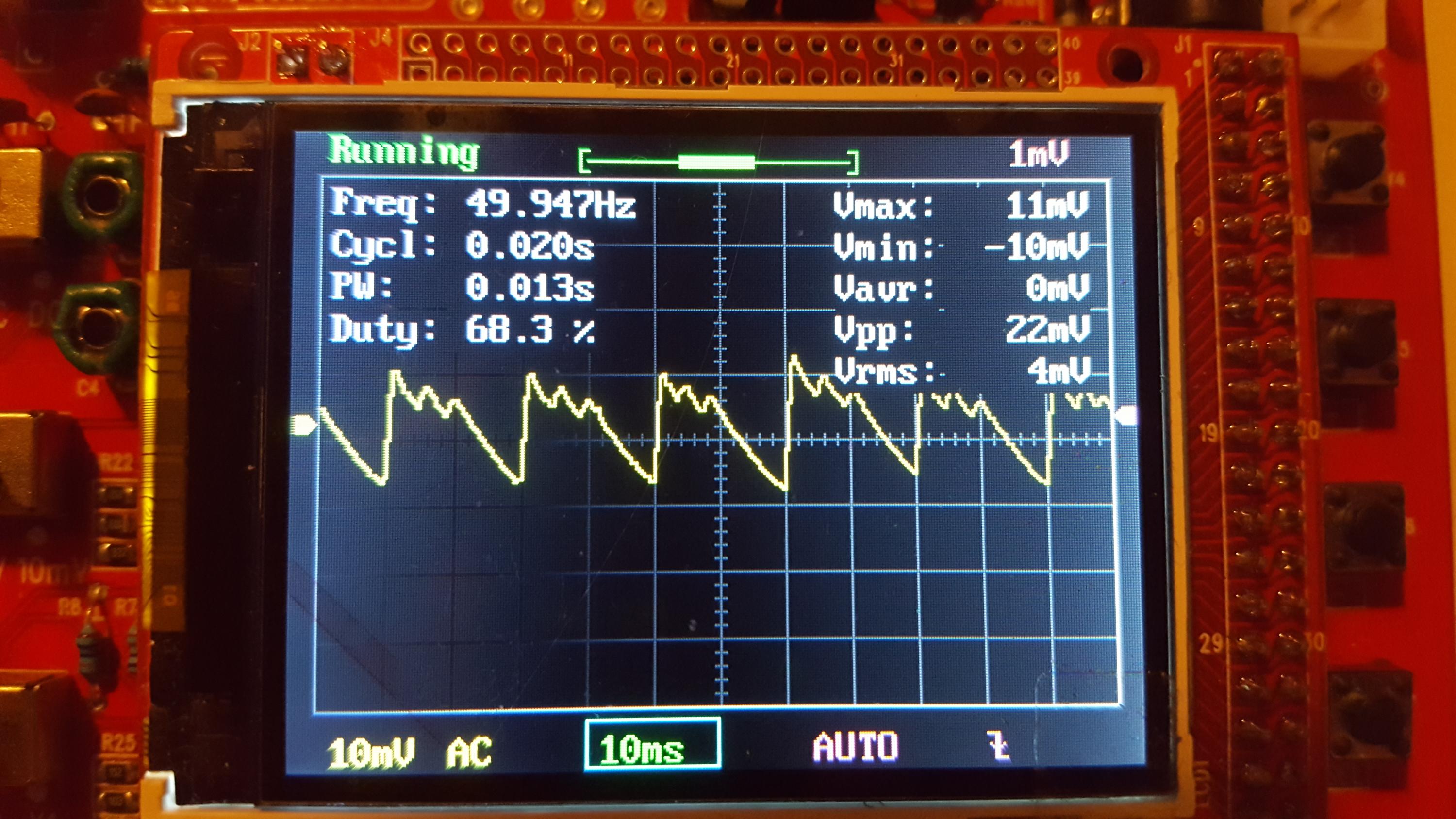

                    Alright, I think I found the problem.
                    I swapped the 47uF/400V cap with a 100uF/400 ( that's the only 400v which I have at the moment ) and the noise disappeared.
                    Also the ripples changed ( see attached ).
                    I tried to measure again the 47uF/400V but couldn't get a good reading this time. It looks like there is some kind of an internal failure.. probably one of legs is not getting good contact with its conductive plate.
                    So I guess the "ticking" issue has been resolved ( kudos to R_J ).
                    Do you think there is any point in continuing working on this to get better outputs?

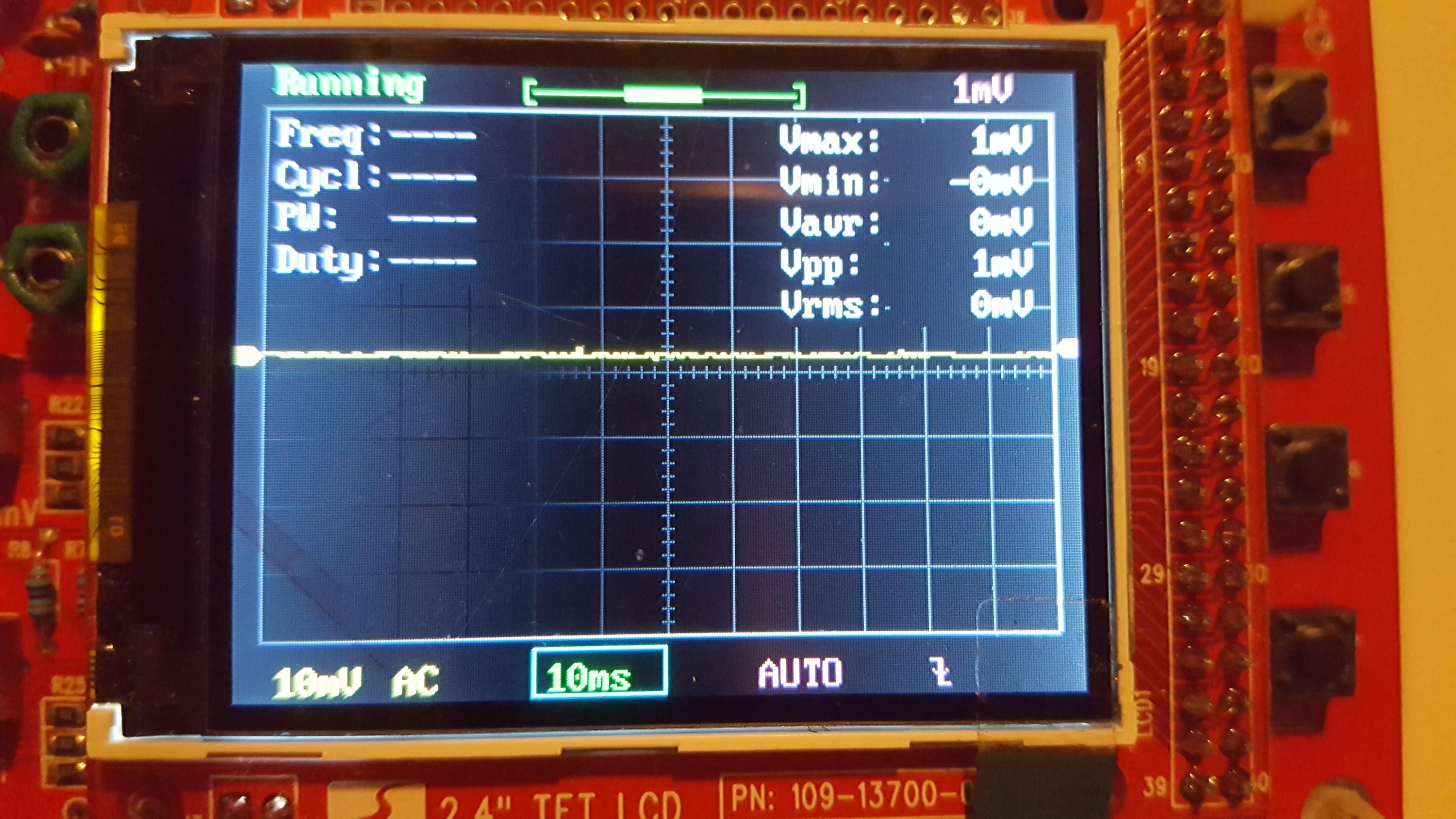

                      I am curious as to where you hook up up the scope too to get that 50Hz (20mS) reading, the primary side use full wave rectifier so the ripple on the main cap will be 100Hz.
                      • madan1
                        • Nov 2016
                        • 682
                        • Bulgaria
                        Re: Ticking PSU
                        I used the black output wires for ground. The orange wire is +12V, the red - +5V
                          Re: Ticking PSU
                          I am curious, If you do not have the power supply connected to the AC outlet, what do you see on the scope (leave the probes hooked up the same way)?
                          • madan1
                            • Nov 2016
                            • 682
                            • Bulgaria
                            Re: Ticking PSU
                            There you go.
                            Leads hooked to the same wires ( black and orange ), no AC.

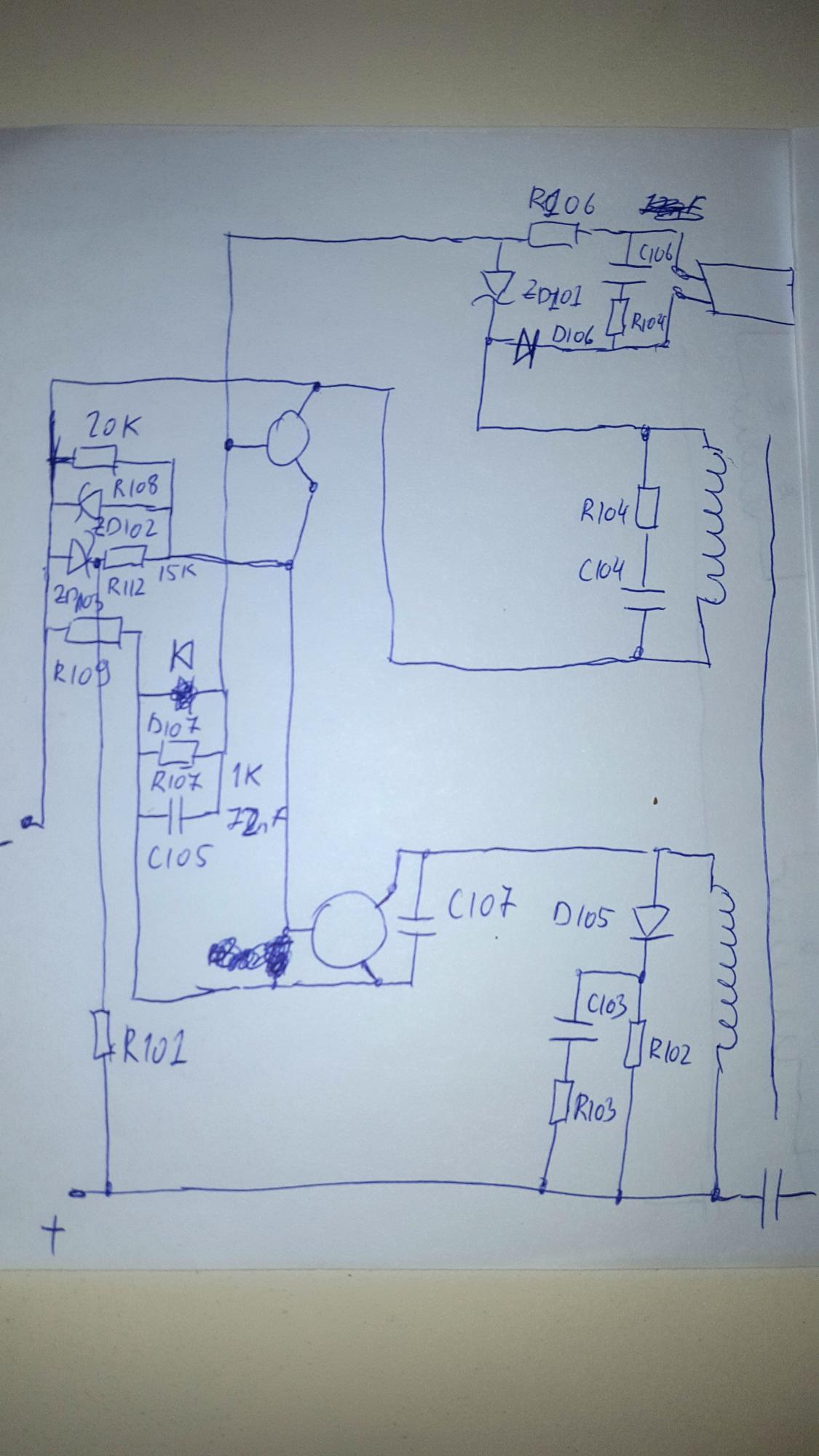

                                        The board is for a NAS which I'm going to use at home, so it is not a problem to keep an eye on the PSU and its caps
                                        Unfortunately, I "killed" the PSU by discharging the 100/400 cap with a srewdriver.. most likely the arc jumped to something else and now I do not see anything on the low-V side.

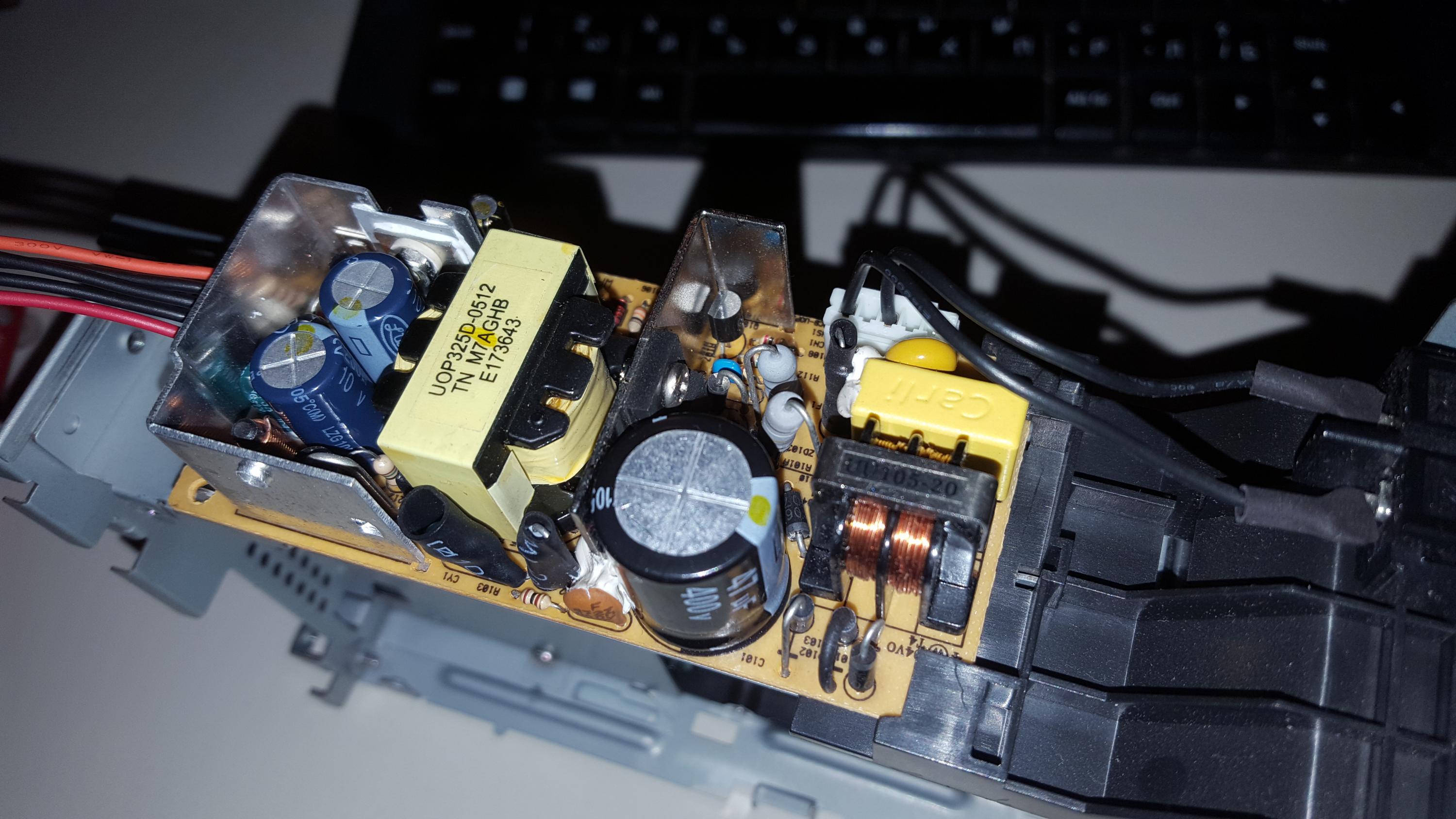

                                        Here is what I was able to draw as a schematic for the hi-V side ( see attached, the rectifier part is skipped ).
                                        The bad components which I found are ZD103 and C107. I was not able to find the same design, but in others they show it as "17-18V"(?). Also, ZD102 on the board is labeled as "ZD", but the actual component is detected just as a diode.
                                        The big transistor is K3567, the small one - C945
                                        At this moment I 'm starting to think that it would be better just to get one of those https://www.aliexpress.com/item/12V1...310683501.html instead of fixing it.
