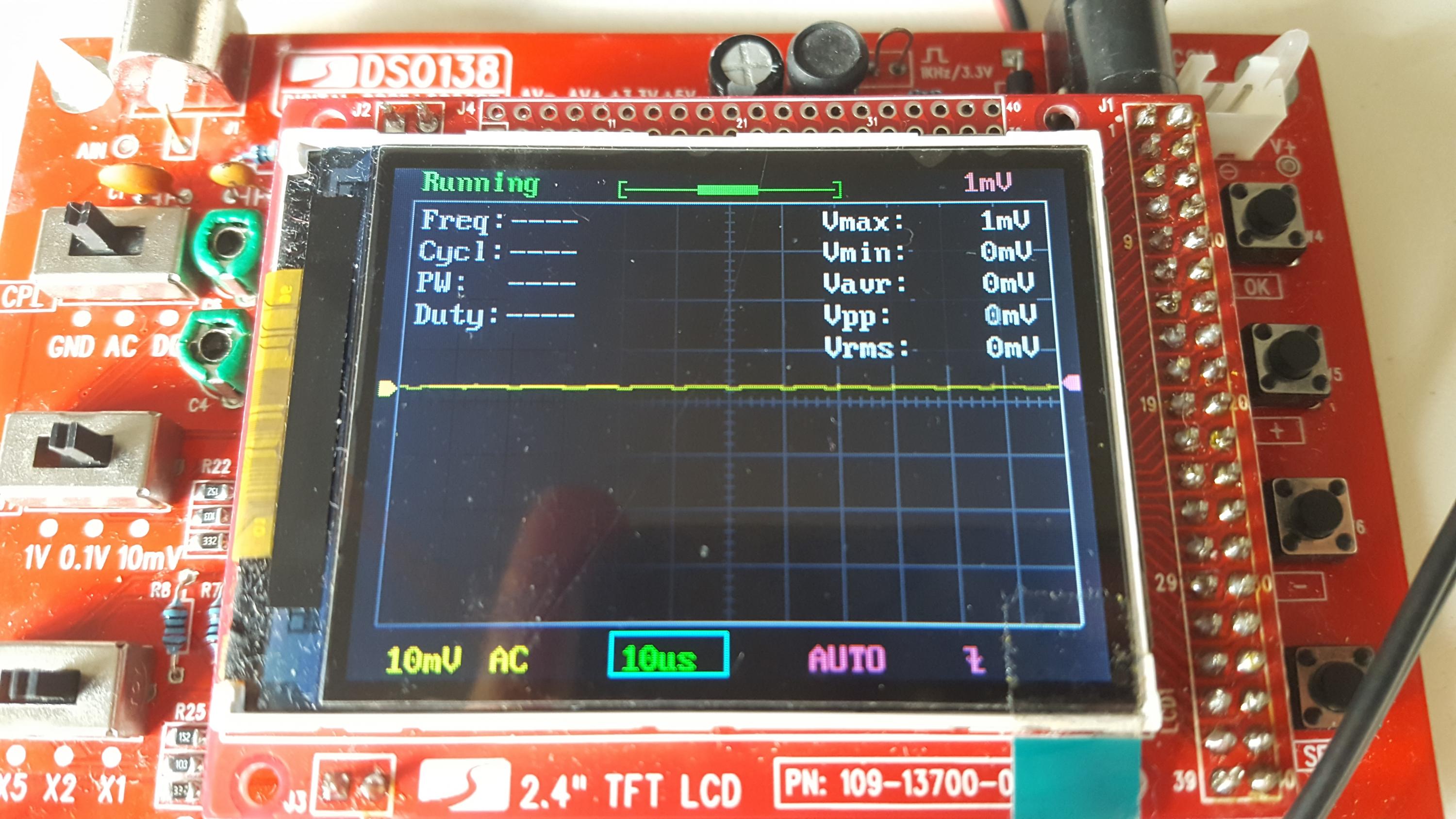

                      I installed new ZD 27V and C107 (22pF ) and got back the voltages on the secondary side.
                      Then put the correct bus capacitor ( 47/400 ) and now I do not have any visible ripple on my "scope" ( I'll attach images soon ).

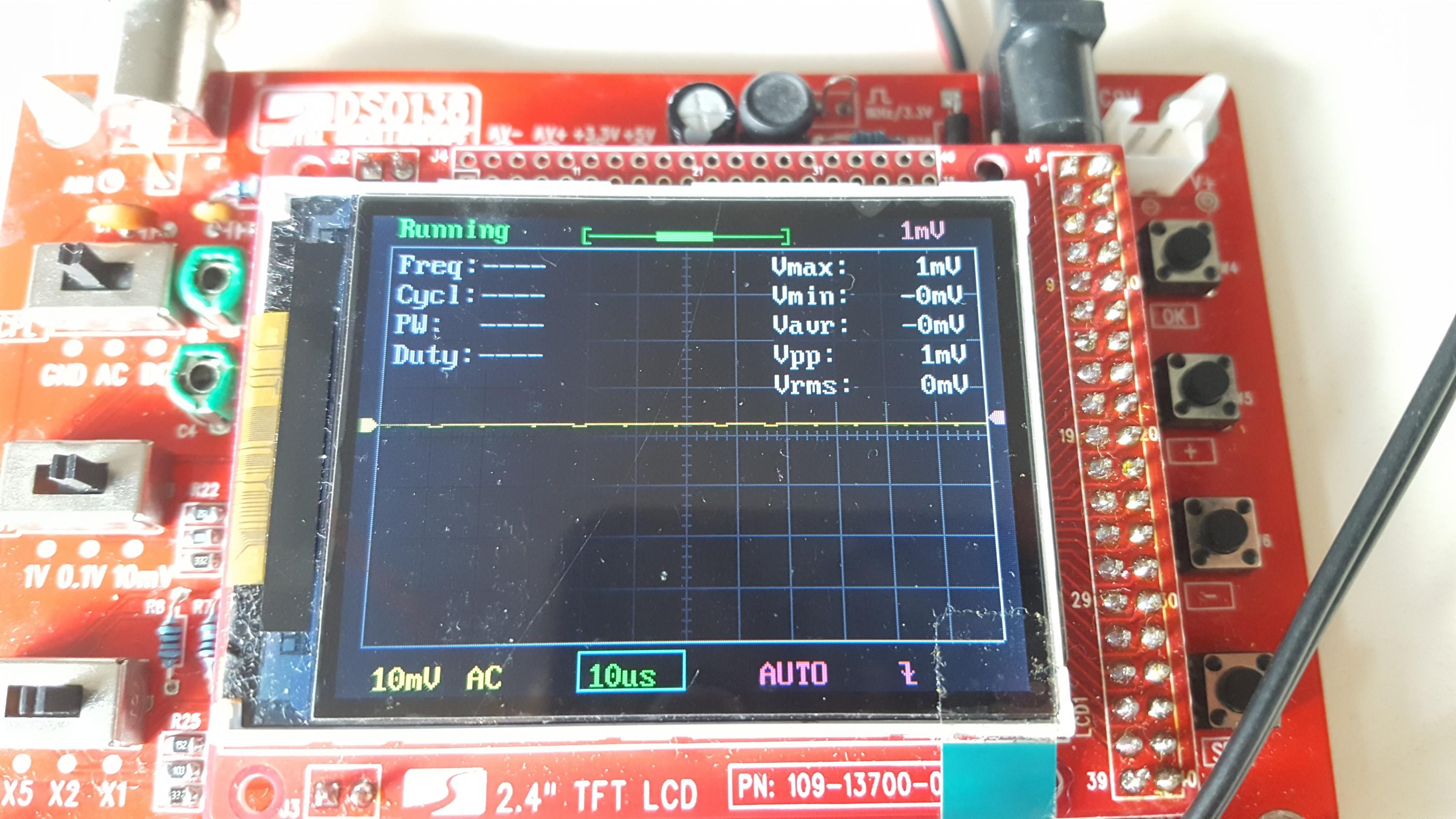

                        #31
                        Re: Ticking PSU
                        Here are the waveforms without load ( for 12V and 5V ).
                        With load the fluctuation is about 15-20mv and frequency of ~25khz and ~130khz for the two V rails ( no clear sines though and lots of noise ).
                        Fortunately, the HDD seems to be happy with that. The mainboard also manages to filter the supply and for now everything works fine.
                        P.S. - no ticking sound at all!
