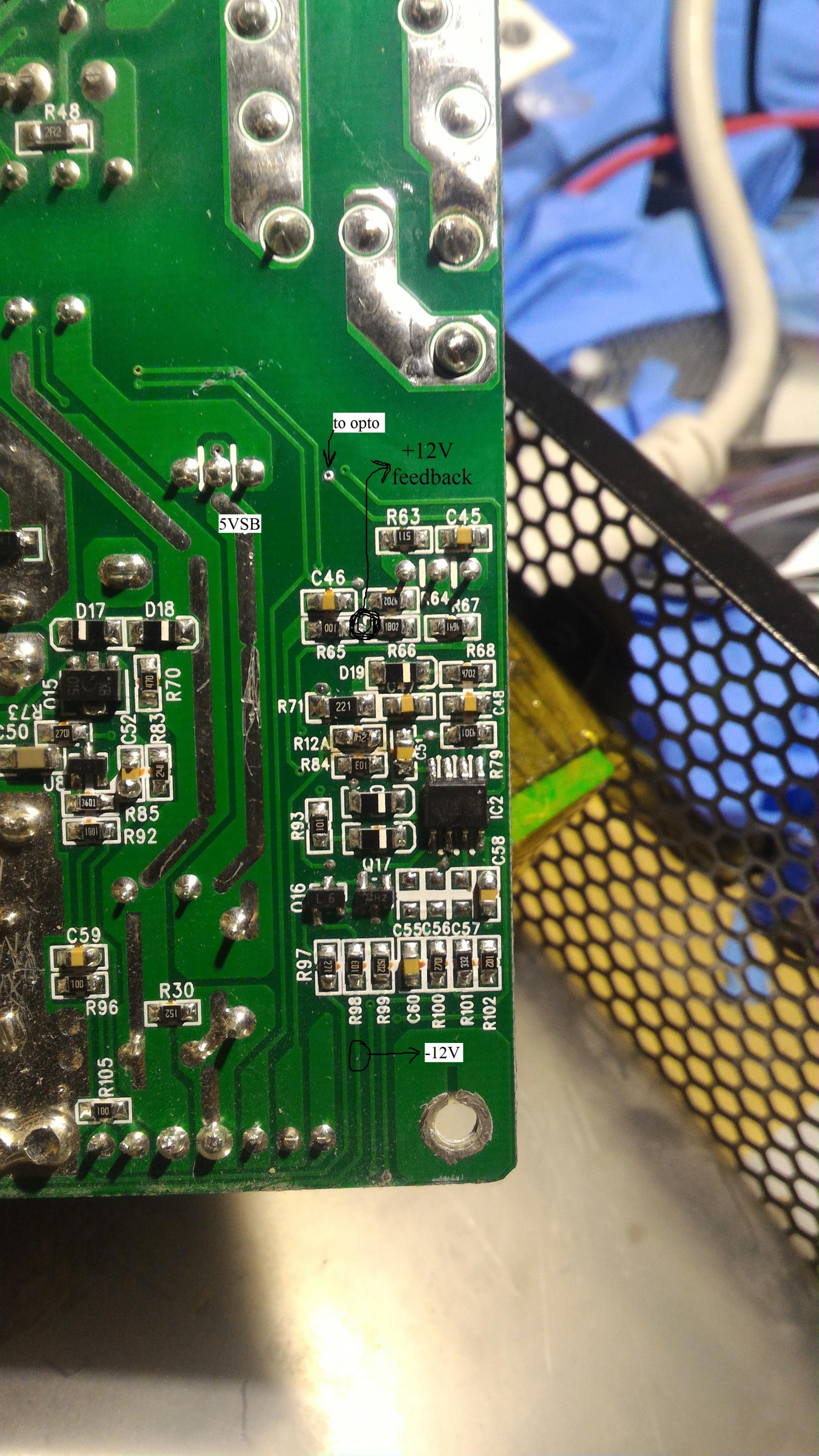

            Turns out the diode was the rectifier for the -12V rail. Another thing is that there's a WT751002 supervisor IC, which should take care of things but it doesn't really help much.
            There are three optocouplers in total, one is for voltage feedback, other is for 5VSB feedback and the third is for fault feedback.

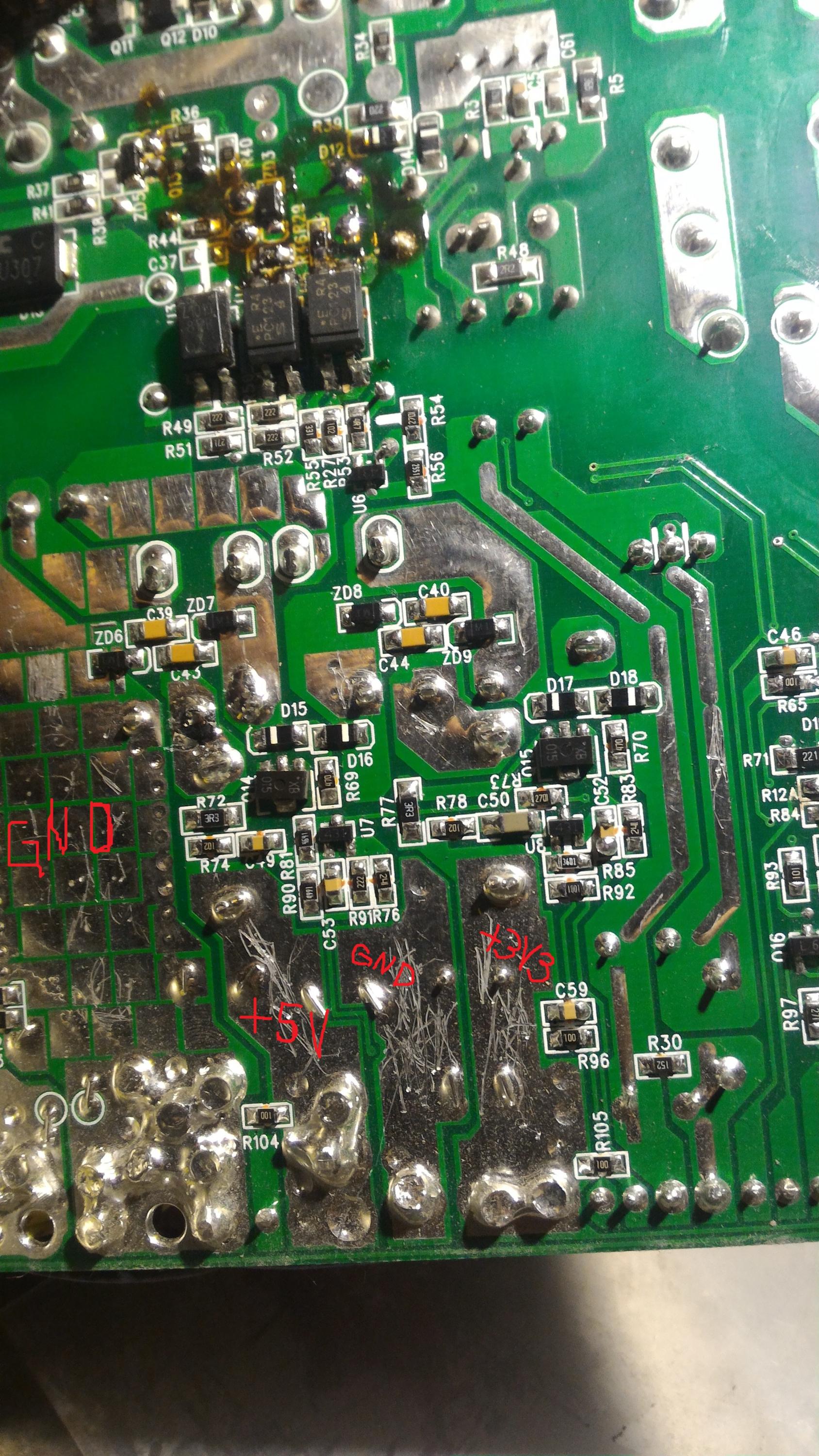

            There's some weirdness going on at the 5V and 3V3 rails, they both have these nearly identical circuits next to them consisting of a TL431 that controls a transistor, but from what i can gather this does not influence the voltage feedback.
            I might just bodge a resistor divider from another PSU schematic to control the voltage feedback.
              Re: Weak 5V line, Nexus RX-5300 530W modular PSU.
              I took two pics, one of the supervisor IC area and one of the 5V and 3v3 areas.
              Please excuse the fluxy mess
              Edit: calculated what the TL431's trigger at, on the 5V side it's 5.194V and 3.435V on the 3V3 side.
              I might just hook those TL431s to the voltage feedback opto i think.

                  Most likely, your 5V and 3.3V rails are mag-amp regulated. If you have separate toroid outputs for the 5V and 3.3V rails from the 12V rail, it's definitely that. Providing more picture of the entire PSU should allow me to tell you for sure, though.
                  As for fault feedback - there's no way the 3.3V, 5V, and -12V rails are not connected to the WT751002 supervisor IC. There should be thin traces from these rails going towards the WT751002 chip... unless there is another chip that they go to (but I doubt it.)
                  If your PG signal is low, that may be because of of the rails is too low or too high, but not enough to trip protection. Or just not detected properly by the WT51002 chip to issue a good PG signal. *OR*... some of the small caps surrounding the supervisor IC are bad. Again, you didn't tell us what brand of caps the unit has nor did you check them with an ESR meter. So there's no telling where the problem is.
