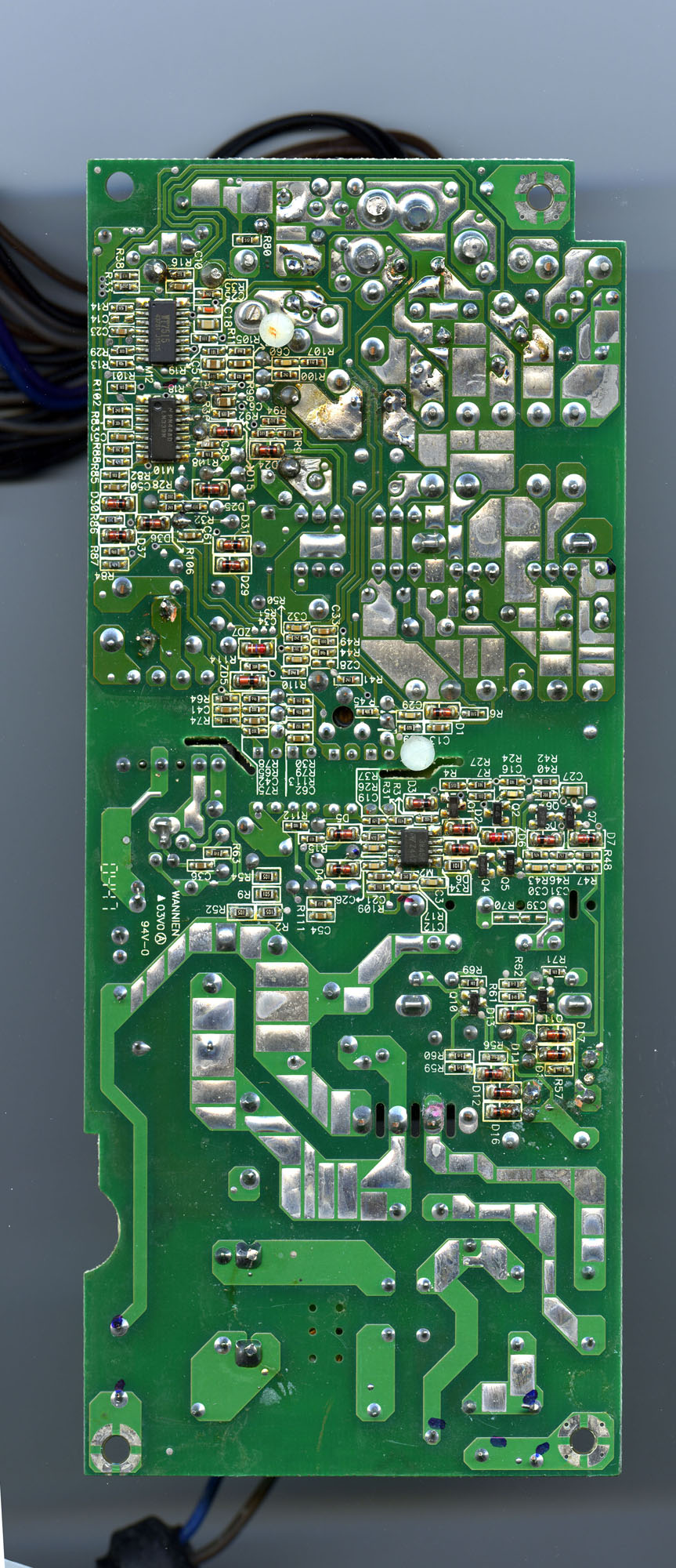

          Can you get a pic of the backside of the board? If you can identify the chips back there (PaintShop-Photoshop?) it will make some explanations a bit easier.

                Here's the solder side of the power supply. Upper left is M12 over M10. Middle of board is M2.
                  Re: iMac P/S posts then shuts down
                  BTW:
                  3845B is a PWM
                  LM339M is a quad comparator
                  WT7515 is a protection IC that monitors 3.3v, 5v, 12v for over/under voltage

                                Haven't given up but I may have reached the wall that separates the newbies from the real techs. I'm having trouble locating the "source" for the various voltages- 3.3, 5, 12 and 24. Example- on the LM339 of a working supply, I see input 2 with +20 & -20 and +24 (Vcc)Supply yields output 2 of 0; input 3 has 0 & 2.5 and 0 (Vdd) Supply yields 3.3vdc; input 4 compares -1 & +2.8 to yield 3.3; input 1 does -2.6 & +3.1 to yield 3.3 at output 1. This is on a psu turned on with the 15/16 jumper. Now the one thing I've noticed on supplies which either run and shut down or won't go beyond LED1 lighted on the mobo (I think I saw where you guys discussed the 4 LEDs this iMac uses to indicate good power-- if not, LED1 just senses voltage from the psu, LED2 acknowledges startup and peripherals, LED3 is for display (to 20" needs the 24v here) and LED4 doesn't come on unless there's and overheat problem,) is the lack of 24 Vcc. And, while I can find it at TPs I lack the knowledge/skill/good eyesight to track it to its source. I think its at UGIODCT 0420 because after T1 puts out two 12v rails UGI shows 12v on its outside legs and 24v on the center. This carries up through L1, C59, D21 and out +24 to pin 22. Bingo that should be it, right? Not exactly, I've tested some supplies where 20v appears on the cathode side of D21 and 0 on the anode side. I've no idea where that's coming from. Anyway, I think the UGI rectifies the two 12s from T1 to yield +24. Also in that area under T1 are a bunch of smds including M2 which is a 3845B Z442 PWM which I know what it does but not how to tell what it's doing here. I'm also not sure how to read the TOP242 correctly and wondering exactly what its "multi-functions" are being used for. It seems like its protection circuits like WT7515? All this regulation is getting me confused!!
