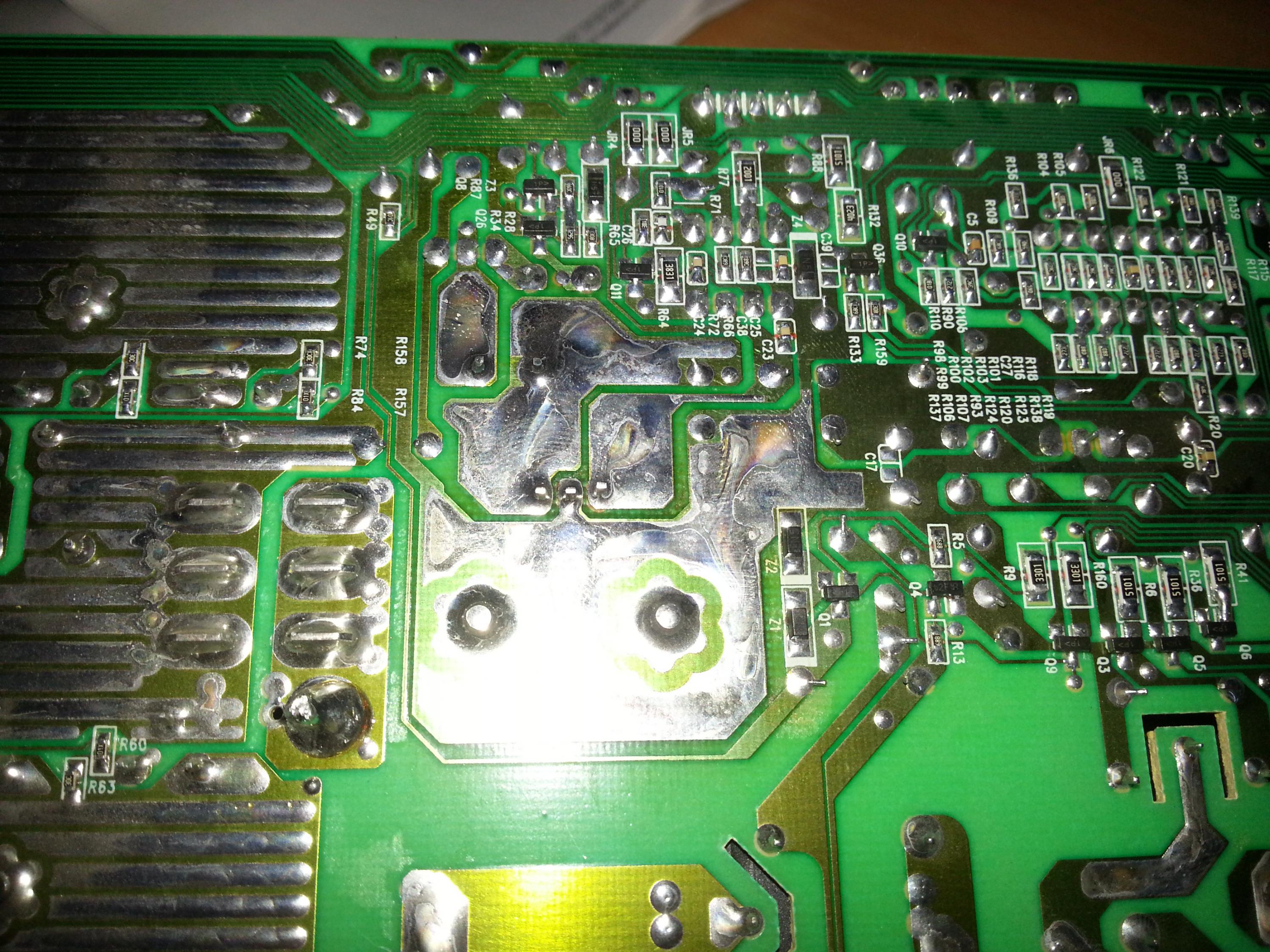

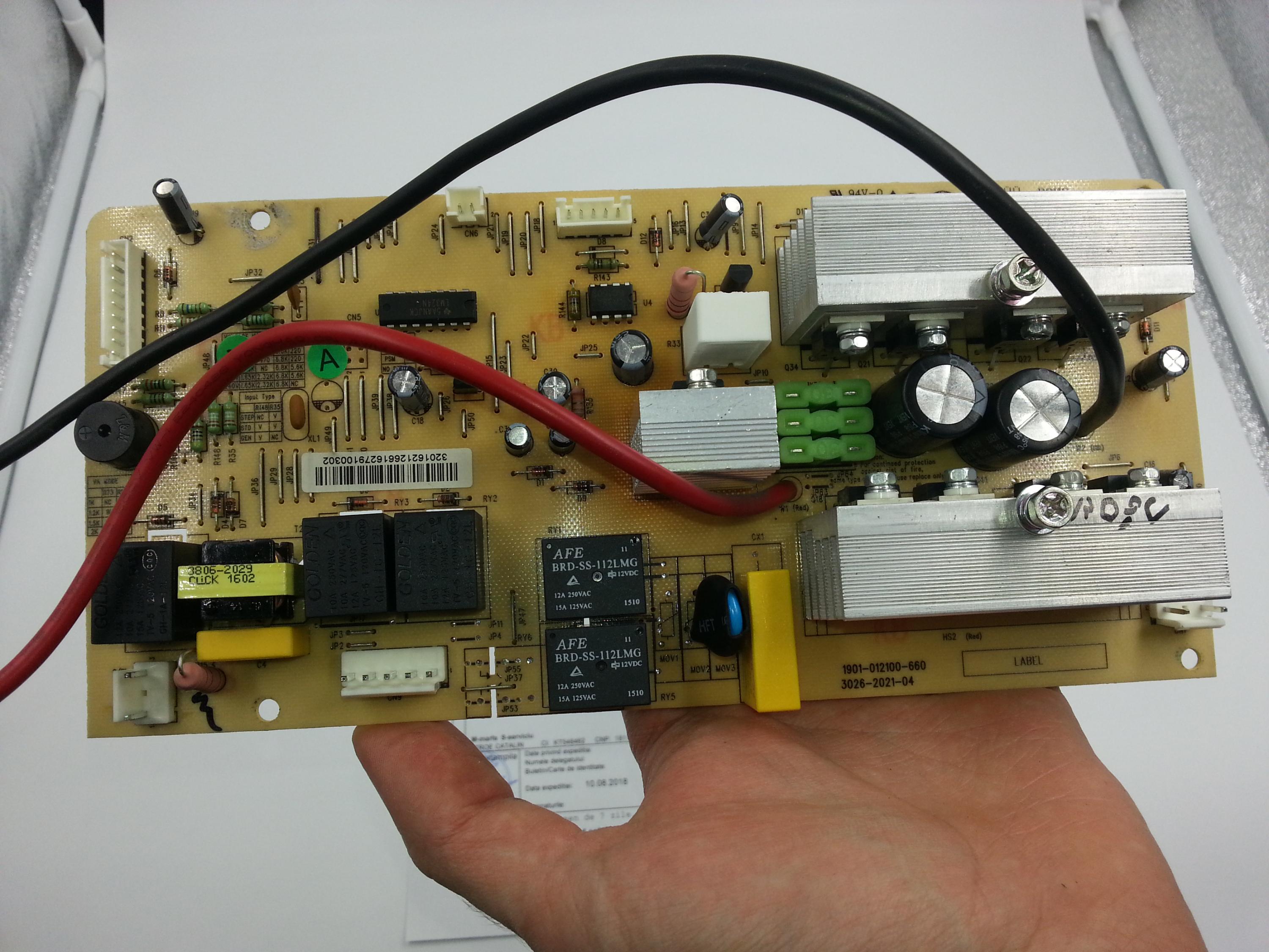

    Good day folks. This is going to be a general discussion, since it's a rather particular issue with a rather particular device that not many people are going to have around, but the basics may still apply.
    I've got an UPS (called "SPS Pro", whatever) which won't turn on but beeps continuously when you connect its batteries or plug it into the mains. When you apply mains, the display does come on with all the segments illuminated like it's initializing something, but then begins beeping and the display goes out (sometimes, but not always, accompanied by an "overload" indicator). The weirdest thing about this is that I replaced the batteries in it yesterday (takes 2 of them in series for 24v) and it worked perfectly on the bench with nothing plugged it. My colleague then took it to the customer where it was to be installed and on its way there it somehow broke down and when he arrived and tried plugging stuff in, the thing went crazy and he had to come back with it....heavy thing BTW
    I'm suspecting bad caps (pun intended) This thing likes to get hot....VERY hot...in fact when I first got it to replace the batteries, it was SO hot inside of it that the transformer inside was impossible to touch, despite having spent around half an hour in transit turned off, from the client's site to our shop, so I can imagine those caps don't like that, especially 24h a day for the past year or so ! The batteries were completely cracked, bulged and leaky...it was a freak show. Still, it appeared to work immediately after replacing the batteries, and I may have a theory: it was still warm when I replaced the batteries, so the faulty cap(s) might have still been semi-functional, you know how you heat them up slightly and that SOMETIMES tricks devices like TVs and main boards and other stuff to turn on ? After a while sitting on the bench, it cooled down, the caps failed for real this time and here we are...I might try heating it up again gently just to see what happens. Batteries are full, at around 25v in series, so no issues there.
    Point is: what are some of the common failures in UPSs (upsS...is there such a word ? ) that would cause them to behave like this, as if the battery is low or it's being overloaded ? Nothing's blown, of course, at least not visibly. Certainly none of the 8 transistors - I checked those, plus I doubt it would've looked so pristine if one of those went Could it be considered a "software" issue ? Is it really that smart ? I see a micro on there, but that could be for the display for all I know.
    Wattevah...

    Point is: what are some of the common failures in UPSs that would cause them to behave like this, as if the battery is low or it's being overloaded ?
    APC units will squeal incessantly if the battery is dead. Have you checked to see if there is a blown battery fuse?
    Note that the UPS shouldn't be "hot" with no load if on mains power.

      It does react to the battery being connected to the terminals, so there is power going into it. Having a look at the underside of the board also shows us that there's no other way for current from the battery to get into the board but through the fuses. For a second I thought there might be some hope in what you suggested, like current flowing into a sense line but not to the main FETs, but no...
      I imagine it got hot when he brought it in because those busted batteries were drawing a lot of current, since otherwise the transformer is not doing any (major) work when on mains beside trickle-charging...unless, from what my brief knowledge is telling me, we're talking about a line interactive UPS which this clearly isn't.

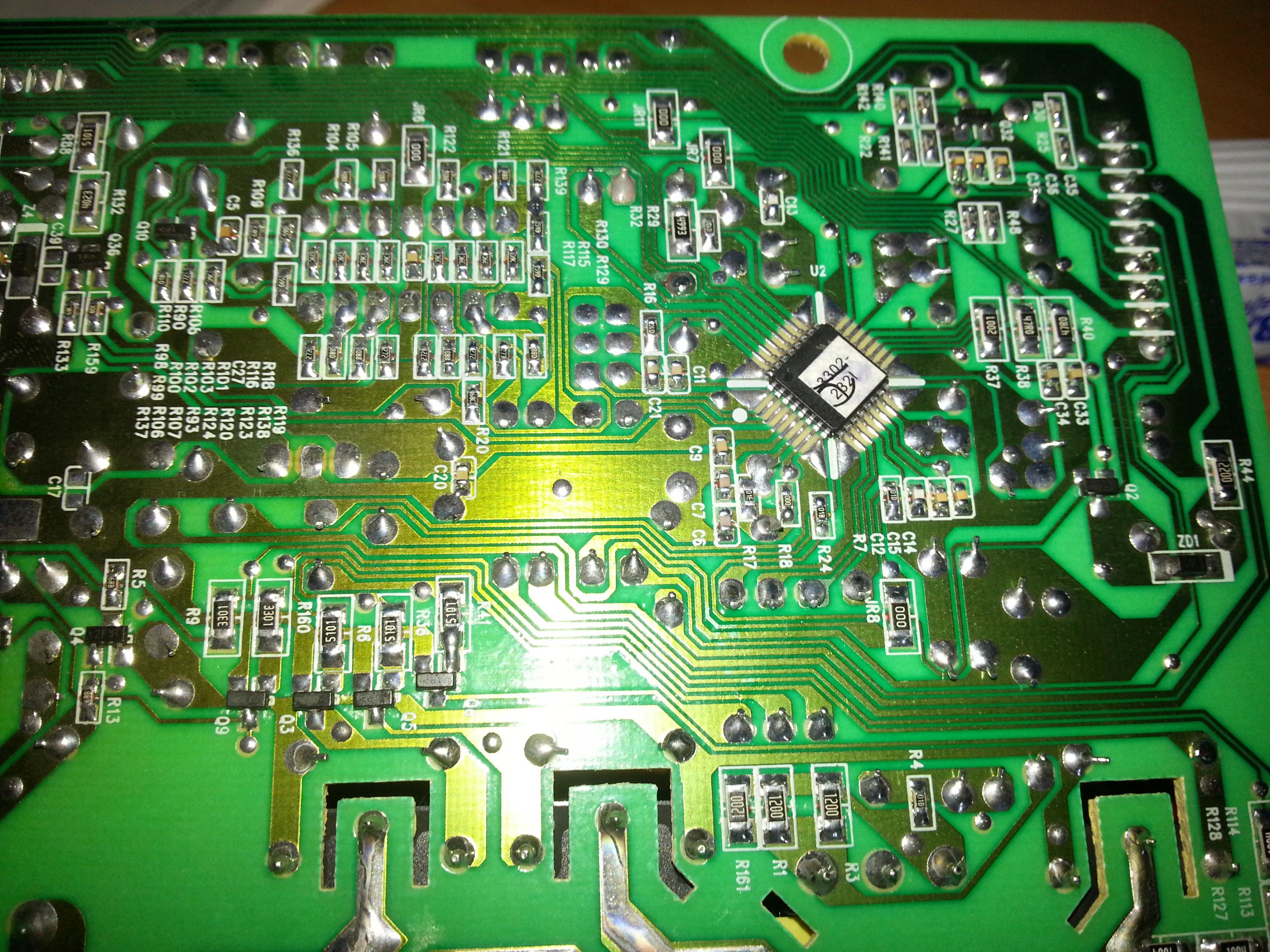

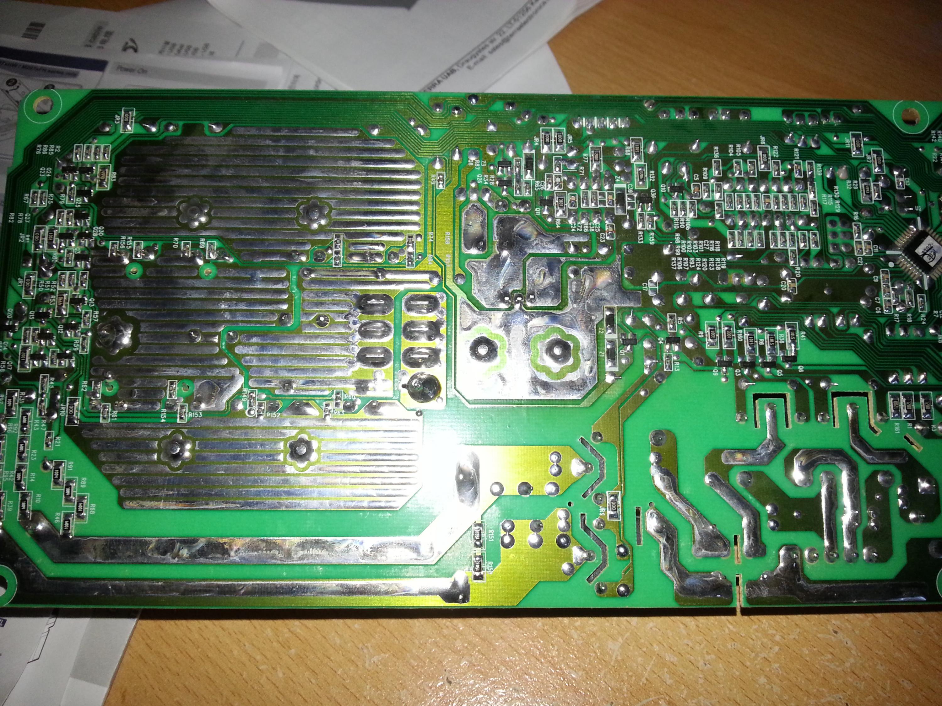

          Tried hitting the board with some hot air but didn't change anything. Strangely, today the problem is consistent: a continuous beep with FAULT shown on the display...

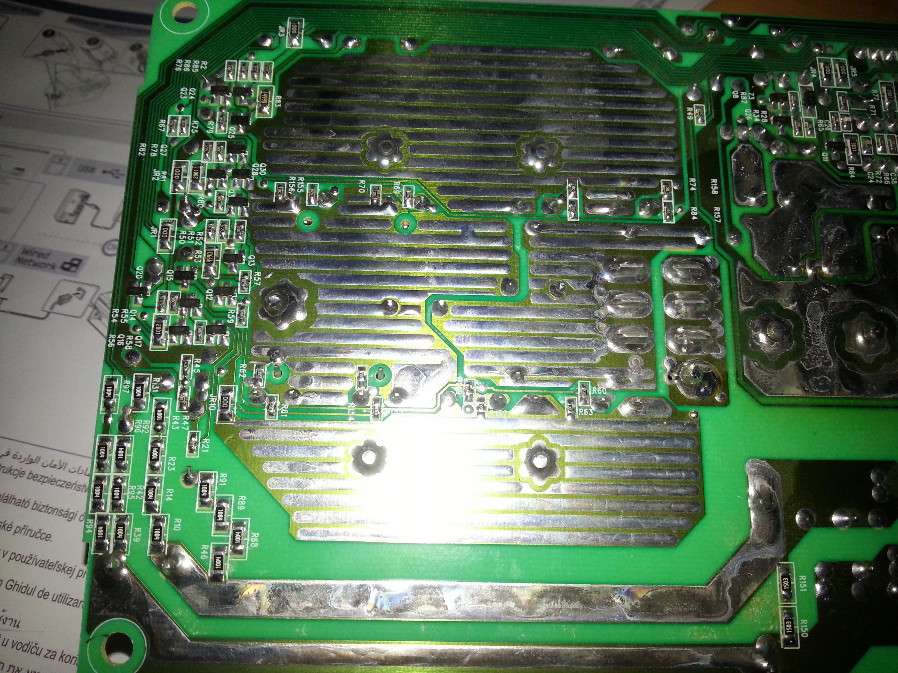

            it's taken some knocks, there are a lot of micro-cracks in the soldering.
              • 31163
              Re: UPS beeping continuously
              btw, after caps, micro-cracks around pins of large or heavy parts or connectors is the most common fault on stuff.

                Not too many large components on this thing...just those FETs. Guess it's worth a reflow nonetheless. Normally, it should fire right up in battery mode when it detects no AC. It could be that it's not detecting the transformer (no AC output), but I don't hear any relay clicking, so that power couldn't make it to that sense resistor network on the right (third photo) even if it DID work...something else is interrupting the "startup" sequence, whatever that might be....

                        That heatsink holds a 12v regulator whose input is in series with that large ceramic resistor....I wonder why a regulator needs such a large resistor on its input. I'll try replacing them - not like I have anything to lose.
                        Relays are good - I tried each of them and they work.

                                  I made another discovery: I did the transformer thing with a series lightbulb and I get 9.5v on the output. Without the bulb I get 12.5v with one pair of primary wires (black and yellow) and 15.5 with the other (black and blue), which makes me wonder how it charges the batteries with that little. Anyway, we can assume the transformer is working.

                                    did you fix the shit soldering yet?
                                    if not then your just wasting your time.

                                      Anyway, I guess I did reflow most of the components. I believe I'm close to tracking down the issue: something's not right in the battery level monitoring - I have no idea ATM how it determines it, but when it DOES decide to turn on, the battery level indicator bars on the LCD display jump up and down randomly before the thing finally shuts down, so it's either a cold joint somewhere still, or a component (resistor?) became out of spec. Trying to track down how it senses the battery level now. Such a pain with these SMD resistors since you can't check them in circuit...

                                        i imagine it's centered around that LM324
