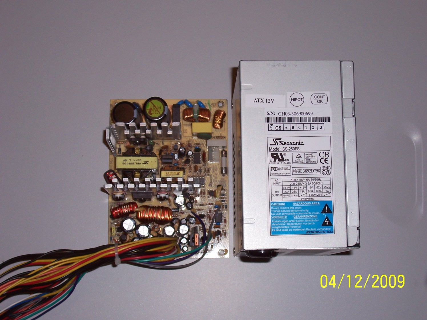

                            Here is a SeaSonic SS-250FS which had 5vsb measuring 12 volts when I got it. Same crappy two transistor design as the Bestec. I gutted the two transistor circuit and replaced it with the same DM311 circuit I put in a Bestec. No more problems with capacitor going HI esr and causing overvoltage.

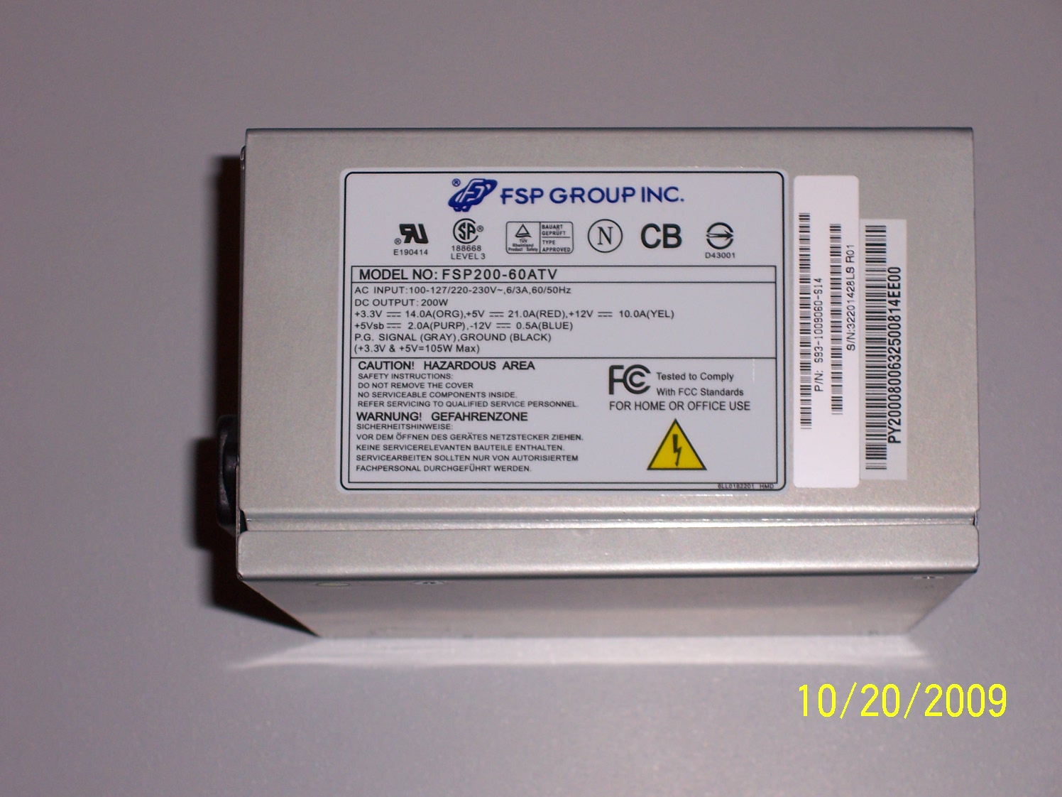

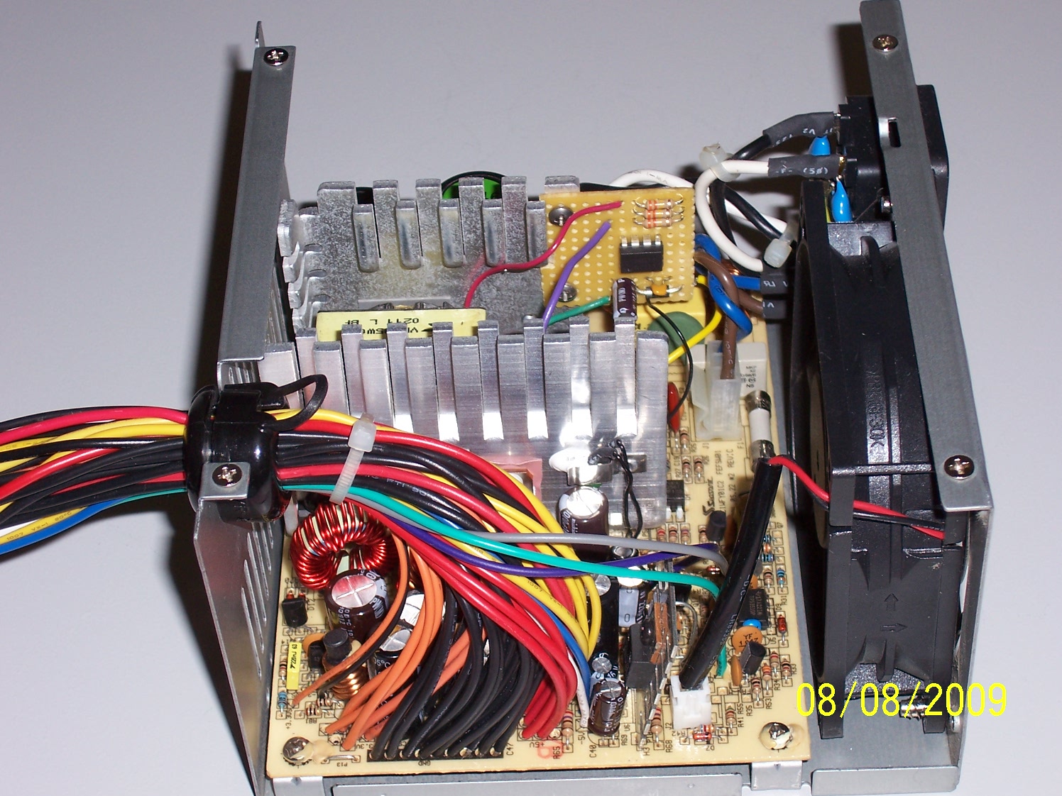

                                      I wasn't too sure how to answer this question earlier, but now can. I have a Fortron FSP200-60ATV which I acquired with a dead 5vsb. See attachment of drawing showing that on the output side of the 5vsb transformer there is a diode rectifier, a zener, and a PI filter consisting of capacitor coil and capacitor. The pc board was badly burned under the diodes, smoke damage and burning of the diodes.
                                      The main diode, marked SD840 is a 40 volt 8 amp Schottky diode. It was shorted. The zener was a 4735 rated for 6.2 volts and a maximum operating current of 146 mA. It was also shorted. Both capacitors were bulging.
                                      When the 5vsb goes overvoltage, the zener will attempt to regulate the output voltage. However, if the two transistor circuit has the power capability to maintain the increased voltage, the zener just works harder increasing its current until it fails. If it shorts, as in this case, all of the power is carried in the diode between transformer and ground. So it also shorts.
                                      Bottom line is that the 5vsb needs something to slow it down and lower that output voltage. A zener is just a bandaid, not a solution to a 5vsb circuit out of control.
                                      Old proverb say.........If you shoot at nothing, you will hit nothing (George Henry 10-14-11)
