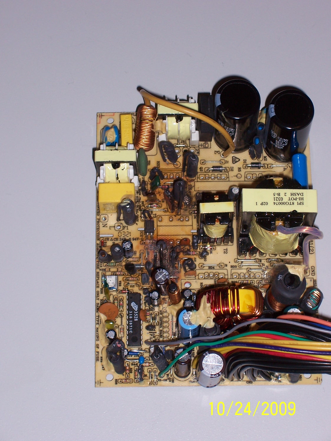

    Re: The whole Two Transistor Thing

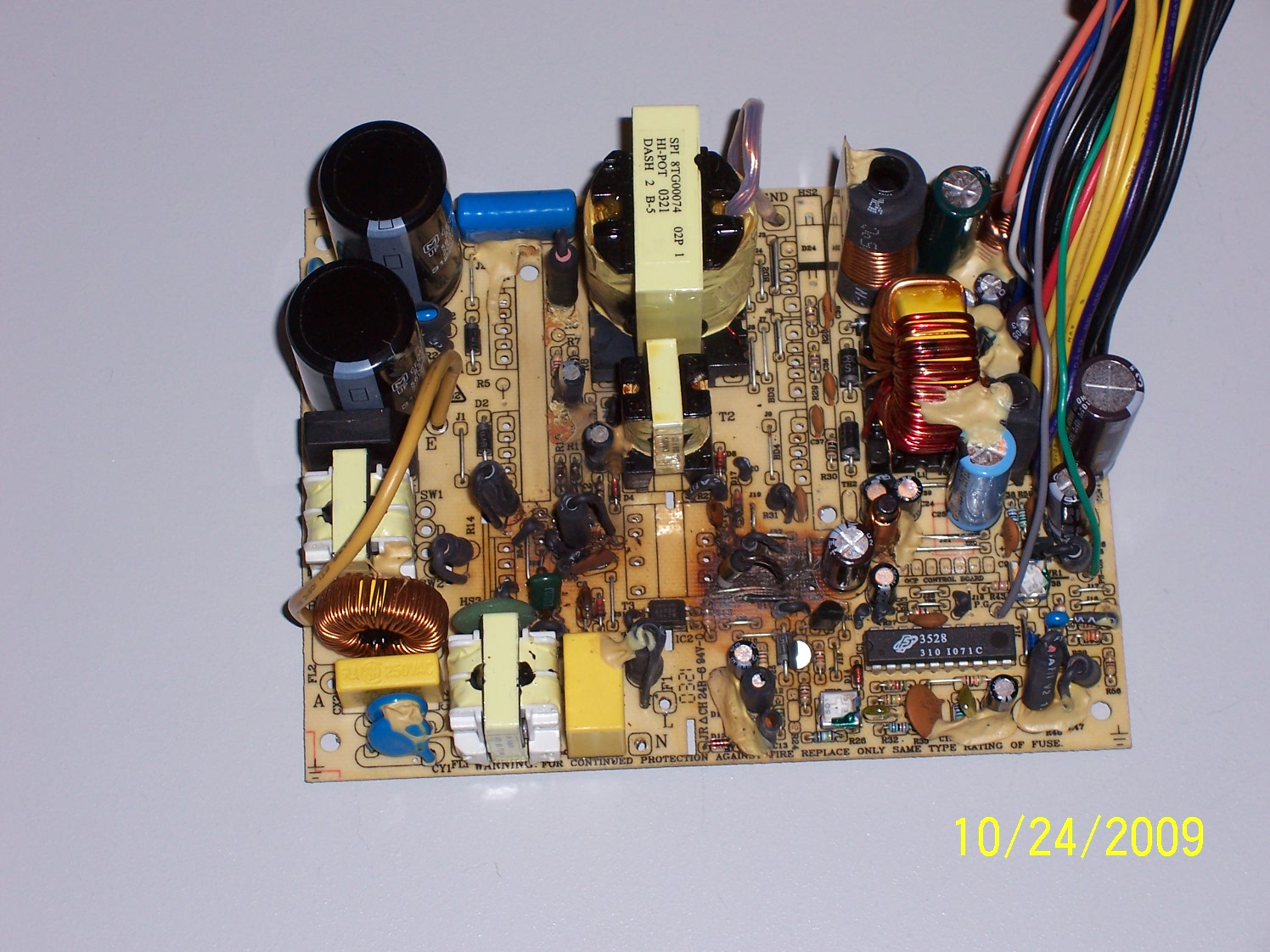

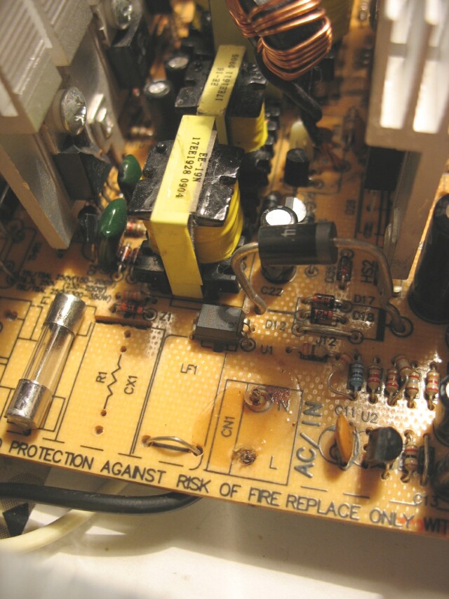

    I attempted repairing the 5vsb - replaced the shorted diode and both bulging capacitors with Nichicon PW caps. I measured the transformer and both transistors. All looked good. So powered it up ... a second or two pause ... then a loud bang with a nice fireball. Both transistors shorted!
    This is why I hate troubleshooting those 2 transistor 5vsb circuits. EVERYTHING has to be just right or else. No telling what other problems were there, and now additional components bad. So I removed the heat sinks and 5vsb transformer to take some photos ..... now TWO burned areas.
    IF I decide to repair this power supply - I will "Bestec" it - that is, gut the 5vsb circuitry and install a pwm chip for 5vsb circuit. Instead of blowing up, they just shut down when there is a problem.
      Wow, too much damaged to PCB and nearby components. :-O
      Once, I was repair Enlight VP-300 in same case, I found LT817C leaked also but after replaced the two transistors twice.

        The pwm chip on this Fortron FPS200-60ATV is marked 3528. This looks like a proprietary part number for Fortron. Does anyone know the generic part number for this chip? I couldn't find 3528 data sheet by googling on the web.

          I suspect there is no OCP on that, considering those open holes on the pcb labeled "OCP control board".

            The OCP control pc board is for the main pwm switching chip - not for the 5vsb circuit which failed. Therefore, when a two transistor 5vsb circuit fails.....it is spectacular.
            If you want a reliable power supply - don't use one with two transistor 5vsb design.

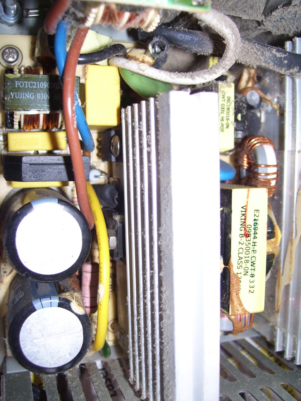

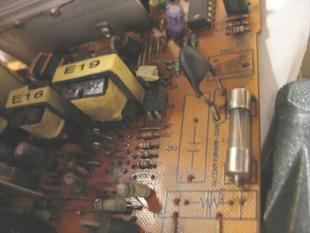

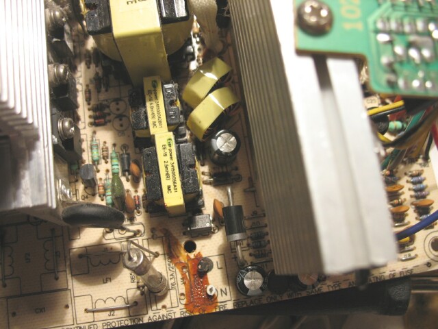

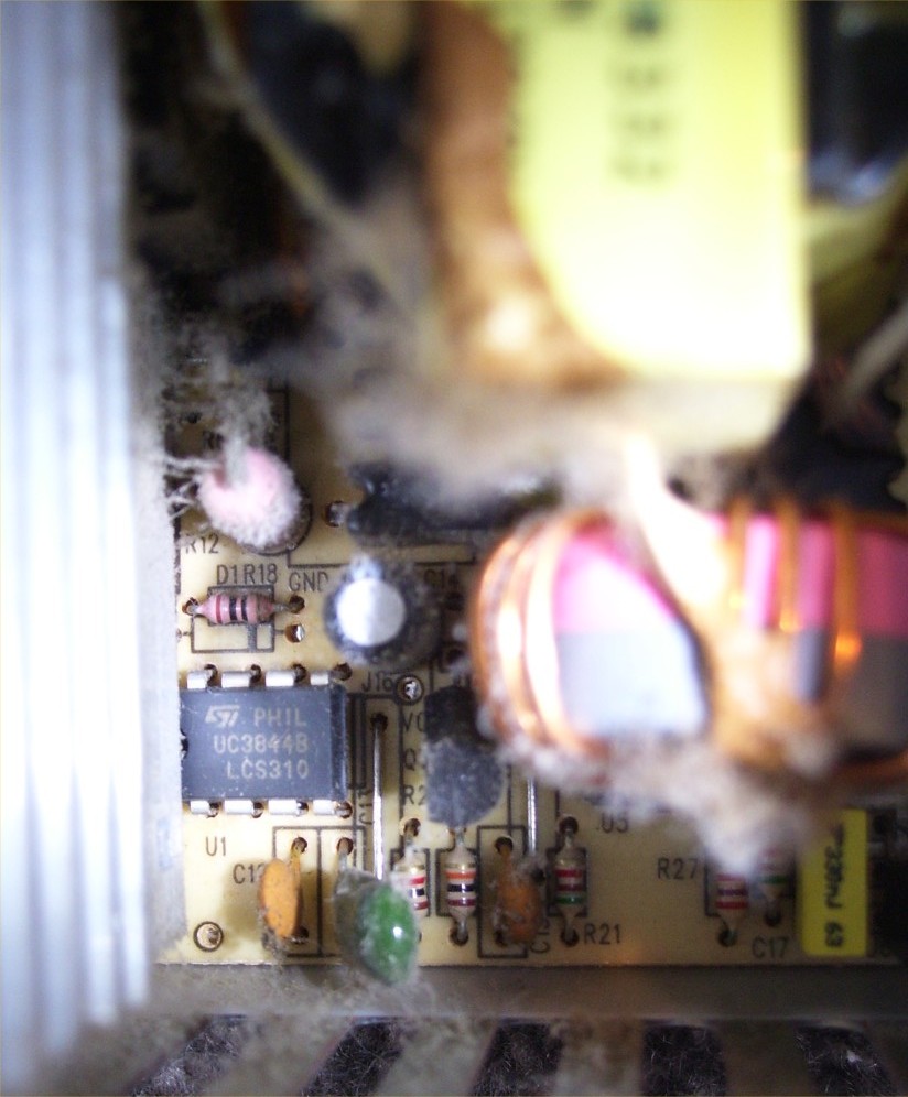

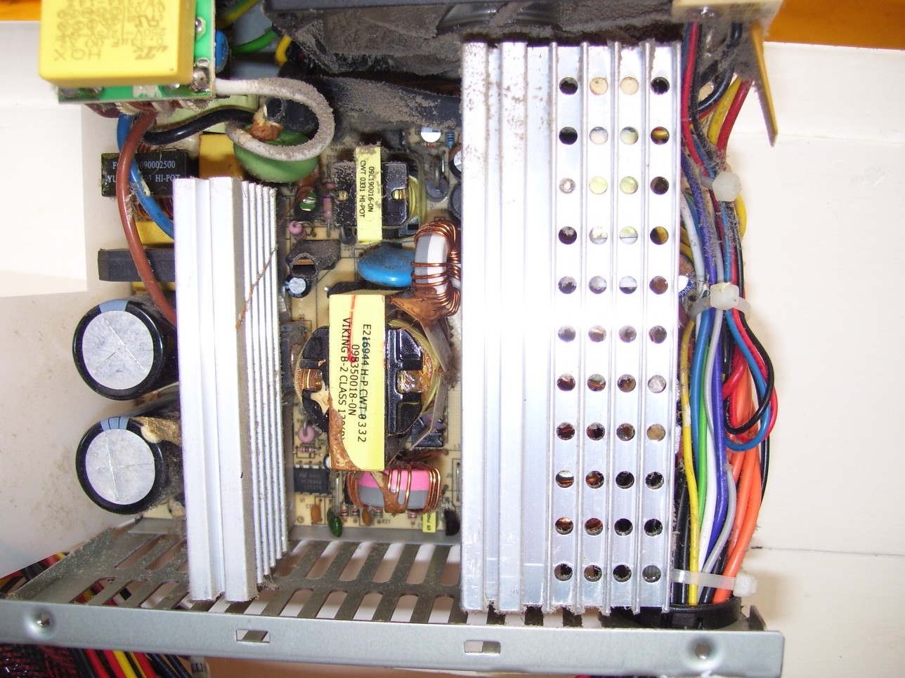

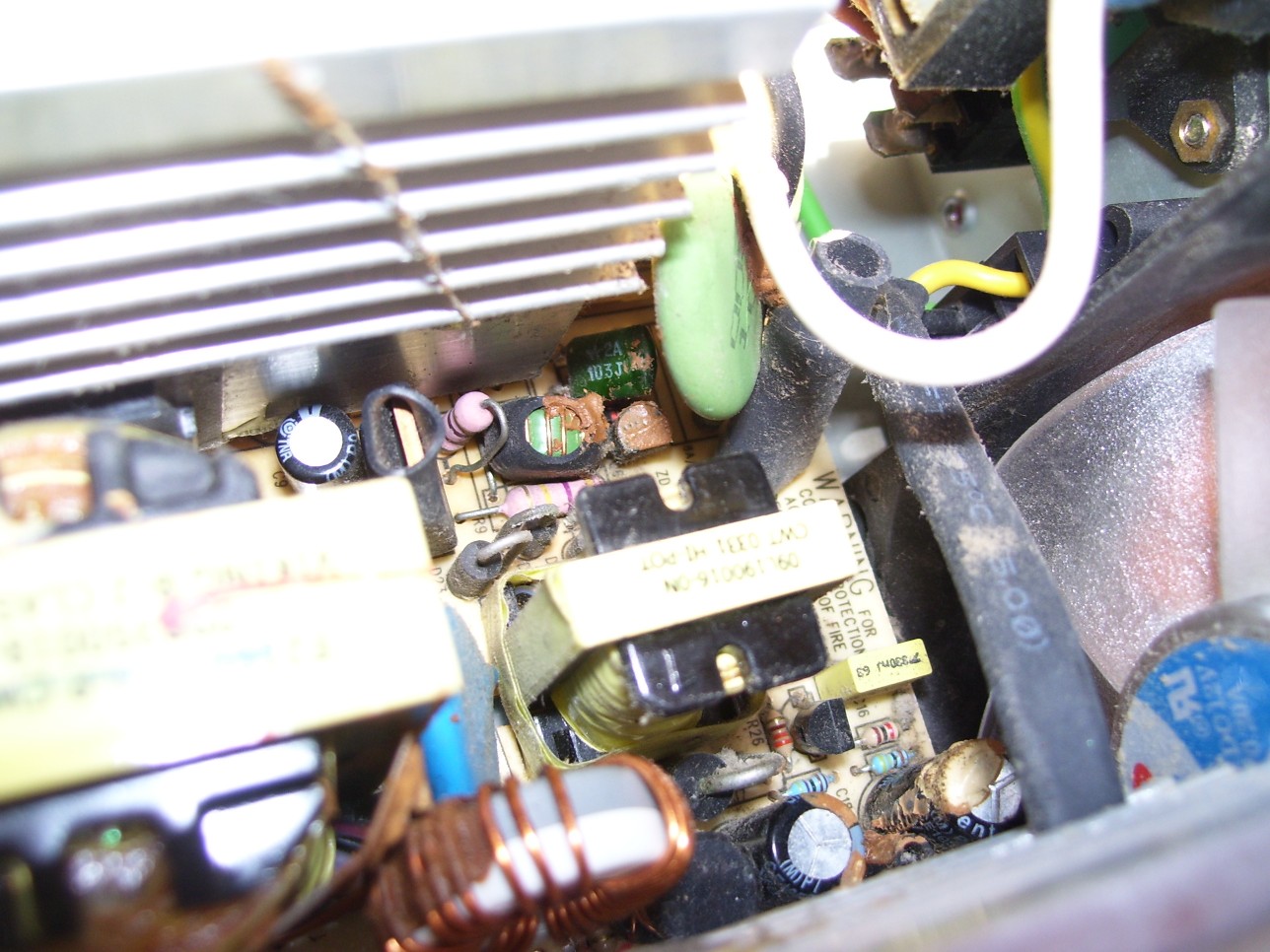

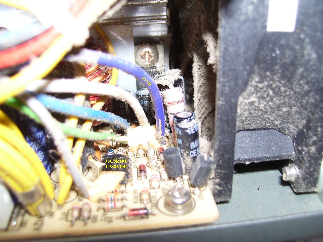

              Was reading through the threads on this fourm, and came across this:
              post #16 shows a seasonic with a couple of 8-pin chips.
              Although i can't completely read the markings the one on the secondary side, they appear to be the same as the ones on my antec true 380s
              The one on the primary side (in between the heatsinks) is
              UC3844B
              LCS310
              The one on the secondary side is
              33C5R1M
              TPS3510P
              Noting that this seasonic is a 2-transistor design and a candidate for a dm311 mod (which is well beyond my current ability),
              Could one safely assume that this antec is also a 2-transistor design?
              Had a decade's use out of this, and all the voltages are still in spec - except for the powergood grey wire, which is 0.05V - shouldn't it be around 5V?
              No bulging caps - there is there is brown/cream glue over, and in between, the 6 fuhyiyya caps under the heatsink)
              The last 2 pics are close-ups of either side of the secondary heatsink near the 33C5R1M chip
                I think I can see a primary transistor there, the one with heatshrink. But try to clean the dust and glue first and take some more photos around the +5 V SB supply.

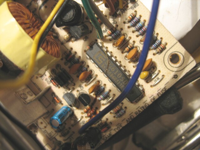

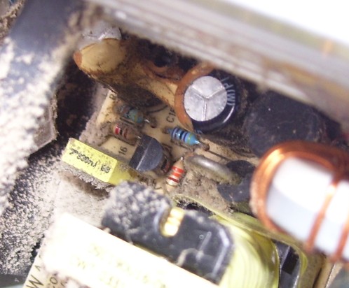

                  On the primary heatsink there is 3 mosfets
                  2 are 2SK2648's, each on opposite sides of the heatsink - they would have to be the primary switching transistors?
                  And the other one (4N60B) is smaller (on the 3rd photo in previous post)
                  After removing the glue, there is seen another transistor (i think you call these little ones BJT's)
                  So there is 3 transistors, and that small mosfet, in that area -
                  the one in the heatshrink,
                  the BJT that was under the glue,
                  the BJT next to the transformer and the optocoupler (you can see the optocoupler in the first photo in previous post),
                  and the mosfet on the heatsink
                    The 4N60B is the first transistor of the circuit, you can tell right anway from the small current (4 A) it can handle, it cannot be used for anything else.
