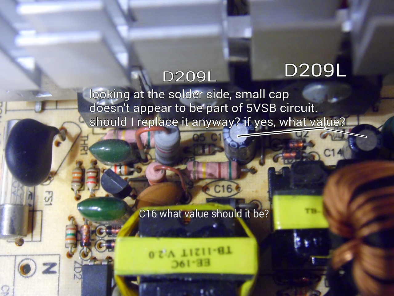

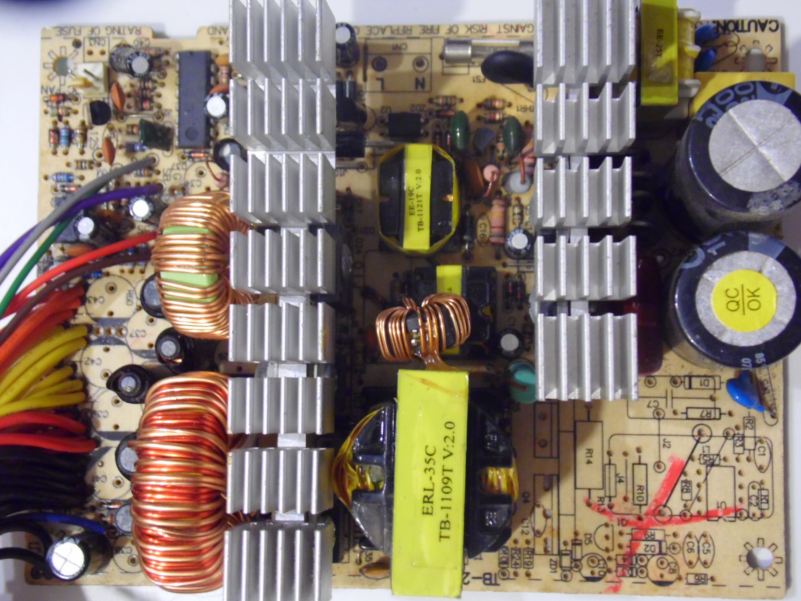

    I have been given this EZ-Cool ATX-650 JSP. I don't believe that it is actually capable of 650W but it seems reasonably well built with a decently sized transformer and heatsinks.
    Please see photos before reading further.
    I have removed all the output caps and labeled where they go and some other things in the photos.

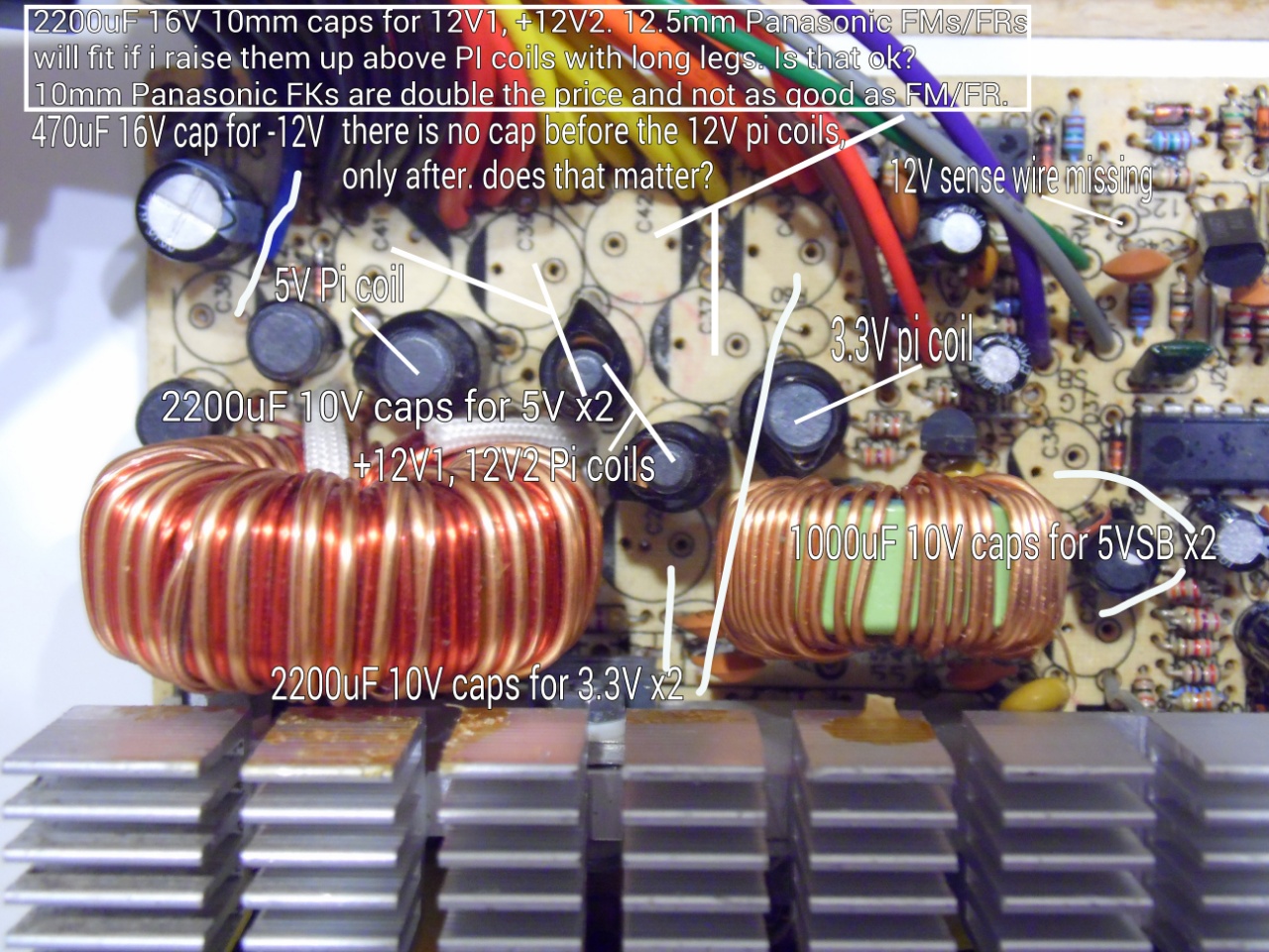

    The 5V and 3.3V output caps were all 2200uF 10V fukyuu's and were visibly bulging. I intend to replace these with 10mm 2200uF 10V panasonic FRs.
    It has 2 12V rails each with its own pi coil and output capacitor, which are 10mm 2200uF 16V Gi LOWRSR 105C 07B. They are not bulging and test OK on my ESR meter with 0.04ohms ESR. I have never heard of Gi capacitors before. Are they any good? Should I replace them anyway. The only 2200uF 16V 10mm caps that i have found are Panasonic FKs but these are over £1 each. I think I could manage to fit the better 12.5mm 2200uF FRs or FMs here if I raised them up above the pi coils with long legs but would that be ok?

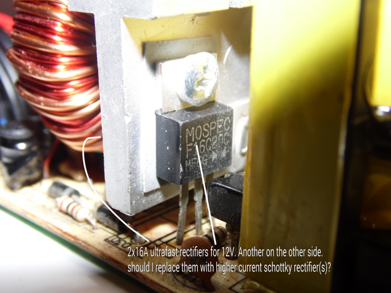

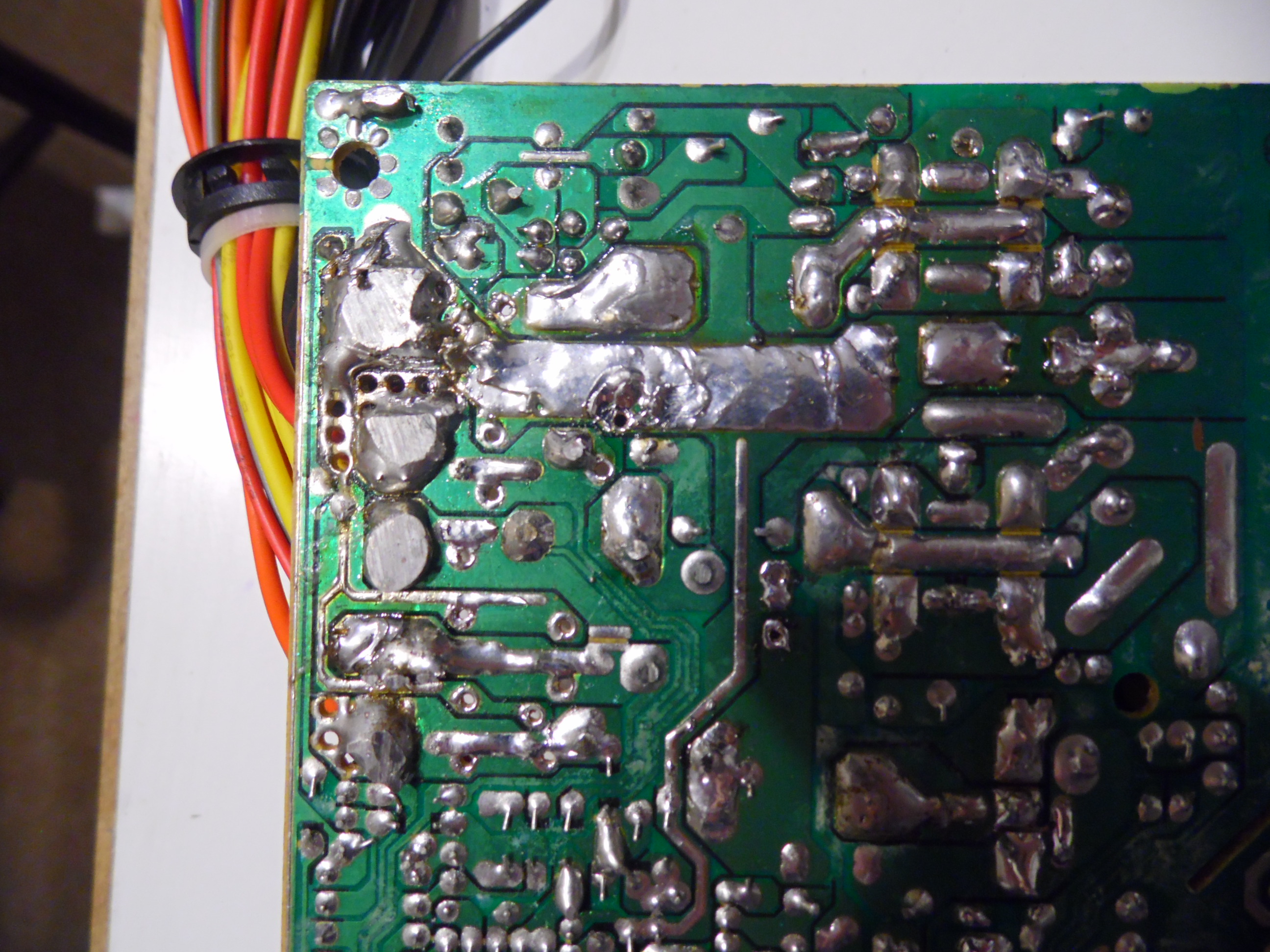

    The 12V output is rectified by two MOSPEC 16A ultrafast To-220 rectifiers in parallel. Should I replace these with Schottky's or will the existing ones be good enough.

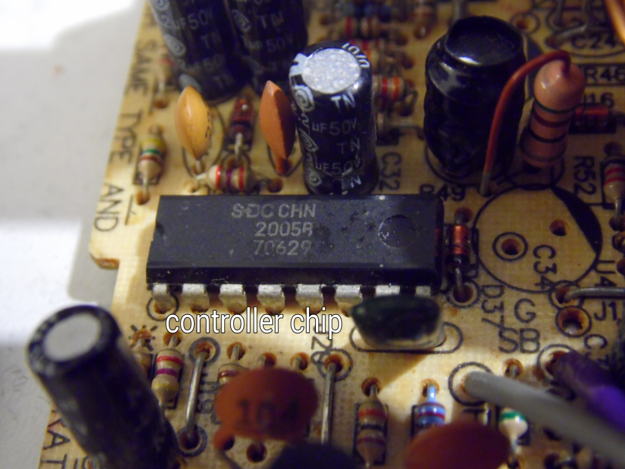

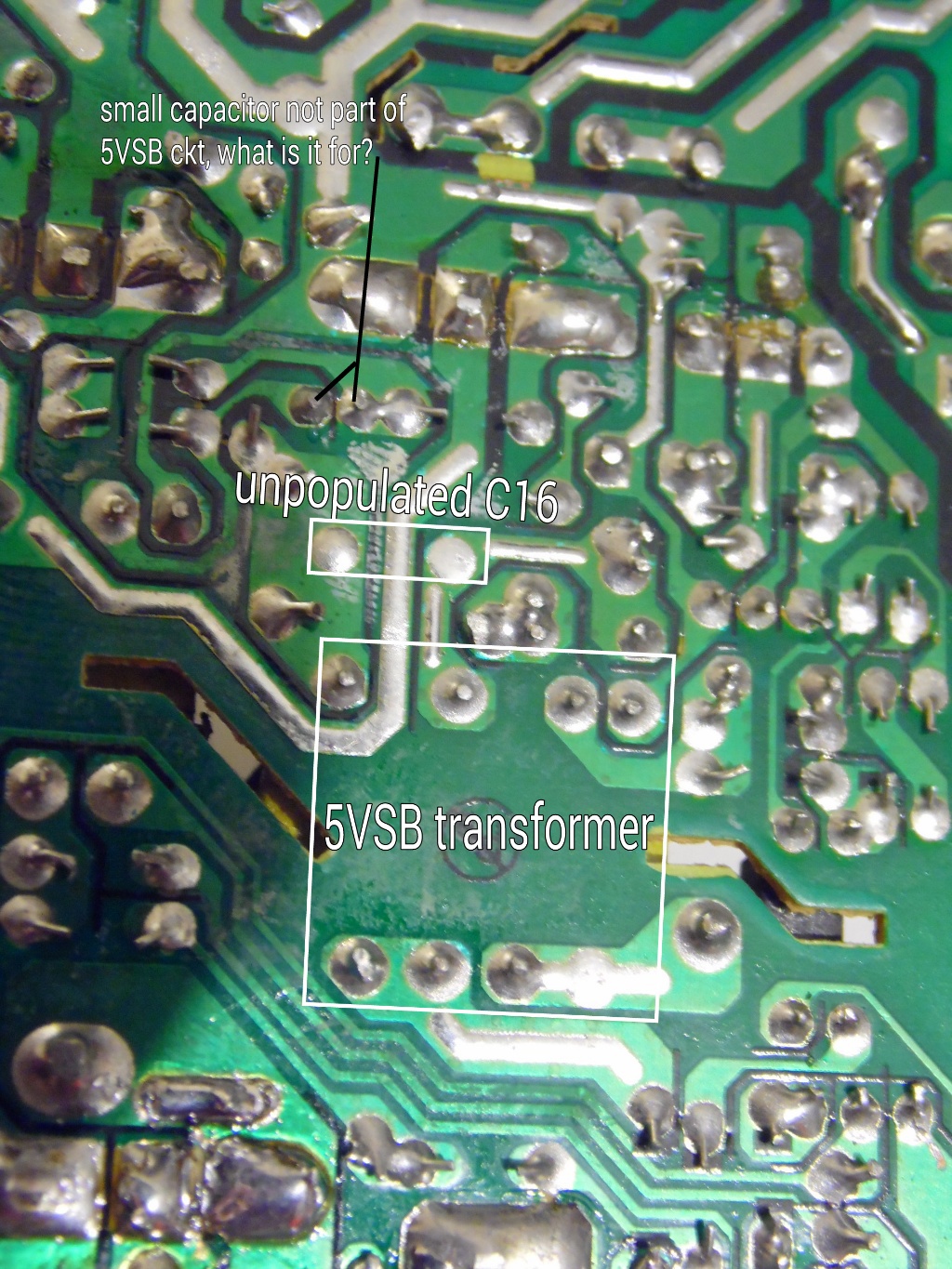

    The 5VSB circuit uses the 2 transistor design but doesn't have the critical electrolytic cap that causes the output voltage to go high. There has not been any excessive overheating.
    The output caps were 2 1000uF 10V fukyoos, which were not bulging but I'm going to replace them anyway with 1000uF Panasonic FRs.

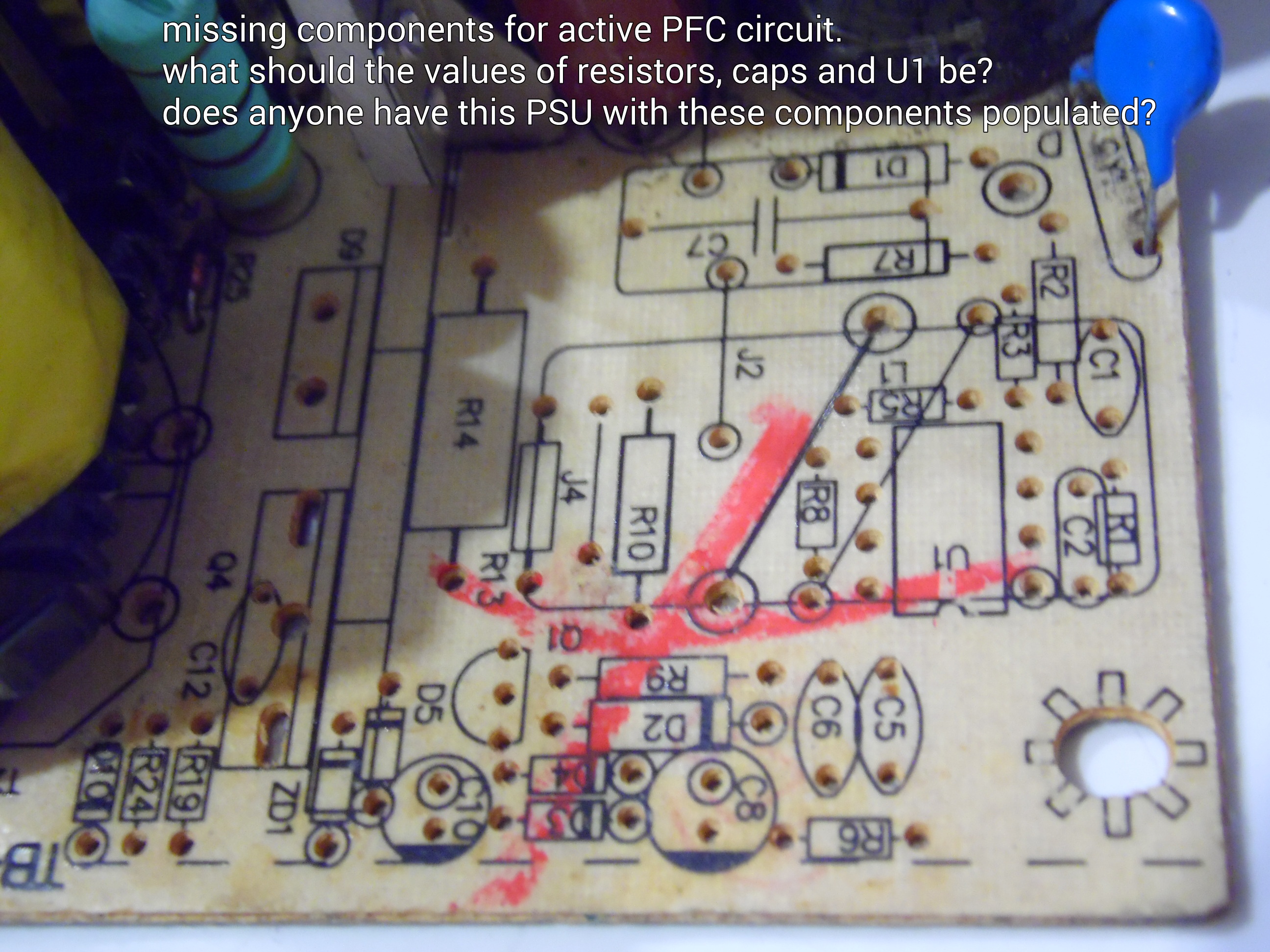

    There is an unpopulated area on the PCB for an active PFC circuit. I would like to add this back if possible.
    I would need the values for the resistors, caps, zeners and the part number for U1. In this place is a passive PFC choke that is screwed to the case. Does anyone have this PSU with the active PFC circuitry populated and could tell me the component values?

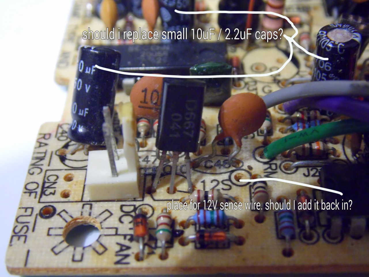

    Should I also replace the small 10uF and 2.2uF caps?
    The primary switchers are 2 D209Ls in half bridge configuration. I think equivalents would be MJE13009's?

    12v sense is optional in ATX spec, so it's ok to leave it out.
    Measure the voltage drop to get an idea if it would help to add it, might be more parts missing.
    On 12.5mm caps on extended legs: don't do it: the ESR will be affected.
    As you have already measured the current caps to be ok just leave them.
    As for the small caps always replace them in a power supply, otherwise it's better to do nothing with it.
    In most cases they are either critical for the 5VSB section and/or critical for the driver chip.
    On the APFC why would you add it?
    The only sensible case for an end customer is if you use a UPS, then it will present a lower VA load.
    Otherwise it will just be a downgrade because private citizens don't pay for apparent power, only real power.
      Just like the Fuhjyyu caps, they are certainly not going to be high quality reliable parts. As to whether to replace them or not... that depends on what you intend to use the power supply for and how much you value it overall. If the PSU will be used just for the occasional motherboard test, you probably can leave those Gi caps until they go bad (they will eventually, but it might be a while before they do). However, if you intend to give this to a customer or someone who needs their PC working reliably, then it's better to replace them.
      Other options for 16V, 2200 uF caps in 10 mm diameter are United Chemicon KYB, IIRC.
      Otherwise I agree with what Per posted: don't install caps with long leads, because that will affect the circuit ESR. That said, there is a trick I sometimes use when installing 12.5 mm caps in spots for 10 mm ones: if the space is tight but not too tight, you can install the 12.5 mm caps with slightly longer leads so that they are just 2-3 mm above the PCB. Then, bend the leads in such a way that allows the 12.5 mm cap to fit in. Again, obviously this won't work if the space is too tight. But if you have very close components on one side of the cap and a little bit more space on the other side of the cap, you can use the above trick to fit 12.5 mm caps.
      In general, Schottky rectifiers will give you better efficiency. They will also raise the 12V rail's voltage a bit, which may be helpful when the PC is used in a system that draws power primarily from the 12V rail (i.e. pretty much all computers since 2004-2005).
      That said, because this is a half-bridge PSU... you may also encounter problems with the Schottkies on the 12V rail (generally due to slower recovery time.) Also, if you happened to use this PSU on an old PC that draws power for the CPU from 5V (like a socket 462 motherboard or some socket 478 boards), the 12V rail with the Schottky diodes could go too high (out of spec).
      So all in all, using Schottki diodes on the 12V rail on a half-bridge PSU like this is a bit experimental. Nevertheless if you do, make sure your Schottkies are rated for *at least* 100V reverse voltage. Also, if you go with Schottkies... there's no point in using two smaller ones in parallel. Just use a bigger single one. Something rated along the lines of 30 Amp, 100V should be plenty.
      Always a good idea.
      Don't bother.
      Your power supply will be much more reliable with the passive PFC coil you have there right now. It also doesn't decrease the efficiency as much as Active PFC does. (Yes, APFC actually decreases efficiency on the customer side).
      The only benefit true benefit from APFC is universal input voltage (typically 90-250 V AC) - this can be helpful if you live in a country with 220/230/240 V mains that has the tendency to go low from time to time.
      The other not-so-important benefits (to the customer) of APFC is low line harmonics, which only matters if you live in a place where there are only a few central step-down transformers in the city/town/village, and most of the power to the houses is directly carried on 220/230/240V lines. APFC also makes the PF close to unity (1), which can matter if you run 100's of these PSUs in one room.
      But like Per said, for a customer's PSU, you don't need APFC. And I can tell you for a fact that PSUs with no PFC or only PPFC are much more reliable in the long run over their APFC counterparts.
      Yes.
      They are also usually pretty cheap, so no reason not to.
      Yeah, this is definitely NOT a 650W power supply.
      Probably 400 Watts continuous at best, and maybe 450 W peak. I suggest keeping the load under 350 Watts to be safe. Reason being is the label looks pretty sketchy. First giveaway is the lack of "combined" power draw from all of the rails. Then there's the agency approvals: none of them look legit. Given the trace spacing on the solder-side, I doubt this PSU will pass UL and CE safety standards, let alone S/N/D/FI, which are even more strict.
      Also, apparently your -5V rail is capable of 18 Amps! SWEET!
      But in all seriousness, the biggest show-pooper is probably that 18 Amp rating on the 12V rail, which means you'll have only about 216 Watts of power for a modern PC. So if you have a dedicated GPU in your system, check its TDP before using this PSU. For safety margin, the combined TDP of the GPU and CPU should not exceed 200 Watts. And that's only if the PC has 1-2 HDDs. If you have more HDDs, further drop the combined power for the CPU and GPU by approximately 10W per HDD.

          I will replace the GI caps. I may be able to fit 12.5mm FR caps in without extending the leads too much if I adjust the pi coils and other caps a bit .
          If not I'll have to use Panasonic FKs as Farnell don't stock chemicon KYBs.
          I don't trust chemicon caps anyway as I've replaced bulging ones before on motherboards.
          Never seen a bad Panasonic.
          I have a whole drawer of TO-247 Schottky's taken out of PSUs that were used for the 5V output.
          I'll check the data sheets to make sure they are rated for at least 100V (why?) reverse voltage and 30A .
          I will replace the small caps too. It already has a PPFC choke (not pictured) so I won't bother with APFC.
          As you said - its not necessary and i don't know the component values anyway.
                Sounds like a plan. I too have "adjusted" components around in the past to get bigger caps to fit. Just when you're done installing the bigger caps, make sure there is no excessive pressure on the leads, as that can cause failure over time. For example, if a cap is really tightly soldered down to the PCB and there are wires near the cap that tug on it, they may eventually snap the lead connections inside the cap. Likewise, if you have to push your cap(s) hard to get them to stay where you want them, that too can make them fail.
                So make the space for the bigger cap(s) and make sure it fits there easily before soldering it down.
                Those would be their KZG series. They had a ton of problems with those up to 2008 or so, along with a few other ultra-low ESR series that were again only seen on motherboards (like KZJ).
                However, their KY, KYB, and KZE series are absolutely fine. Many PSU manufacturers use them and they simply don't fail unless heavily abused past their specs. The LXZ, LXV, and LXY series are another choice. These are not as low ESR as teh KY, KYB, and KZE, but they've been out for a long time (since the early-mid 90's) and proven themselves over the years. So I wouldn't discredit the whole brand just because of a few bad motherboard series.
                Though you're observation about Panasonic is correct - they indeed appear to have the best track record when it comes to reliability. All the other Japanese brands have had at least one or two series with some sort of problems (with Nichicon, it was HM, HN, and HZ from 2001-2005, and some of their old PSU-grade series such as PR often leaked from the bottom; Rubycon MCZ series are sensitive to heat; and Sanyo WF and to some extend WG, appear to have similar problems as Chemicon KZG).
                If they were used on the 5V rail, they are very likely only rated for either 40 or 45V.
                The reason for the 100V rating is because half-bridge, push-pull, and full-bridge PSU topologies (i.e. ones where you have a center-tapped transformer output) will usually have 2x higher voltage on the rectifiers than what single and double-forward topologies do. So as one side of the rectifier sees a positive voltage square wave (and rectifies it), the other will be seeing the same square wave, but with negative voltage. And because the Cathode-side of the rectifier is already connected to the 12V rail (i.e. 12V DC above ground), the difference between that and the negative square wave will be 12V + the absolute voltage value of the negative square wave. You might think that's only 12V + 12V = 24V, but it's not. You also have to factor in that PSUs function on the principle of PWM, so the +/-square waves will not have a peak at 12V. It's going to be more like 15-30V, depending on the PSU design. If it's closer to the latter, each diode in the rectifier could be seeing up to 12 + 30 = 42V reverse voltage. And if you ever looked at a square wave on an oscilloscope, they always have little "ears" near the edges. These "ears" can present voltage transients of another 2-5V. Add everything up, and you'll be looking at over 45V reverse voltage. Hence why a 45V part CANNOT be used.
                The next higher voltage for rectifiers is typically 60V, and some half-bridge PSUs actually do use a rectifier with that voltage rating for their 12V rail(s). Bug again, depending on design, some PSUs will not be happy with a 60V-rated Schottky either. This has to do with the reverse-recovery time. Ultra-fast (i.e. not Schottky) rectifiers can recover from the reverse voltage very quickly before they conduct again and vice-versa. Schottkies are slower, and when you use them near their maximum rated voltage, that can make then perform even worse.
                So for this reason, if you see a half-bridge (or other center-tapped topology) PSU with rectifiers on the 12V rail rated for 100V or more, then your replacements should also be rated for 100V or more.

                  That said, I noticed the +12V rail uses two parts in parallel: this will not necessarily result in double the rating either, because they are in parallel, they may experience (if not properly cooled or coupled) a phenomenon known as “thermal runaway” where due to differing voltage drop characteristics (ever so slightly as no part is exactly the same), one diode package may be conducting more current than the other, which will cause one to run hotter than the other which will further lead to the other part dissipating even more heat, resulting in a cascade effect that will eventually cause at least one of the parts to potentially burn out. So two 16A parts, even in half-bridge topology, I would not consider the same as a single 32A part: more like 20-24A.
                  Of course, there are several other factors besides the rating of the output diodes that limit the output current rating as well - the width of the PCB traces, the main transformer, the output toroids (this PSU appears to use -52 material for the +3.3V coil, which is good because it’s more efficient than the older -26 material), the actual gauge of the output wires, etc. I think the manufacturers possibly take all those facets into mind when determining the final rating on the label... at least the PSU manufacturers who are honest.
