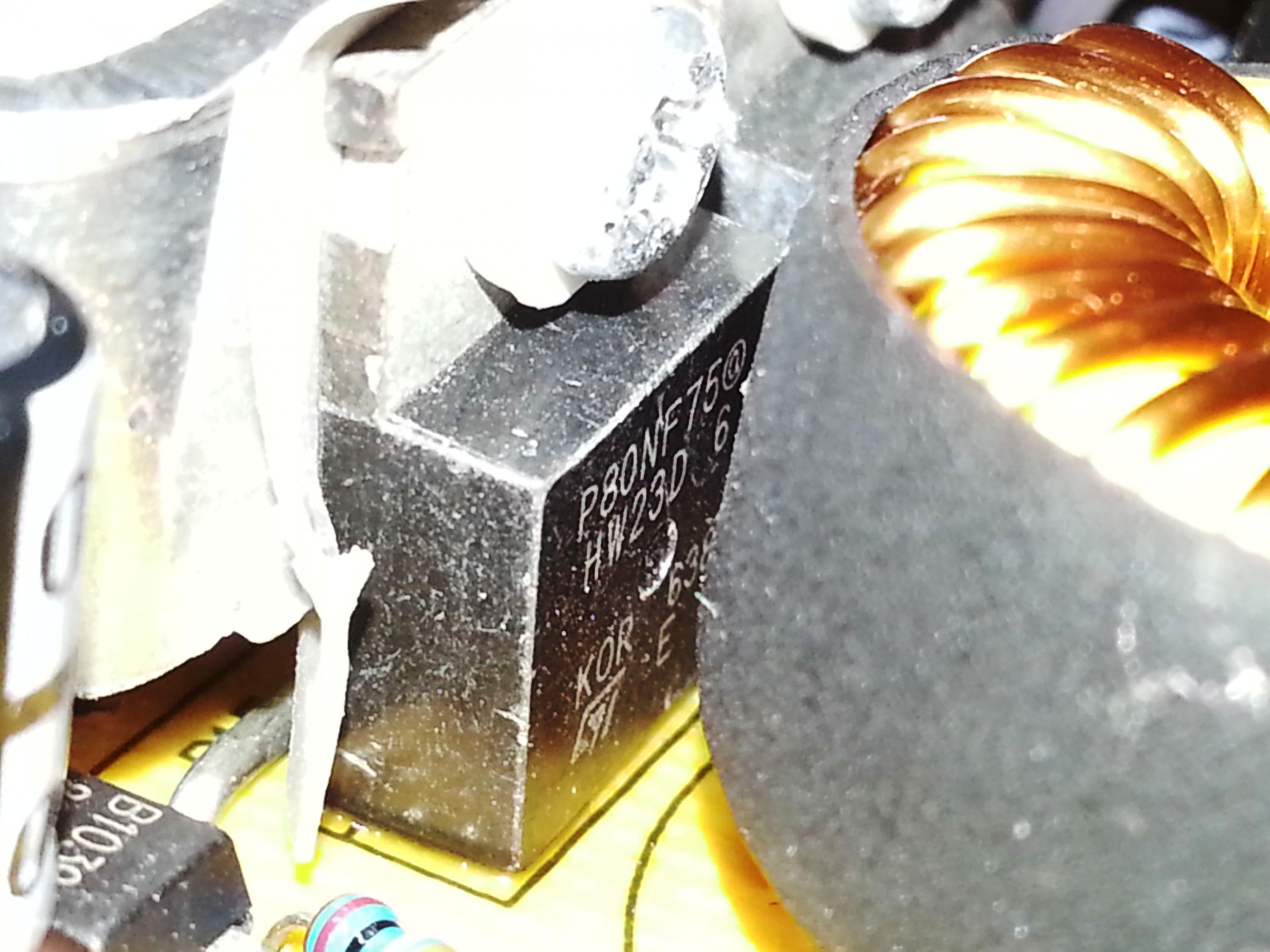

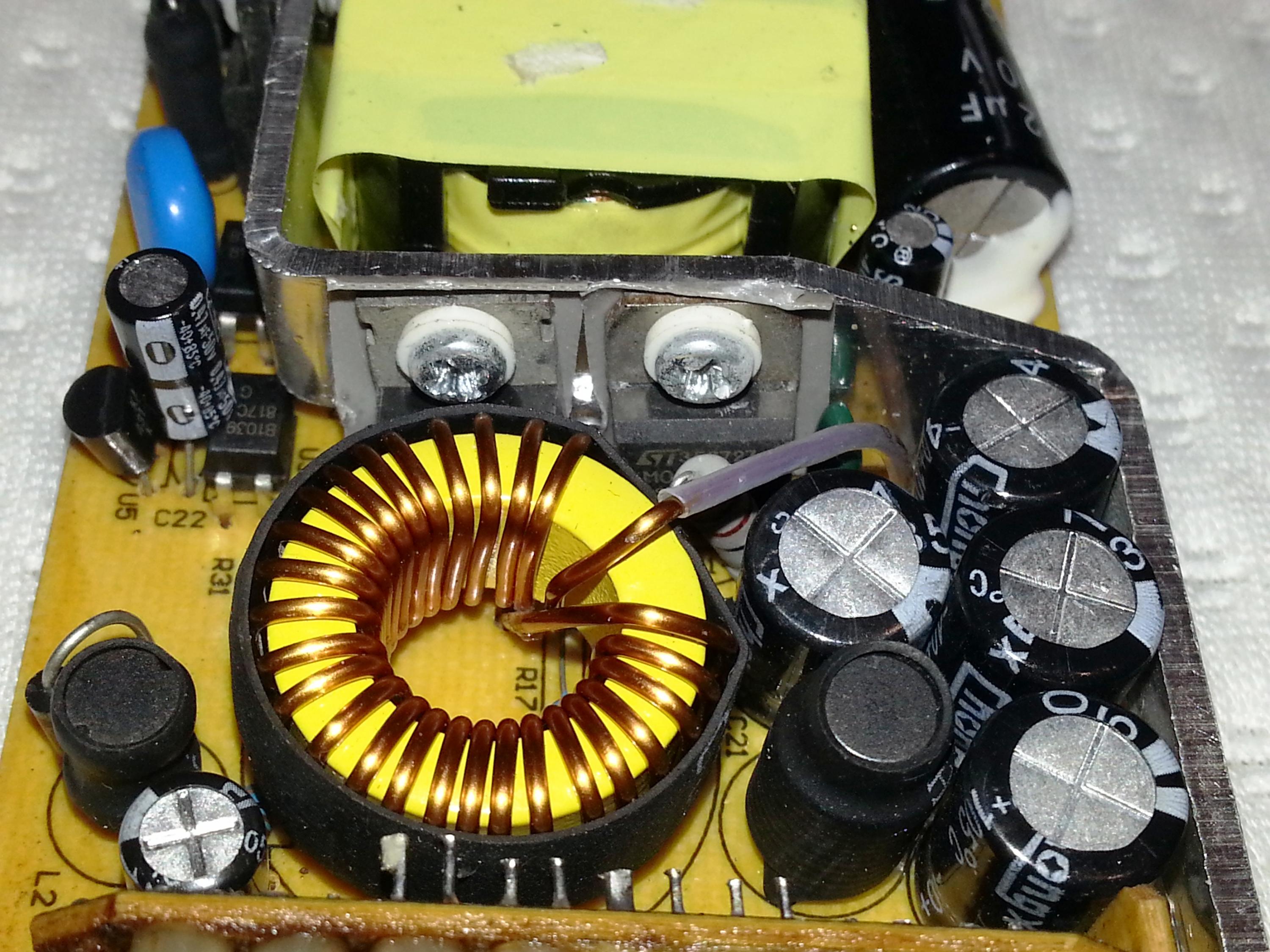

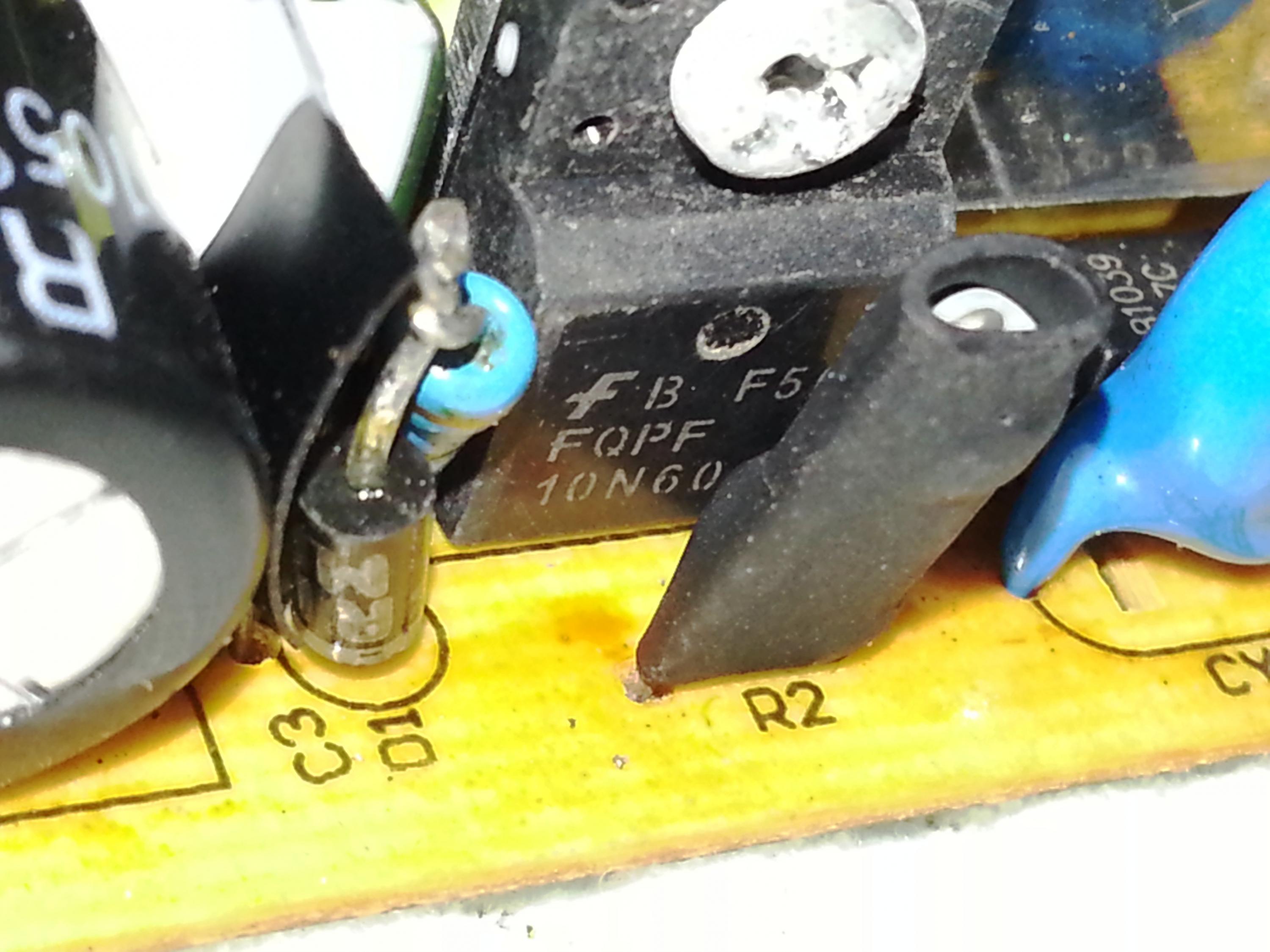

        • Romania
        Re: SMPS output power upgrades and limits
        Here's the brick in question...you're probably seen these before....the soldering is pretty piss-poor on some of the components on the back. It gets the job done at least.
        There's two transistors: one on the primary and one on the secondary, plus a diode next to the one on the secondary. From what I can make out, when plugged into the mains, it operates like a regular SMPS: the primary transistor runs the transformer which is then rectified and fed to the output. When powered from 12v, it operates in a boost converter configuration using the transistor and the coil on the secondary side. I don't know what would happen if you hooked up BOTH the mains and the 12v input A resistor network switches between the different outputs. Pretty cool idea...I like it actually. Very hackable too, like if I wanted different voltages, I could hack that resistor divider to get whatever I want, maybe with a pot or a trimmer or something. I already did this with a cigarette socket mobile phone charger and turned it into a temperature controlled driver for a fan: by using an NTC in place of one of the feedback resistors, the output voltage would go down/up depending on the temperature, but I digress
                  Originally posted by stj
                  i would say the bottleneck is when the transformer saturates.
                  ^ That.
                  Also, for PC ATX PSUs, especially the cheaper ones, the size of the output toroid and size/capacity/count of output filter caps are another two factors. After all, who cares if your PSU can output XX Watts of "raw" power if the output ripple will be so terrible that it kills all of the attached components to it or makes your system crash.
                  i would also say that most psu's are already running on the limit for cost reasons.
                  Either that, or crappy APFC circuit designs are making everything run marginal.
                  Regarding that universal power adapter:
                  You have one heatsink for the primary and secondary-side silicone. This is a *terrible* idea, especially with the way it is running close to other primary components. Basically, the isolation of this adapter (if you can even call it that) is absolutely marginal, if not outright dangerous.
                  In terms of limits, that would mostly come from the transformer size and also the power dissipation from the rectifiers and primary-side MOSFET. With bigger heatsinks and/or active cooling, you may be able to push more power, but who knows how much before that transformer saturates.
