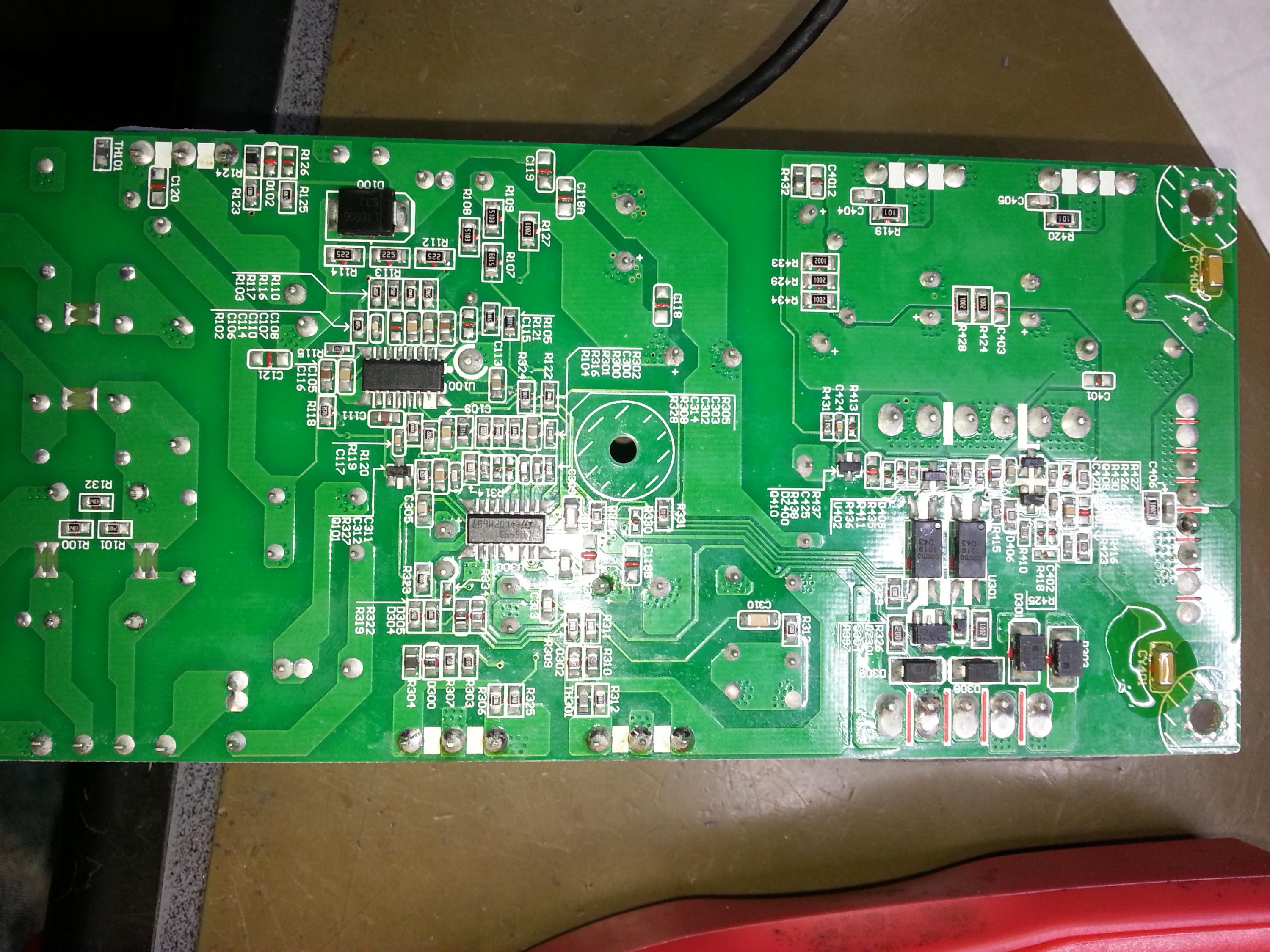

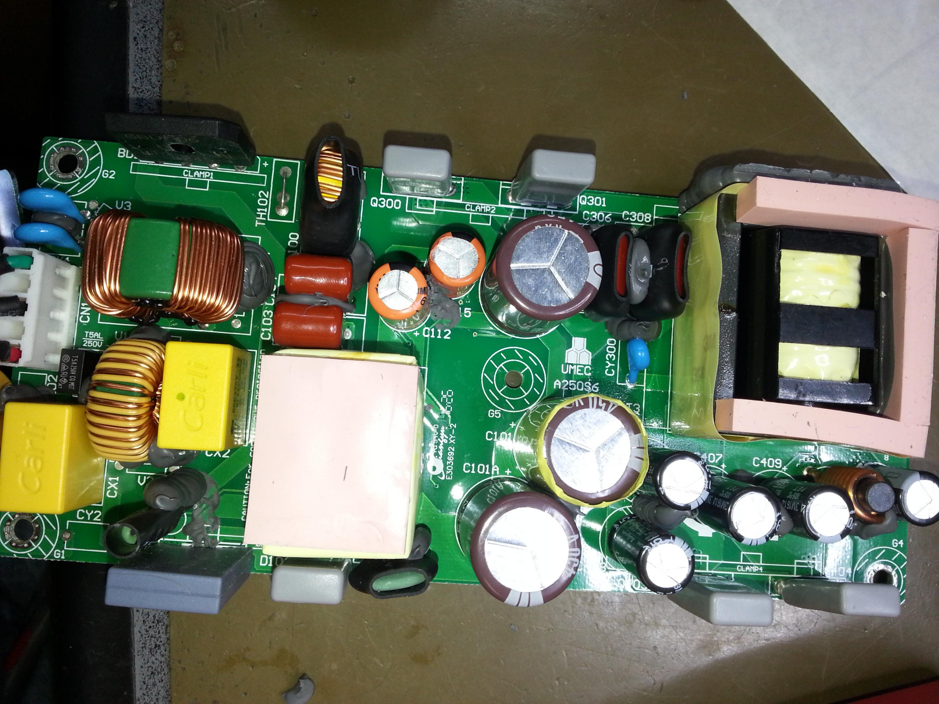

    Good day folks. I'm trying to figure out what's wrong with this power supply. It's from a barebone PC/POS thingy, NVM. It's supposed to be on all the times: just a single output - no ON/OFF control or anything. I tracked the problem down to the two control ICs on the back not receiving the correct supply. They're an NCP1605 (U100 on the left, for PFC I reckon) and L6599 (U300 on the right) for the main switching action....the VCC pins are common and get around 7v, which is not enough. I tracked VCC down to Q304 of which I took a close-up....DQ QZ....what could this be ? Could it be one of THESE ? At the bottom we have 2SD2211. The package and pin layout corresponds and would technically make sense: the VCC pins go to the left terminal (bottom one in the picture - the emitter, "output" let's call it) and then the tab (center contact) goes to those diodes, which would make it the "input" collector. The remaining pin (top one), is connected to that zener diode and the top optocoupler, so that would be the base.
    Now the VCC for those IC (and therefore the bottom pin of the IC) jumps around between 7v and 14v, like it's trying to start up but fails. Measuring those two diodes (D309 and D308) gives me 7v, which I'm not sure is enough.
    No schematic and a truck load of SMDs....it's like tough sh!t It's be really awesome if we could get it going.....any ideas ? Cheers and thanks. No blown stuff on the board BTW, of course....
    Wattevah...

    UPDATE: removing the NCP ic completely results in that oscillating voltage disappearing completely for some reason...it also seemed to get quite warm...thinking of replacing it.

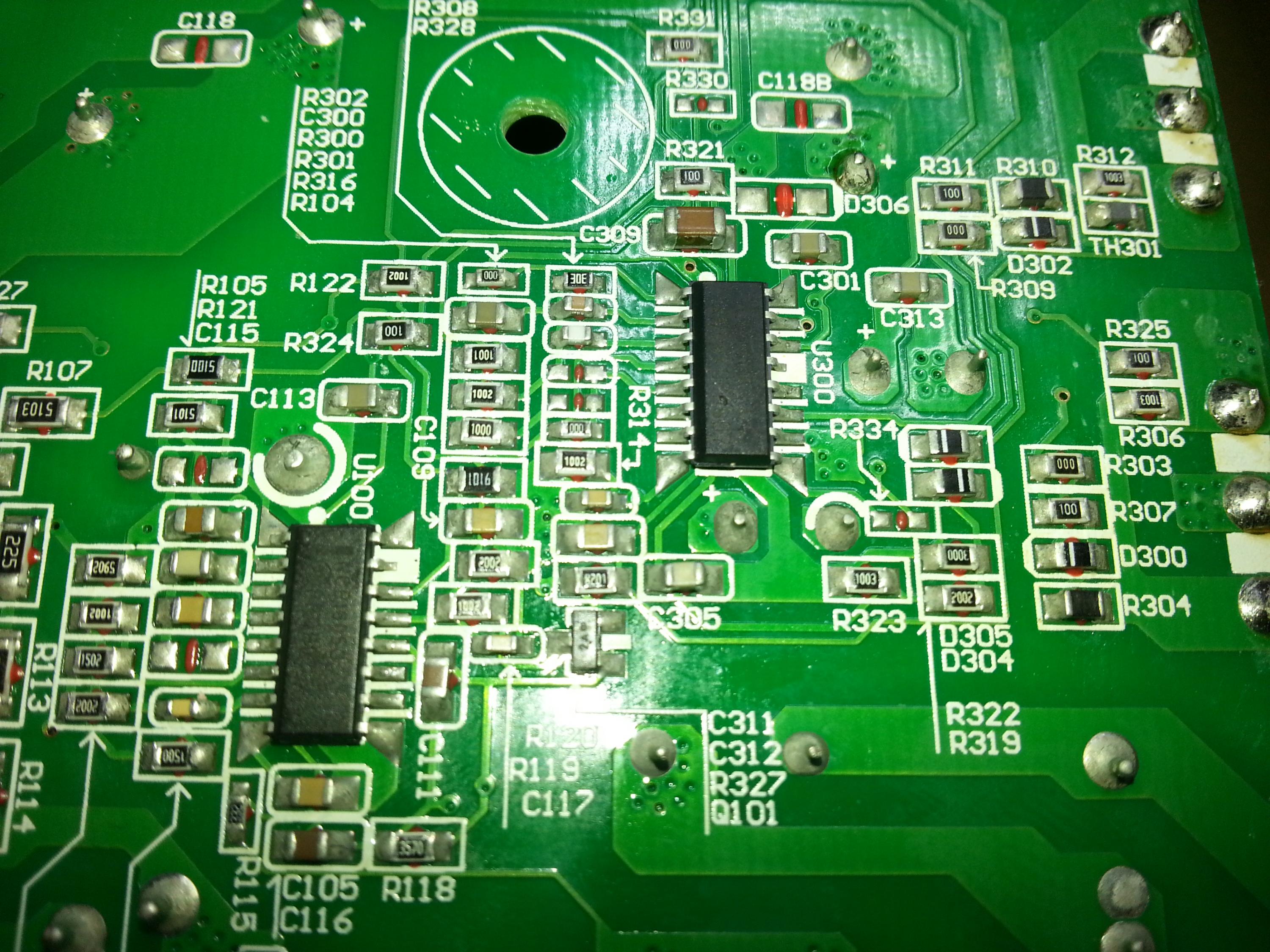

      When thes supplies try and start like that usually indicates a bad cap. There should be a winding from the transformer that feeds a resistor, diode and then a capacitor that supplies the run vcc for the ic's, if this cap is bad the voltage never comes up and the supply oscillates. They are likely one of those orange caps.
      The ic has a built in regulator that takes the main B+ (300v) and supplies the startup of the ic, this will pulse the transformer which will generate the run vcc to keep the ic's going
      If you check the schematic for the L6599, the cap is listed as C24
      When the supply is pulsing is there any secondary voltage at all?

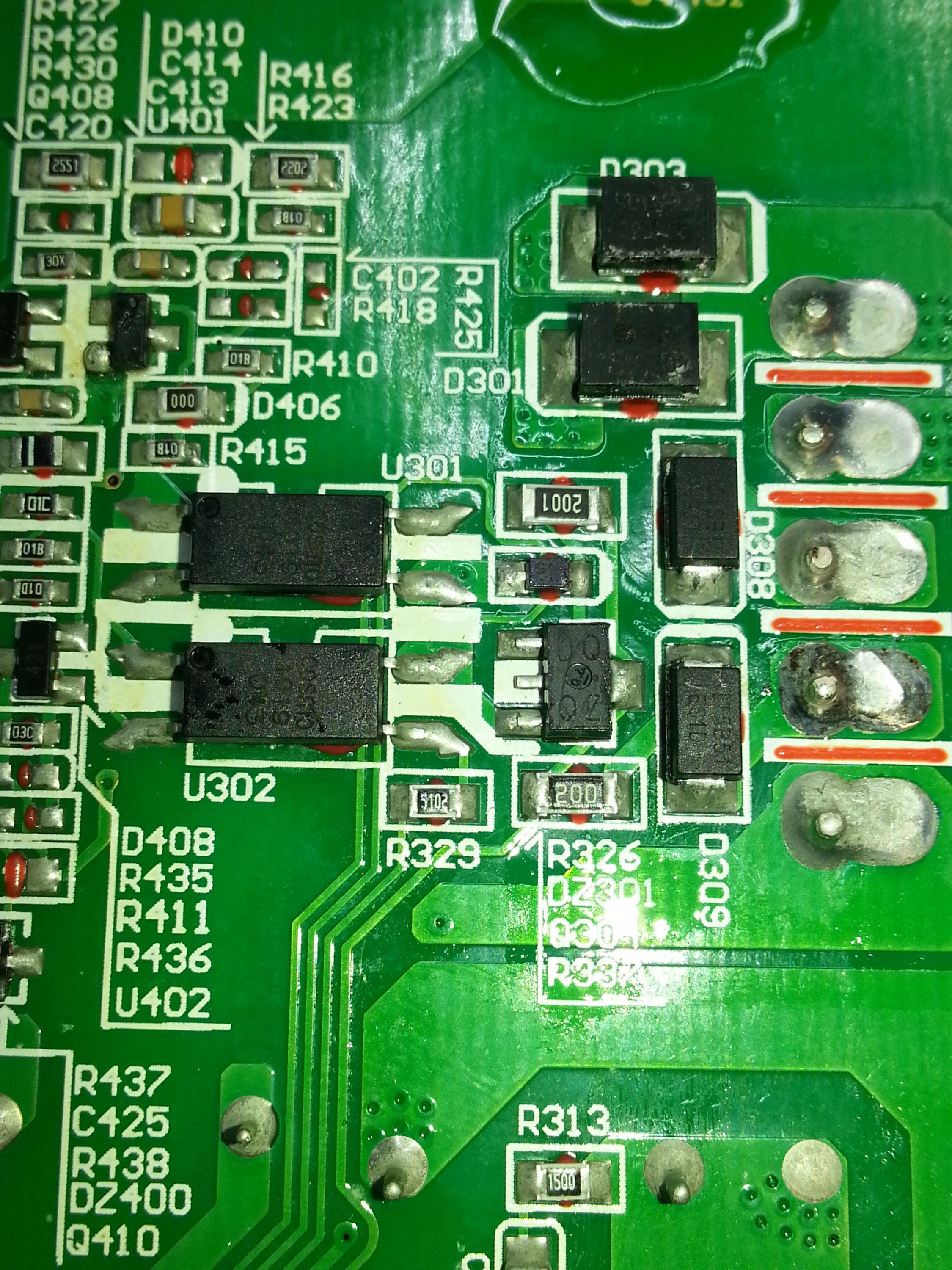

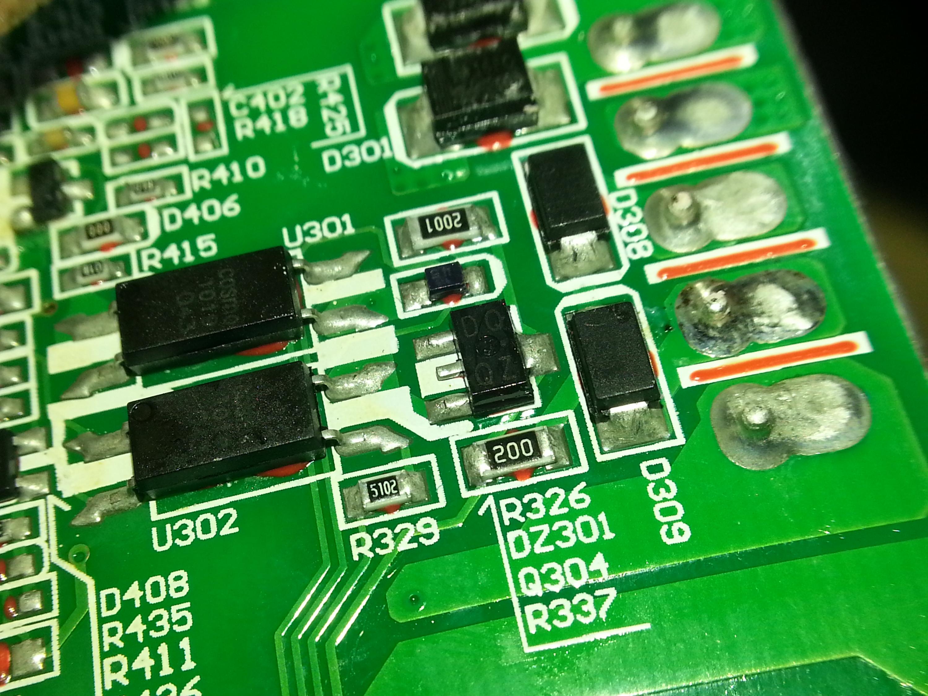

          I see two opto couplers, one is usually for feedback to control the primary, I wonder if the second one is for turning one of the ic's on and off? standby? If there is no load on the secondary, the supply is off? maybe?
          • Dannyx

              It also says the NCP starts operating at a minimum of 15v which I'm not getting....
              Page 26 of NCP datasheet: an auxiliary supply must take over before VCC drops below 9v, which I'm not getting either - could be the OTHER IC is faulty - not this one. It keeps trying to start, but the other IC is not starting the AUX winding to keep it going...I could be looking in the wrong place.

                1) On page 6/36 L6599 can turn the PFC circuit on or off depends on the load.
                2) Now the VCC for those IC (and therefore the bottom pin of the IC) jumps around between 7v and 14v, like it's trying to start up but fails. When you see these Voltage going up and down, do you see any output on the cold side at all? If it is trying to run and able to produce the Voltage on the AUX winding then the Voltage on the cold side will be present. Or may be then the Voltage you are seeing is from the main cap that provides the kick Voltage, see the application circuit page 31/36 on how it gets the kick start Voltage to the VCC pin.
                3) What Voltage do you see on the Cathode side of the Diode that get the AC from the AUX winding?
                4) What Voltage do you get on the Collector of the Transistor that being fed by the Voltage from the AUX winding?

                            I removed that transistor I pictured up close and I still get the fluctuating voltage on VCC, but another thing I noticed is that without the transistor, there's no more collector voltage on the pad which connects to the tab...don't know if that's normal or not though...
