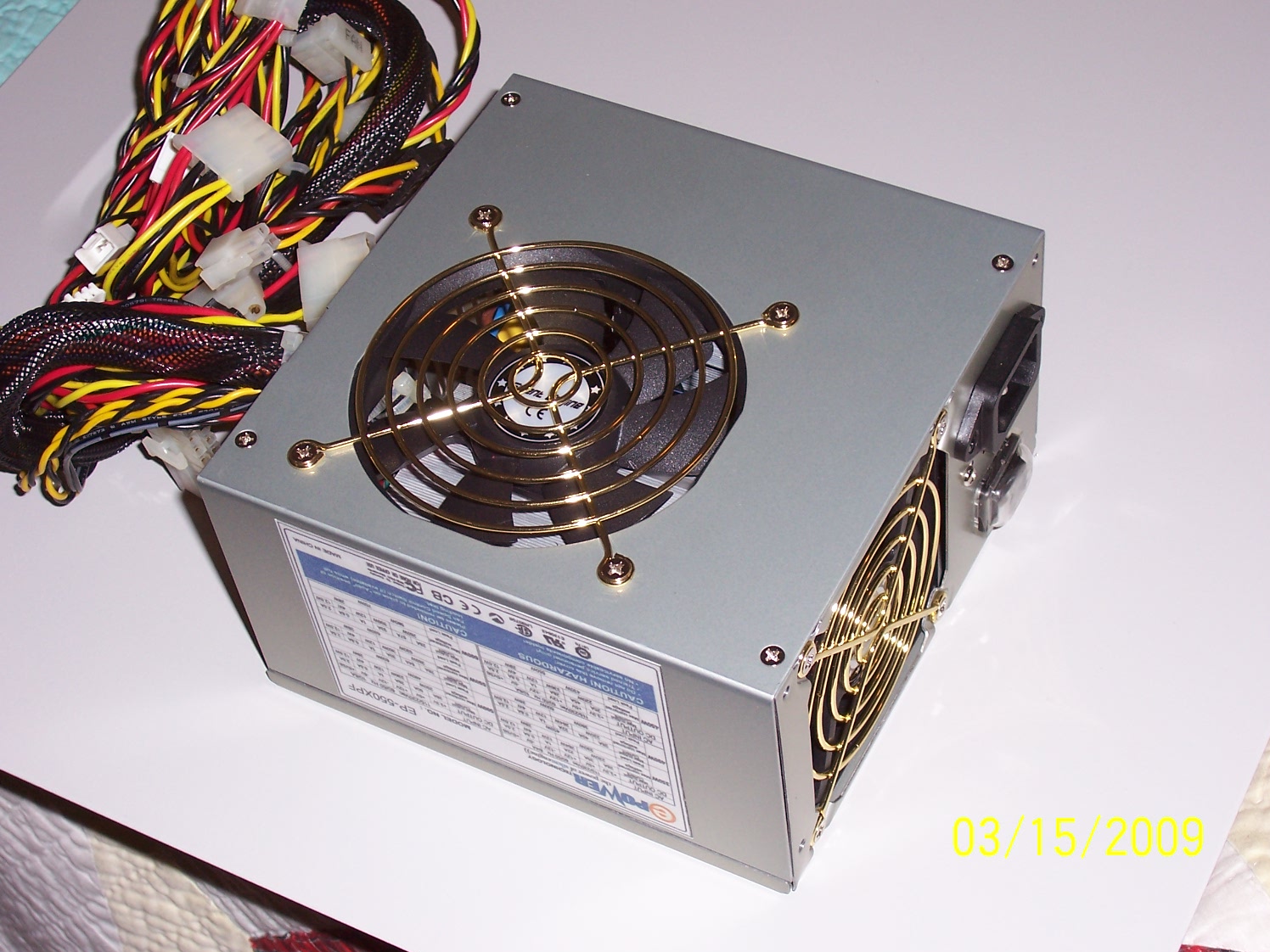

    A few months ago (before finding this website) I purchased an epower EP-550XPF from Newegg (on sale) as a replacement for an older Pentium 4 machine. From what I have learned over the past several weeks, I finally opened the case and took a peek inside. It looks like an older design with the simple transistor switcher in the 5VSB circuit, uses a TL3842P PWM chip, and TL494 & LM339 chips on the add on supervision pc board. In its favor, it has two fans and two huge heat sinks. A very heavy power supply. I did notice some Fujitsu capacitors on the output side. I will try to post some photos later.
    The computer power supply I am using is not giving trouble, just getting some age on it. Now I am somewhat fearful of using power supply designs using unreliable 5VSB designs which don't have overvoltage overcurrent protection. Replacing the working power supply with this new one might turn into a disaster!
    So thought I would start this thread and see what experiences others have had with epower power supplies, perhaps the same model.
    Thanks. Tom

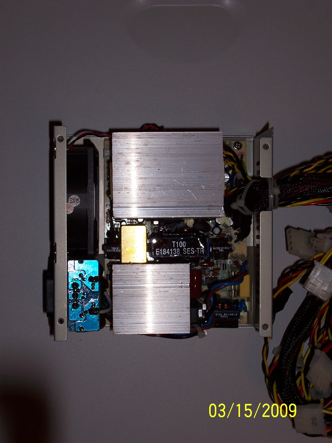

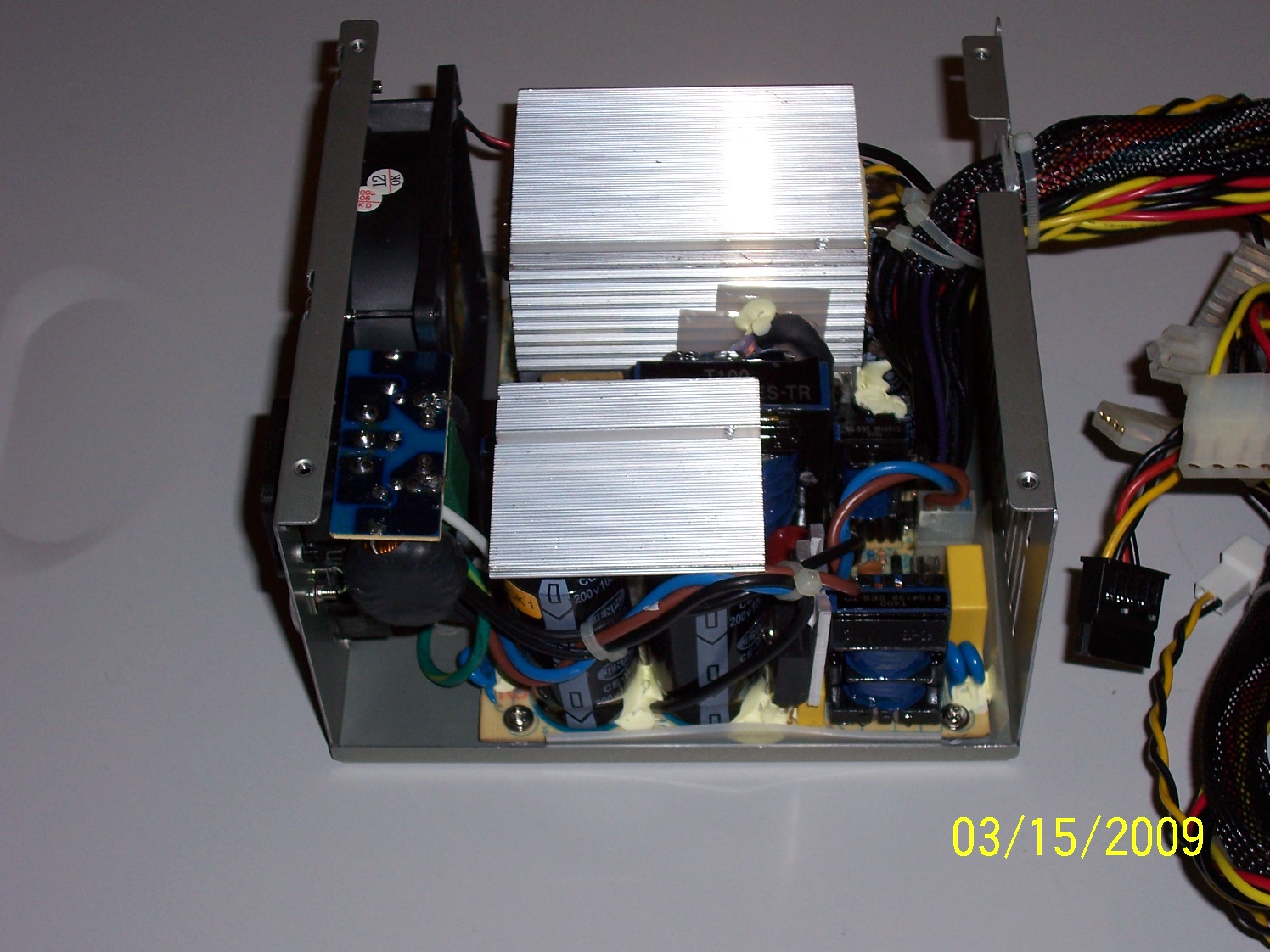

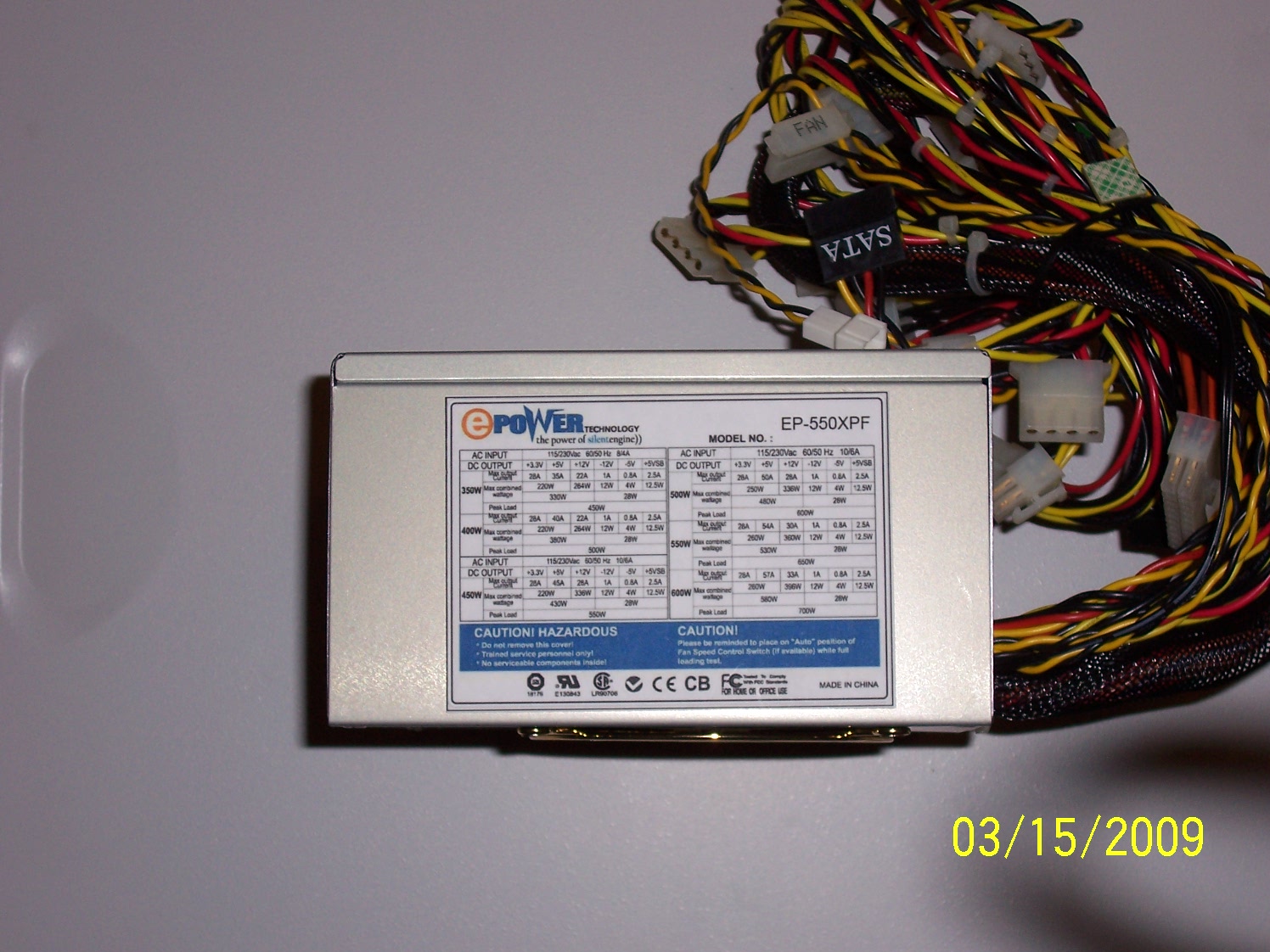

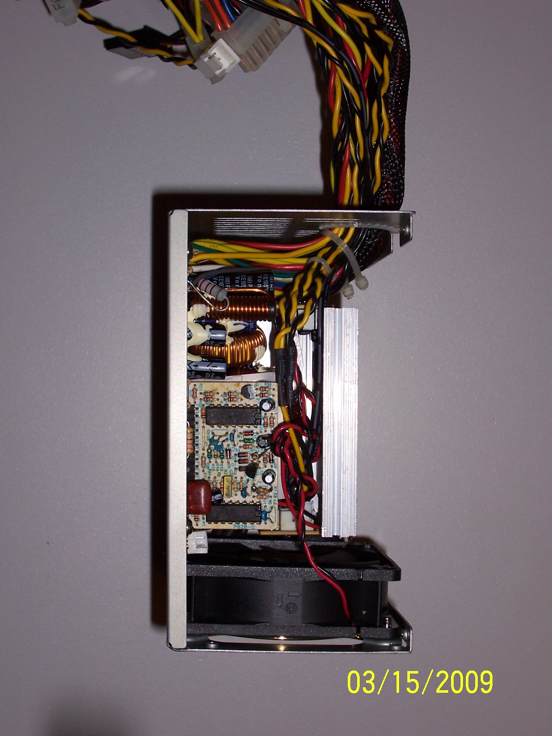

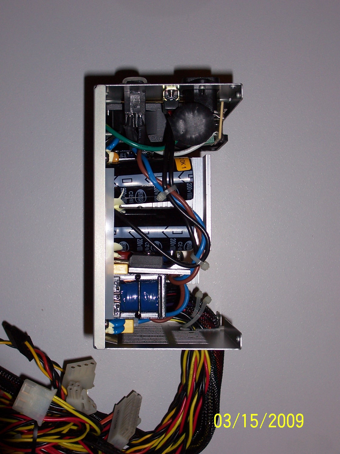

    Here are some photos

      Fujitsu caps? Not likely - most probably Fuhjyyu (pronounced Fuhk-yu in many places), which is a well-known crap cap. Not the worst out there, but still crap. You should replace *all* the Fuhjyyus on the secondary side if you can - they're a bigger reliability issue than the discrete +5Vsb circuit, which may also have one critical cap in it.
      • Oklahoma Wolf
        • Dec 2005
        • 353
        Re: E Power EP-550XPF
        Epower/Topower is known for using questionable caps. Fuhjyyu is very likely, and they still use those caps to this day under the name Asia-X. They've used other names off the back of a Chinese truck too, like Samson and Viva. Their idea of premium capacitors is usually Teapo.
        If it's a few years old, I'd plan on a recap soon.

              If you pull 'em, chances are very good they'll be under capacitance spec or at the very bottom of the ±20%. (i.e. 1000uF = 800uF) That might give you some headroom when it comes to finding a can size that will fit.
                that chip should have protection...to some extent...
                offcourse chip u used in 250w crap psu mod is better....
