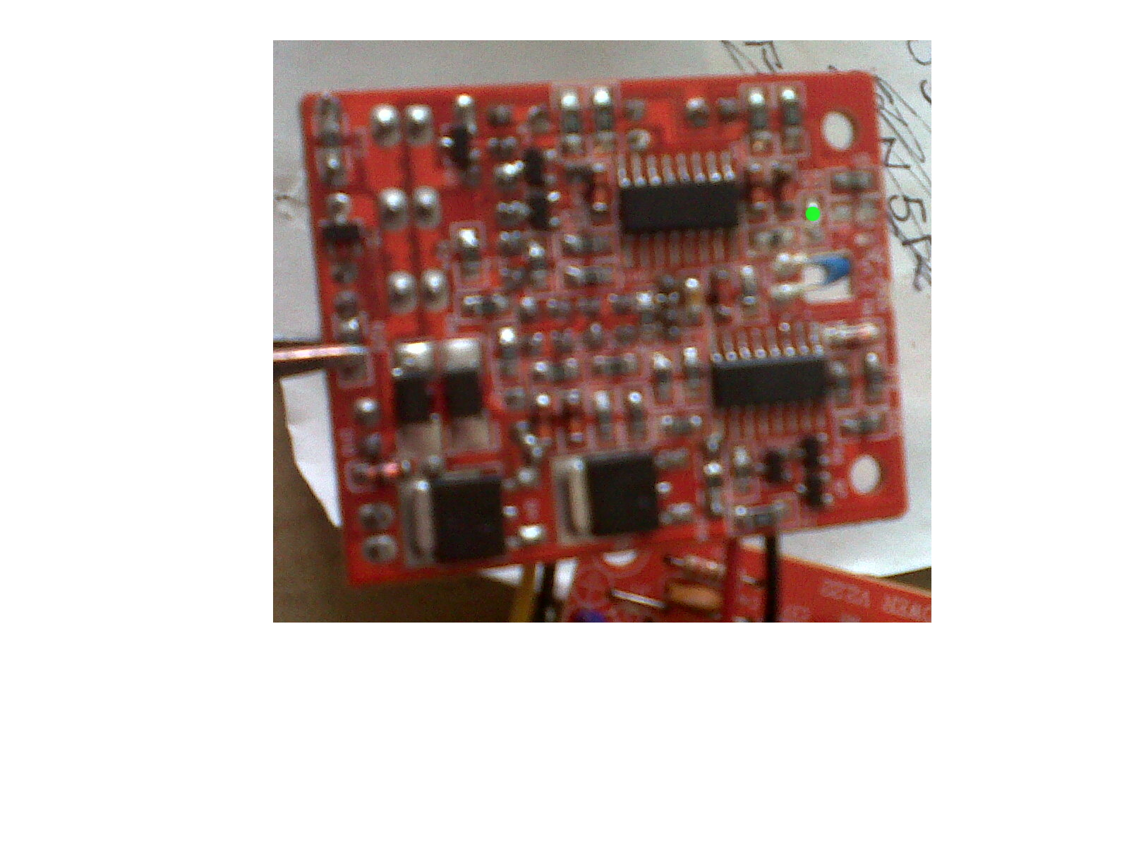

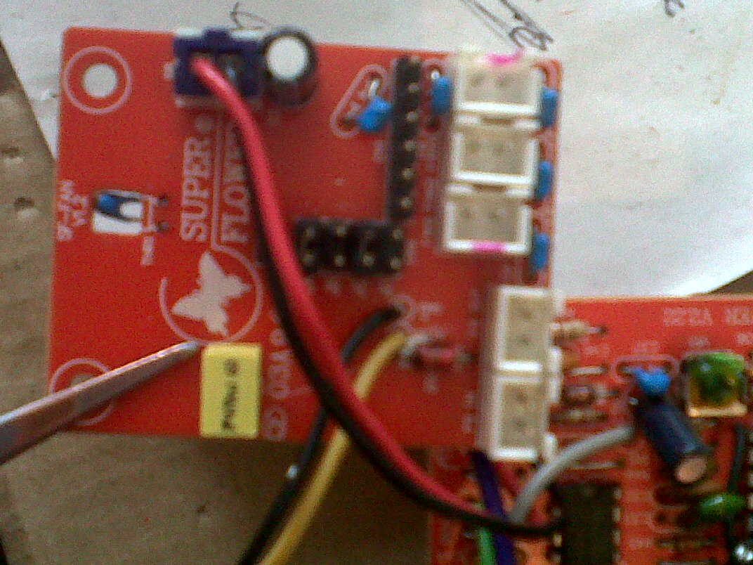

    does anybody have one of these??
    i broke a resistor on the fan controller while removing glue that was on the thermocouple!
    looking for the value of R3 on the underside of the fan controller.
    marked in green in the foto.

    Hi, Sorry, but nothing similar. Until you find something, you can try to find a 5v, or 12v source, and connect the fan to it, and after some monitoring you can use it with fixed speed.

        You're picture of the PCB is very blurry so I can't see the circuit at all. Looks pretty complicated with those ICs, but we may still be able to figure it out if there are better pictures.
        Worst case, what if you put a multi-turn pot in place of that resistor and vary it (starting with a very high resistance and going lower) until the circuit works?

              well they arent identical at all.
              and the controller is complex, it has a set of button selectable profiles consisting of a base-speed that is maintained until the temp goes over a set point after which the fans ramp up.
              thats why it has so many chips - one is a decimal counter used to step through the profiles and drive an RGB status led.

                Vote better picture! so maybe we can reverse engineer!
                  • 31304
                  Re: SuperFlower SF-530T04
                  i was thinking that actually, but so many tracks go under the chips that i would have to lift them off.
                  so for now- not going that far.
                  i will post a pic later of the leds & button bit.
