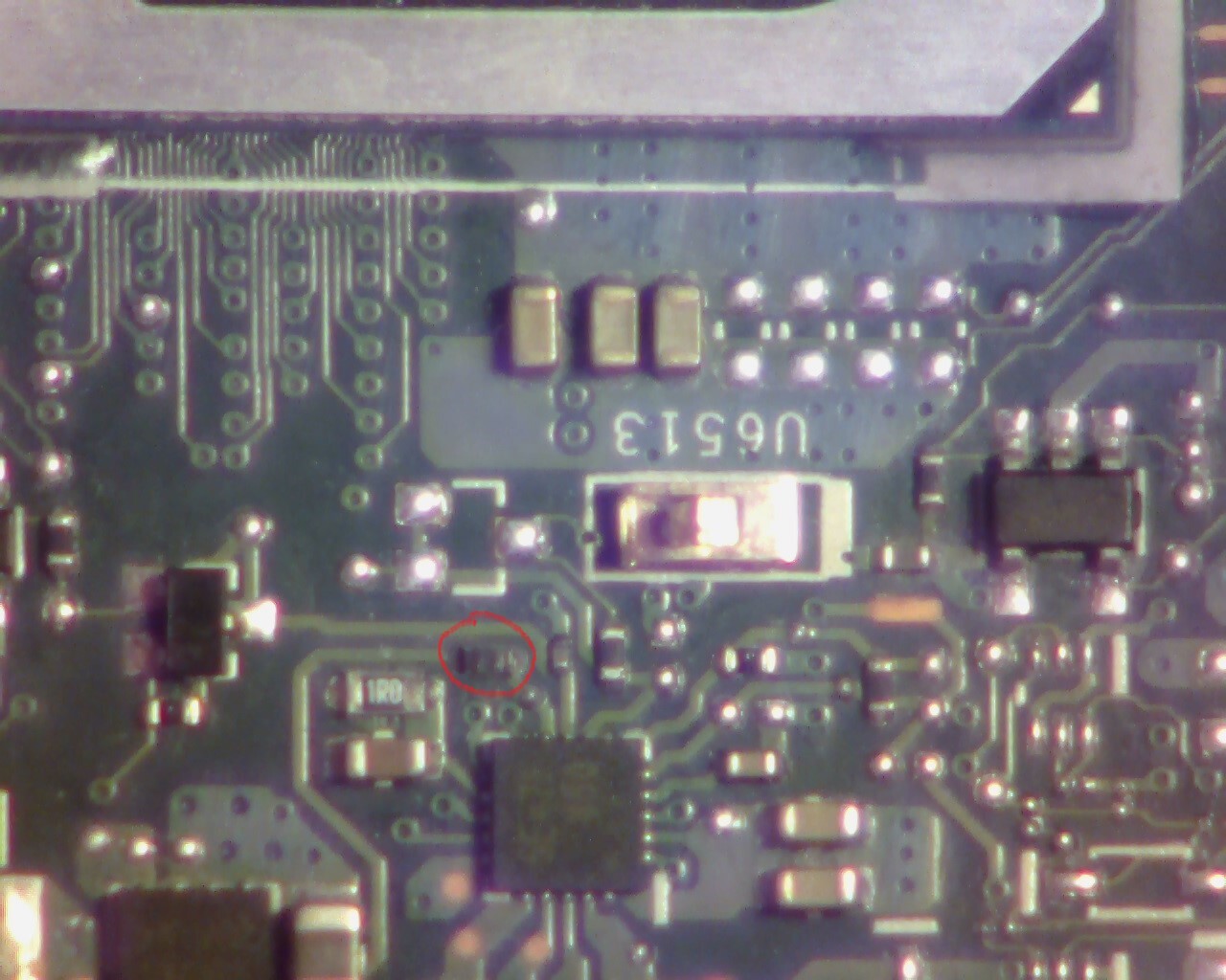

    Hi, Asus P2451F board P2451FB rev2.0, flooded with liquid. I need schematic or element identification, please see the photo.
    Regards for all.

    Resistor 620K on pin 9 RT8248A
      Thank you, this is correct answer, an image appeared on the LCD
