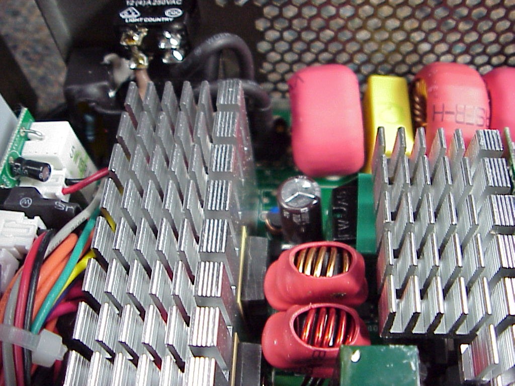

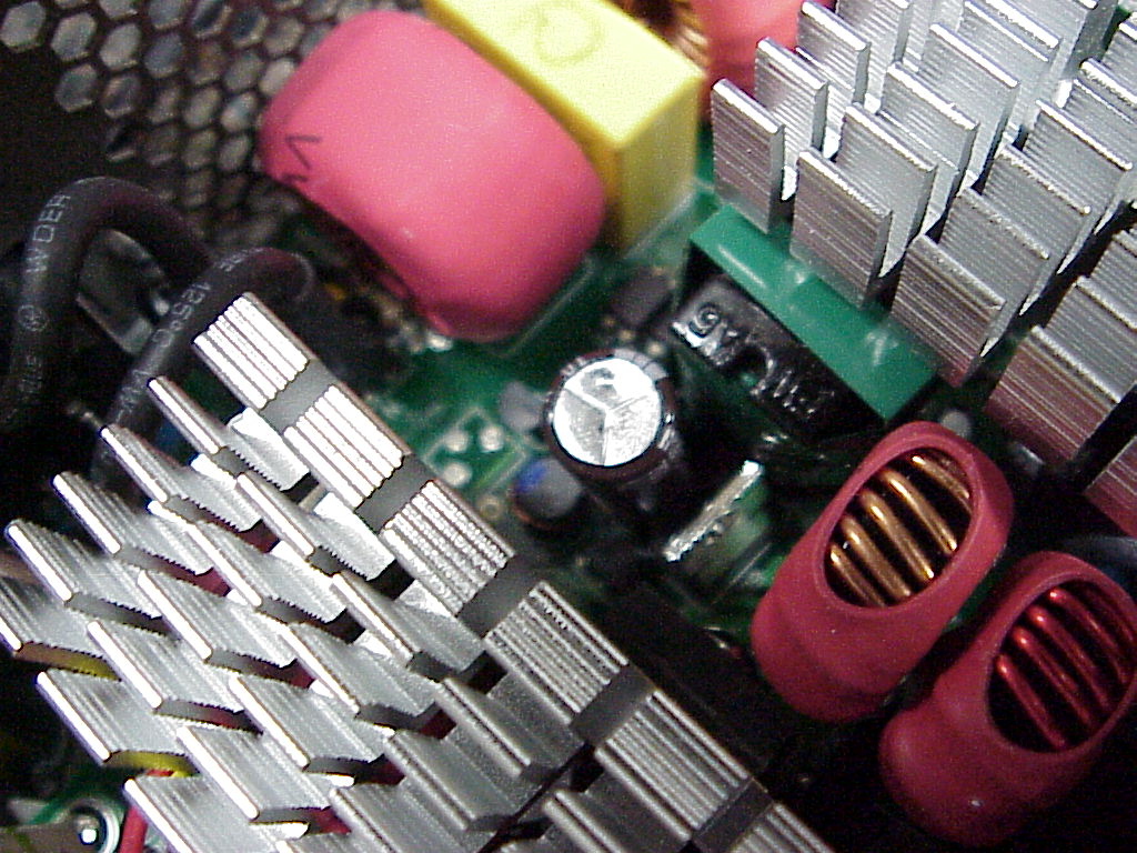

    this is a new toughpower 850 for a new build.
    customer brought it in to do a preemptive recap if needed.
    all ncc kze so not needed.but on +5 stby look at the dent in this cap.

    Oops. I bet all the heatsink mounting screws under the PCB are loose, too. Common problem with these bigger CWT based units. I keep some red threadlocker on hand for all the CWT based review units I intend to sell afterwards

      i will be checking that when i change that cap.
      at least it does not have all that tan glue dumped on everything.
      as for looose hardware they have to have some flaw to make it go bang!
