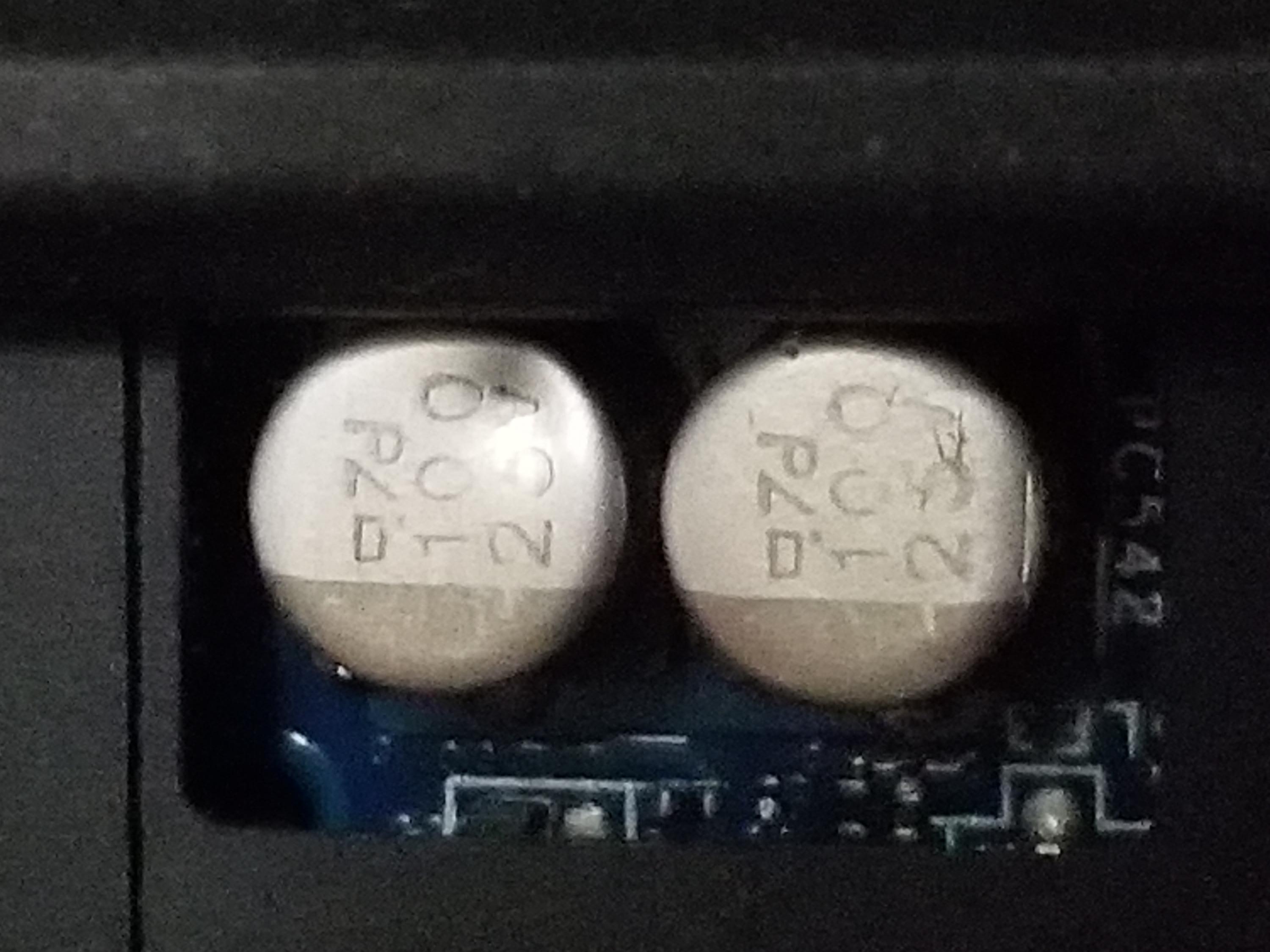

    Remove all power. Meter in resistance mode.
    Measure the resistance across the 2 pins of these dented capacitors. Post their readings and the scale used on your meter.

        Okay I checked them with a Fluke 177, the 2 caps both gave the same readings, I assume they are connected in parallel.. On auto range it used 600K Ohms and the reading started at 180 and continuously dropped. I also tried 3 manual ranges, @60M - 0.002, @600K - started at ~14 and increased to 30 in a few seconds still rising, @6K - started at ~0.6 and increased until it hit OL after a second or so.
        I'm not sure how to interpret these readings, I am assuming this is showing that the cap is behaving as expected?
        Thanks for your help and suggestions, I will happily try anything I have the tools to test..

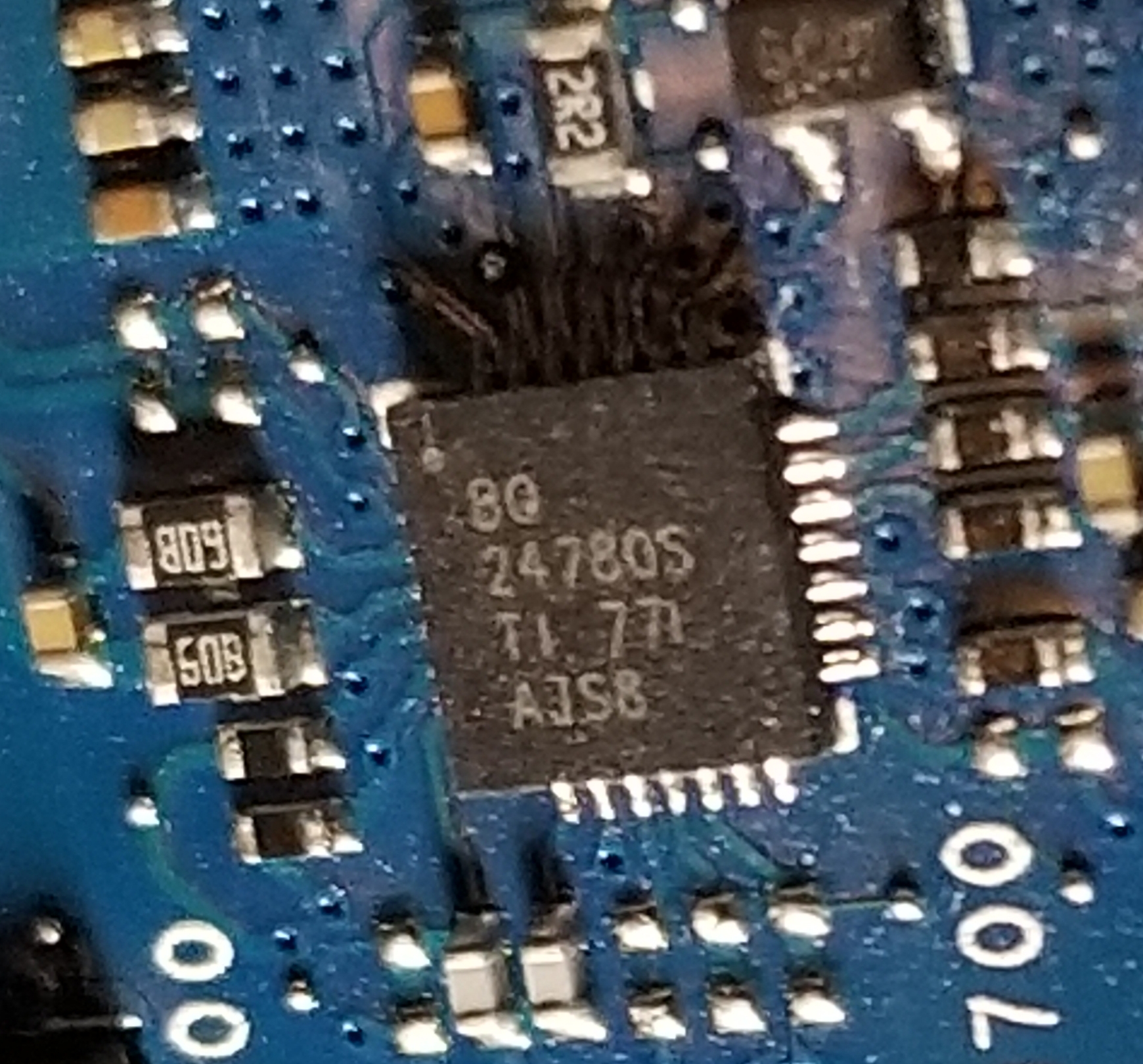

                            Locate the charger IC on the logic board.
                            Post the smd markings. Likely a part from TI (not the rapper) with BQ....
                            It should be near the dc adapter connector.
                            • z32KRAzY
                              Eager to learn!
                              • Aug 2022
                              • 37
                              Re: Alienware 15 R3 Motherboard Issues Help Plz!
                              Okay I found it.. It's marked with:
                              BQ
                              24780S
                              TI 77I(?)
                              AJS8
                              Not sure about the last character in the third line, I'll attach a picture of it..
                              Do you think there's something wrong with the charging circuit? I assumed it wasn't charging just because it's a cheap aftermarket battery..
                              Thanks again!!

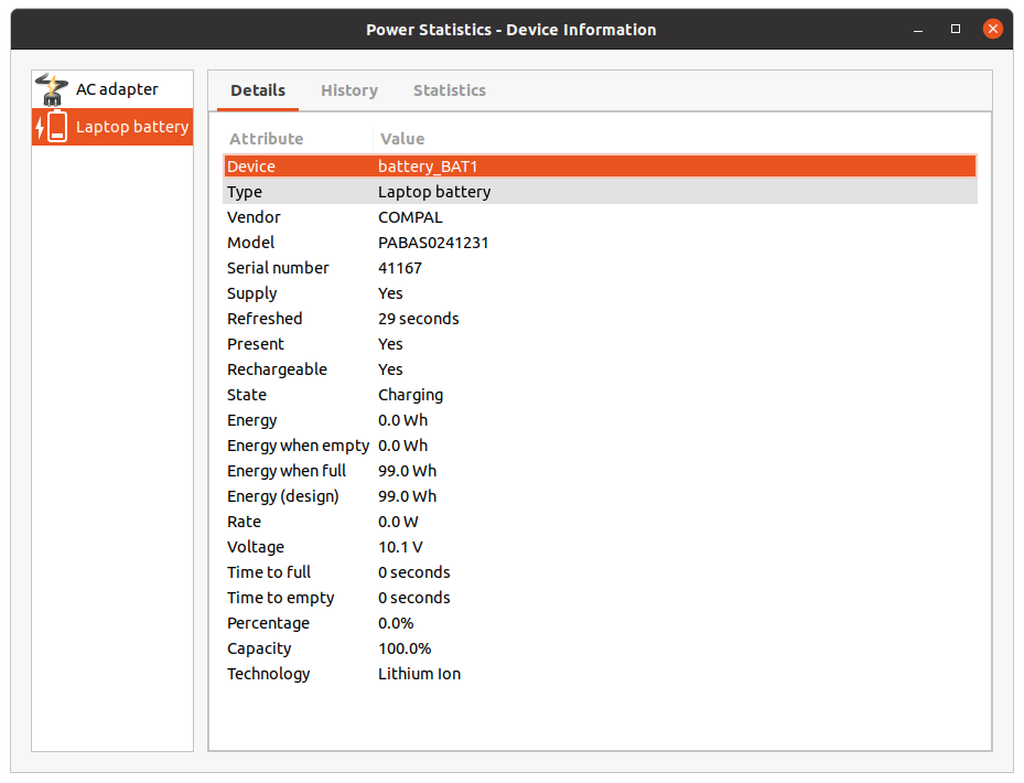

                                Hey guys, I guess it is the charging circuit.. This is a screenshot from ubuntu power statistics, it appears it is trying to charge the battery.. What's going to be the likely problem? That TI chip itself?
                                Thanks..

                                  Yes. This is the charger chip.
                                  With the power adapter and battery connected, very very carefully, measure the voltage on each pin of this IC.
                                  From the voltage readings, we will have a better understanding of what the charger IC is doing.
                                  In many cases, the fault is with a defective 2nd dcin mosfet that is driven by this charger IC. See above sticky on charging circuits and their operation
