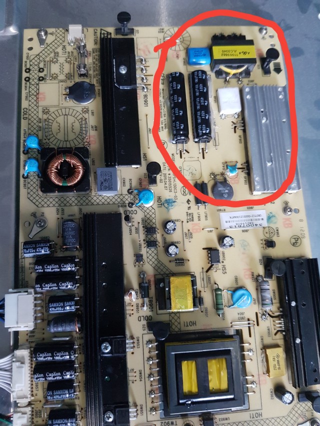

    Hi all. Just managed to diagnose a toshiba regza 40 inch power problem that resulted in no picture and no sound. Was checking throughout the voltages and noticed 12v and 24v was very low with load. Knew some caps popped somewhere. Started checking all the caps and noticed the main 2 filter caps was leaking. Went to parts store, didnt manage to get the exact same size which is the long type according to the picture but got a bigger one instead and with same uf and v which is 68uf 450v. Soldered it and tested the unit, works perfectly fine.
    But have 1 problem here. I am hearing a eeeeeeee buzzing sound near the caps or the transformer. But the unit works fine. What can be wrong? Can i use a bigger size capacitor or i have to use the same exact size?

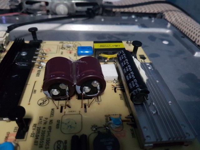

    According to the picture, the long black one is the faulty cap and the short fat one is the new caps.
    Note : There was no buzzing sound before replacing the new cap. After replacing cap theres buzzing sound.

    Once you have the space to accommodate the bigger e-caps that wouldn't be a problem as they are the same uF and WV as the original. Reflow the transformer pins onto the PCB sometimes while handling they develop fine cracks that can produce buzzing sounds. Look too at the other heavy solder connections on the PCB, heat sinks, etc. The buzzing sound though is not a problem though. Unless it is loud and unbearable.

        Did you do the re-flow? That buzzing most likely is off the Transformer and other Coils.

          Yes i did. Still same. The thing is, the sound wasnt there with the old cap. Only started with the new cap. Afraid something to do with the size of the cap. Maybe its too big? Overloading? But the voltage and value is same.

            Then you should not have a problem. No overloading and nothing to do with the size.Tighten ALL hold down screws on the PCBs. There is something loose. Perhaps the cap is resting on something and vibrating. I don't have photos, neither is the PSU in front of me and I don't know if this is a CRT, LCD, LED or Plasma TV or size of TV we are dealing with. Unless the Transformer core is broken/cracked.

              Its a toshiba rega led tv, slim series. So basically ure saying, it doesnt really matter whatever size the capacitor is aslong as its the correct value. Right?

                Yes.

                  Manage to replace original caps at a very affordable cost. However, the transformer still giving a high pitch sound. Its the Ac transformer, not the DC. U can actually see it in the first post photo. The yellow color. The sound is definitely coming from it. But no problem with all the voltages, all accurate. Already soldered all the cold joints. Still no change. TV is working perfectly fine now. Just the sound.
                  When i put my ears really close to the pitching sound, it sounds like more coming near the capacitor. Also with the high pitch sound, i hear a faded tuner sound. Of course i had unplugged all the speakers. The sound coming from the marked area.

                    If you re-read my Post Nos. 2 and 4 I spoke about the transformers...Took you really long to finally agree that the buzzing sound is coming from there. OK so you changed the e-caps to the ' original' ones. Did it make a difference?? NO....And you re-soldered the transformer legs and all the heat sinks attached to the board. What is it then exactly you want?

                        That is the inductor for the PFC Voltage booster circuit, the buzz can be cause by bad PFC controller IC.

                                      That noise is likely caused by oscillation of the feedback loop of that controller IC. It could be by (poor) design and throwing parts at it will not fix it - understanding what goes on and modifying the circuit slightly to get rid of the oscillation, will. Some power supplies just whine from the day they were born. If it gives the correct voltage output and the ripple is in spec, a lot of times they will let them go like that.
                                      Control loop theory is unfortunately complicated, even I do not understand it fully, but if you give me a schematic i can try to figure out where you could start.
                                      The good news is that it will likely not cause any issue in the long run, it is just audibly annoying and that's it.

                                        I just replaced the PFC IC from the other faulty board, looks like the other one is faulty as well but no noise, just blinking standby red LED. I fixed back the original PFC, the noise is there. Ive ordered a new PFC which is FAN7530. Oh well, we shall see what happens when i replace the new one.
