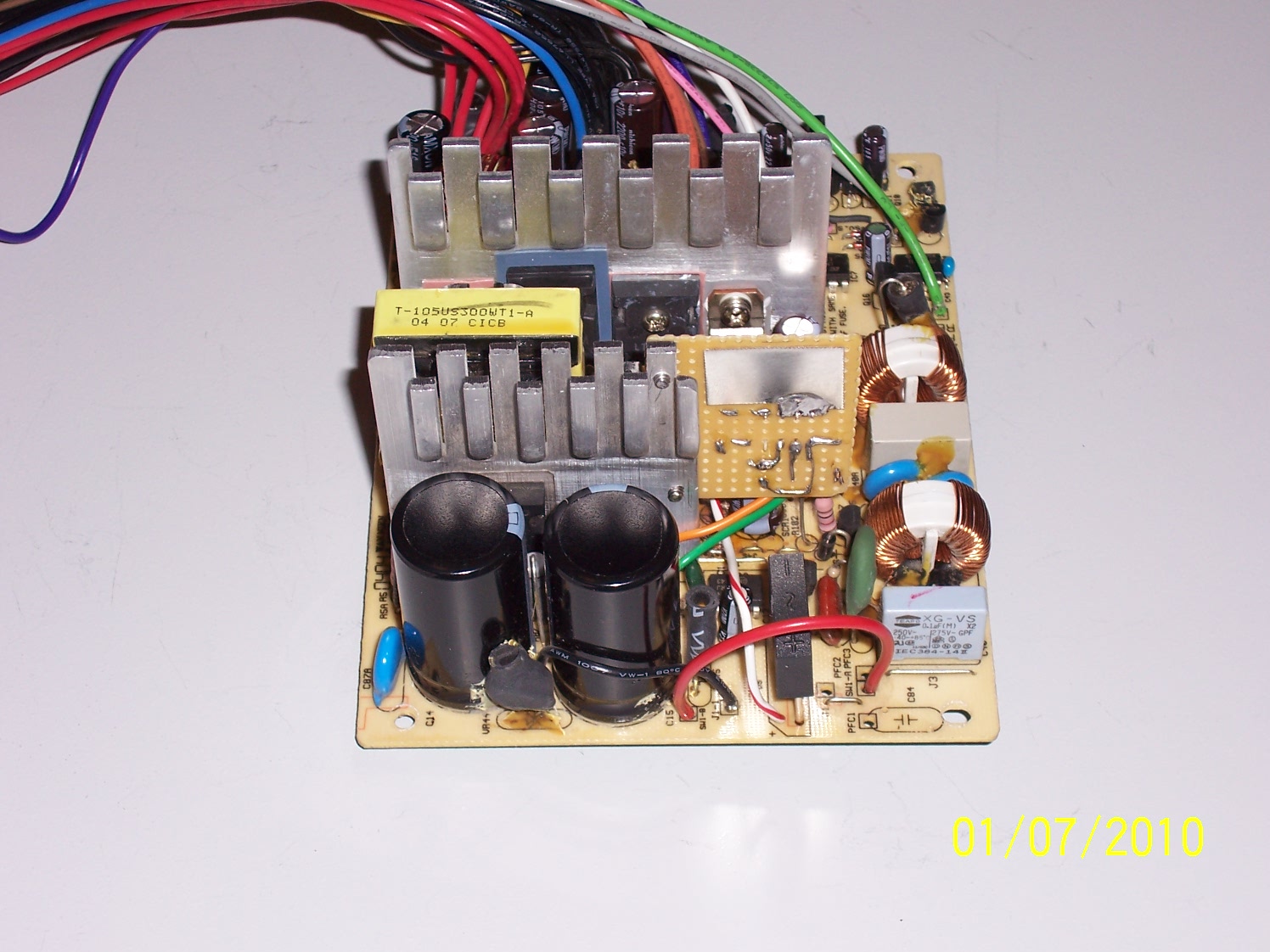

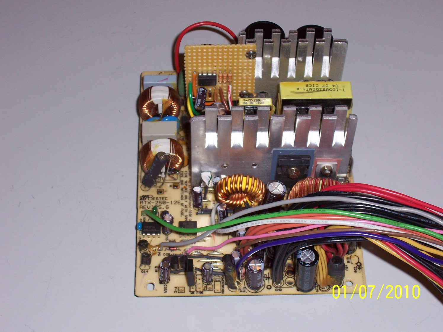

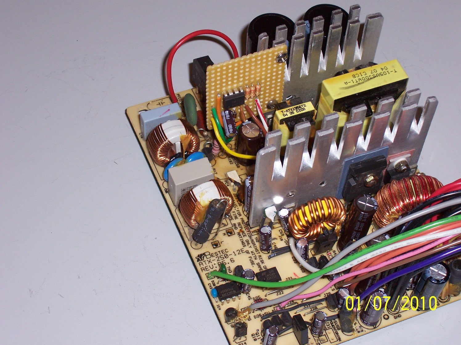

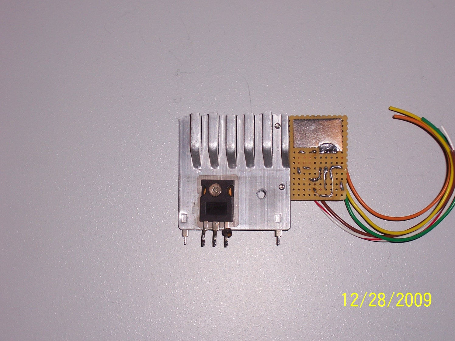

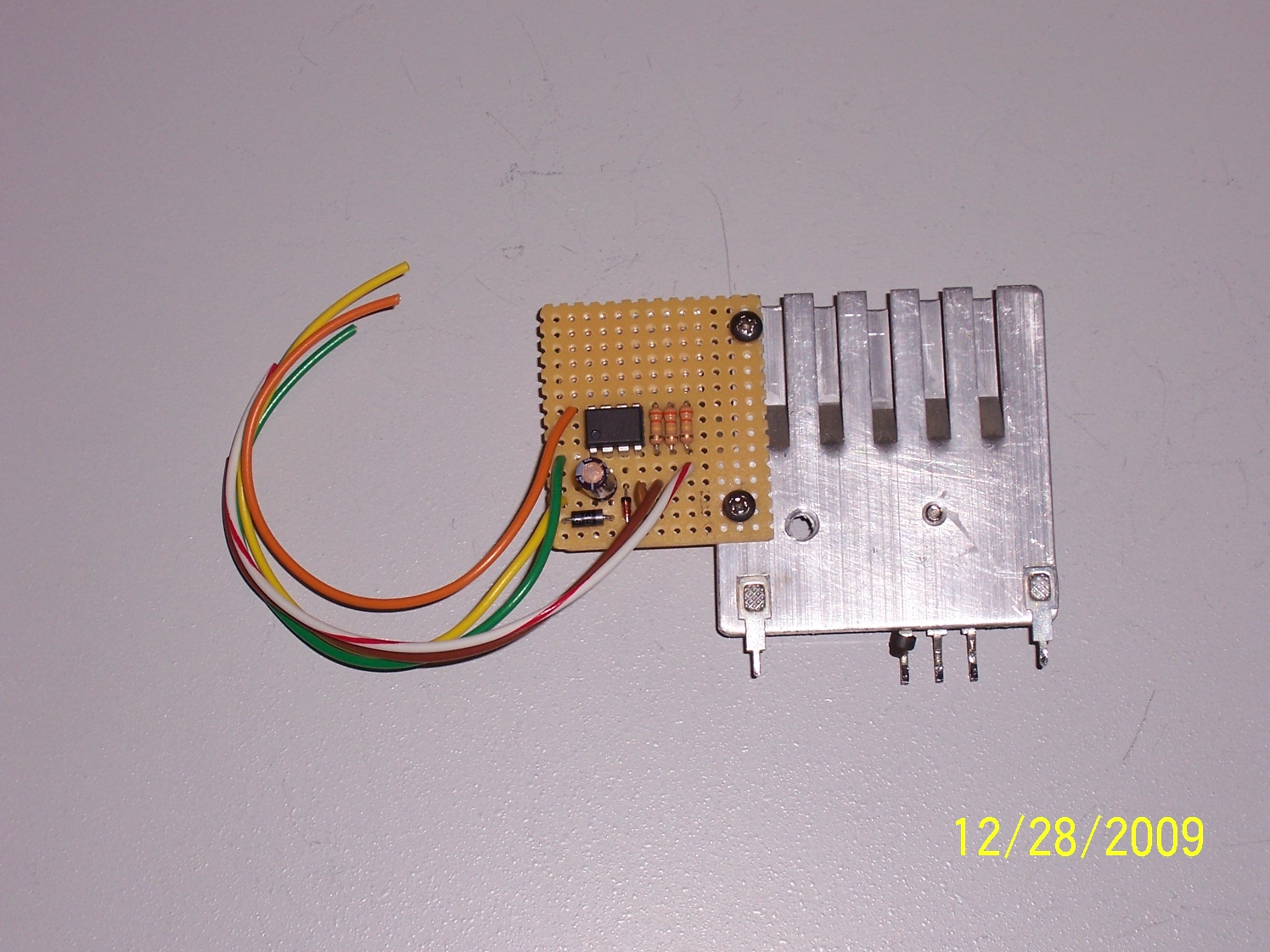

        New layout for DM311 add on pc board. Features "McIverish" heat sink cut from tin can using tin cutter. Photos attached showing pc board attached to main heat sink.
        Old proverb say.........If you shoot at nothing, you will hit nothing (George Henry 10-14-11)

          Re: Bestec ATX250-12E up and running!
          Nice, clean layout! How hot does the heatsink get? How hot does the DM311 get without the heatsink?
          I'm going to be building my board soon and am thinking of a glue-on MOSFET heatsink for the DM311 in addition to a tin can sink.
            On my boards, I have never put a heavy load on the 5vsb, so the DM311 has never been too hot for me to touch. The "tin can" heat sink was just an add on idea for future loading. I might mention ......... don't touch that heat sink while the power supply is running. It has the switching signal on it between the +320 volt source and the FET switcher, an AC signal of something like about 600 volts peak to peak. Notice also that the added heat sink does not touch the other heat sink (which is tied to AC common on this model Bestec).

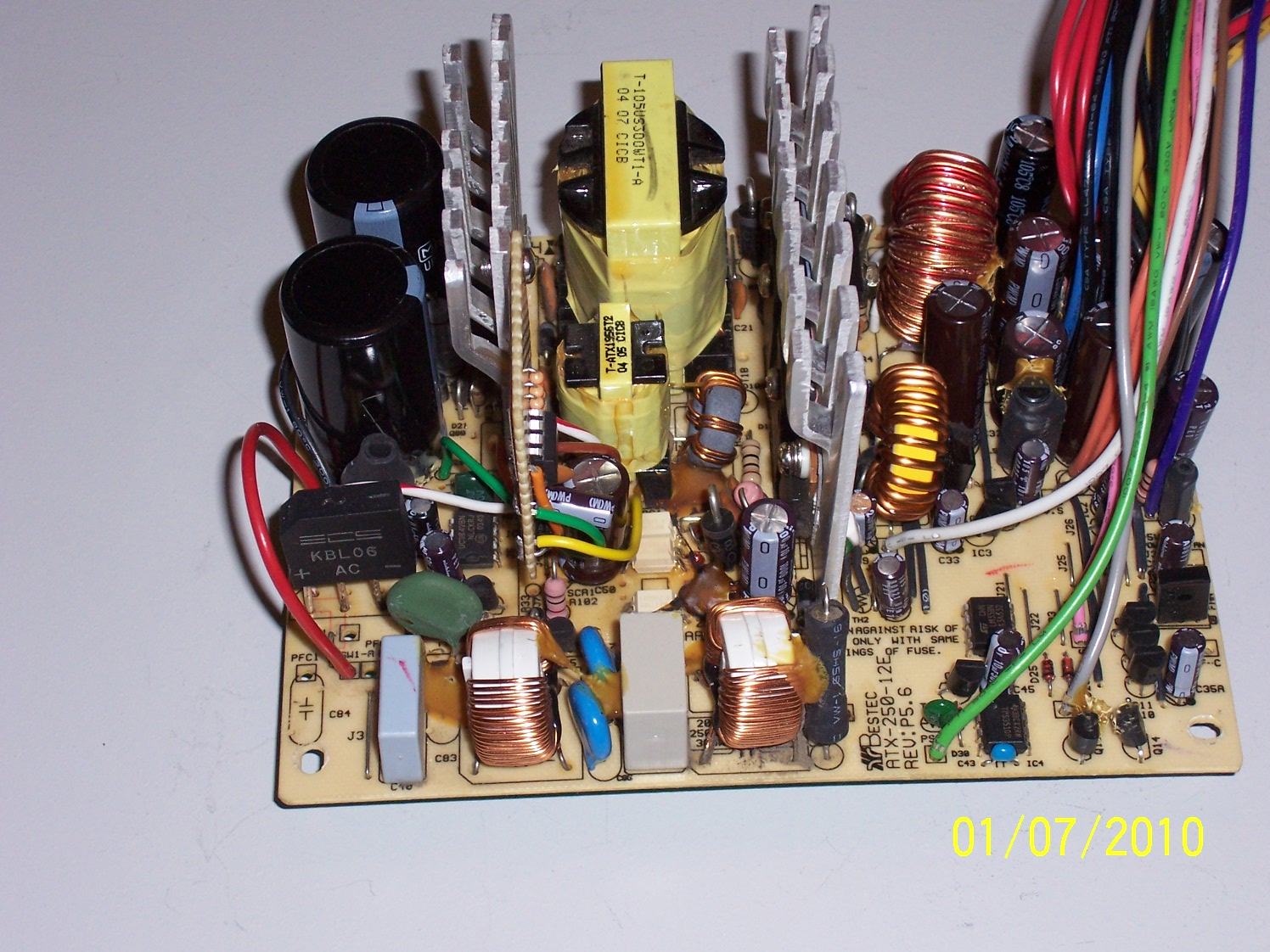

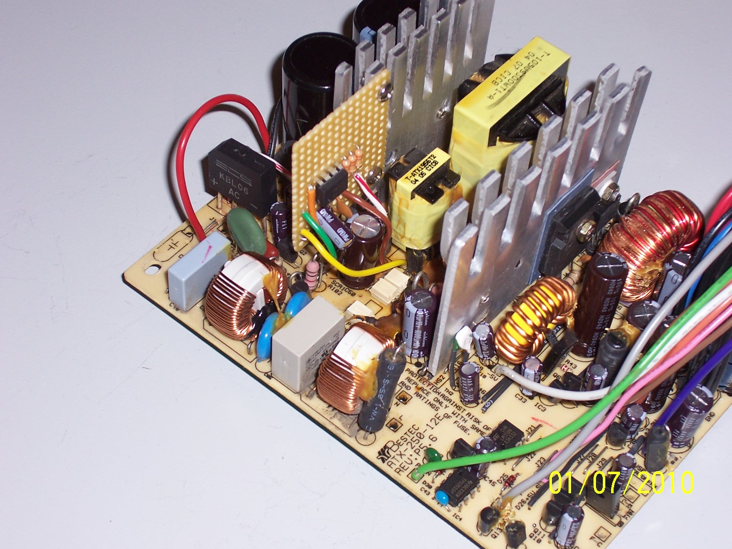

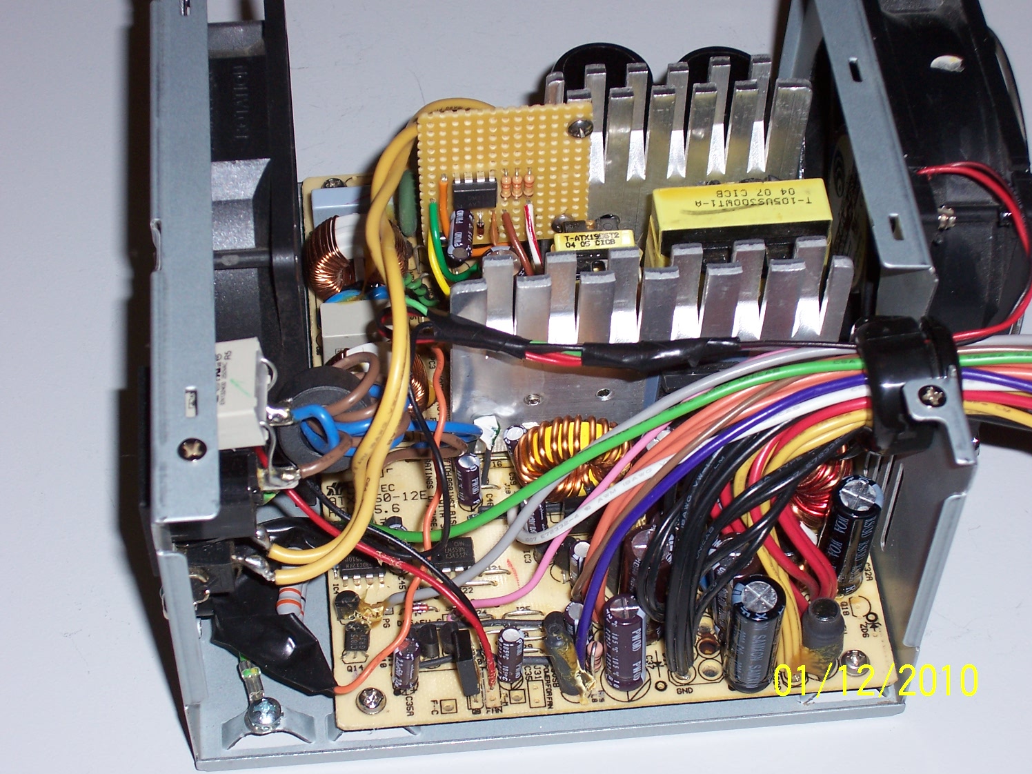

              On Bestec ATX-250 12E #2 I have completed the recap process. The first 12E had mostly JPCE-TUR capacitors. This one had mainly Jamicons. So here is an analysis of how the Jamicons held up.
              The two mains were CapXon 470 uF/200 volts. I had a burned board with a pair of Panasonic 560 uF/200 volt capacitors so changed the CapXon for the better Panasonic.
              12 volt rail:
              C32A Jamicon 2200 uF/16V esr=.02 -> Samxon 3300 uF/16V esr=.02
              C29 Jamicon 1000 uF/16V .07 -> Samxon 3300 uF/16V .02
              5 volt rail:
              C31 Jamicon 1000 uF/10V .10 -> Nichicon PW 2200 uF/10V .02
              C30 Jamicon 2200 uF/10V 2.3 (bulging) -> Nichicon PW 2200 uF/10V .02
              3.3 volt rail:
              C26 Jamicon 1000 uF/10V .11 -> Nichicon PW 2200 uF/10V .03
              C25 Jamicon 1000 uF/10V .09 -> Nichicon PW 2200 uF/10V .03
              -12 volt rail:
              C32 Jamicon 1000 uF/16V .07 -> Nichicon PW 1000 uF/16V .05
              5vsb rail:
              C37 Jamicon 1000 uF/10V .11 -> Nichicon PW 1000 uF/10V .05
              C36 Jamicon 1000 uF/10V .10 -> Nichicon PW 1000 uF/10V .05
              Remaining capacitors:
              C12 Jamicon 2.2 uF/50V 2.2 -> Nichicon PW 2.2 uF/50V .50
              C13 Jamicon 0.1 uF/63V 23 -> Nichicon VZ 0.1 uF/50V 18
              C24 Jamicon 0.1 uF/63V 20 -> Nichicon VZ 0.1 uF/50V 17
              C39 Jamicon 1 uF/50V 2.7 -> Nichicon PW 1 uF/50V 2.0
              C35 Jamicon 22 uF/50V 1.2 -> Nichicon PW 22 uF/50V .45
              C35A Jamicon 2.2 uF/50V 1.8 -> Nichicon 2.2 uF/50V .53
              C45 Jamicon 10 uF/50V 1.5 -> Nichicon PW 10 uF/50V .51
              C27 Jamicon 1 uF/50V 2.7 -> Nichicon PW 1 uF/50V 2.3
              C33 Jamicon 0.47 uF/50V 7.0 -> Nichicon PW 0.47 uF/50V 3.6
              C46 Jamicon 10 uF/50V 1.8 -> Nichicon PW 10 uF/50V .54
              C59 Jamicon 2.2 uF/50V 2.5 -> Nichicon PW 2.2 uF/50V .52
              The "critical" capacitor:
              C1 Jamicon 10 uF/50V >99 (not bulging) -> not used in DM311 mod
              C50 CapXon 220 uF/25V .92 -> Nichicon PW 220 uF/50V .05
              Note that C50 at 25 volt rating was changed to 50 volt rating. It normally runs at 20-22 volts. If 5vsb goes up, the voltage across C50 goes up proportionatly. Not much room for overload - one of the reasons this model had high failure rate.
              The esr readings of the JPCE-TUR capacitors on the first Bestec were much lower (see earlier post in this thread) than the Jamicon capacitors. The Nichicon PW had nice low readings.
              Before putting it back in the box, here are some photos of this Bestec with mod and recapped.

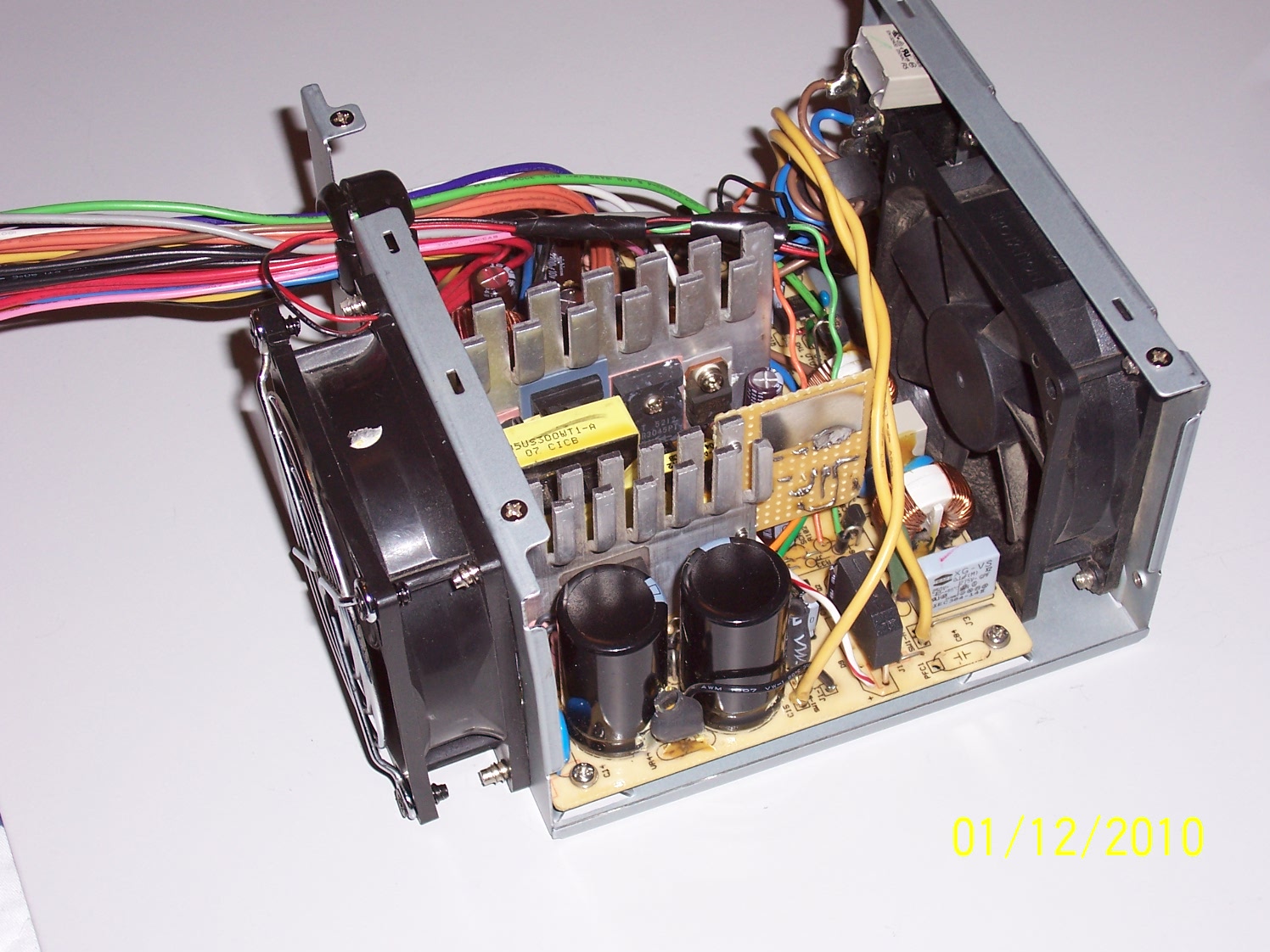

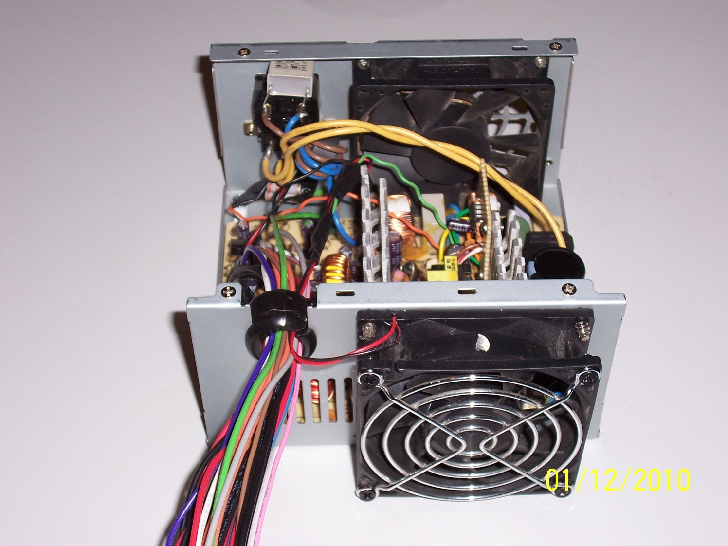

                      Here it is, back in the box. It has been recapped. It has the DM311 5vsb mod. It has the added fan which runs when the computer is turned off. The fan acts as a load resistance instead of resistor R102 which does nothing but generate heat.

                        Originally posted by everell
                        ...fan acts as a load resistance instead of resistor R102 which does nothing but generate heat.
                        AWWWW! No more frost-free standby...
                            The Bestec ATX-250-12E is the only psu I know of that has this circuit feature. When the computer is turned off, a transistor switches power from the pwm chip to a 1000 ohm resistor. It serves only as a heat generating load. So I remove the resistor (R102) and wire a fan in its place.
                            So go find you a Bestec ATX-250 12E and you can do some cool experiments!
