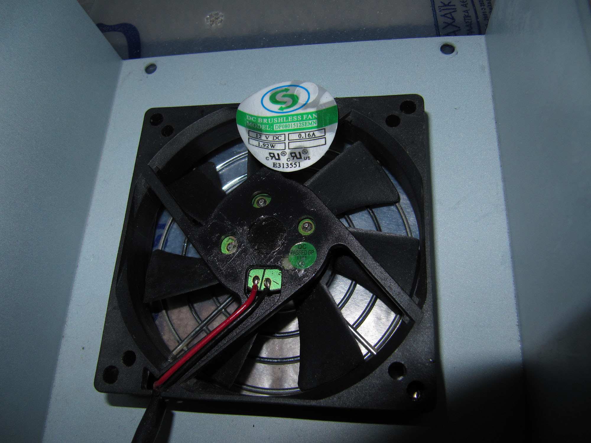

LC Power LC380M fan seized. Needs repair

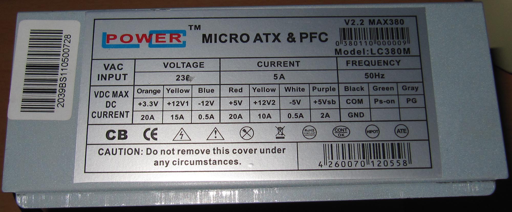

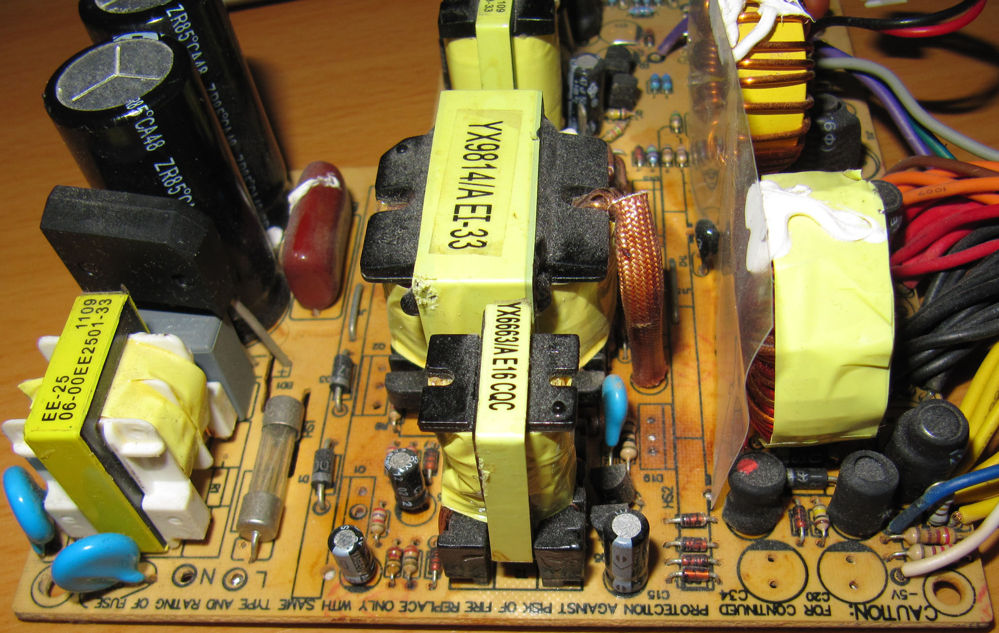

    This is a micro ATX LC Power power supply, not L&C. The label is missing info such as 3.3V & 5V combined power, 12V total output power and total output power. How convenient!

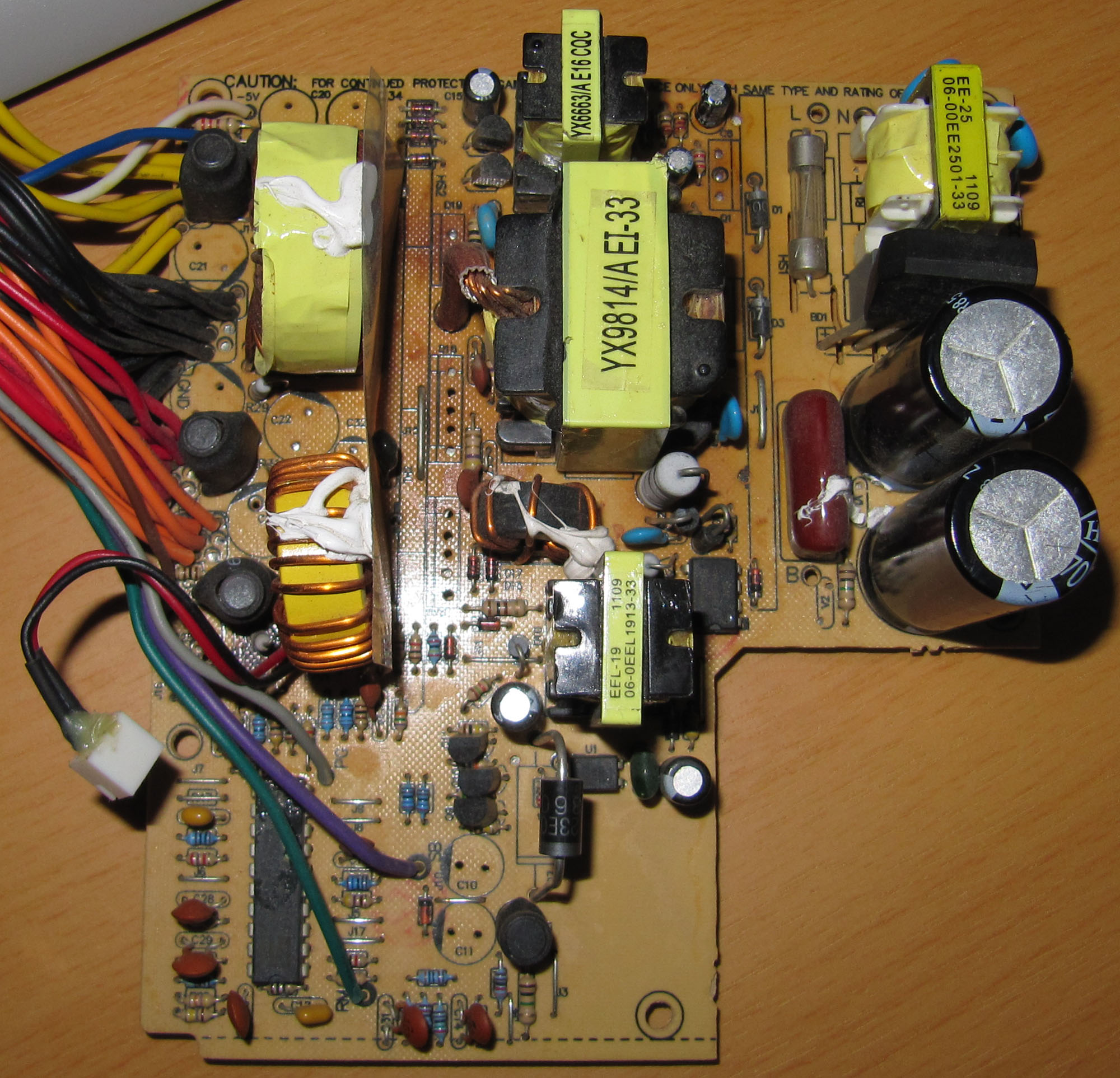

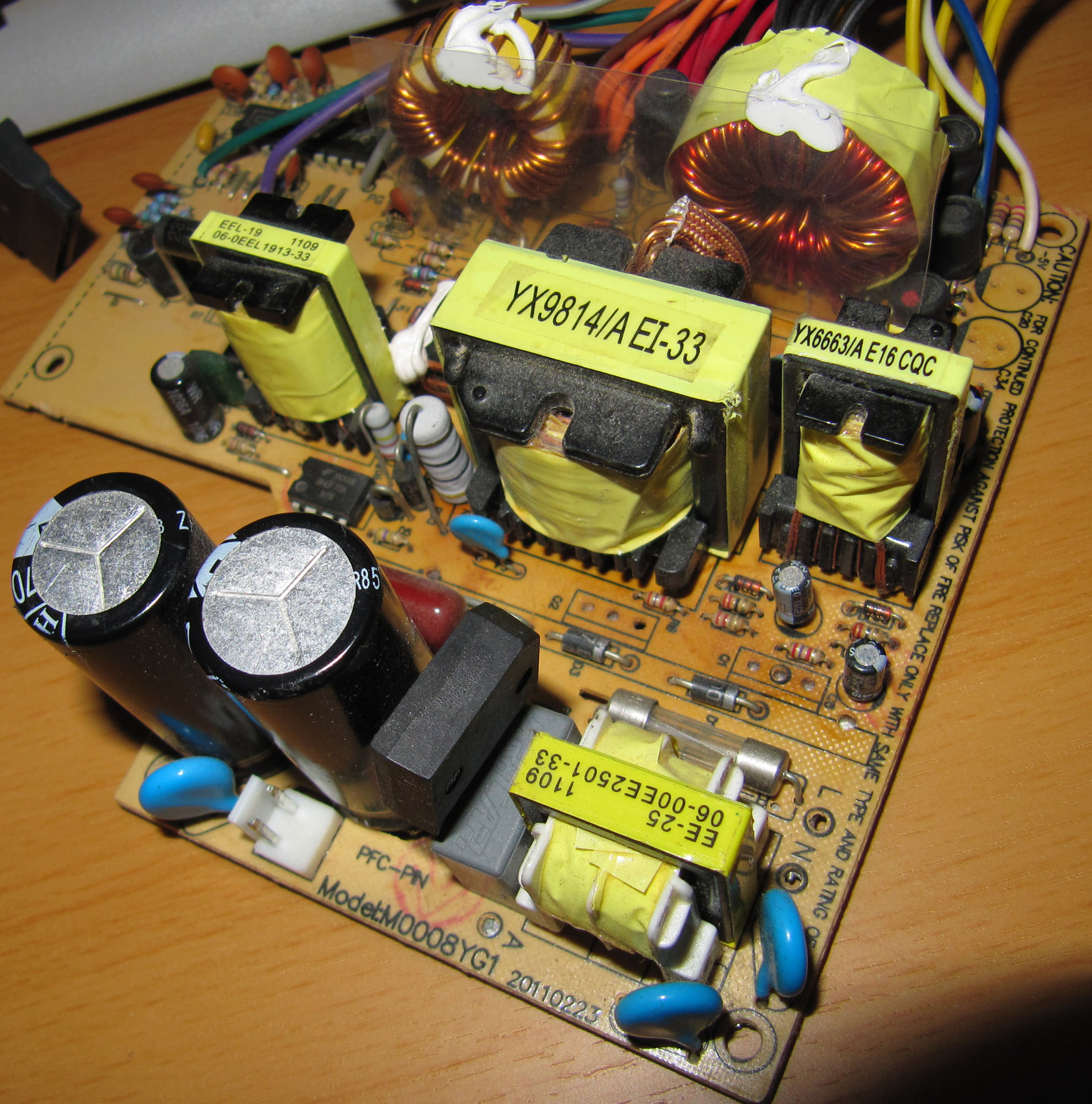

    Overall, the psu is not so bad.
    There is just 1 common mode coil and no spot on PCB for a thermistor. There are spots for MOV but they are missing.
    Input caps are 2x HEC 470uF 200V, their real capacitance is 452uF. The main transformer is ERL-33 and the switching transistors are 2x13009 but in TO-220 package. I would say it is a 250W unit.
    5vsb is generated from BH0F70A, this is good.
    SG6105D combo PWM and supervisor is used for this half bridge unit.
    Toroid coils look good for 250W, 3.3V and 5V use S20C45C schottky rectifier and 12V uses U20C20C ultra-fast rectifier.

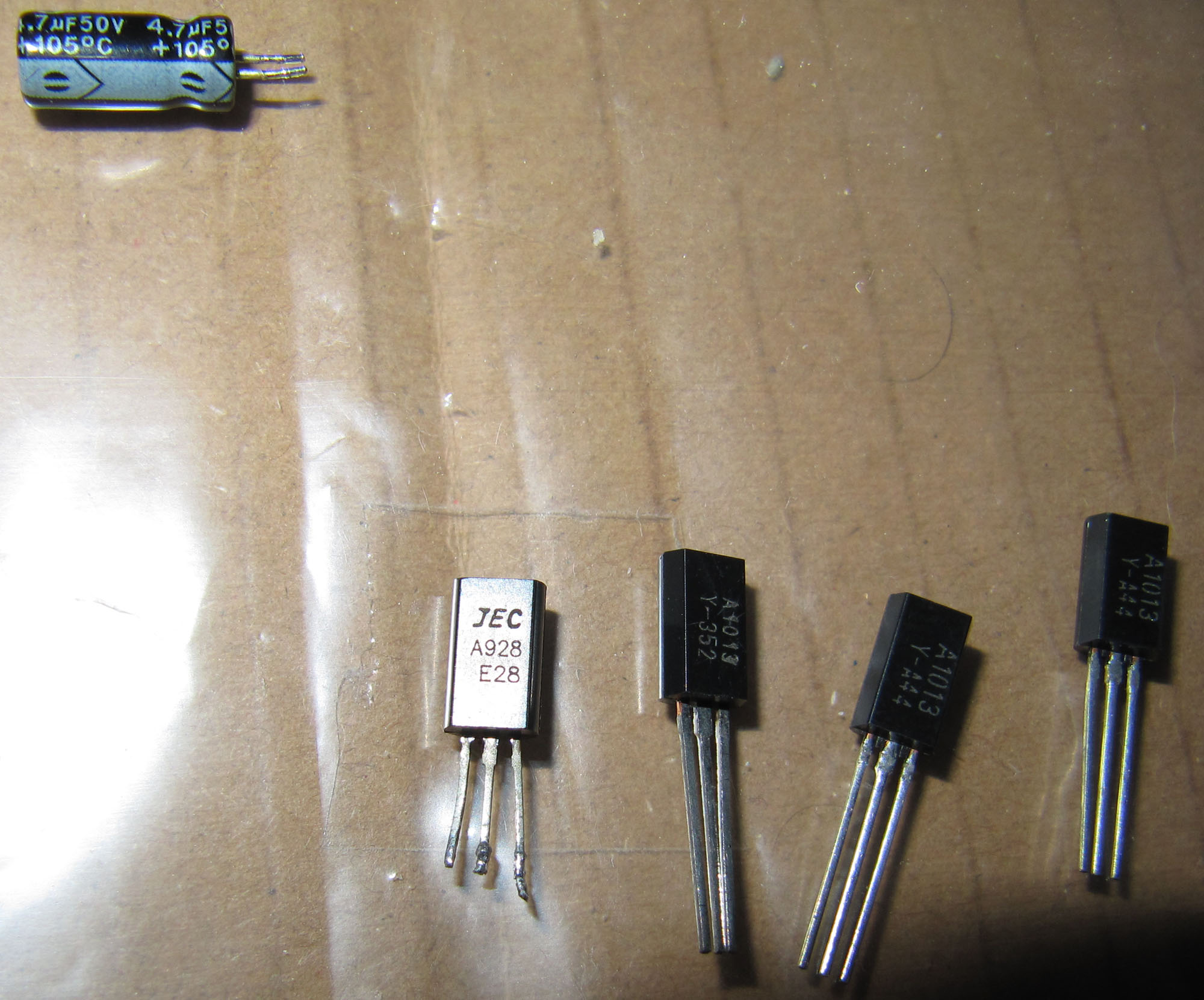

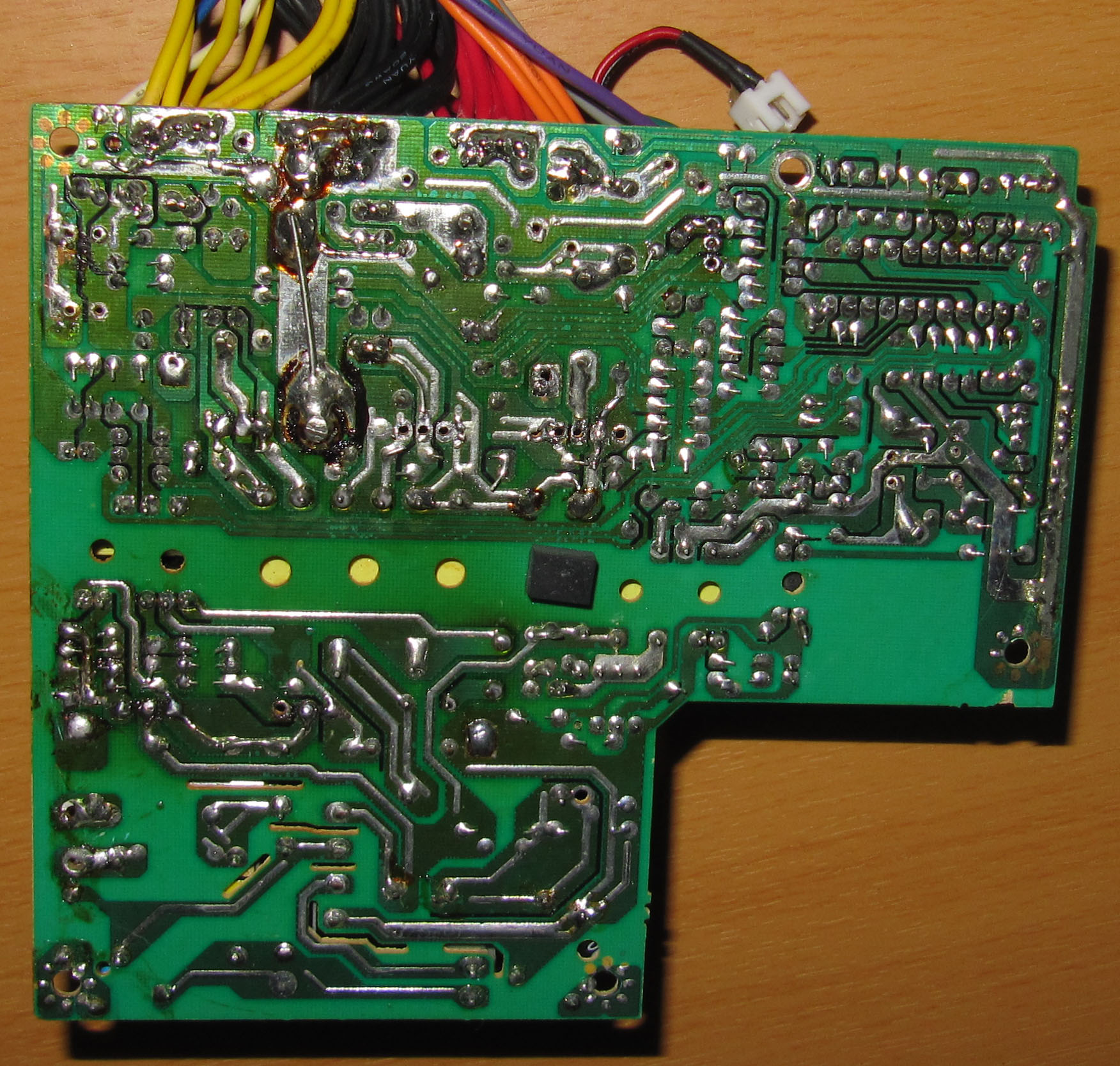

    I found A928, PNP transistor that failed open. I will attach some pictures of the unit later

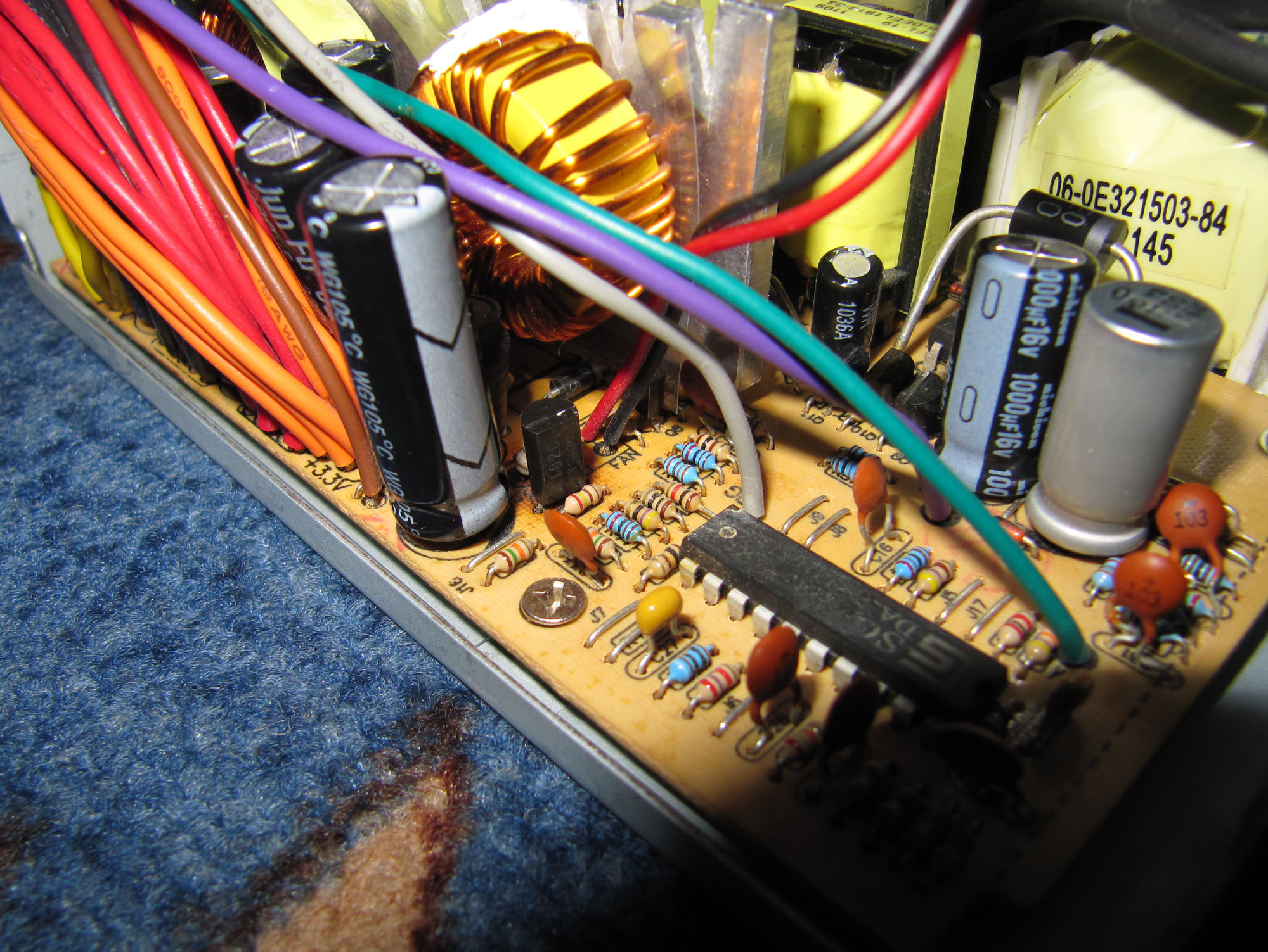

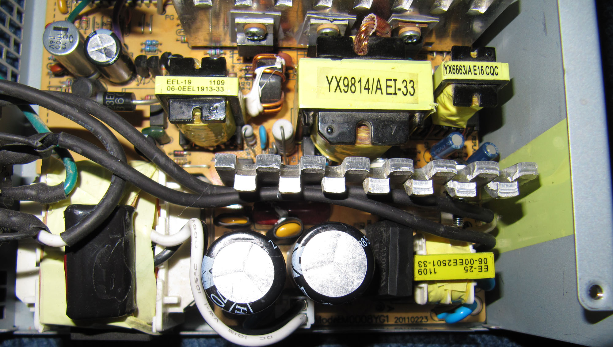

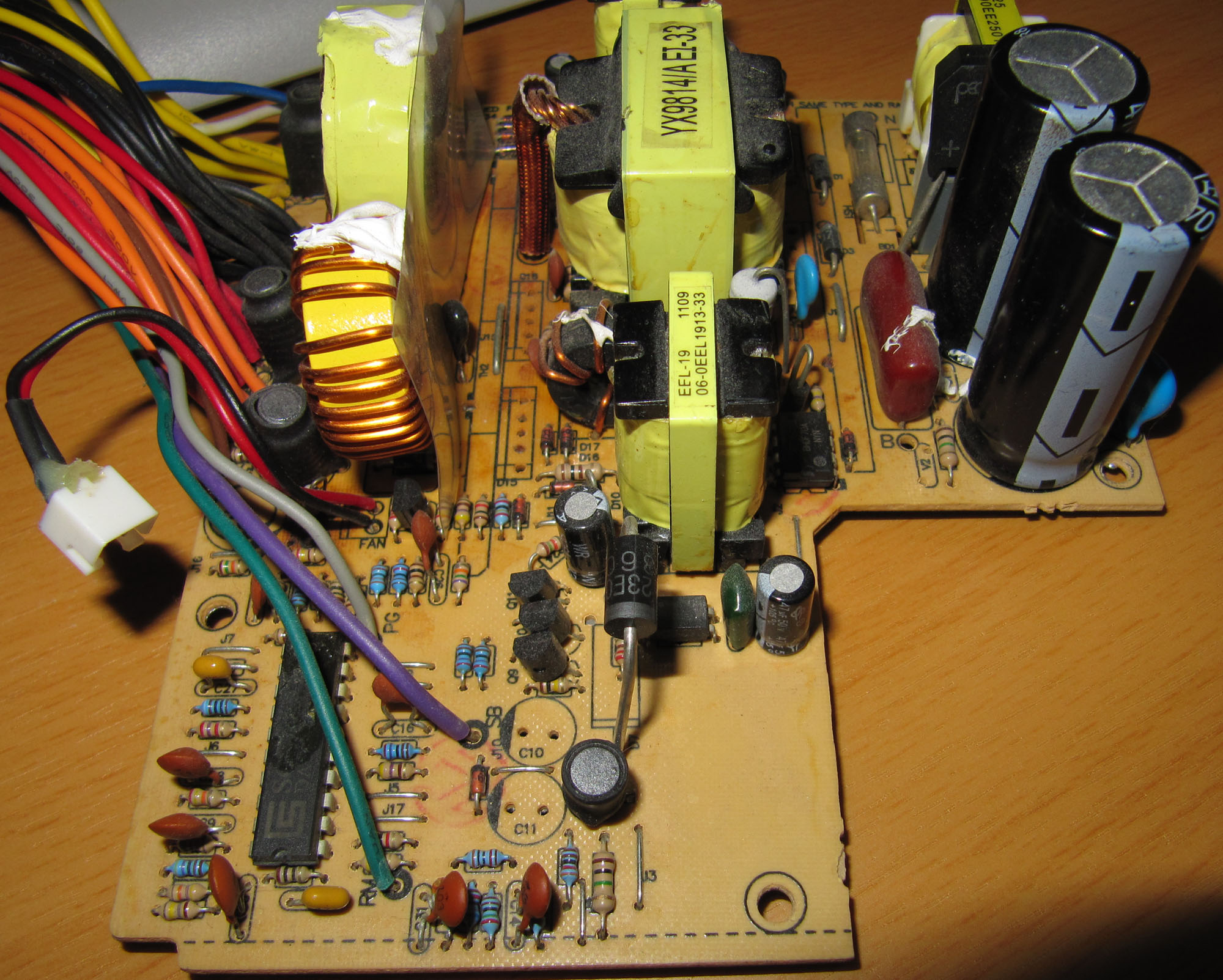

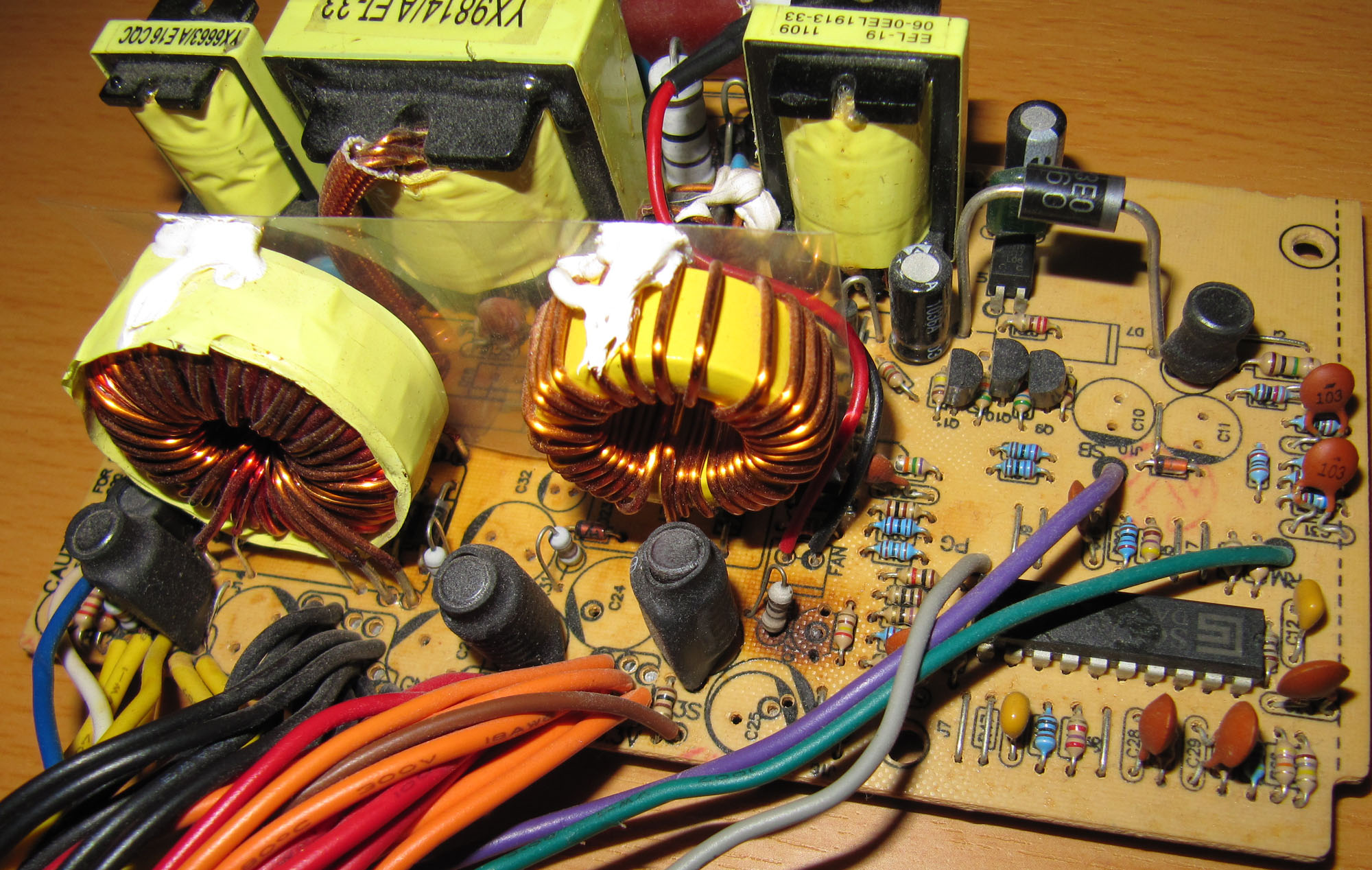

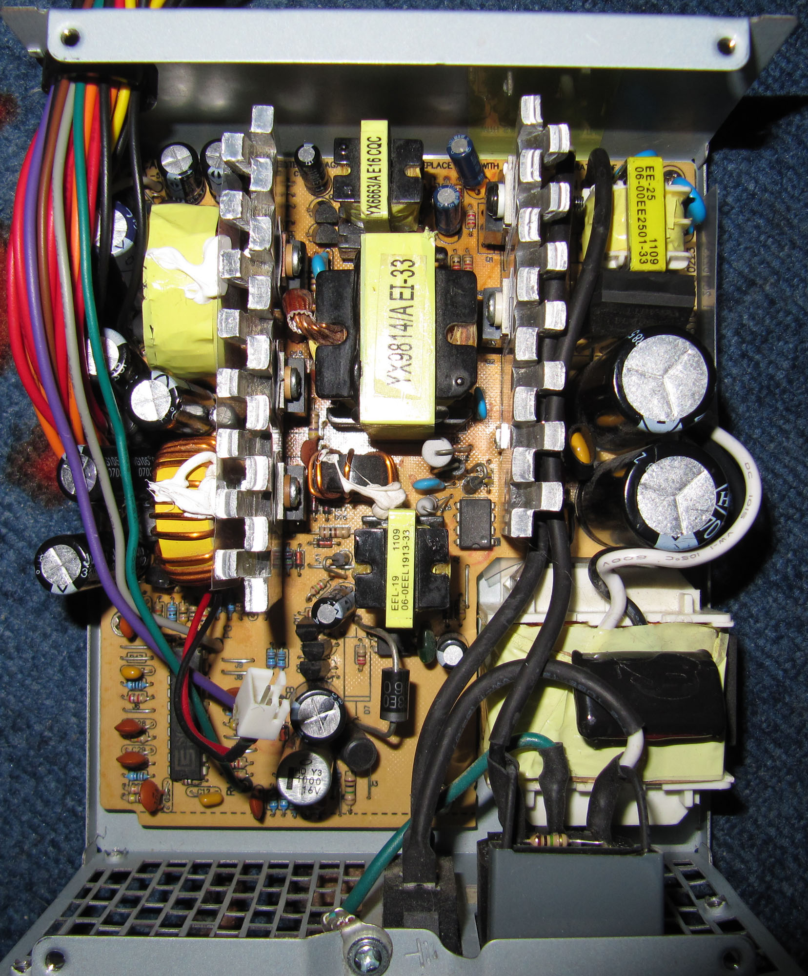

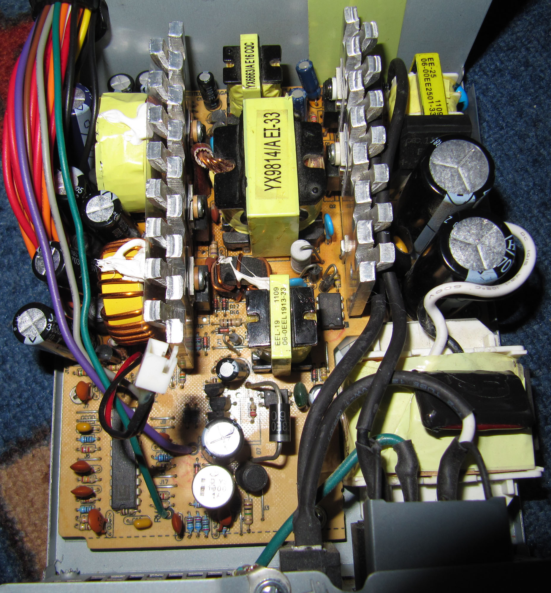

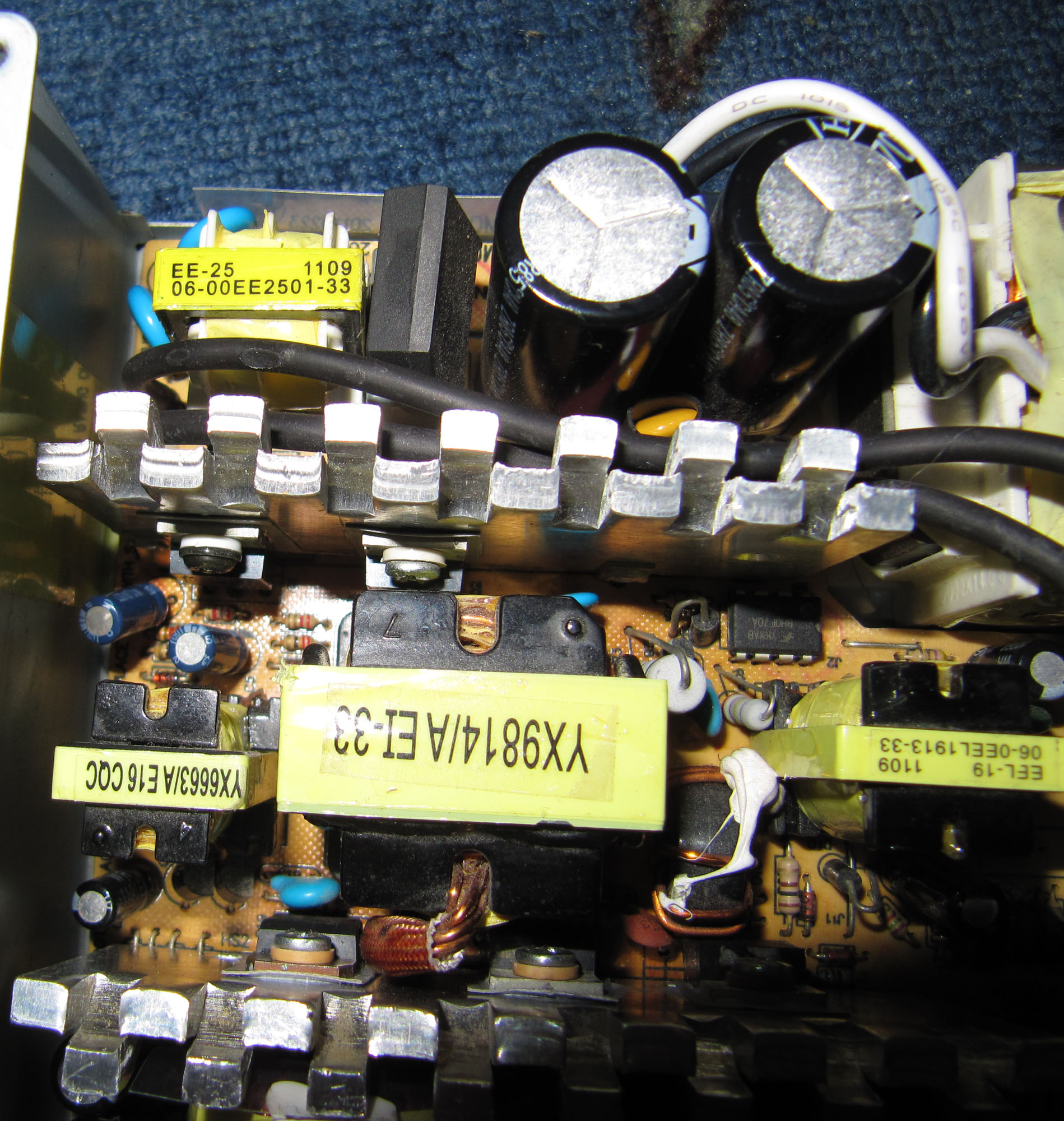

    Re: LC Power LC380M fan seized. Needs repair

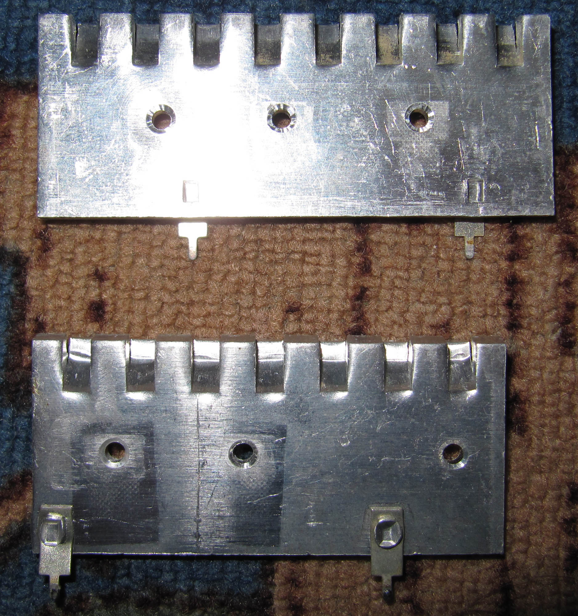

    Pictures after I have removed many caps and heatsinks
      I think your primary transistors are BAD.
      PCB area the heatsinks appears a bit toasty. Did the fan seize? Aside from that and the caps, this PSU looks good otherwise. I like how it uses TO-92L transistors rather than regular TO-92. Still, makes you wonder why that one A928 transistor burned. Was it for the fan controller, perhaps?
      As for the PSU not having an NTC thermistor: well, it does have a passive PFC choke, so that is usually enough to reduce large current transients from the PSU.
      I'm guessing you're going to recap it and use it?
        Yep they're BAD!
        Yeah that fried pnp transistor may have been due to the seized fan. It looks pretty close to the fan output and without doing reverse engineering of the tracks it's likely to be what it's for. Hopefully nothing else failed from elevated temperatures (good PSUs should also do a thermal shutdown from cooling failure?)
        When I had a PSU that had a seized fan and failed, the output filter toroid overheated and insulation melted down, forcing its replacement. Hopefully nothing this bad happened.

          Did the fan seize?
          Exactly! I added some oil and it came back to life.
          Nope, it has something to do with 3.3V regulation, 1 of its legs is connected to the mag-amp coil, but I can't say for sure.
          I am actually surprised that the output toroid coil survived.

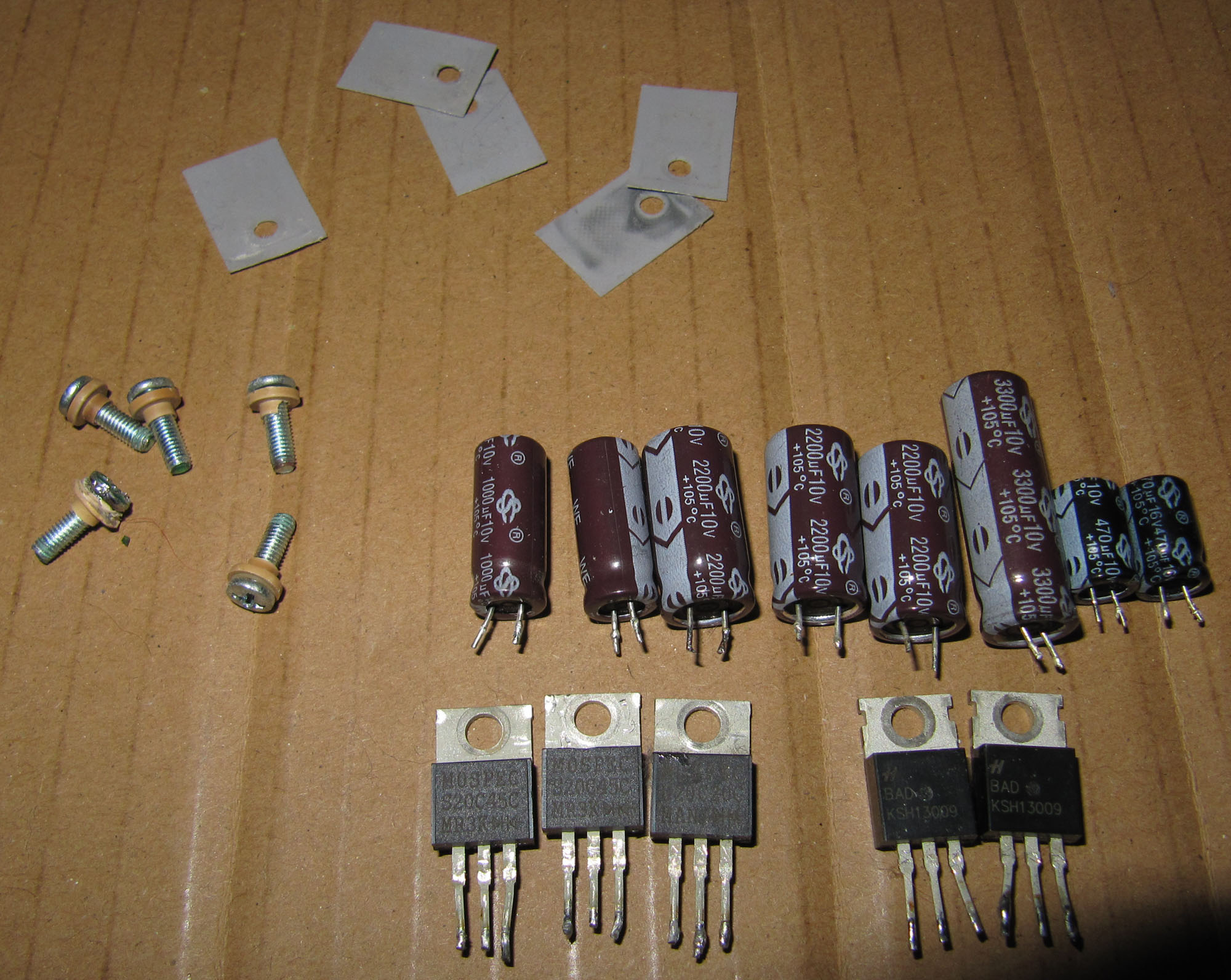

          Well, this is a summary of what I did:
          I replaced failed A928 PNP transistor with A1020.
          Installed 2 movs. Before soldering them, I covered them with heat-shrink.
          Minimum load resistors
          Original --> New
          3.3V: 47ohm (~0.23W) --> no change
          5vsb: something like 1Megaohm --> no change
          5V: 47ohm (~0.57W) --> 94ohm, 2x47ohm resistors in series (~0.28W)
          12V: 240ohm (~0.62W) --> no change
          -12V: 220ohm (~0.67W) --> 240ohm (~0.62W)
          -5V: 220ohm (~0.12W) --> no change
          Replaced U20C20C ultrafast power rectifier for 12V rectification with STPS20H100CT schottky rectifier
          Recap:
          2x4.7uF 50V Ltec for the main switching transistors
          5vsb: 2x 1000uF 16V Nichicon HD 10mm from Intel motherboard
          12V: 1x3300uF 16V Junfu WG 10mm
          5v: 2x3300uF 10V Junfu WG 10mm
          3.3V: 2x3300uF 10V Junfu WG 10mm
                Ah okay. Yes, the 3.3V rail mag-amp circuit does indeed use a transistor (usually PNP-type from what I've seen).
