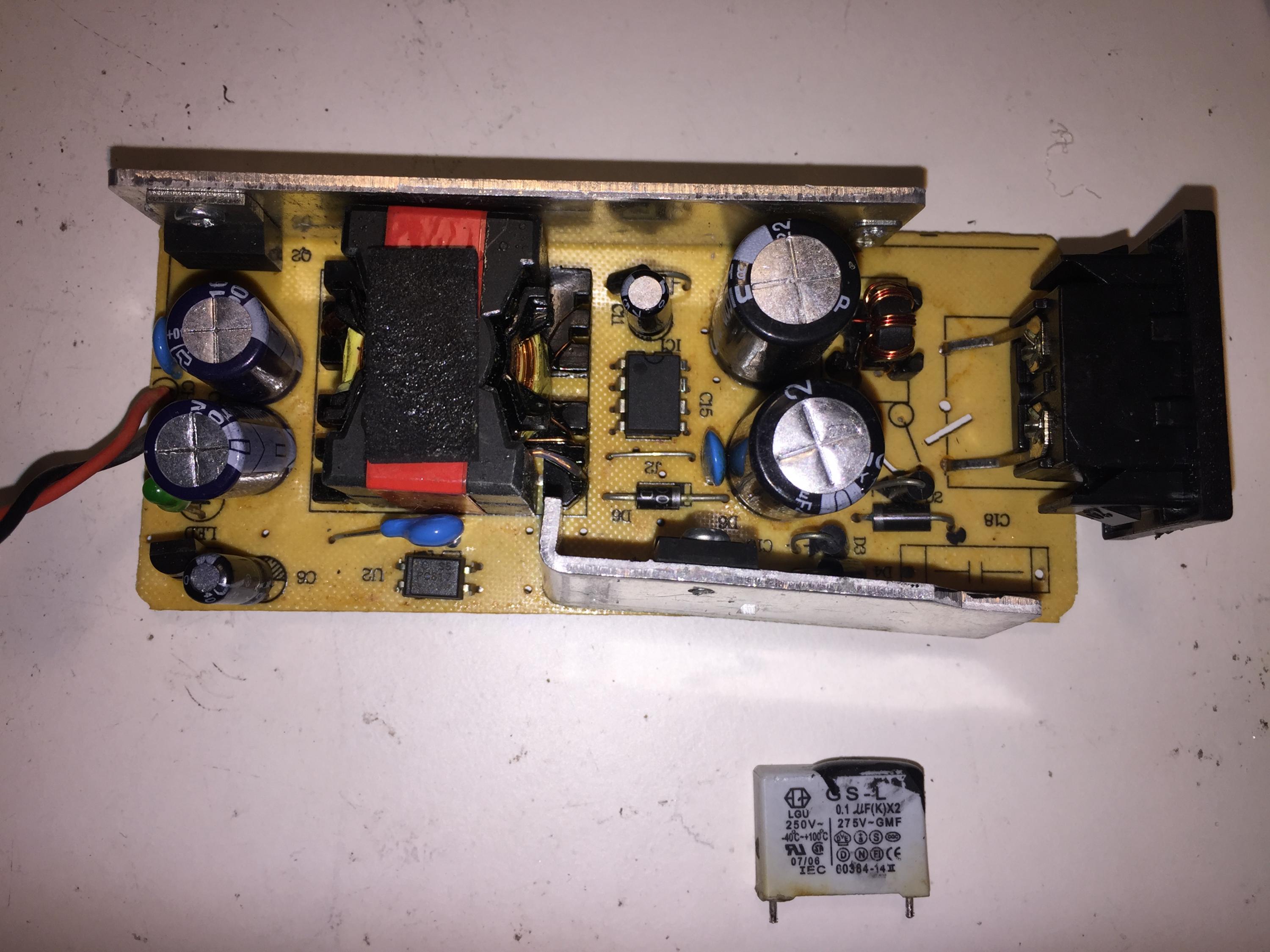

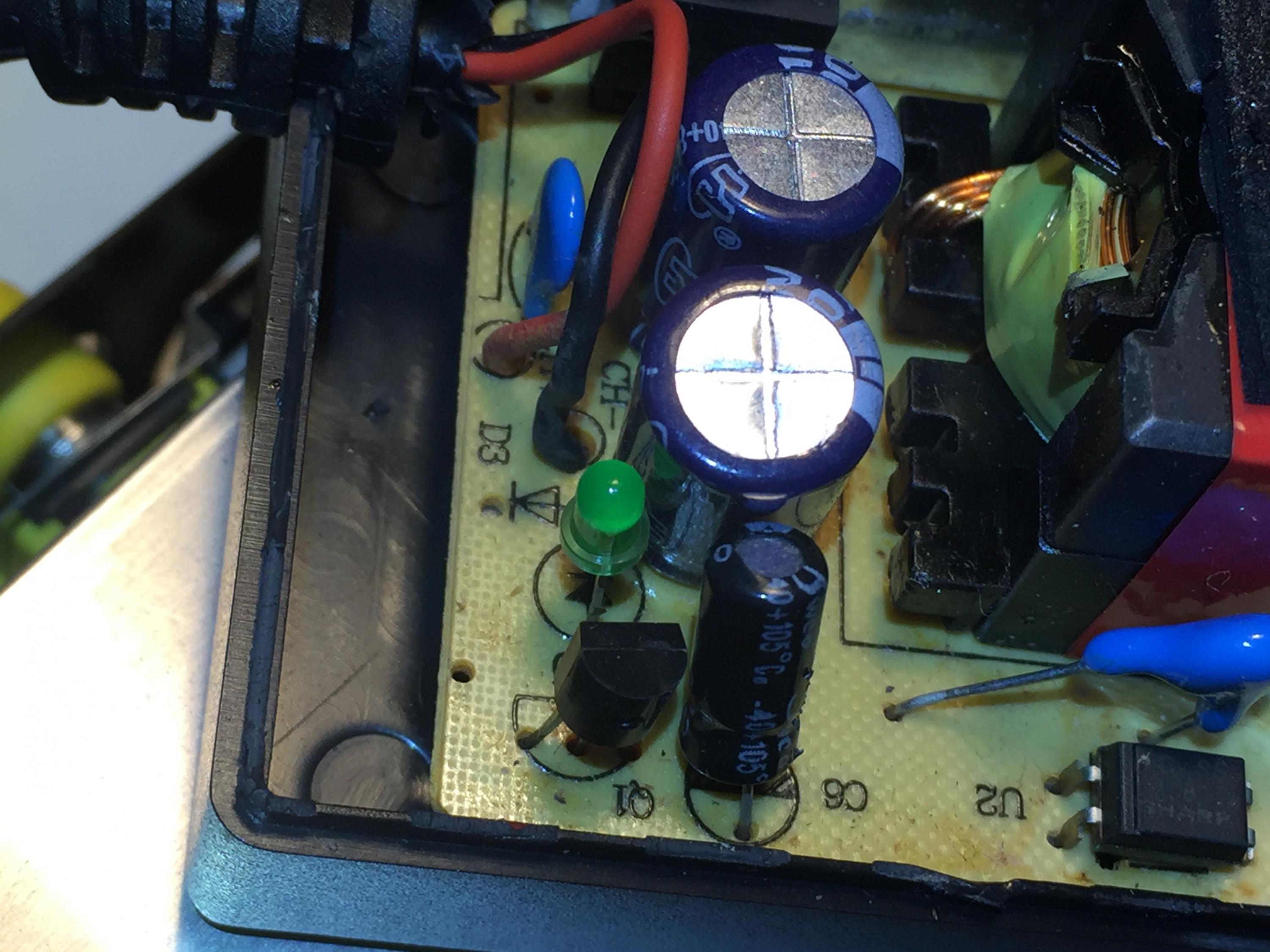

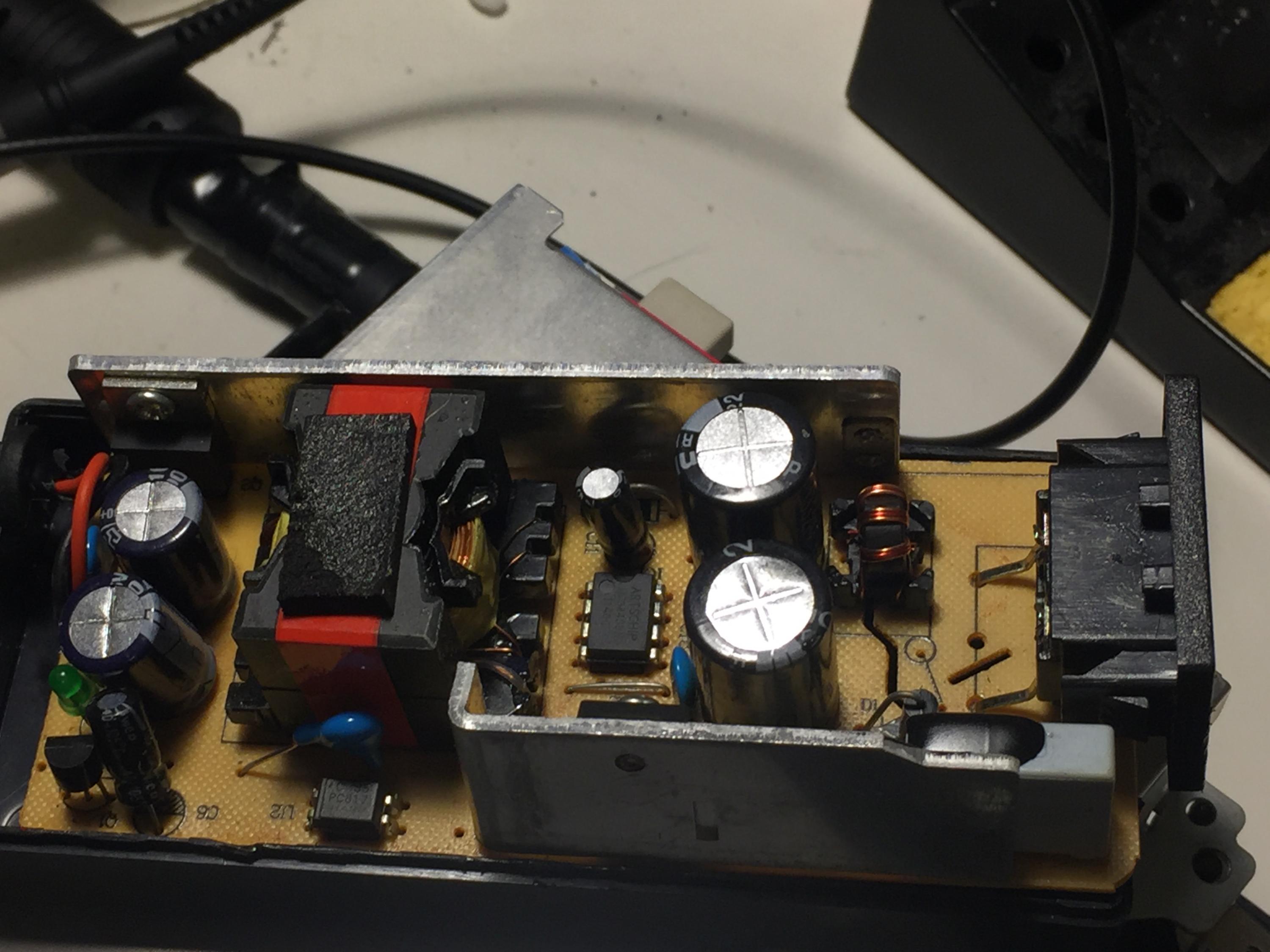

I have a DVDO Scaler (iScan HD) from Anchor Bay that asks for 6V 5A DC input. The power supply that was provided with it (secondhand) is... err... was a generic, made in China, 5V 5A AC/DC converter.
It has been awhile since I had last powered it up (and it hasn't been plugged in during this time). Upon plugging it in today, I got a rather abrupt, metallic "pop" from inside, and the LED never lit again.
So I decided to crack it open and take a look.

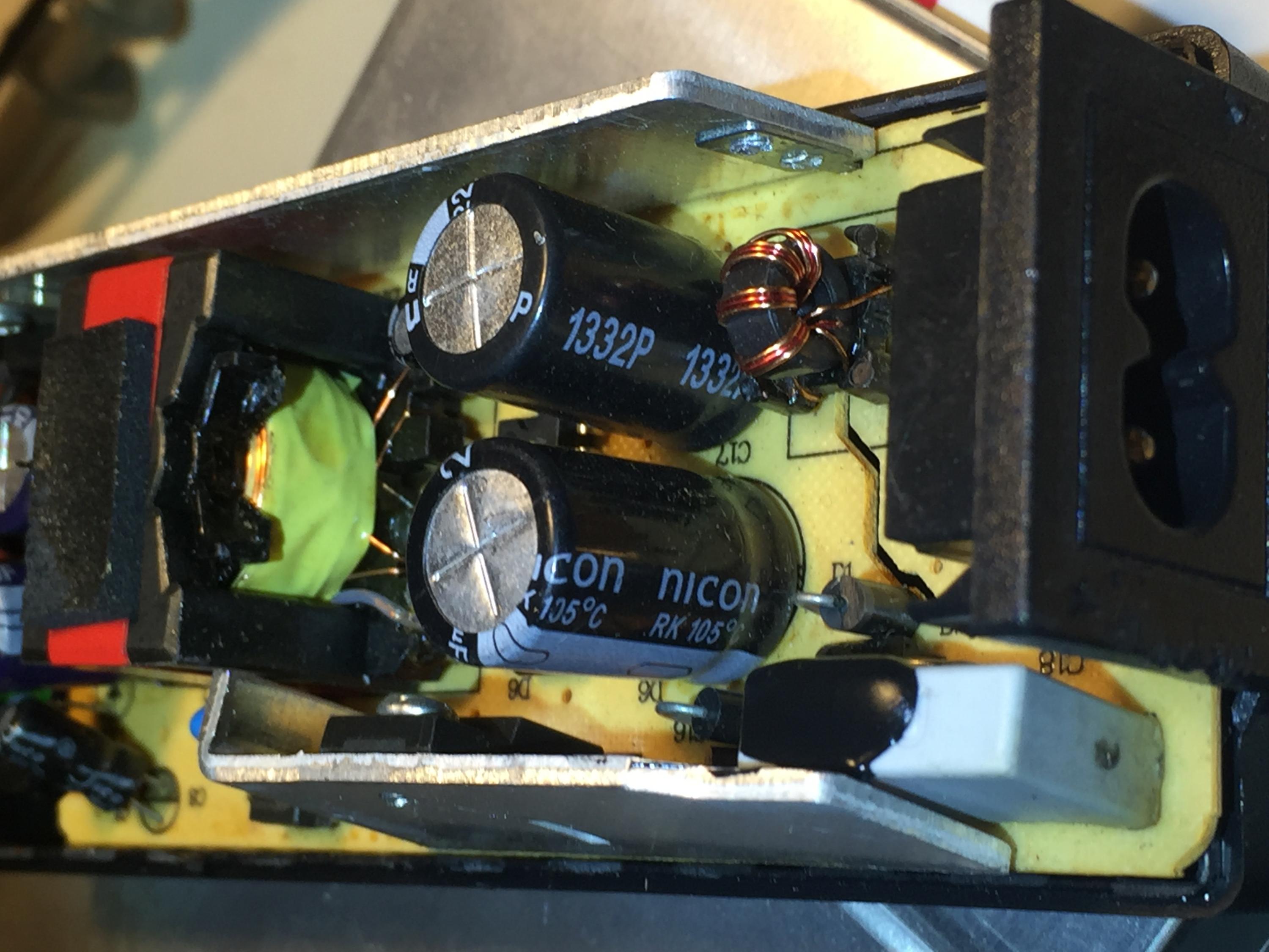

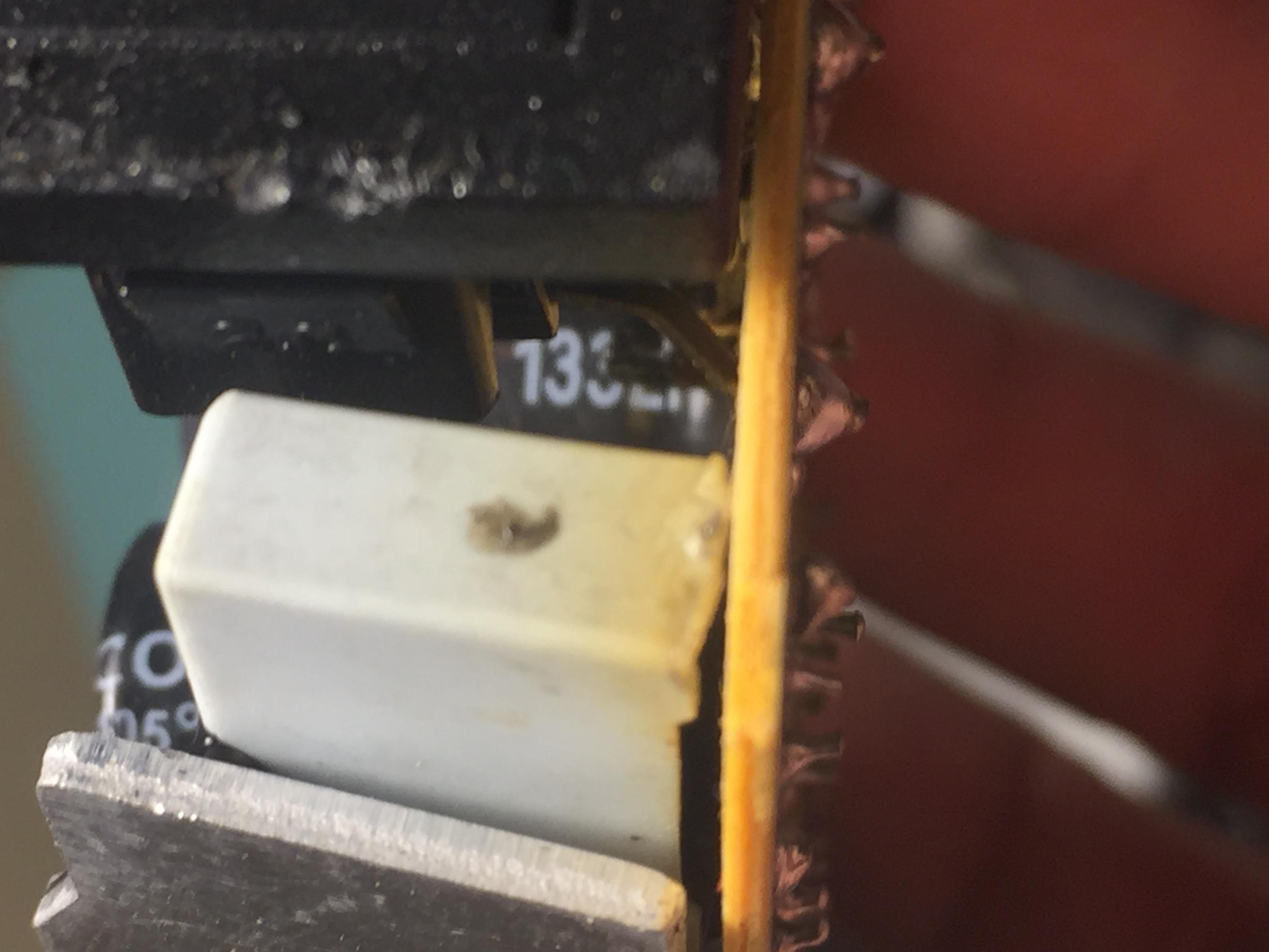

What blew? The X-cap? That is my best guess - based on... smell.
Should I be using this? No.
Have I been? Yes.
Do I want to spend money to buy a legit replacement? Not really.
Arg. Haha. Photos for your amusement and comments.
