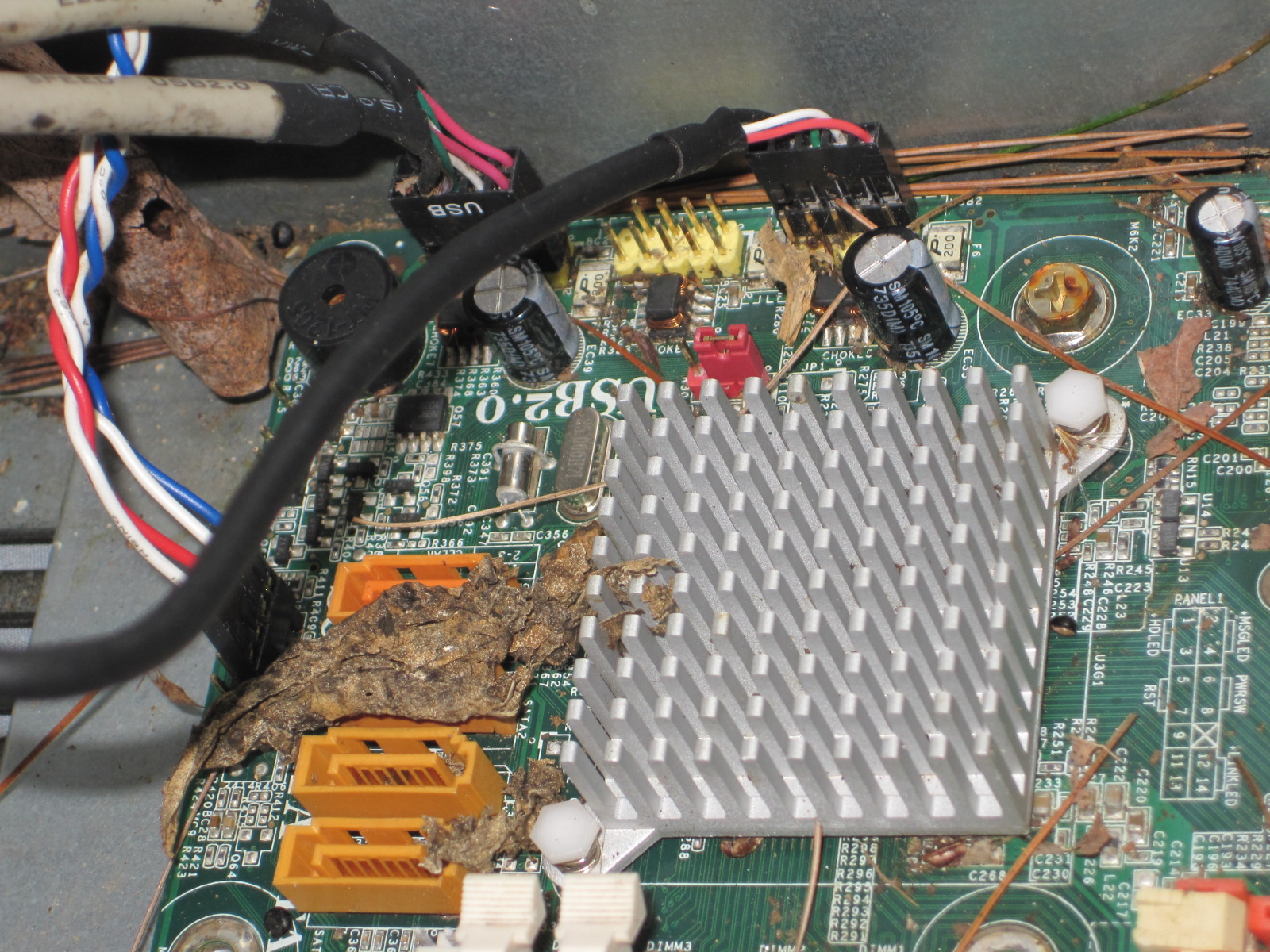

                psu's often arent worth it, but whole pc's can be.
                i found a dell once that had been in rain all night with the side open - rain AND black mud in it from car wheels.
                so i took the mobo & cpu/heatsink out, washed them in the sink, dried them.
                and.... - they run fine!
                  Yeah, I found a computer like that before as well. Wasn't much mud in there, but there was a bit of dirt and lots of wet dust everywhere.

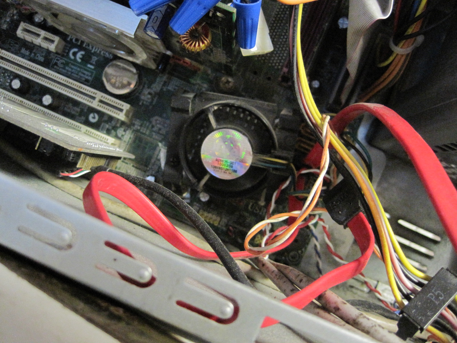

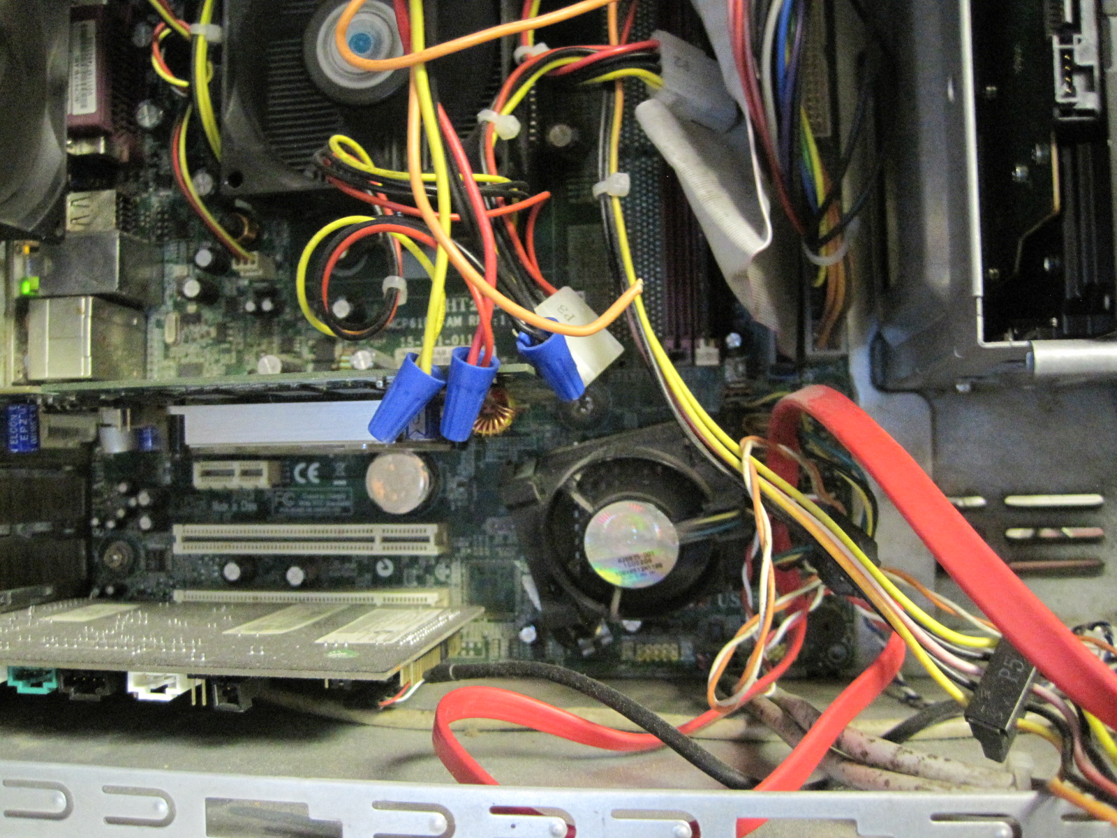

                    I acquired my present 'daily-driver' PC, a T5234 Emachine, from a (formerly) drug-scum residence, it had been sitting out with all covers off in the weather for several months, there was even pill-bugs and dirt heaped up along one section of motherboard - took it home, totally disassembled and cleaned it.
                    Turned out to have a bad memory stick, bad PSU, an over-heating southbridge (I think
                    that's what it is called) and a bad memory slot. It's been running more or less Ok for a bit over 7 months now with a 2 gig stick of ram in it's one good slot and a little fan rigged to blow constantly on the SB, the screw visible in the first pic is now the mounting-screw for the fan. Considering where it came from, def' ghetto...

                          Re: Say you got a free PSU from outside... and it was raining
                          Cool!
                          What I find even more amusing is that your eMachine T5234 appears to use the same motherboard as my Gateway GT-5656: an ECS MCP61PM-AM v1.0 (with the only difference that mine came equipped with all 4 RAM slots). Good thing you added the fan on the chipset there! Those motherboards have a GeForce 6150/6200 chipset, which is known to fail at elevated temperatures due to nVidia's bumpgate issue. So the fan should definitely keep it going. However, what you also need to be beware about that motherboard is: BADCAPS! Mine came mostly with Sanyo WG or WX (I forget which), but it also has a few TK and OST. Some come completely with TK, and some (particularly the purple SM-GM versions) come with all-OST. Either one of those would be bad news, as both OST and TK caps are known to fail on these motherboards.
                          So if you start getting crashes and other goofy issues on a cold boot, you may need to recap yours if it has TK or OST caps.
                                  Originally posted by momaka
                                  Those would be the caps that filter the RAM buck regulator output (1.8V). Probably why the RAM was dead when you found the PC. And if you didn't use high quality caps, that's also a possibility why your board appears to have a dead slot.
                                  Another possibility is corroded/dirty contacts in the slot from all the rain/water. My system came with 3 GB of RAM (2x 1024 MB + 2x 512 MB), but sometimes one of the slots would not recognized a RAM module. I changed the two OST RLP caps responsible for filtering that with polymers, but that didn't fix the problem. Re-seating the RAM enough times finally fixed it. So you may be able to get that "dead" slot working again if you work a RAM stick in and out of it enough times. (oops, that's starting to sound dirty, so I better stop here. )
                                  That's interesting about the replacement of caps taking care of an intermittent memory problem, another clue to add to my collection. I almost always learn something new reading your posts 8-)
                                  As to the replacement caps I used, they're used and tested ok on an esr tester, and, since the board then would start up I left it at that. After a few cycles of different diagnostics (and errors) on various memory-sticks I took a closer look at the memory slots and realized that on the bad slot one of the contacts is no longer sticking out enough to make contact with the DDR module - so I depopulated that slot and then memory testing passed. I tried to see if the little contact could be repositioned in the slot, but don't see anyway, at least not without knowing how they're made.
                                  I suspect the bad memory slot is responsible for not being able to clone any HDDs successfully the several times I tried to use clonezilla on this machine, but I could be wrong and some other quirk is responsible for the lack of success.
                                  I'll have to try using my one other, non-crippled pc that has both pata and sata, been a couple years since I made any backup drives.

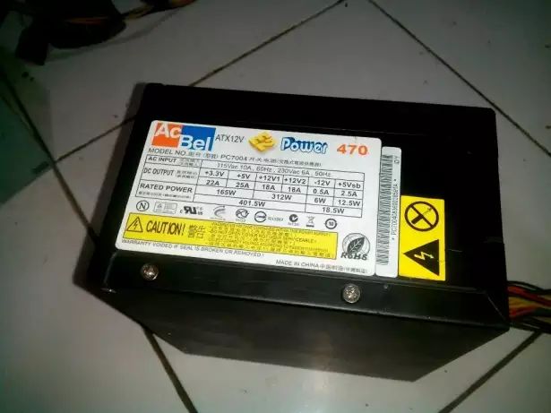

                                    i've just "save" a few old acbel 470 series from someone junkyard.
                                    And it's raining season in my country.
                                    After dry it with heat gun and open the case for a few days, it's time for the truth..
                                    The funny thing is, all of these is working fully functionally.
                                    No sound, no smell, no drop voltage etc.
                                    I bet, the ex owner of these think the psu is broken.
                                    Because when he/she tried to jump green and black cable, the fan doesn't spin.
                                    Well, this one is need minimum load for 5v and 12v rail to run...
                                    And yes, it's full of rust before..
                                    After some painting job, all of these is ready to work.
