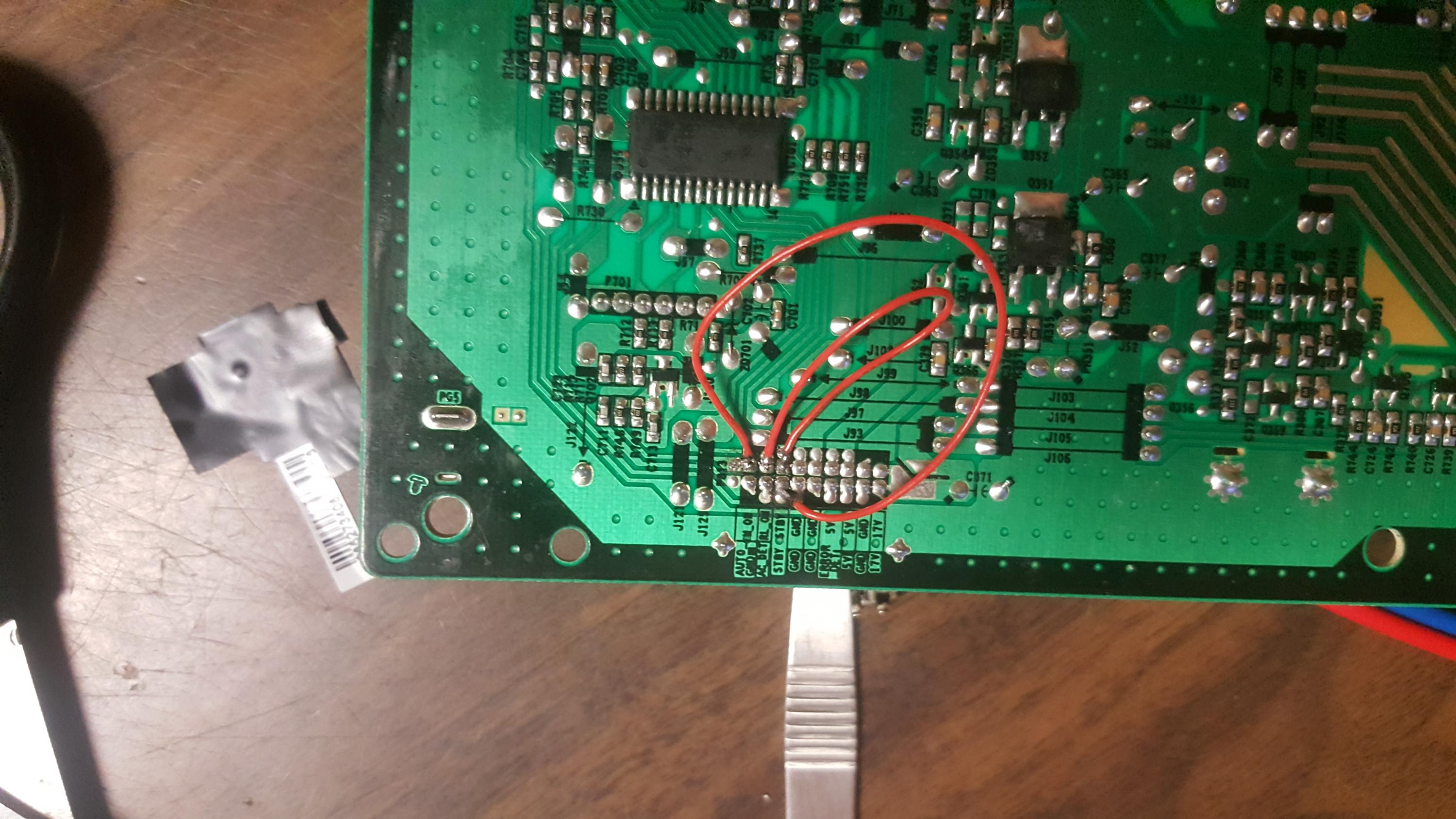

    If I can see clear close-up pics of the labels on the jacks, I may be able to show you how to 'self-test' the PSU.

        andrew let me know if this picture is more clear

          Make a test light with a pair of 120Vac 100W lightbulbs connected in series. With ALL the connectors removed from the PSU, connect a short wire from the std-by pin to the M-ON pin and another short wire from the std-by pin to the RL-ON pin. Connect now the two (2) ends of your test light across Vs and GND. Plug the PSU into the ac and what do you get??Test light does not glow-then PSU bad. If the test light glows bright then Vs is OK. Measure M5V-None-then PSU not working properly. Yes-PSU probably good. Measure Va. Is it within spec? No-then PSU not working. Yes- then you have confirmed your PSU is OK and can go ahead and look for your problem on another board.

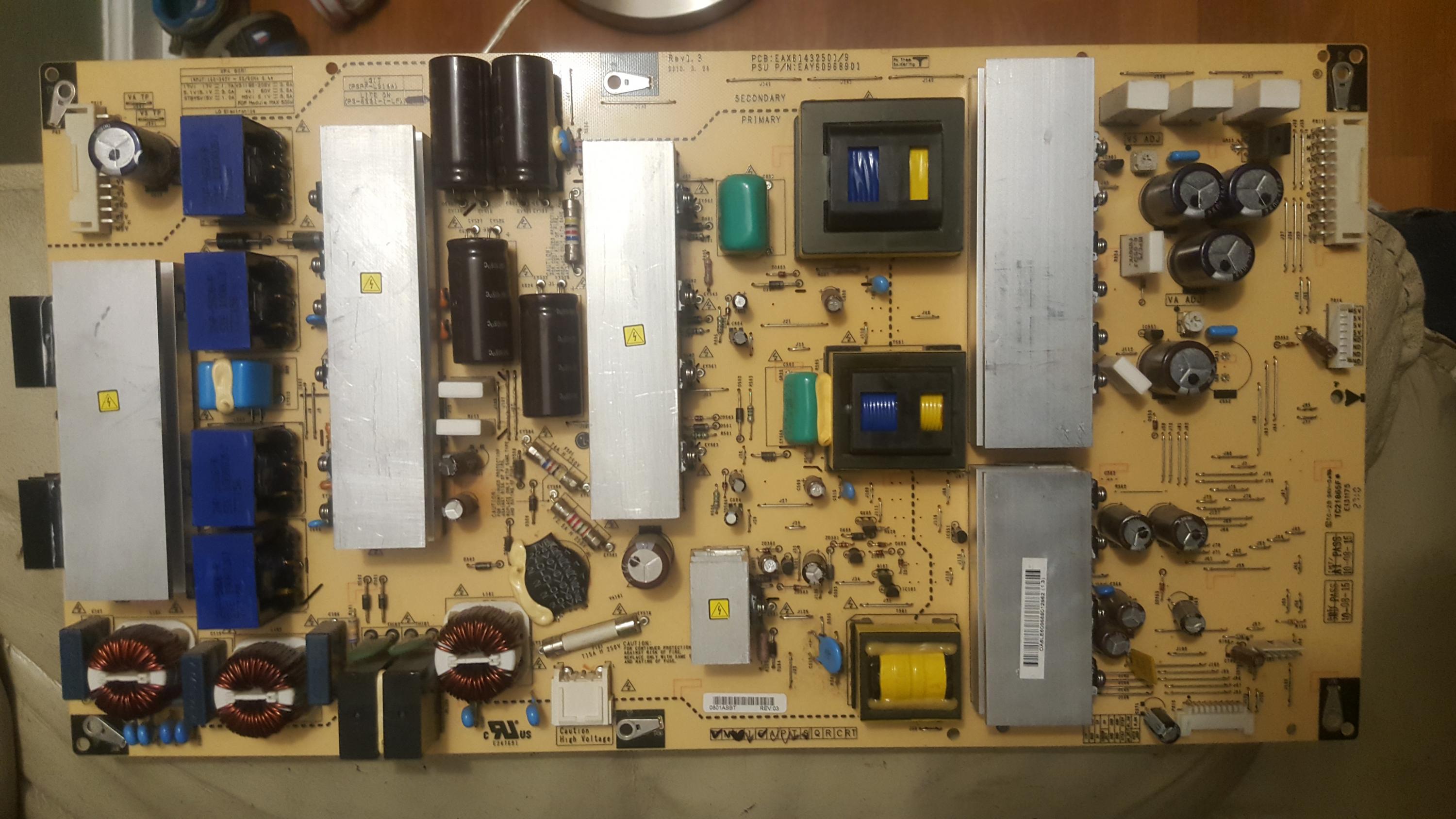

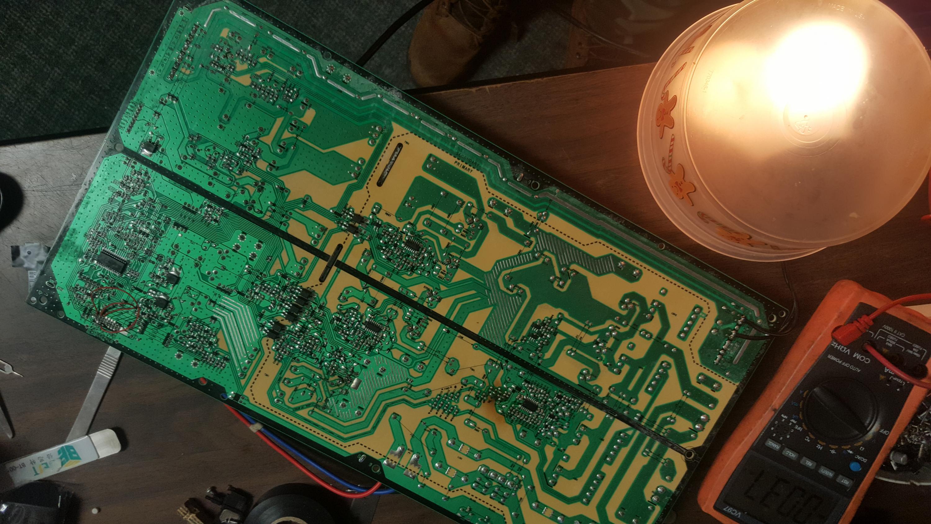

            andrew, i did that test and this what i got:
            first time i plugged it to the power clicked and the lightbulbs turned on, va good, vs good, and m5v good too,
            the voltage on the connector goes to the motherboard good as marked on the board, DC-DET 5v.
            i unplugged it and plugged again, started clicks for long time before the lightbulbs turned on
            i let it on for couple minute, then i installed the board to the tv quick. tv turned on showed the pictures, turned it off/on clicks no power.
            unplugged the tv from the power for 2 hrs when i tested the tv after that the tv did turn on fine. turned it off/on clicks no power.
            is it it a bad caps as budm mentioned!!!
            do i have to change all the caps in the hot side?

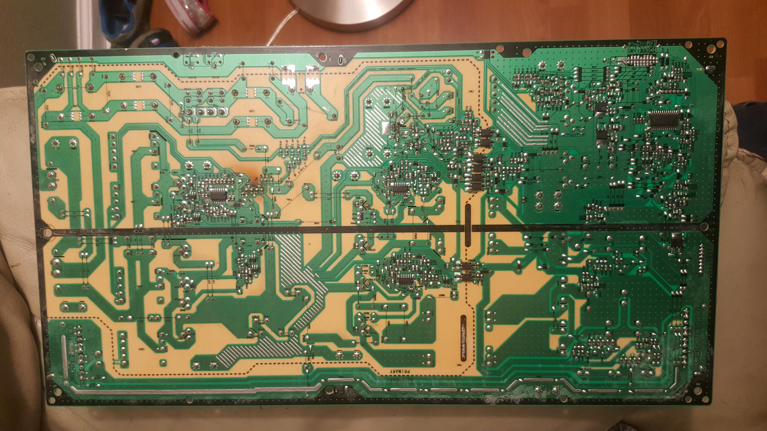

              More picture of the test

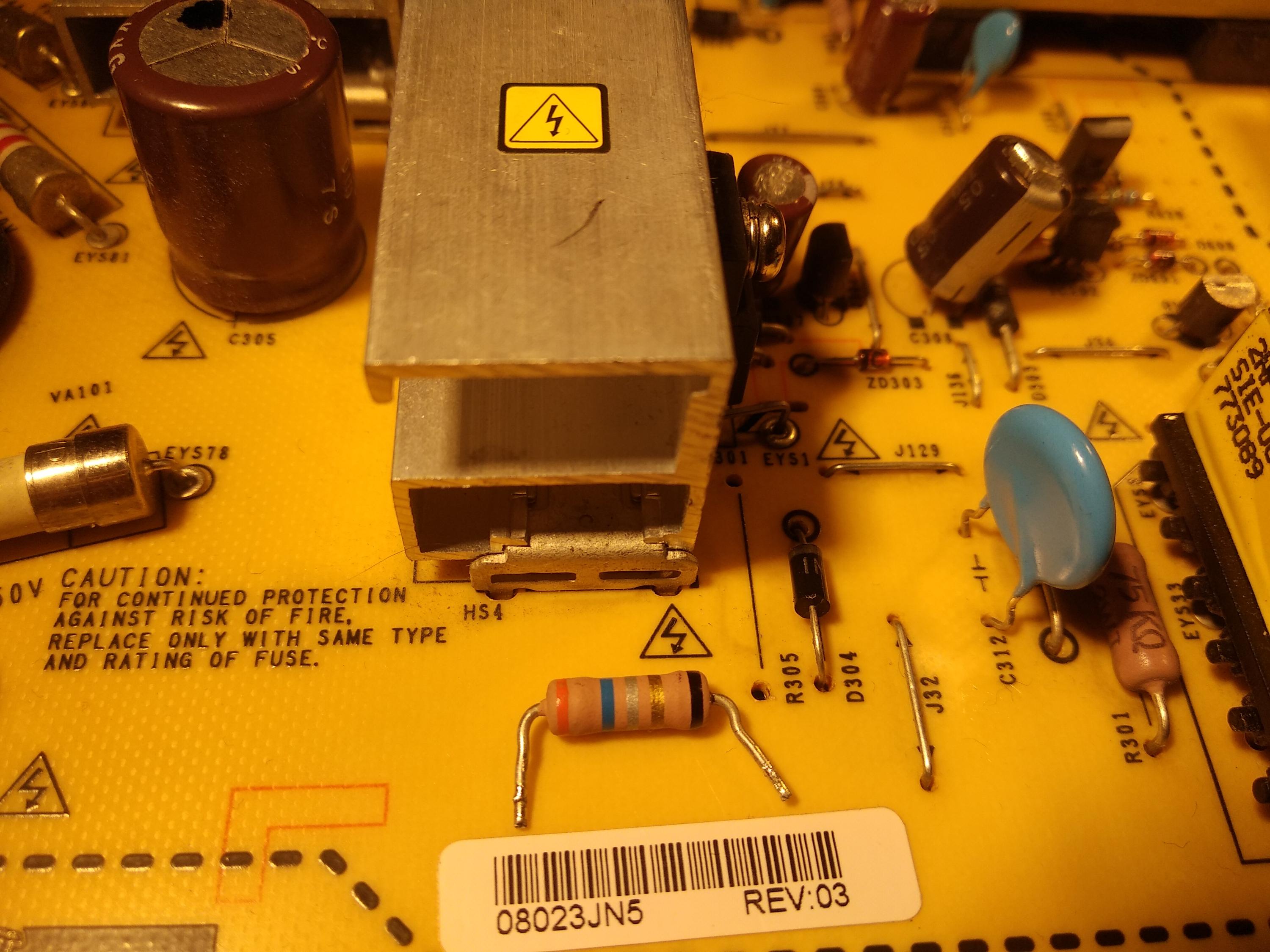

                        i have same problems with this TV. I replaced voltage regulator and D304, it worked for one day and back to clicking again. Then i started to snoop around D304 and see there is also R305 that seems bad, reads only 0,7Ohms outside the board.
                        Can you help me determine the value of this resistor? That schematic jpg doesnt contain values of all resistors and diodes. Looks like the colours are: red - blue - silver - gold - black. Silver is probably grey, because it cant be silver on 3rd position, right?
                        Maybe someone also knows the value of D307?
                        Thank you!
                          Re: LG 60PK250 POWER SUPPLY EAX61432501 clicking
                          If it is RED, BLUE, SILVER then that will be 0.26 Ohms 5% (Gold), Black is the temperature coefficient of 250 ppmk. You need to subtract you meter probes resistance from the reading to get the resistor's resistance. If it is actually Violet then it will be 0.27 Ohms which is common value.
                          Bottom line, there is nothing wrong with that resistor.
