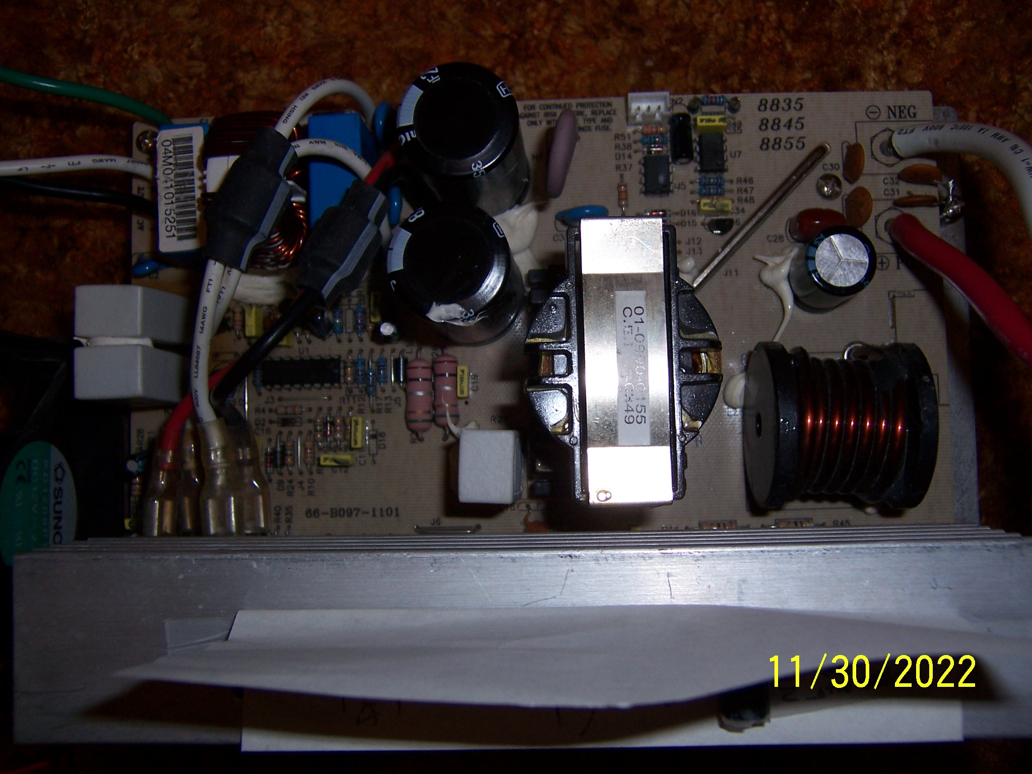

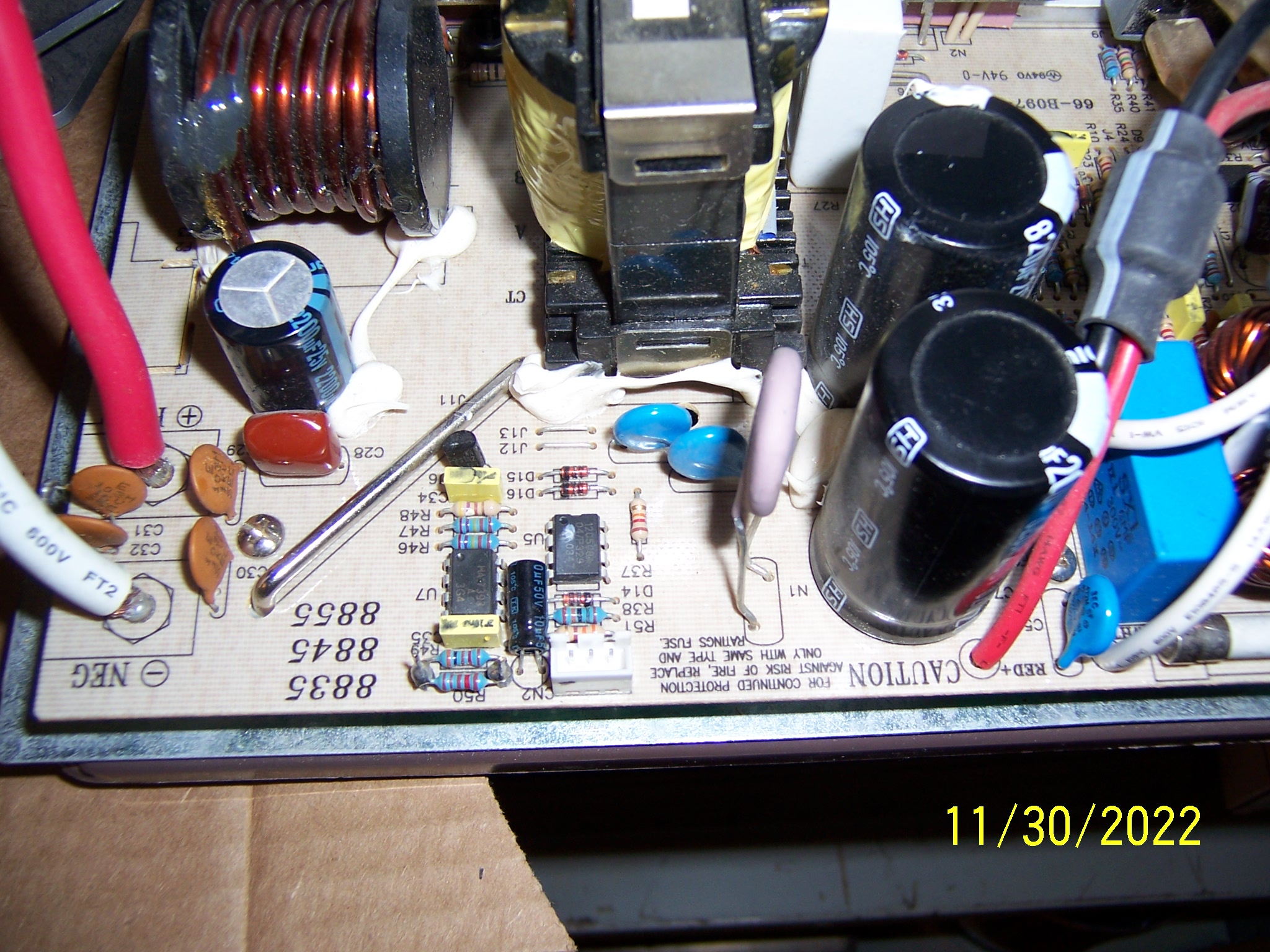

                                          Hello, I was given a WFCO-8845 for salvage but could not resist fixing it. And yes it was just the one electrolytic cap (C10) that caused all the trouble. It works fine now but the two power resistors sure get HOT, even with only a 2.5 amp load. Many thanks for your sharing.
                                          I have one question, can someone tell me what the 3 pin connector is for. I never saw the board installed. Thanks.
