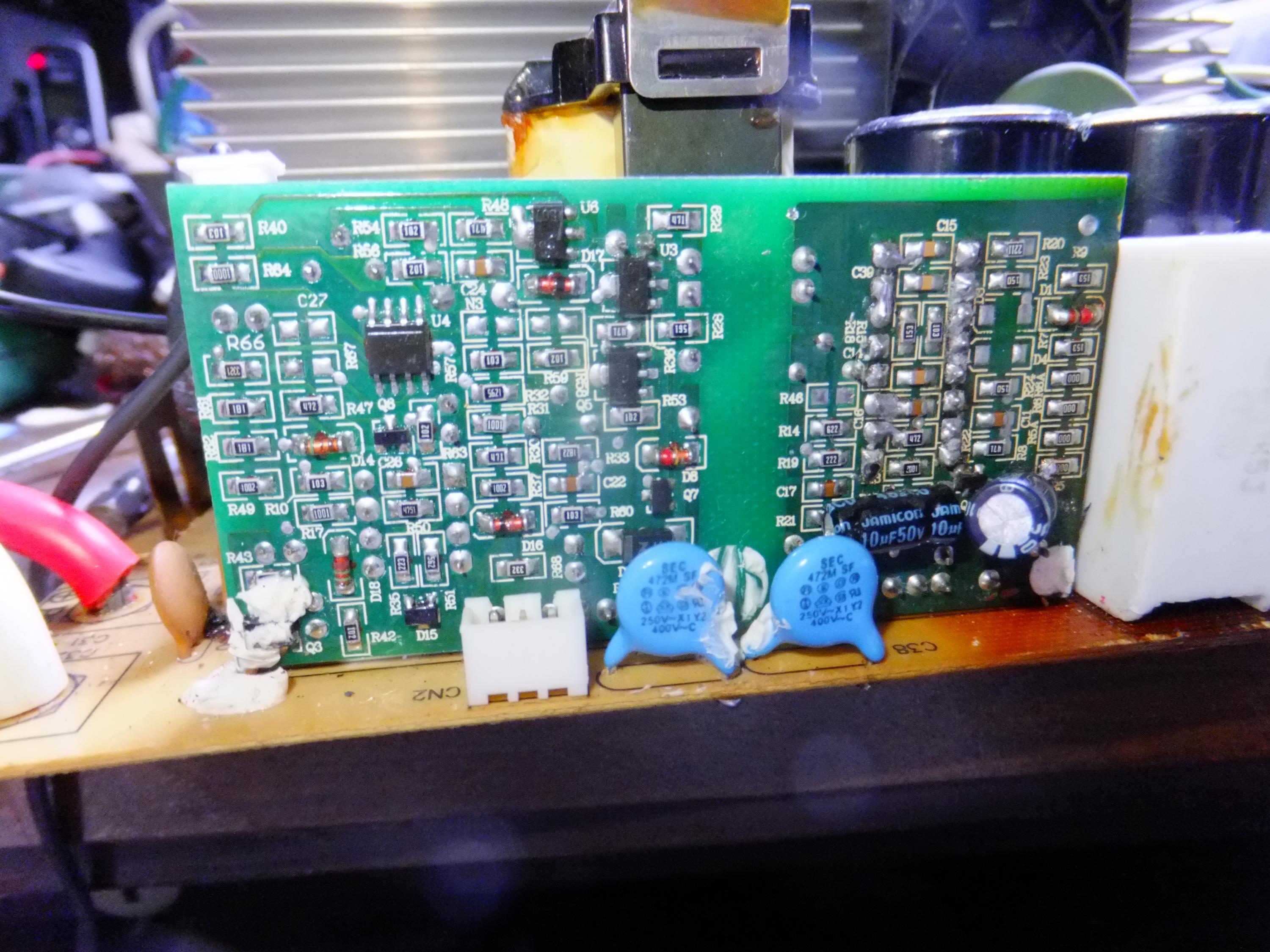

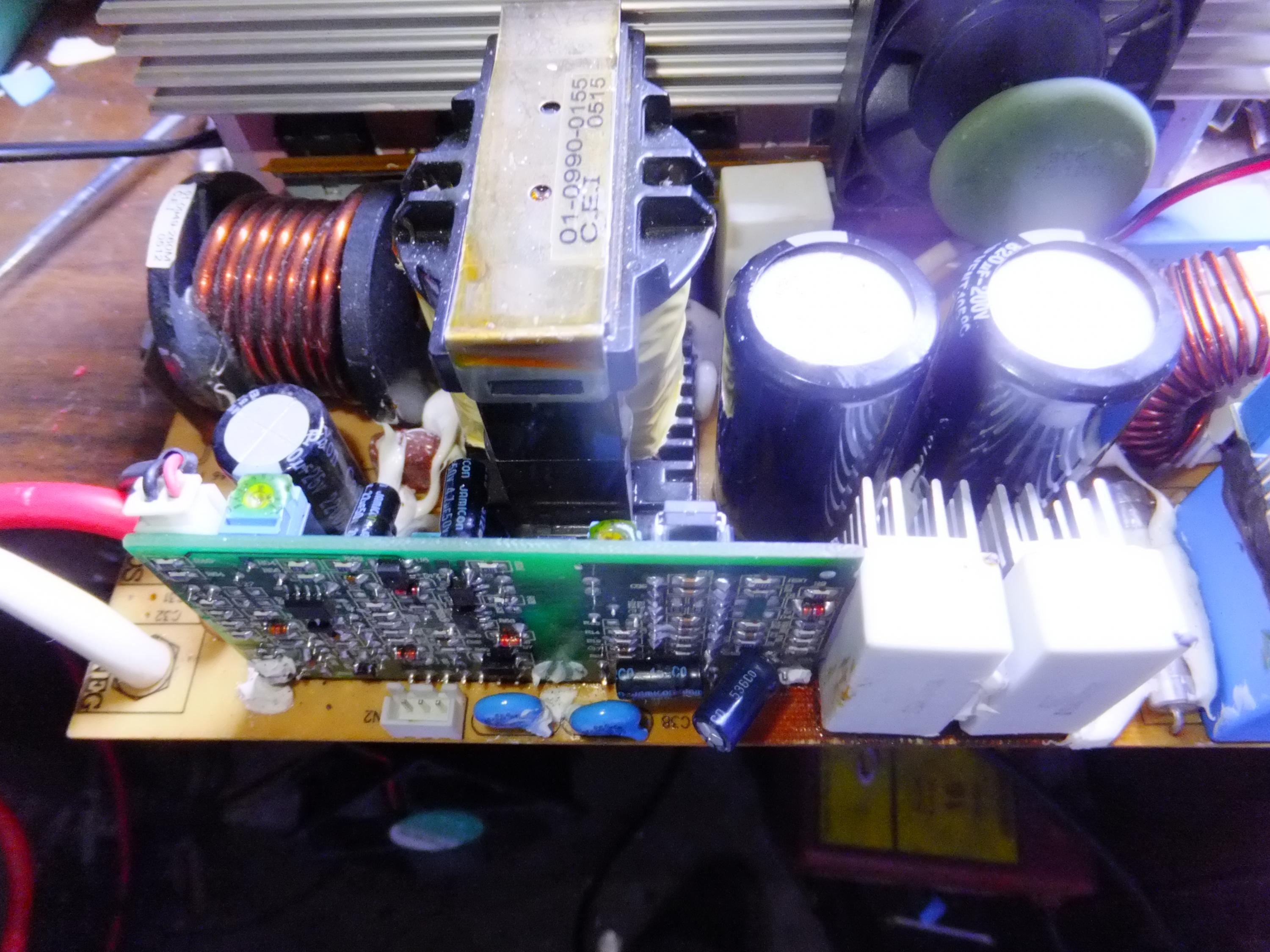

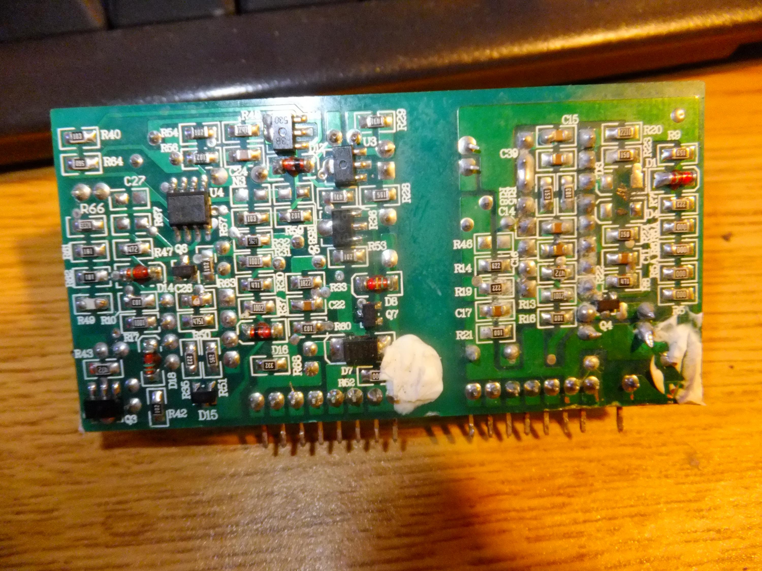

    I will have to remove the small daughter board later and take more pictures.
    • Shane711
      • Dec 2014
      • 493
      Re: WFCO Camper Converter need help understanding KA3846 SMPS Controller

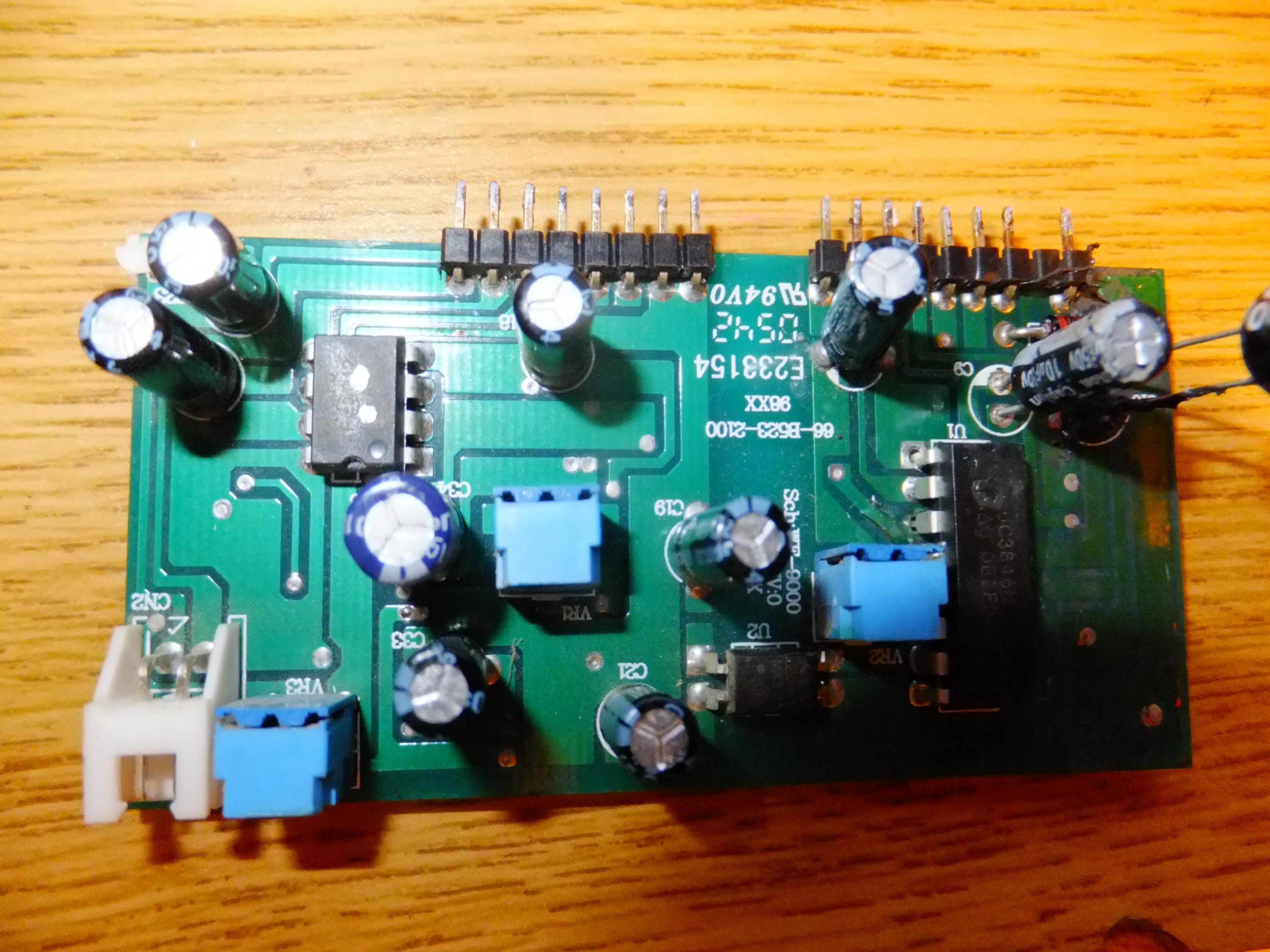

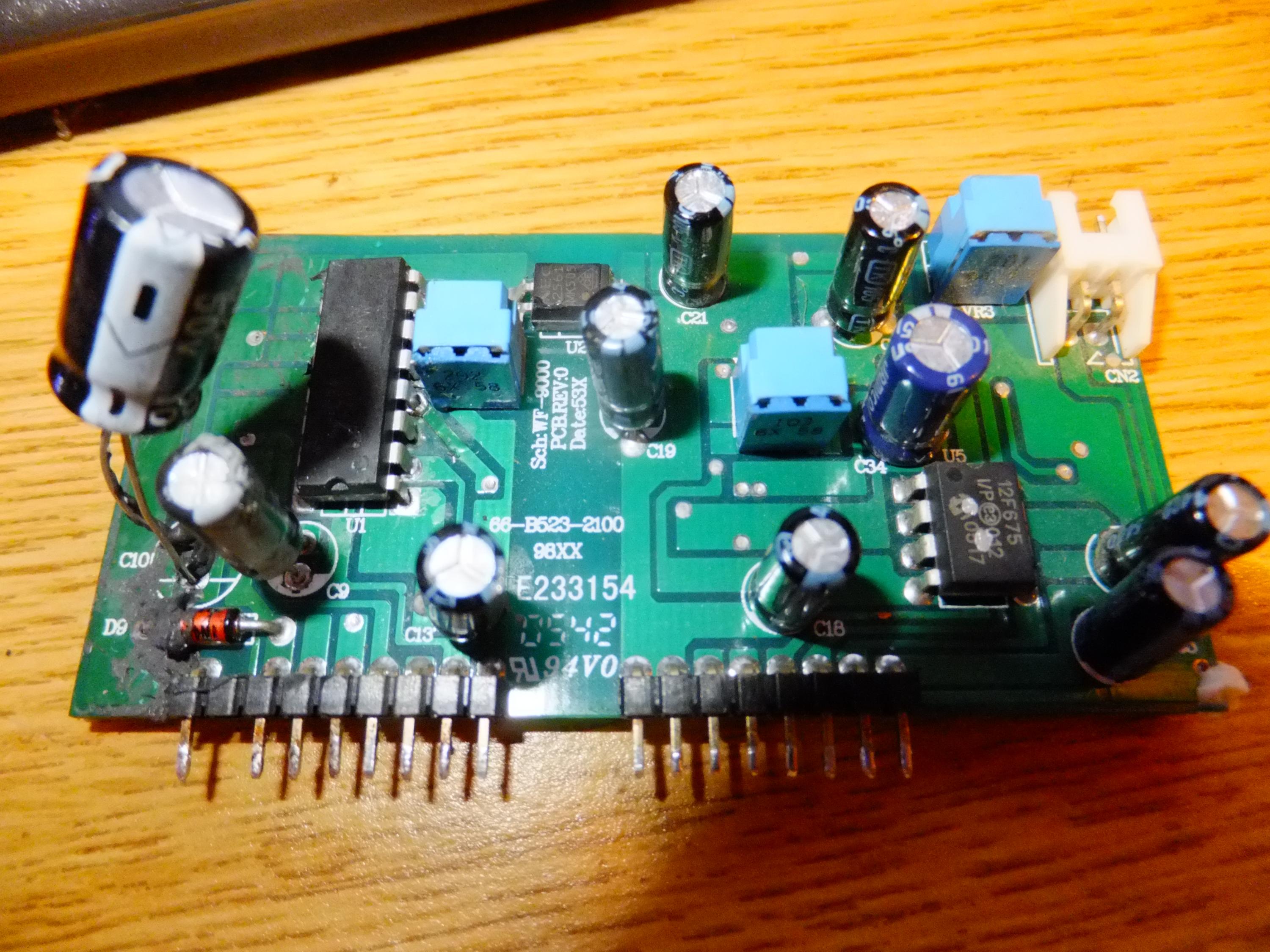

      Here are some pictures. This is the daughter board. It has a PIC 12F675 IC. My next step is to remove the IC and see if I can copy the program.
      But in the mean time I have to figure out why this board is not putting out power. I will have to recheck all the caps. The PIC 12F675 may have the unit in shutdown mode for some reason. When I repairs these if I just change the caps it works but if I change out the KA3846 SMPS Controller then the circuit stops working and I can not get it to turn back on. I am confused about this and I need help.

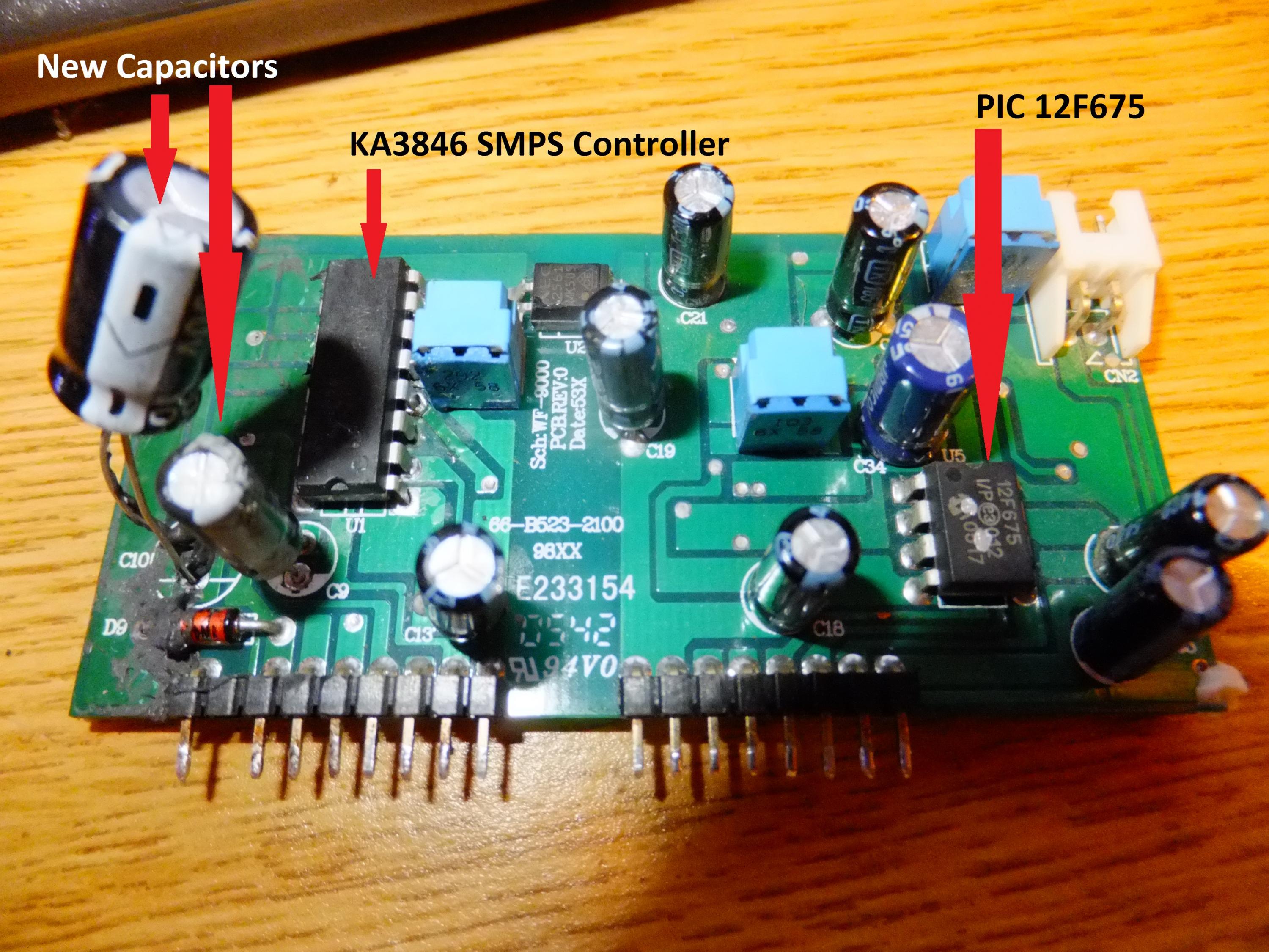

          So today I figured out there was a bad connection on the KA3846 SMPS Controller and I fixed 1 unit so far. I have 2 more of these that I will be fixing in the next few days. If anyone needs help fixing theirs I can help. Looks like I understand these boards at least 90%. As time goes on I should become an expert on these. So far I have been able to fix everyone except for 1. The 1 I could not fix has a burnt out transformer and I could not but a new one; the person that had it reversed the polarity on his battery.
          I have fixed 15 so far and I have 6 more on my bench to be fixed.

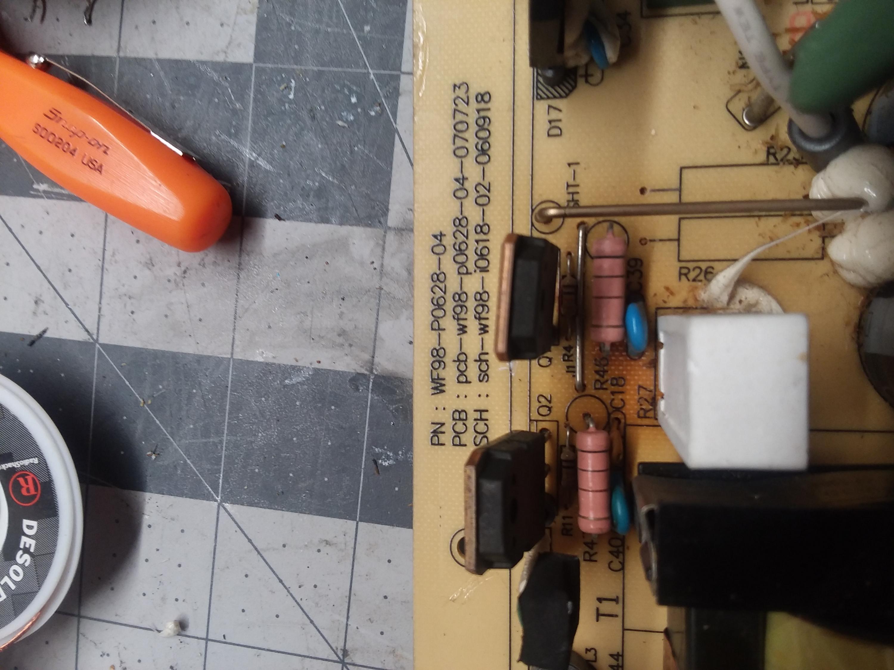

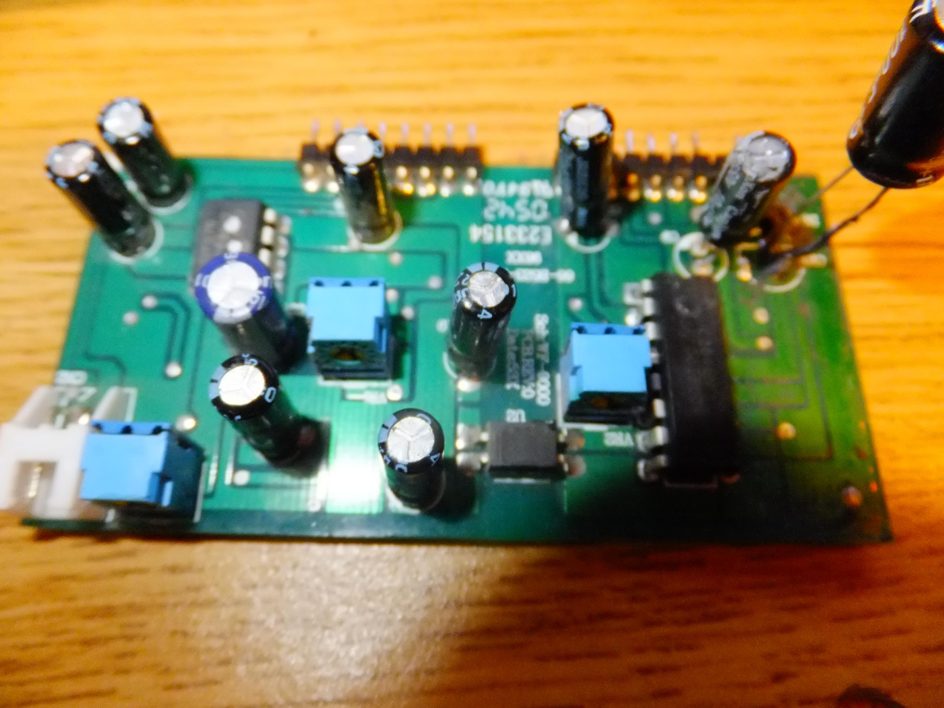

            Shane711 I'm working on the same power supply. Do you happen to know the value of c18? It's on the main board in between the 2 large red resistors.
            • Shane711
              • Dec 2014
              • 493
              There are a few different models, can you provide a picture of the circuit board and I should be able to tell you the value.
              • shadetreetrader11
                • Oct 2015
                • 230
                Tell me if you need more pics. C18 is the cap in the top picture in between the two red resistors.

                    Sorry it took a while. 471K 1KV

                      470 pF, 10%, 1 KV. The "K" means 10% tolerance; "M" would have meant 20% and "J" would have meant 5%.

                        So after a little more investigation I found that almost all of the caps on the control board were shot. The majority of them were open. I replaced them and it started working again. Thanks for the help guys.

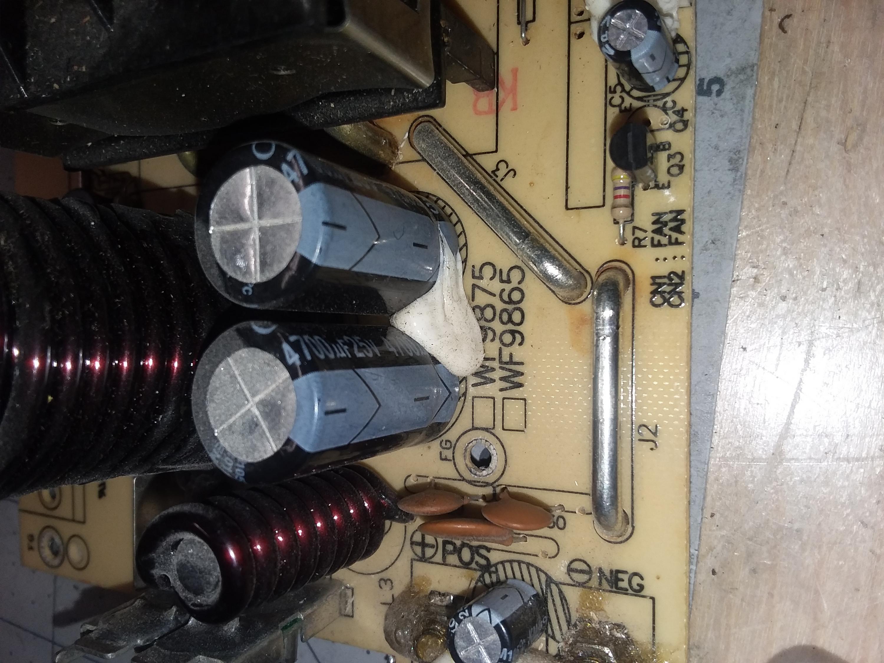

                          The reason the caps go bad is because they are too close to the (Rectangle white resistors), Too close to the heat. So you have to protect them from the heat. I move the caps to the underside of the board.
                          • PeteS in CA
                            • Aug 2005
                            • 3578
                            • USA, Unsure of Planet
                            Unless you're talking about vacuum tubes, heat is pretty much never your friend in electronics. Travelling Wave Tubes are used in microwave power electronics, so not all vacuum tubes are dinosaurian relics or for golden-eared audiophile-devotees.

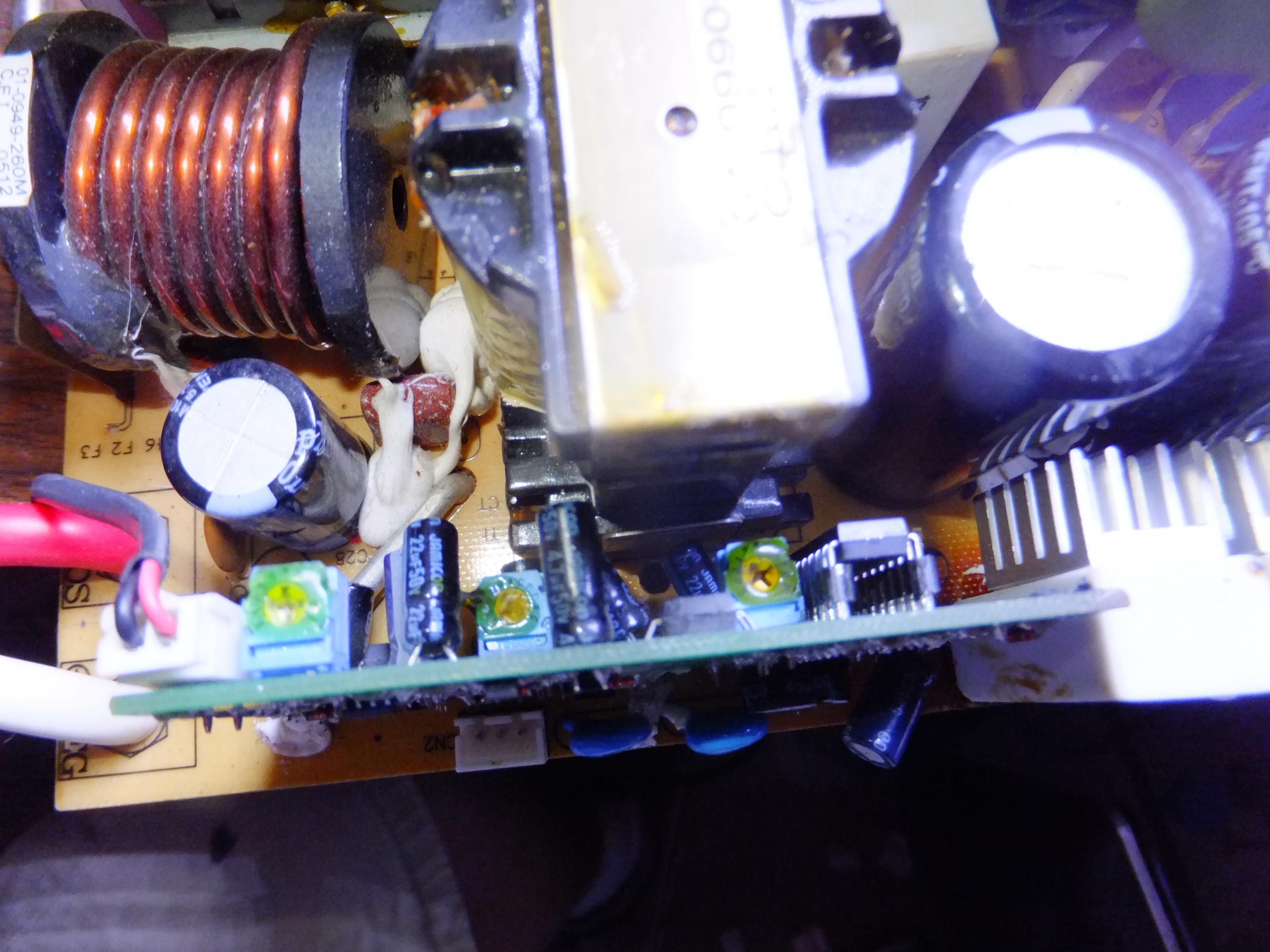

                                UPDATE!
                                I found the problem. I took a chance by replacing a small 220uF capacitor that was a bit too close to the big ceramic resistor... It seem that that capacitor was part of the KA3846 circuit and I assume the electrolyles dried up from the heat of those resistors. Although they didn't have any apparent damage...
                                It seems to be working fine now!

                                  You should move that capacitor to the underside of the board to prevent the heat from burning it up again.

                                    I would need to modify a lot of hardware to to so because the board sits on a tray and there isn't clearance underneath... There was a 220uF 30V and I put a 50v instead. The can is a little bigger so I guess it might be easier to dissipate heat from the resistors.. I think I'll try to fit heatsinks of the resistors too.. if I'm lucky it will last another 10 years

                                      Can't relocate the capacitor? Relocate the resistors
