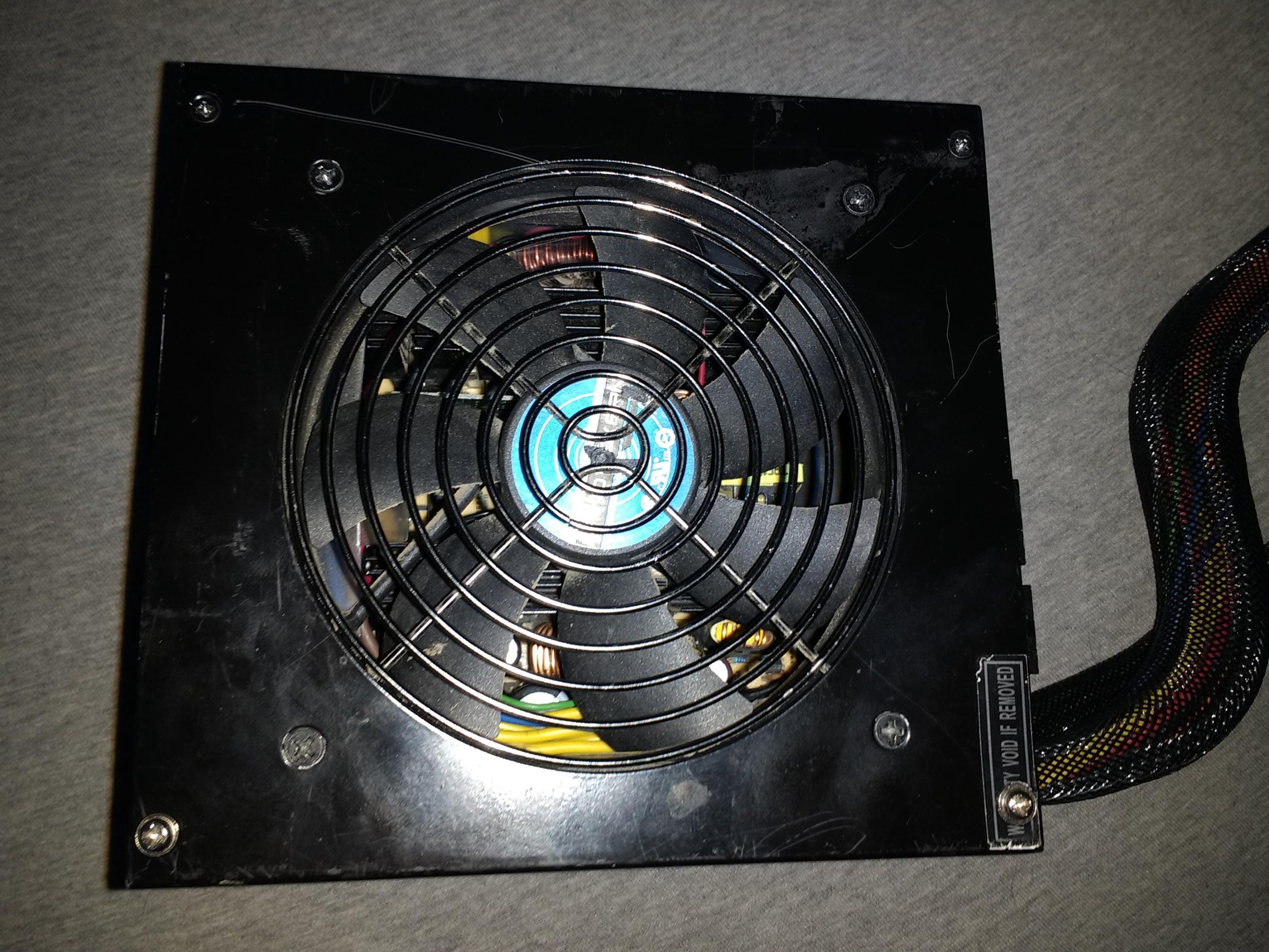

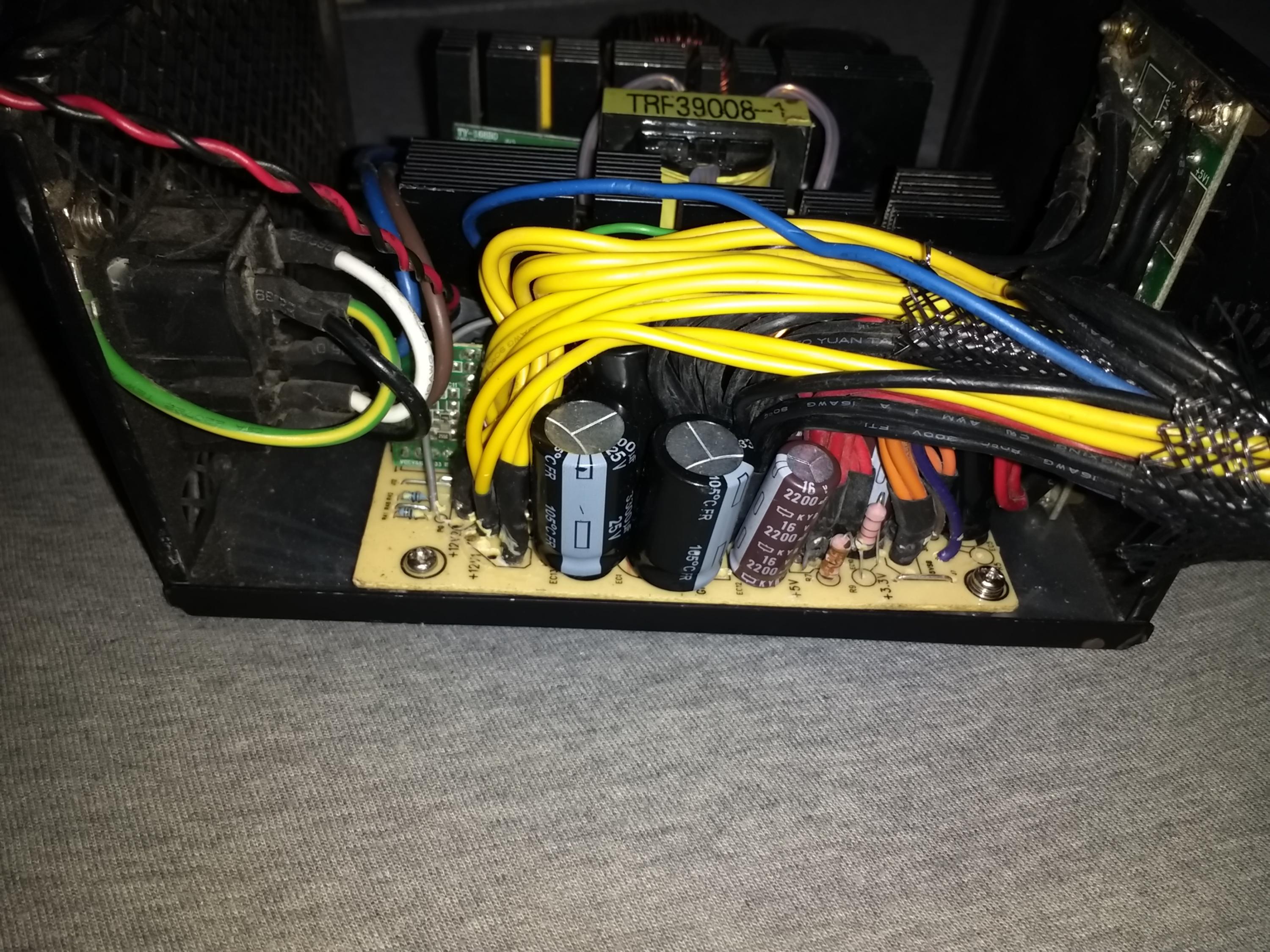

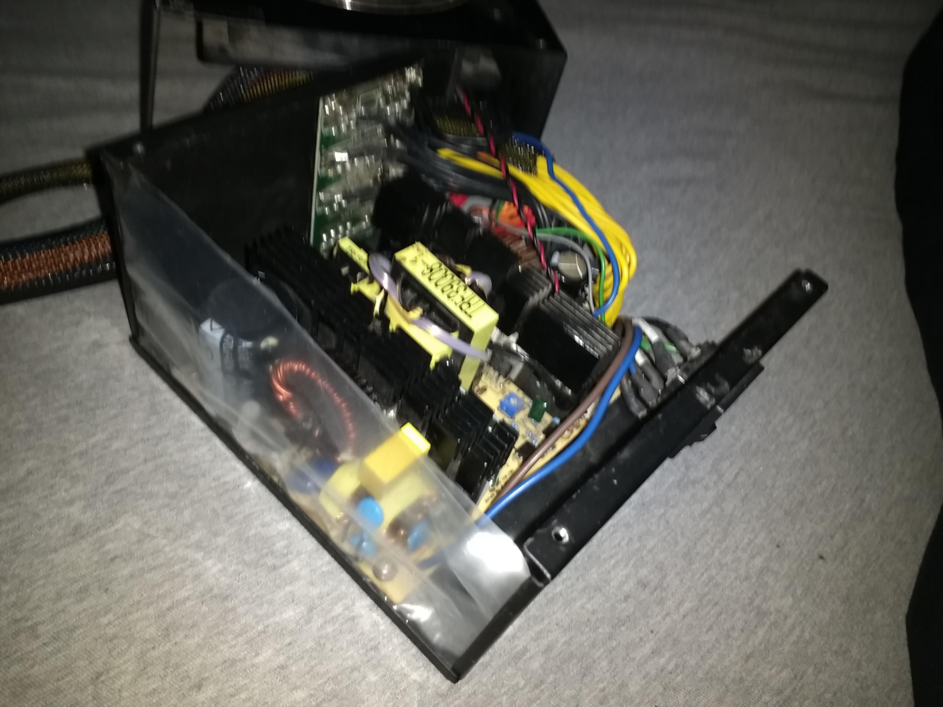

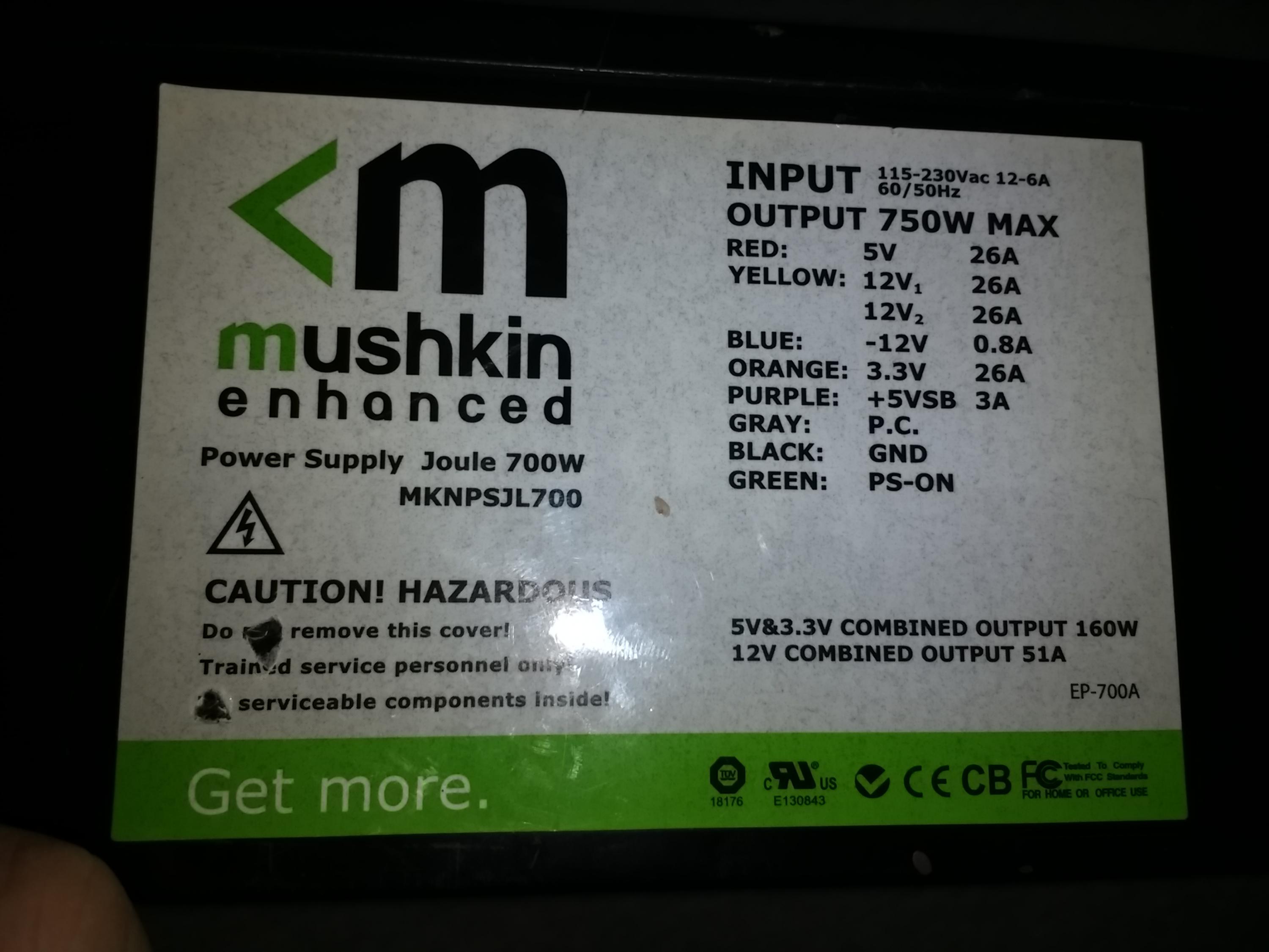

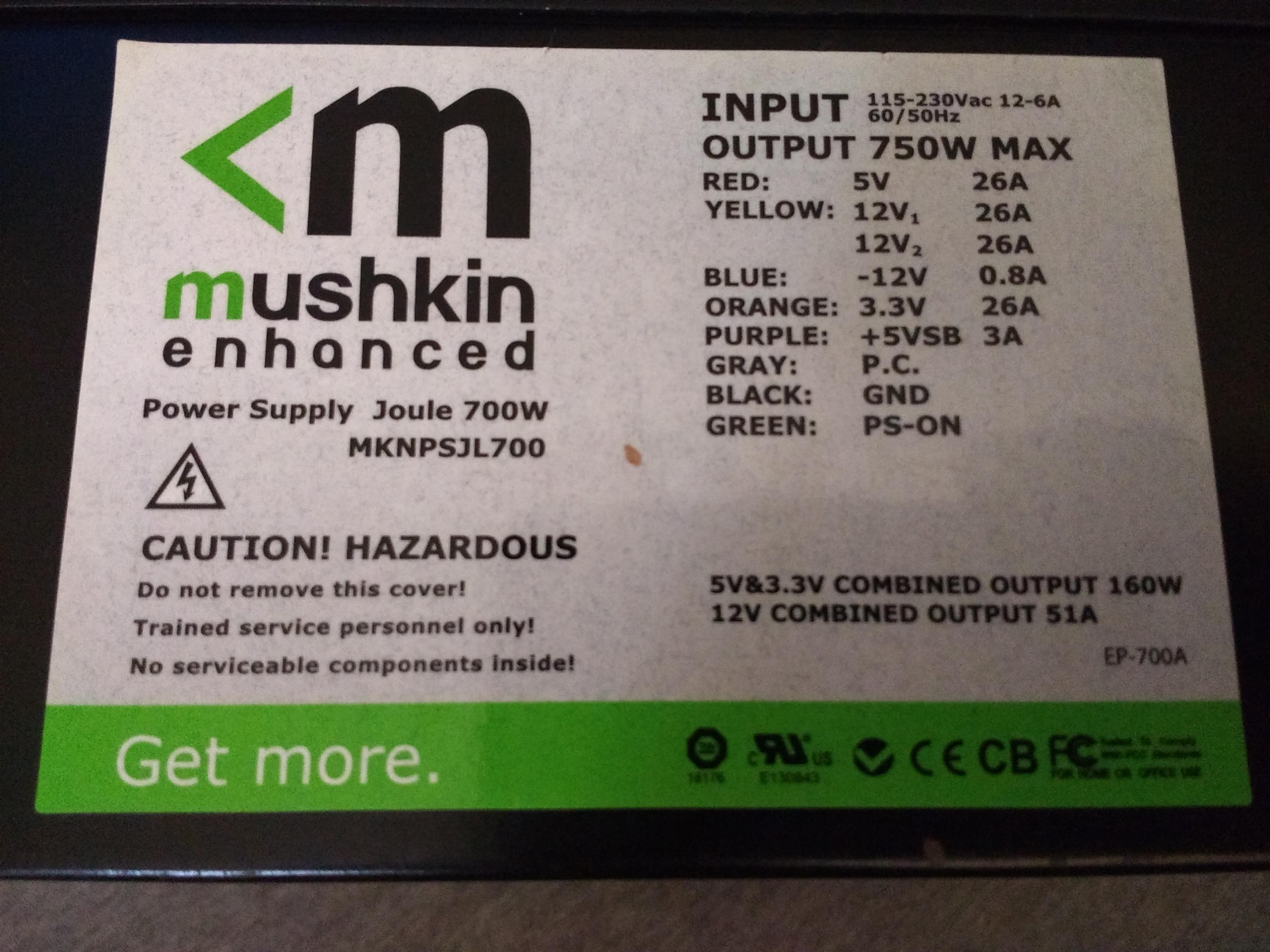

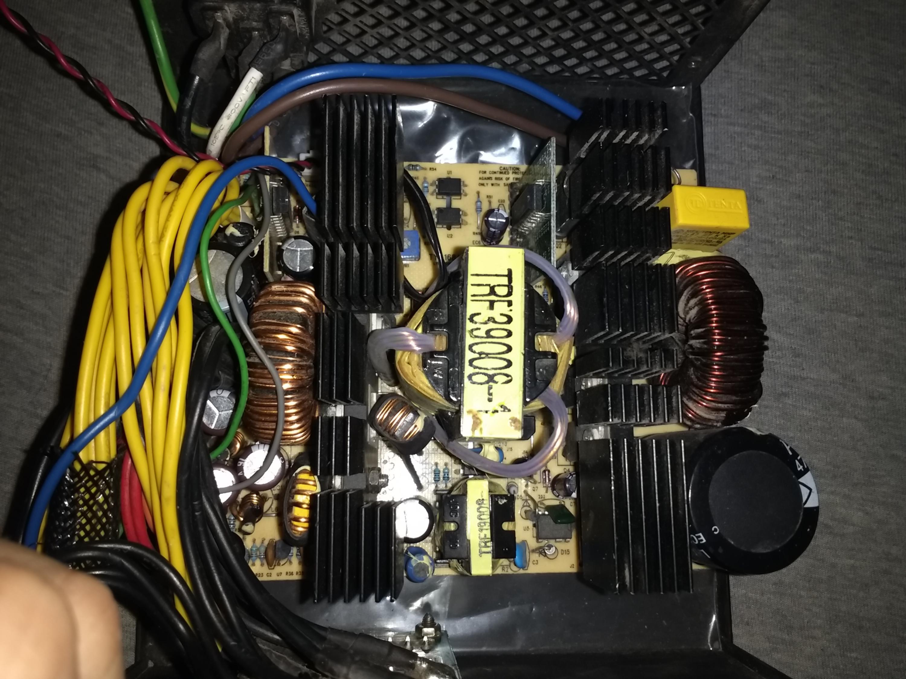

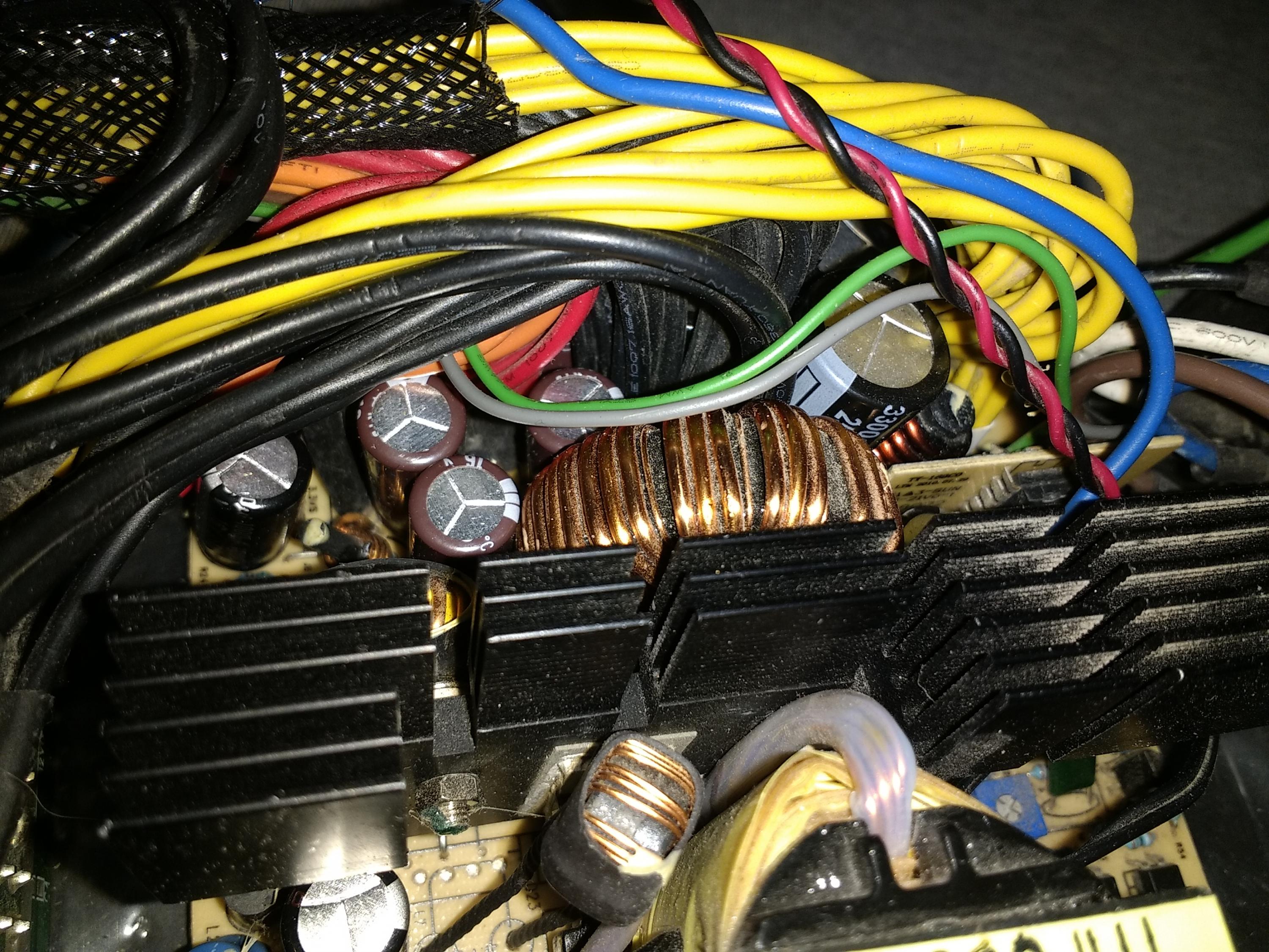

    Alright, pictures!
    Let's start with a top-down
    New caps
    A bit tight
    And the mod needed to fit the oversized caps
    I lost the plastic sheet that goes between the side of the case and the mains section, so this will do
    The usual apprentice marks
    And mismatched screws
    Something is wrong with this label....
    Thats better!
    Notice the pic quality? Blackberries are shit... This was taken with my Moto G4.

      Re: Fixing Goontrons warped PSU and main rig.
      Technically half volt of ripple on 12V is "within specs" though you may not be seeing all of the spikes that may be showing up. But you have that Tek DSO so you should be able to pick up on some of them. Now those spikes are bad.
      This sort of reminds me of my PVR box that has bad caps. It initially was fine, then the video would crash and restart once in a while...and happens more and more often until it couldn't stay in graphics mode anymore. The machine was still OK as a compute box.
      ... until the SATA controller started choking up. The machine needed to retry disk commands and disk accesses got really slow. Eventually RAM started to corrupt and I had to completely take it out of commission.
      It wasn't the PSU but rather the onboard VRM caps that went south. It was the 1.2V line that was having trouble, when I first started it had a good 400mV of ripple on it, which would explain why it had so much trouble. I don't have enough good caps in my parts box to fix it but replaced some of them, jury rig others (of which failed too, forcing me to fix those as well again), and got the ripple back down to 150mV alas it's the best I can do until I can get more good caps for it.
      150mV is still horrible for a 1.2V line! Alas everything works once more, graphics and all. Probably stressing the good caps on the line but so be it for now until I can get more.

          • Stefan Payne
            • 1267
            urgh, Topower.
            WHy waste any time on THAT?
            Although it seems like the newer P6 Plattform...

              • pdavid
                • Jan 2011
                • 279
                • Hungary
                Looks more like an old Super Flower platform to me. Topower newer used that type of center tapped main transformers of the 39, 41, 44 mm sizes.
                • goontron
                  5000!
                  • Dec 2011
                  • 4108
                  • US
                  ^ That i agree with. Super Flower is hit or miss, and this one is OK. Pretty good now that i've hat my grubby paws on it.

                    • Stefan Payne
                      • 1267
                      Originally posted by goontron
                      ^ No topower ive ever seen...
                      Yeah, but still feels topowerish.
                      The Caps were Hermei, were they??
                      And according to RHTX it's topower...
                      http://www.realhardtechx.com/index_archivos/Page645.htm
                      • goontron
                        5000!
                        • Dec 2011
                        • 4108
                        • US
                        ^AsiaX

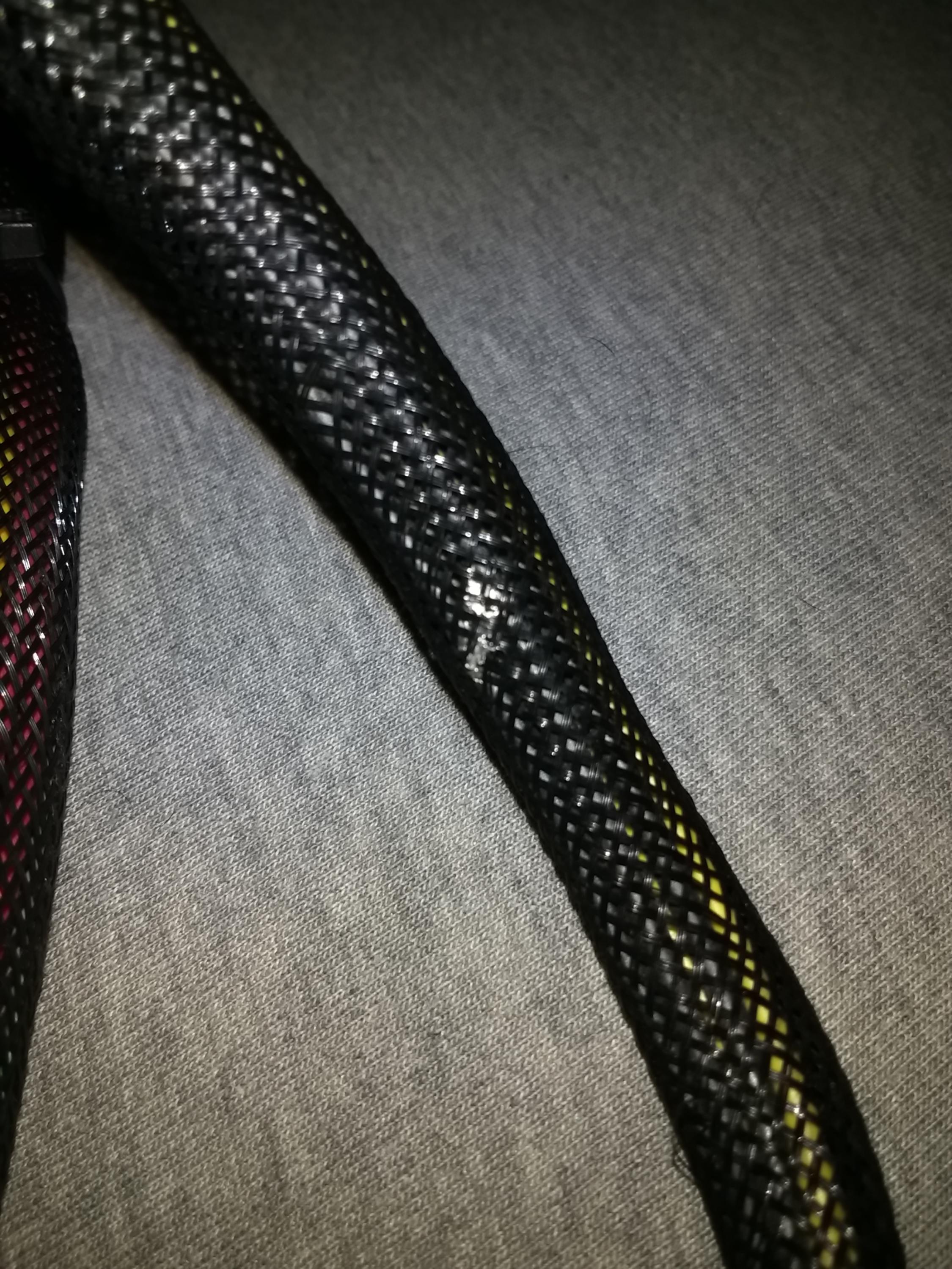

                            https://www.badcaps.net/forum/attach...1&d=1507329032
                            Is that a nylon bag?
                            Probably won't cause any issues... but nylon is not exactly frame-resistant and also melts at fairly a low temperature. I would have just gone with layers of electrical tape on the metal case (with some glue on the edges of the electrical tape, of course, as it has the tendency to peel away and fall off after a few years).
