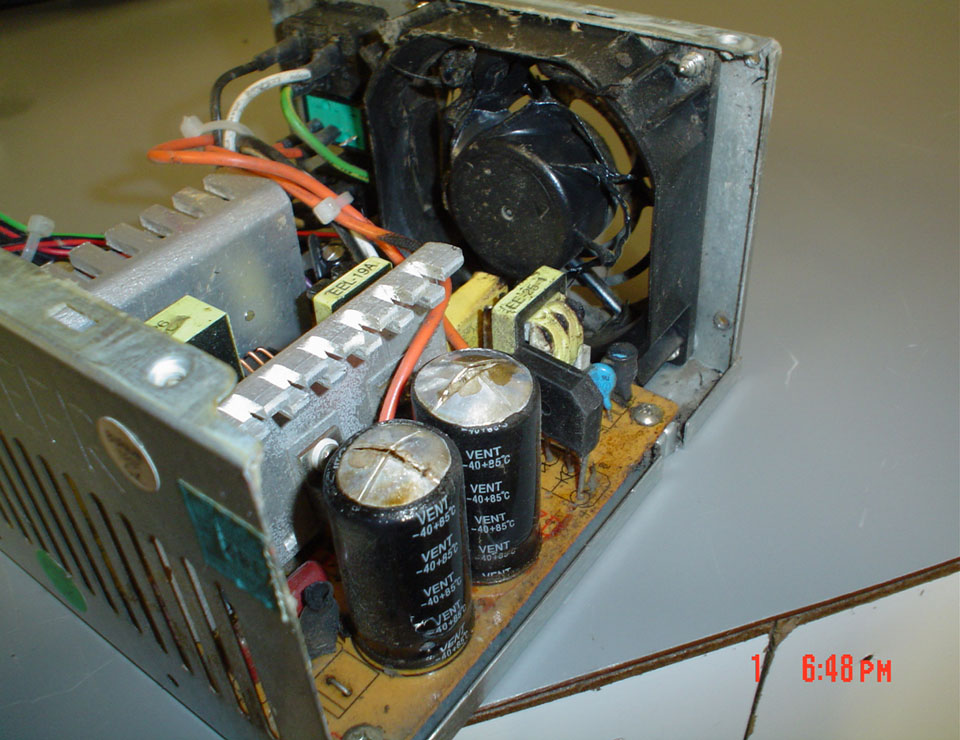

            here's ya a bulging 200v willawakee

              ROFL.........i dont think that one is gonna make it.

                Caps with 'VENT' on them. They've done so. :P

                  oh shit. look at the fan!!
                  i think the fan died, unit overheated the caps past the spec, blew the caps, and shut the SMPS oscillator stages down.
                    If the fan had died, and then the unit overheated the caps to the point of failure, the fan *still* wouldn't be in such horrendous shape. That fan is melted beyond belief. I would be surprised if a re-cap and fan replacement were all that would be required to restore that power supply to working order.

                      ok, a fire would be more feasable.

                        Those aren't Teapo LXK. Looks like Fuhjyyus.

                              Re: Sparkle Power Supplies
                              looks like the one i pulled at a customers shop.
                              it made a loud buzzing noise and spit flaming plastic out onto the desk and carpet.
                              lucky it happened with someone around who knew how to put out a fire.
                              we pulled all those cheapies and sledgehammered them.
                              after our little "meeting" with the kid who built these boxes i doubt he will spec such crap again!

                                    There is no justification for replacing those caps. It is obvious the overheating state popped them, and anything you would replace them with would fail the same way when a PSU gets THAT hot.
                                    The necessary change to that specific PSU is to replace the fan or periodically relube it. Unfortunately Sparkle/FSP has used two drastically different quality grades of fans, some of their PSU use any random generic sleeve bearing fan (like Yate Loon) that is quite likely to fail, and other models use very high quality dual ball bearing NMB or Nidec fans which run multiple times as long. That pictured fan isn't an NMB or Nidec, at least not one made in the past several years.
                                    Also, that pictured PSU appears to be a Deer, not a Sparkle. Because of this it would be good to rename the thread title and other incorrect info.

                                      Oops, I was mistakenly thinking the linked Deer PSU was supposed to be a Sparkle too. My apologies. I would still suspect overheating to have popped the caps though, or just a random defect. A good friend of mine at a PC shop has sold hundreds of systems built in AOpen cases for years that come with Sparkle PSU and they don't typically vent the high-side caps unless the fan had failed and the system (was) kept running in that state.
