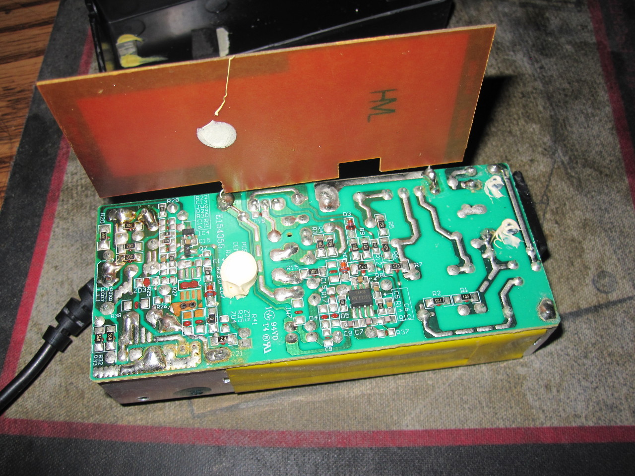

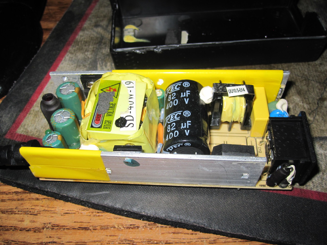

    I just got my hands on an old Cricut machine for cheap, as it was dead. The PSU is a 18V@2A brick, and I noticed its LED stayed off... It must be a dead PSU at least at the first order of repair.
    I got it home and cracked the plastic case open with a hammer and a bench vise. It was a fairly typical flyback design with large heat sinks along the sides... so perhaps it wasn't that great an idea to use the vise, alas it was necessary. It uses the venerable 3843 SMPS chip, surface mounted on the bottom.
    Using an ESR meter, I quickly found that the 3843 power filter, a 100uF 25V capacitor wedged next to one of the heatsinks near the optoisolator was at 4 ohms ESR. I pulled it and measured a whopping 23uF and leaked 4mA at 25V.
    Swapping it for another cap restored operation of the PSU. One of the output caps was bloated, may replace that at a later time since its ESR seems OK for now. But perhaps need to swap it before figuring out how to re-seal the plastic brick PSU case...

    Re: Info for searchers: PSU for old Cricut
    Running it 'off' for a few hours, the PSU gets warm... terrible efficiency at low load.
    I suppose the inefficiency heat it generates is what killed that capacitor.
    The cap is branded "Rifeking" ... The PSU does give a warm feeling due to its inefficiency, but not a fuzzy one.
    The bad cap is that little one near the big main/primary 82uF 400V capacitor.
        That little start-up cap is a critical part for most 384x family circuits. Bad cap, no start-up.
        Output caps in discontinuous flyback circuits are very stressed, should be a No Crap-Cap Zone.
        Discontinuous flyback circuits are not super high efficiency. But more to the point, running a discontinuous flyback circuit no load means much/most of the charge stored into the primary during the switch on time has to be dumped into the primary side clamp (instead of into the load). So that clamp resistor is hotter at no or very light load than it is at heavier load.

                          Curious what people thought of the power rating of this PSU...
                            • 31247
                            looking at the heatsinks i think maybe 120-150w, with a good fan - it's a bit packed at the output end.
