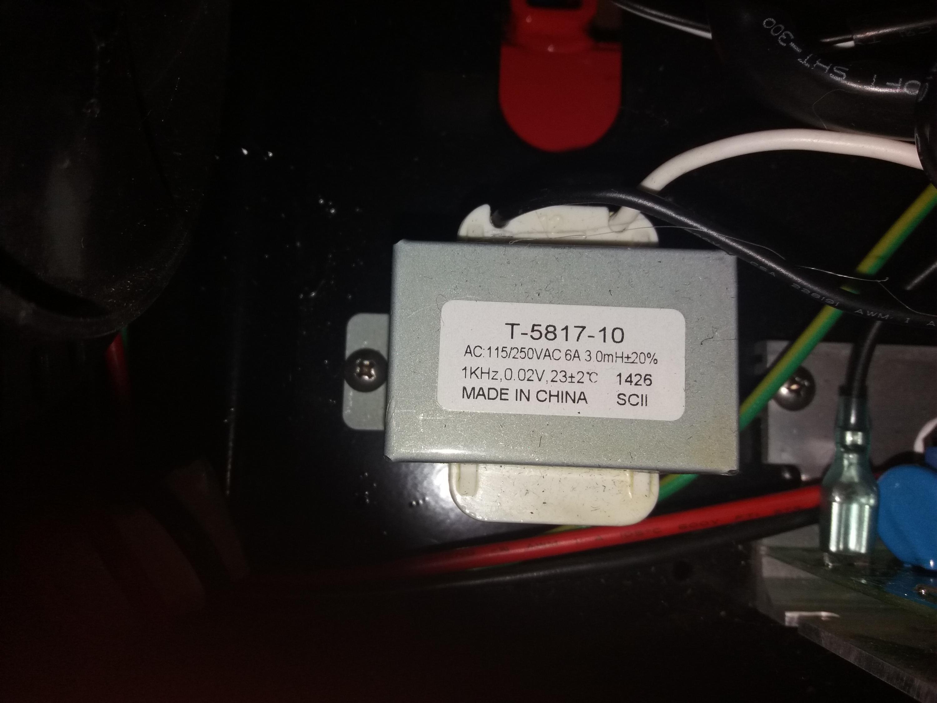

Reebok GT40s Treadmill power supply issue?
  • notallbad
    replied
    Re: Reebok GT40s Treadmill power supply issue?
    Thanks Budm
    Shall check main filter cap and get back to you, it does read around 450uF in-circuit using a cap meter.
    240v def coming into board across AC1 and AC2 via IEC kettle lead, 8A fuse, rocker switch, EMI filter, transformer.
    Last edited by notallbad; 05-04-2017, 04:49 PM.
    Leave a comment:
  • notallbad
    replied
    Re: Reebok GT40s Treadmill power supply issue?
    Found a shorted schokty diode SS310 (DD3), located under the cap immediately next to the transformer.
    What alternative can I use temporarily just to see if it gets it working?
    Leave a comment:
    replied
    Re: Reebok GT40s Treadmill power supply issue?
    "Getting around 290v steady on the main filter cap though takes a few seconds to creep up to that reading"?
    Your incoming AC is 230VAC so the DCV between the two legs of the main filter cap should be around 325VDC. So verify that your meter is OK, the incoming AC is OK, and the main filter cap is OK.
    Last edited by budm; 05-04-2017, 01:22 PM.
    Leave a comment:
  • notallbad
    replied
    Re: Reebok GT40s Treadmill power supply issue?
    Leave a comment:
  • notallbad
    replied
    Re: Reebok GT40s Treadmill power supply issue?
    Leave a comment:
  • notallbad
    started a topic Reebok GT40s Treadmill power supply issue?
    Reebok GT40s Treadmill power supply issue?
    Quite sure its the power board at fault.
    The treadmill does not power up, the LCD display flashes on and off, almost as though the power supply is cycling on and off.
    Getting around 290v steady on the main filter cap though takes a few seconds to creep up to that reading.
    Voltage reads about 8v on the rail to the display/control panel but keeps dropping (fluctuating around 6-8v), pretty sure this is not enough to drive the lcd /control panel but could be the power supply shutting down before the volts can get high enough.
    The power supply board and components look ok on inspection.
    There is an LED on the PS bd but it does not light up or flash - this I believe is used for troubleshooting.
    Would greatly appreciate any guidance.
    Last edited by notallbad; 05-04-2017, 12:46 PM.
  • Soulzink
    Samsug washing machine. Power supply DC41-00189a board issue
    by Soulzink
    Hi everyone,
    I am trying to fix a samsung washinmachine power supply main board.
    I already replaced it with another one to fix the machine but i want to try understand the issue with the old board.
    Therefore i hope to be able to get some help to explain what to check in order to troubleshoot.
    The power supply board reference is the following: DC41-00189a
    I have followed one thread (https://www.badcaps.net/forum/troubl...ingmachine-rel...
    04-19-2025, 06:26 AM
  • GLISIT
    by GLISIT
    01-16-2025, 02:29 PM
    by sam_sam_sam
    07-01-2024, 06:34 AM
  • JimBanville
    by JimBanville
    09-13-2023, 07:21 AM
