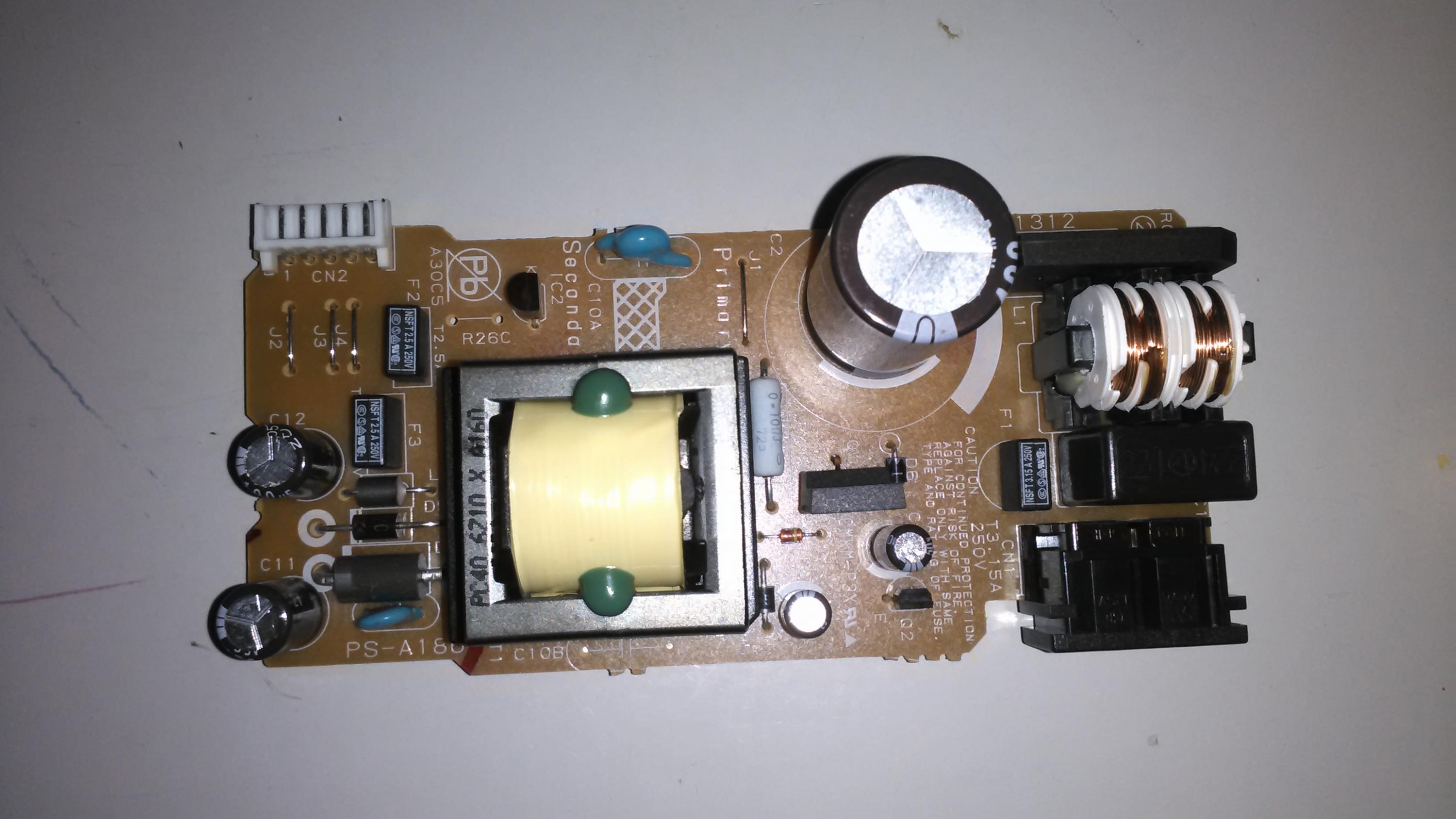

    Okay, hello everyone! My printer power supply stopped working. After checking the voltages they were not as expected. Checked all of the caps and they were all fine. Then after some searching I stumbled upon this video. This is the exact same board with exact same problem. The thing is that the video is on Russian and I can't understand a thing. But I see I could remove the transistor and place a jumper instead of it and replace one of the smd cap with whatever that element is. After using google translate on comments one of the comments said (maybe) that I could use a 2.6k ohm resistor instead of jumper on the transistor and it would be ok. Your thoughts on this fix? Would this work? Would it be dangerous? Thank you.

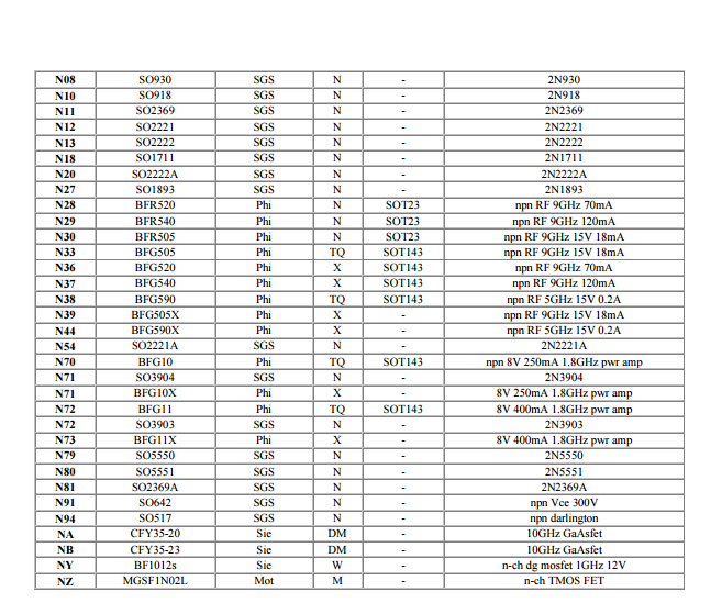

            Googleing got me these two manuals on identifying the smd transistors:
            https://cdn.badcaps-static.com/pdfs/...66be3d5a35.pdf
            http://www.s-manuals.com/smd/nx
            In the first one I would have to believe that its actually written "XN" since "NX" is nowhere on the list.

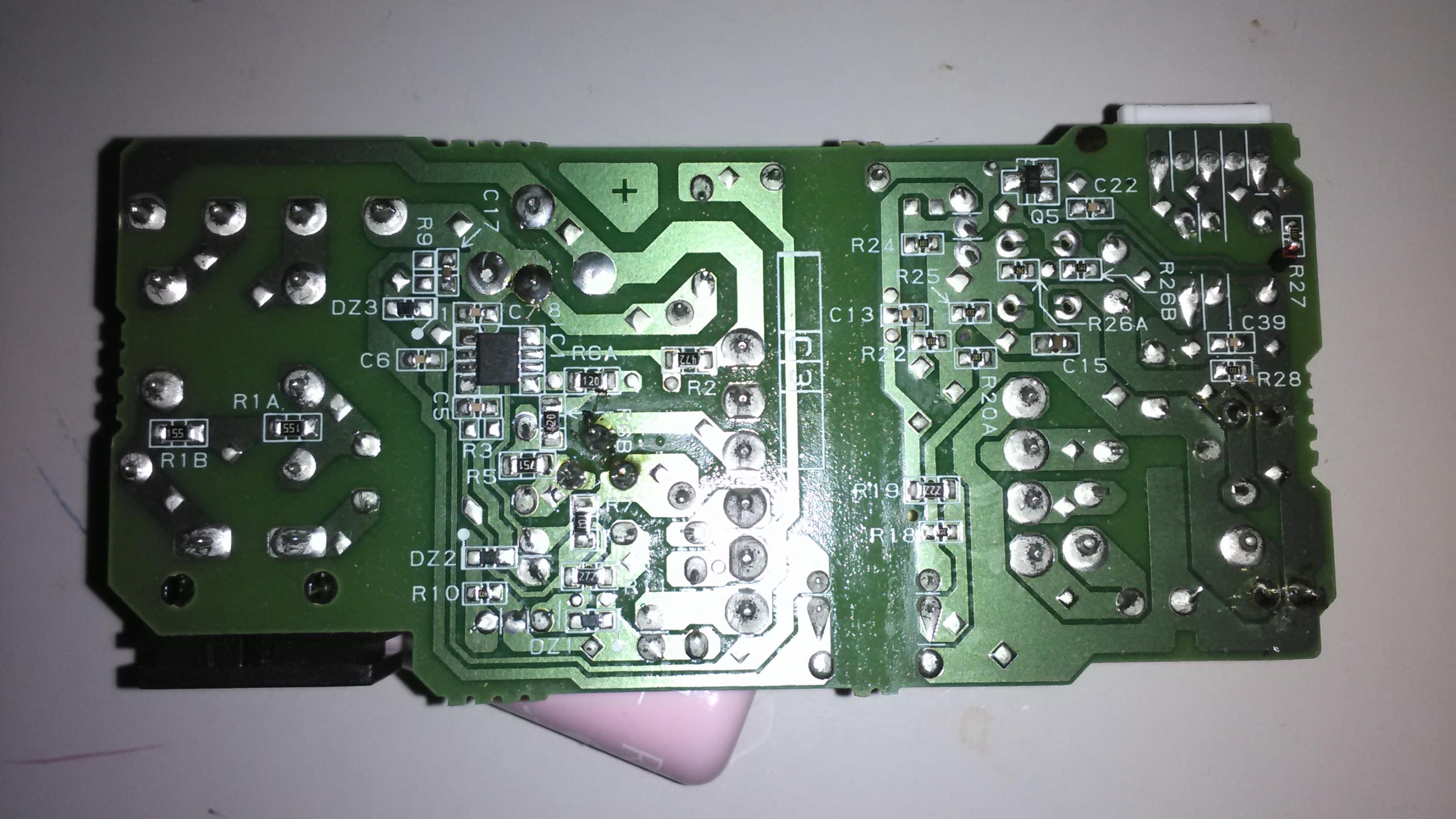

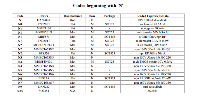

            On image 2 you can see that I marked an XN witch is a Zeener diode. And on the rest of the pictures you can see that NX is nowhere to be found.
            And if you check the second link you can see that there is smd code "NX" but there isn't a package like the one I got.

              I couldn't find a schematic or service manual for this Canon printer power supply.
              You would have to draw a partial schematic (hint: post good pics of both sides on the PCB) to figure it out.

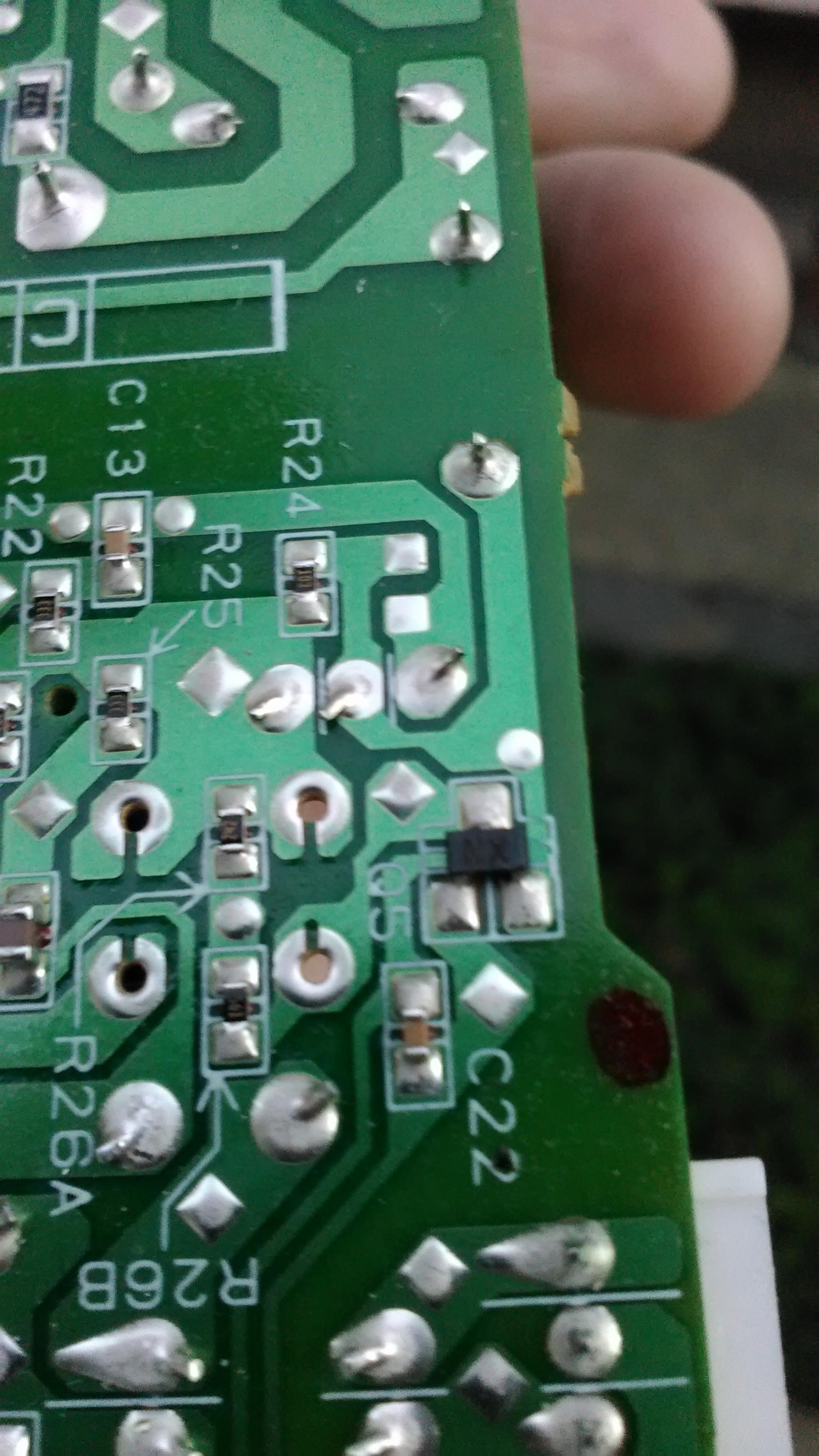

              Have you checked Q5 with a multimeter?
              SMD marking codes are a guessing game, because so many possibilities. It might be a N-ch MOSFET:
                Just did. Here is what I got. Since we can't still figure out what element is it i will name the pins A,B and C (A - stand alone pin, B and C two pins on the other side).
                From the connector pin:
                1 - A = 2,5V
                2 - A = 2,5V
                3 - A = 5V
                3 - B/C = 7,6V
                4 - A = 2,5V
                5 - A = 7,7V
                5 - B/C = 10,4V
                Here are the images too.

                  Morsus, I will draw it out, maybe need a few pics of the transformer some parts seem to be under it.

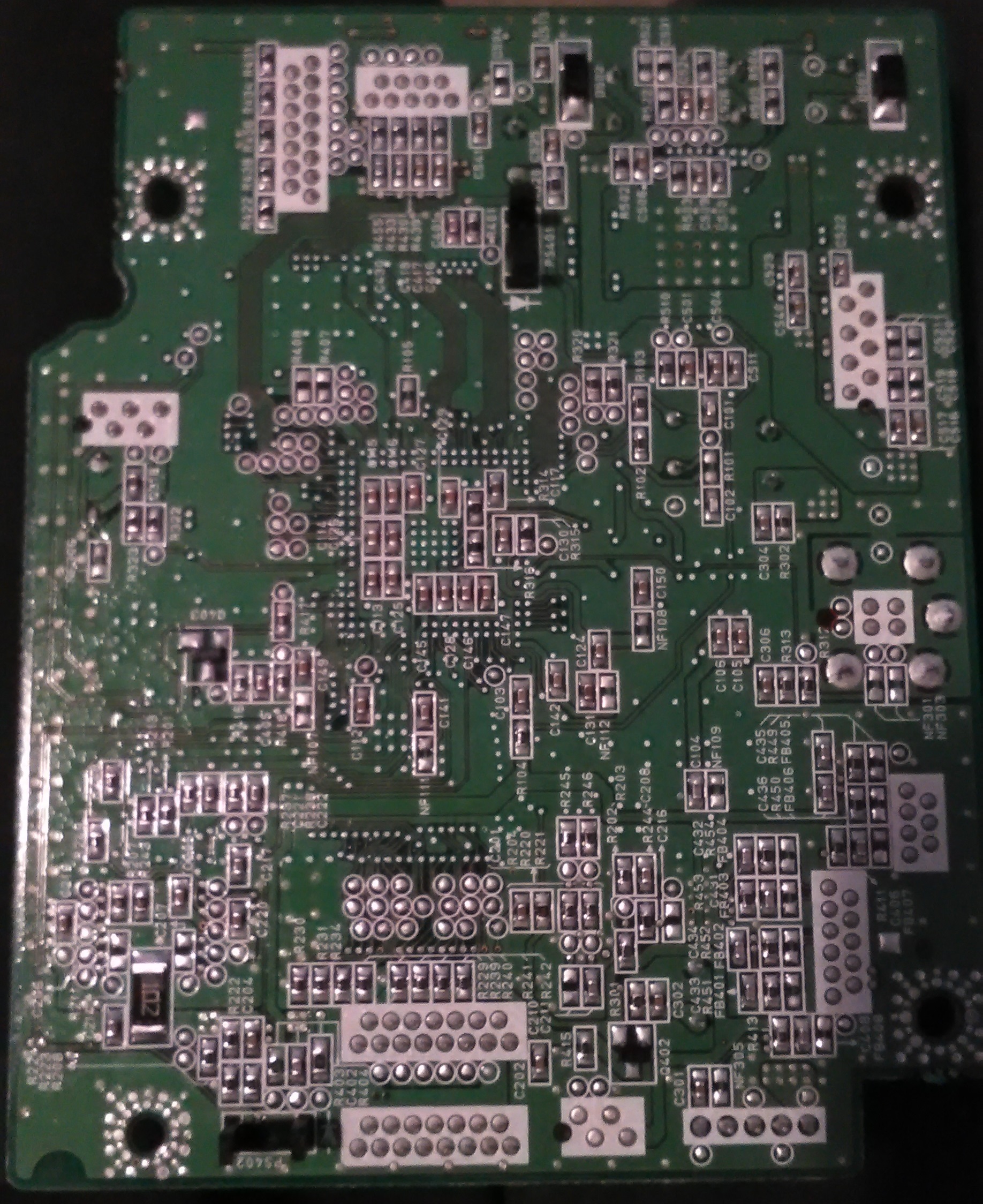

                          Okay folks, after all of the holidays and being busy with more important stuff I finally got some spare time to mess with the printer. I got the printer too now. It's Cannon iP4300. It just wont react when powered on (no led, no reaction).
                          After opening the Printer, I found two boards. One for the buttons and one witch probably controls everything.
                          Since I got problems with internet connection atm I am uploading images to imgur, sry about this.
                          http://imgur.com/a/8zqG7
                          What kind of DCV signal do I need to fully start the power board?
