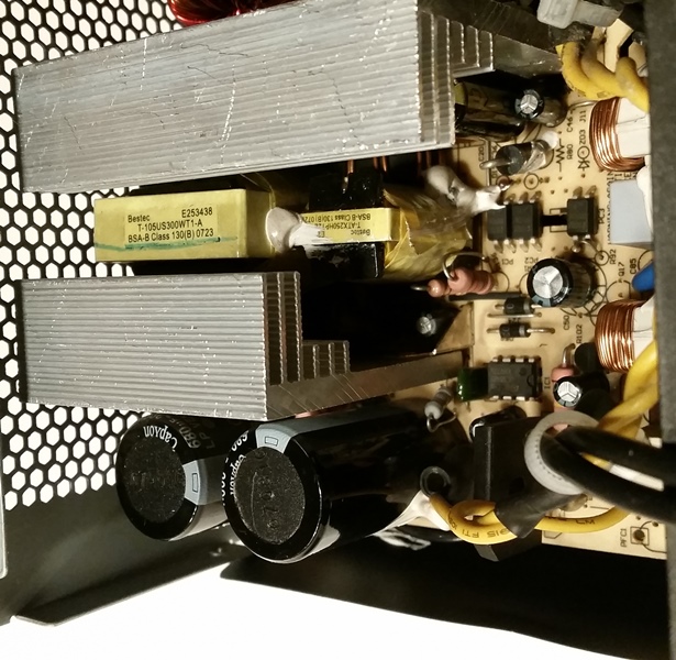

    I have a Bestec ATX-300-12Z that has what seemed "the usual problem" at first sight. When plugged in but not connected, the led (connected to 5VSB) is on. 5VSB measures okay at ~5,1 volt. As soon as I try starting the power supply (I just connect PS ON to GND) the led goes off. When I put a ~1A load on the 5VSB, the voltage drops and the led starts flashing. You'd think C36 (the 2200 uF smoothing capacitor for 5VSB) is bad. But it isn't. Neither is C50 (100 uF, 50V) or C60 (10 uF, 50V). I tested them all with an ESR meter, and even though the ESR meter showed they were fine, I replaced them anyway. No change at all.
    I haven't started measuring voltages on the live power supply yet (feels a bit tricky...) but if all capacitors are fine, what other components could be suspect?

    Re: Bestec ATX-300-12Z with NO bad C36
    I have seen this before. There was a short...Mine just had a solder ball that just got stuck between two leads lol. Can we see some pictures of the unit? It is also possible that you have brown conductive glue causing problems.

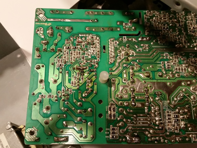

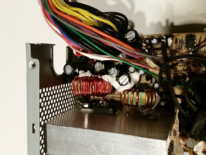

      Here are a few pictures. I took quite a few bits out already, hence the different kind of solder used on some components.
              how did you check them with the ESR meter? In or out of circuit? Also there are some cheap ESR meters, that are good for nothing. That can be another factor. That happened here before.
              I guess we need some schematics and better pictures too, yours are slanted and then not all of the board showing.
