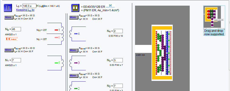

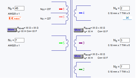

    Transformer N value ?
    Everyone,
    I see N value from the transformer design,
    Is that the real value I must do a winding ? N = 23 so 23 turn on the core ?
    Cheers

        Re: Transformer N value ?
        correct me if I'm wrong
        Vp/Vs = Np/Ns
        Vp/12 = 45/7
        So Vp will be on 70.14V
          and for N0, is it the closest to core ? from that layout ?
            Vp/Vs = Np/Ns
            Vp/12 = 45/7
            I would say the primary voltage is determine to how much you apply. So the equation is correct if you do not know how many volts you apply and you know the turns ratio of the primary and the secondary and the voltage of the secondary then you can figure out the primary voltage.
