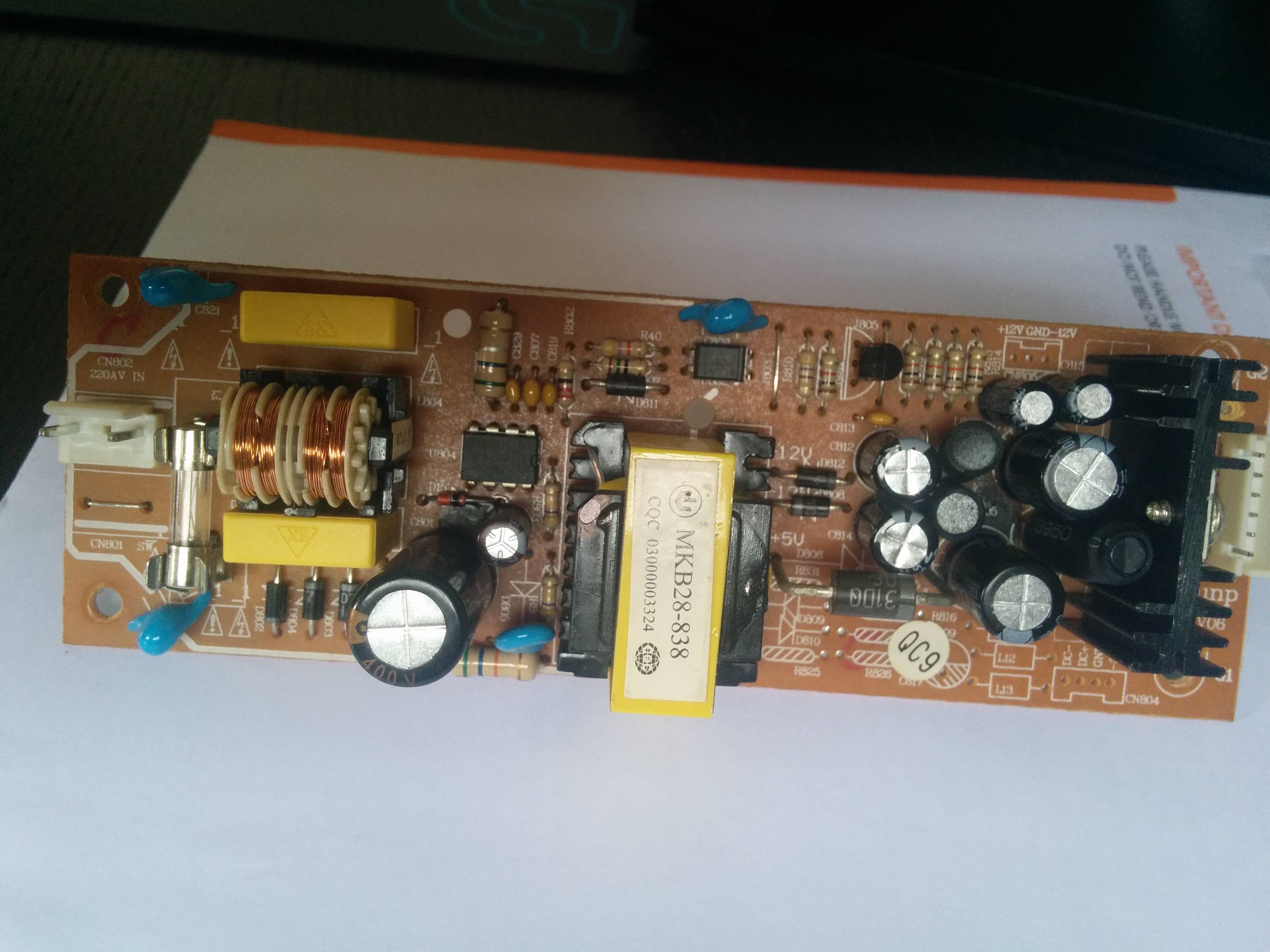

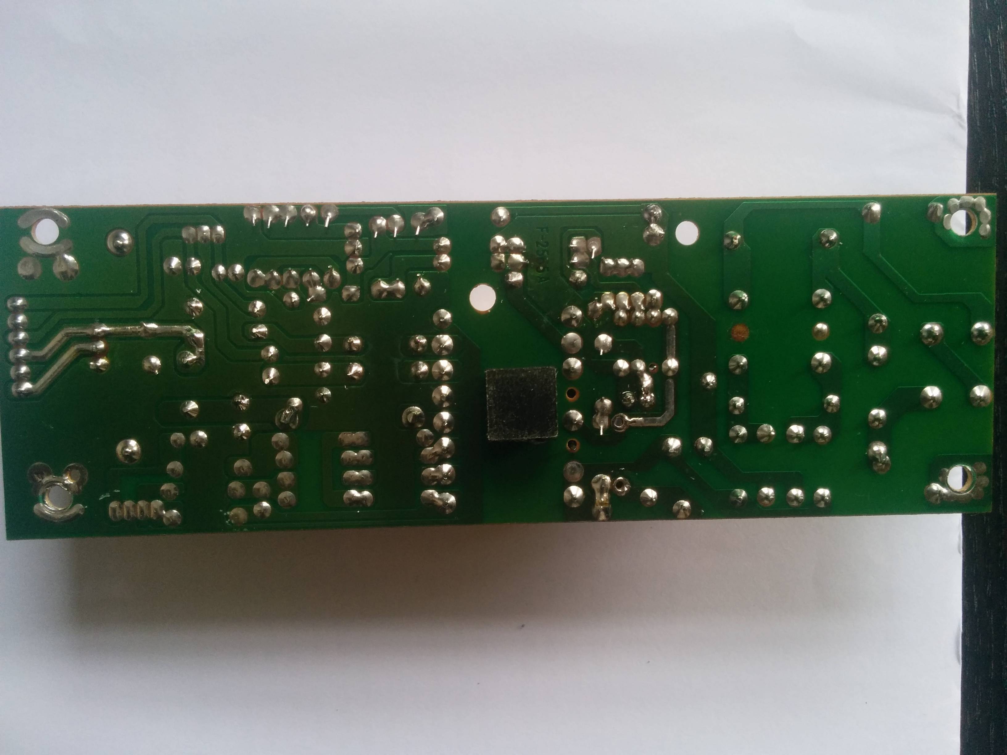

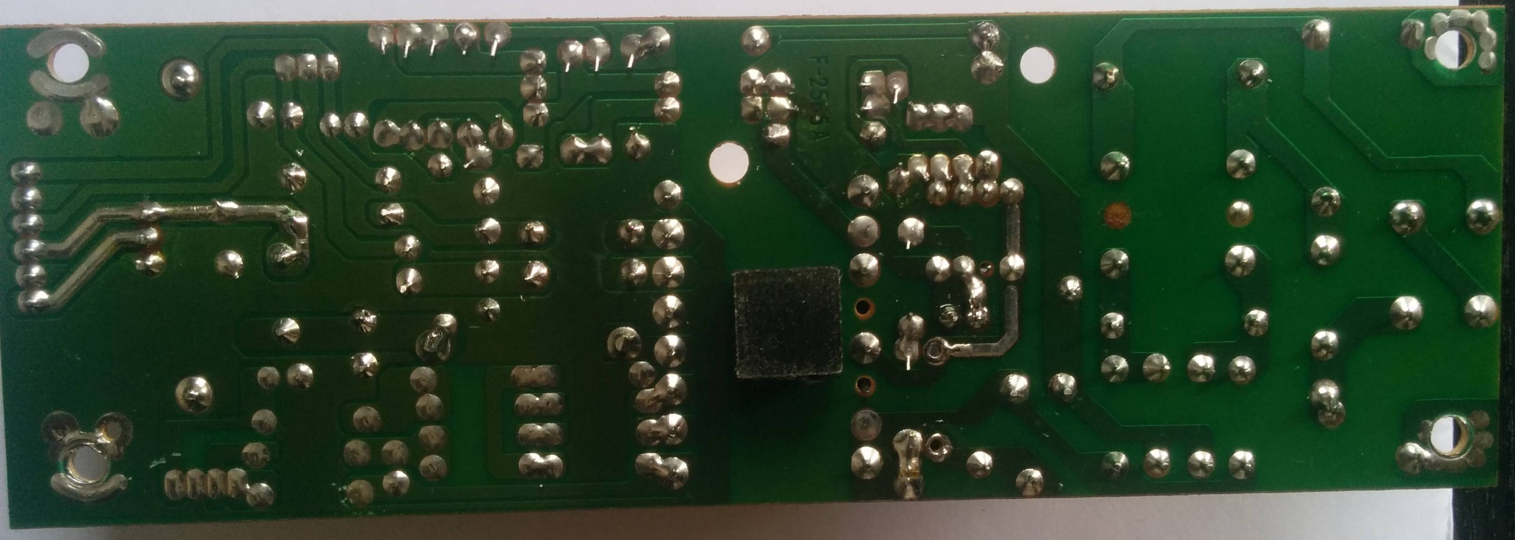

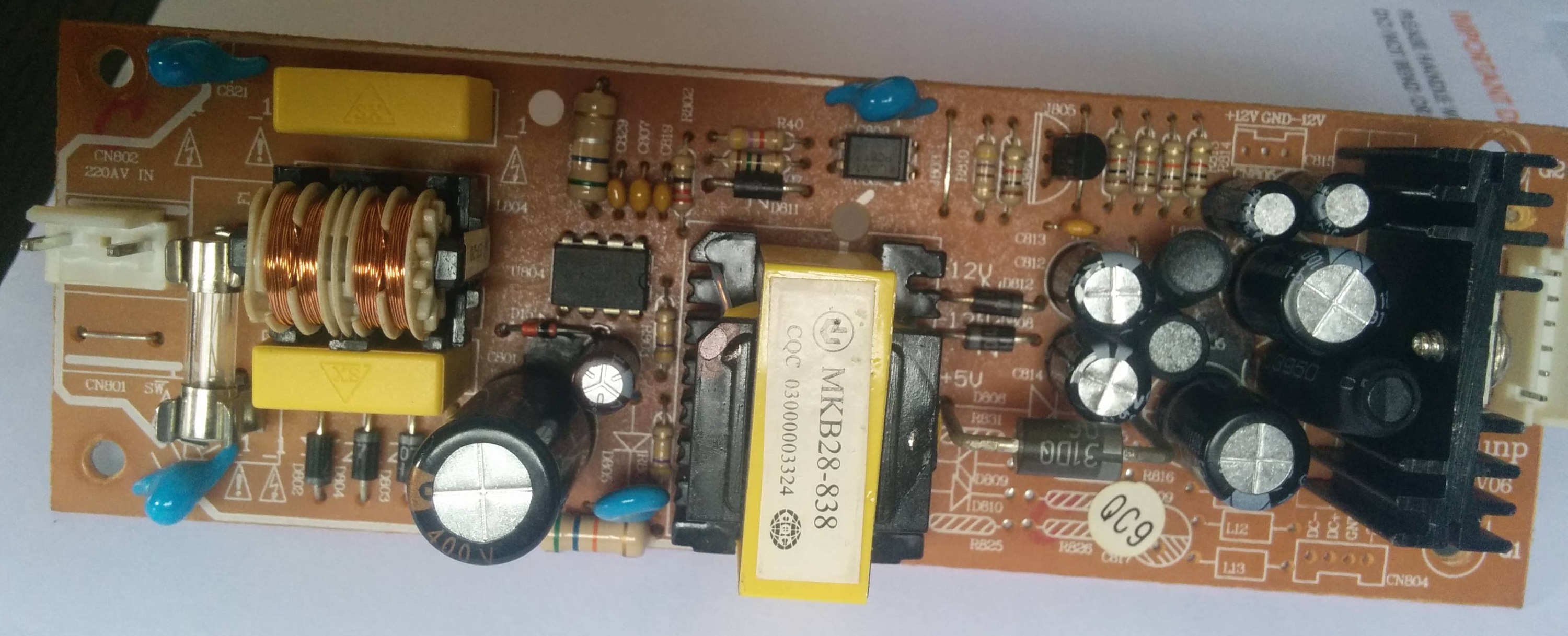

    Hi guys,
    I have limited electronics knowledge, but I'd like to find out what's going on with this power supply I'm fixing for a DVD player as a hobby.
    Here is the board in question:
    The biggest capacitor there is 400V 22uF, receiving about 300V just fine. It's newly replaced too, as well as the small 47uF 50V capacitor next to it because of the black spot on the board there.
    The 2A265 IC isn't receiving Vcc (pin 7), and it seems to be shorted to Gnd(pin 8). For the life of me I can't figure out why as the components connected to it all seem to be in good order when I measured them.
    Can someone give me hints to what to do next?

    Is that diode shorted on the bottom of the PWM?
    • squeeish
      • 15
      Re: 2A265 Vcc and Gnd shorted
      The little red one marked D15? The 2A265 IC is the one marked U804.
        That D15 looks to be Zener diode, so check and see if the Cathode is connected to the Vcc pin of the IC or not, if it is then lift one end of the diode off the board and then check the resistance between Vcc and Gnd again to see if it still show very resistance or not.
