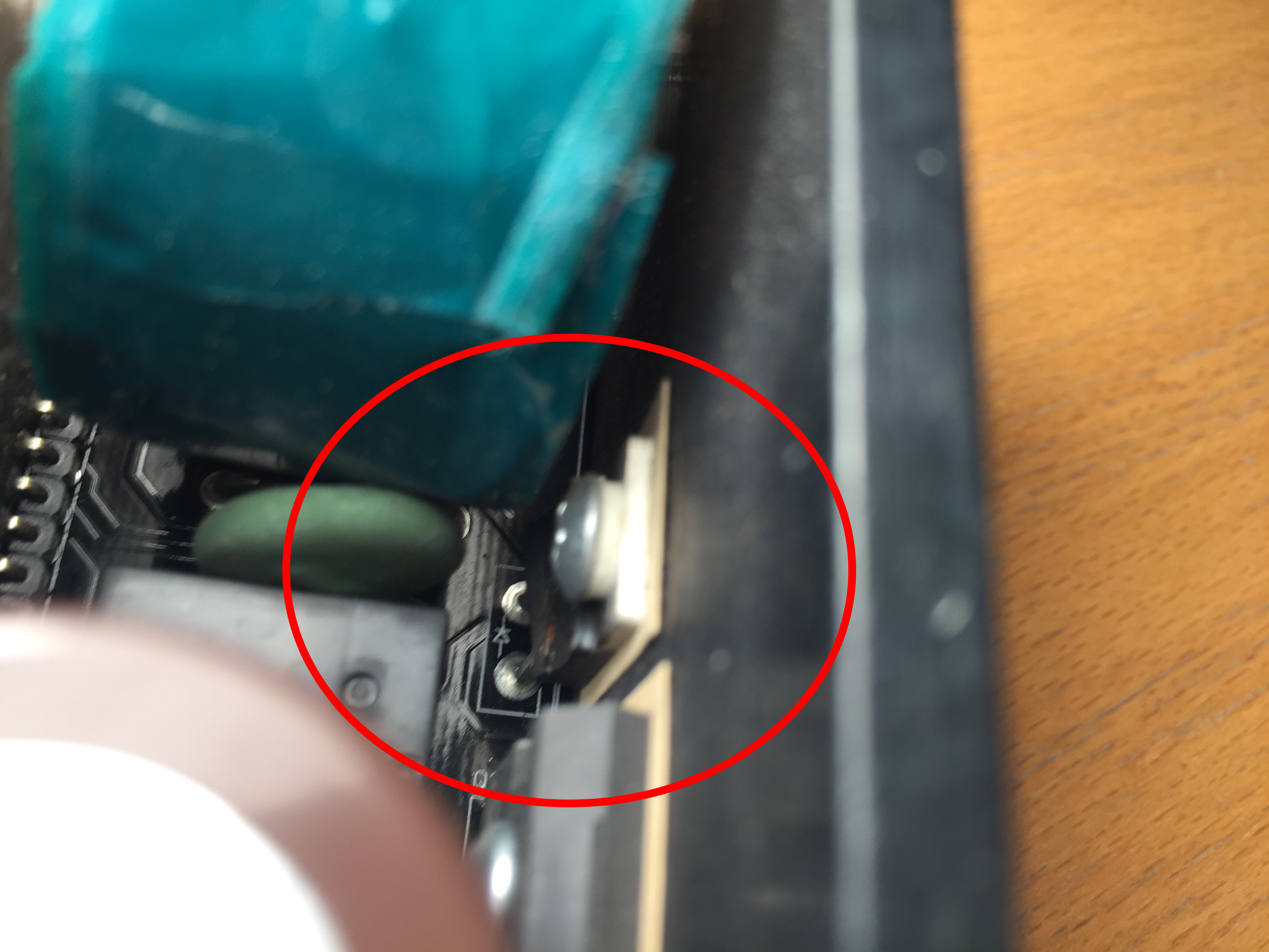

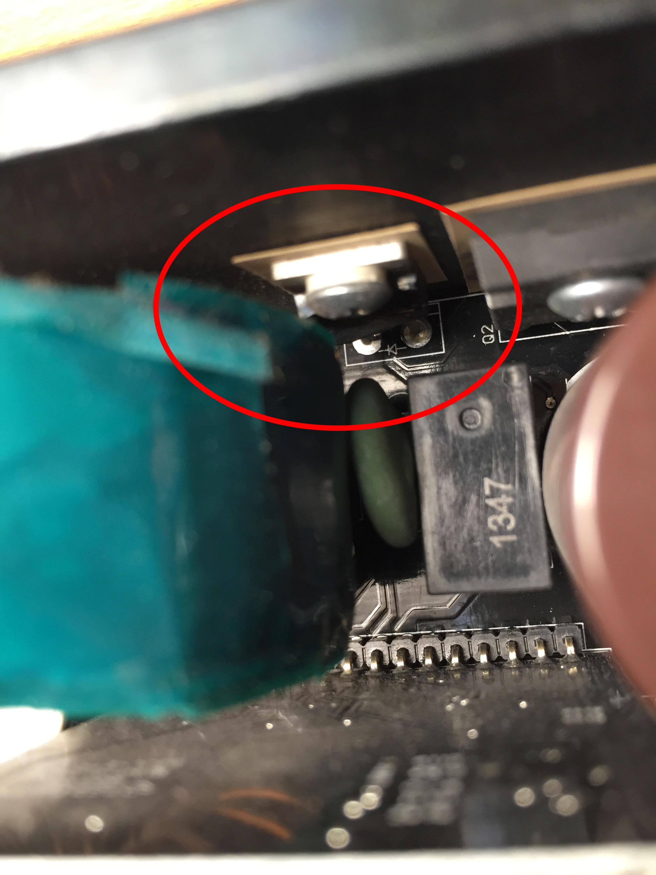

    Got a Corsair RM1000 PSU that kicked off main fuses in the building, found the fault but cant identify the diode, see the pictures below:
    If anyone could provide me some schematics, would be thankful!

    if he face has blown off, it's still in there somewhere - give it a good shake.

      Re: CORSAIR RM1000 - help needed!
      There are no pieces, its been burned off I think.
        • 31161
        no, it split - i'm sure of it.
          Nowhere to be found, searched for an hour, whats the purpouse of this diode`? Why did it make such a power outtage in the whole building?
            • 31161
            no idea, you have to trace the tracks.
            it may be the pfc circuit.
            • japlytic
              • Oct 2005
              • 2086
              It is the PFC rectifier, and two power MOSFETs for the PFC boost stage are near this rectifier - one possible match for this rectifier could be an ST STTH8L06.

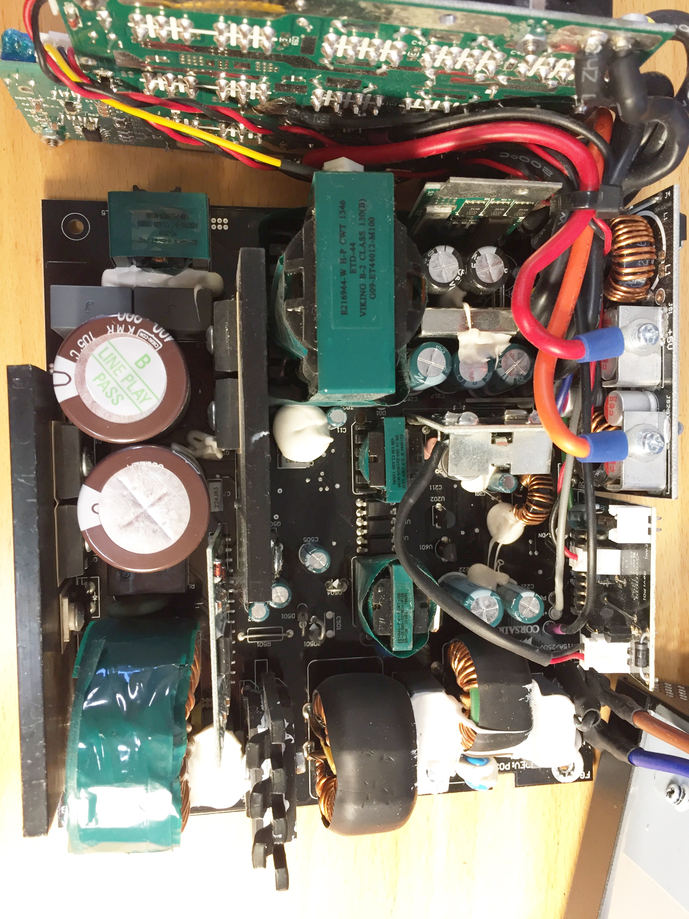

                if you get it running replace the secondary caps.i see crap.
                  It's c3d10060
                  DIODE SCHOT 600V 10A
