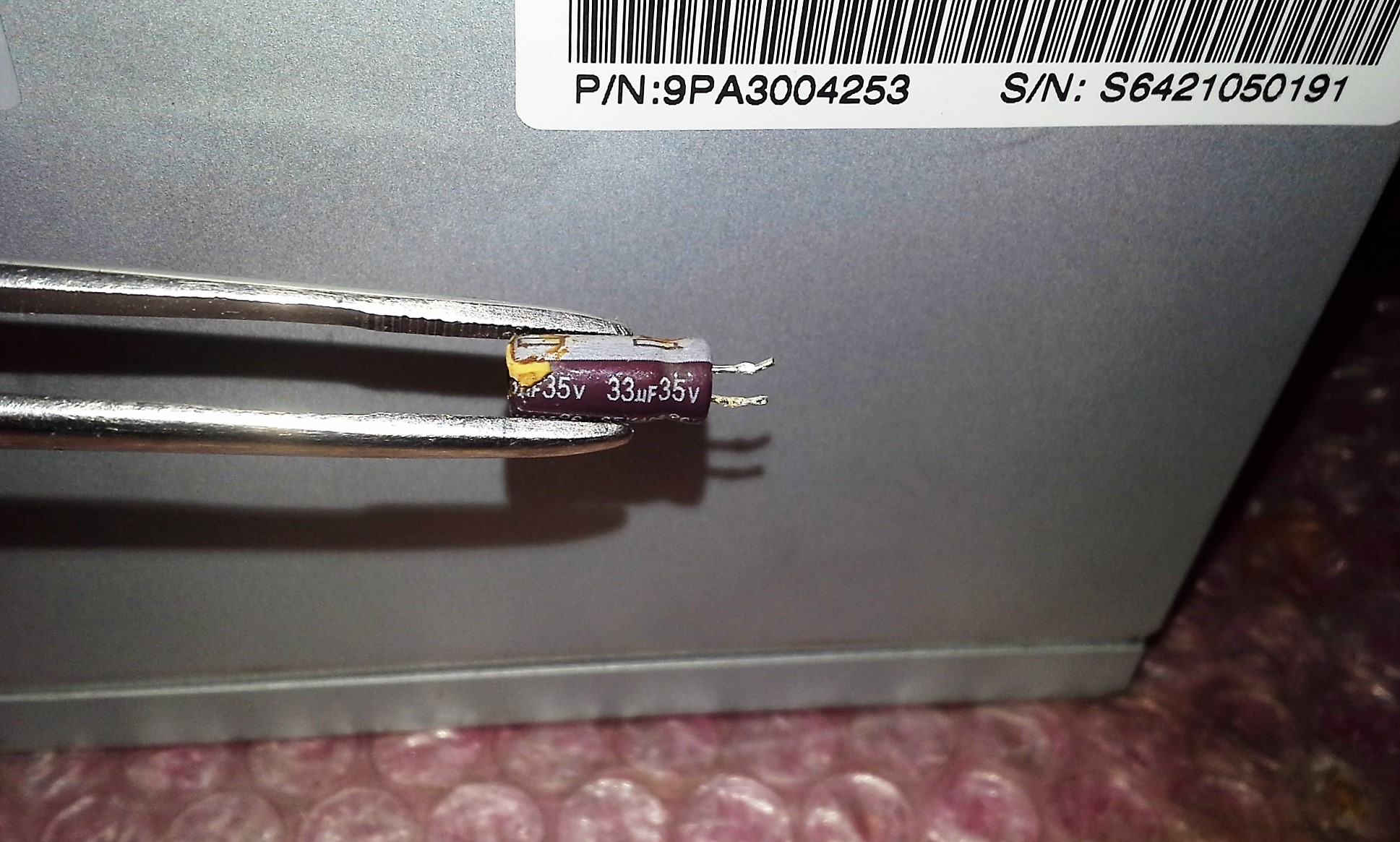

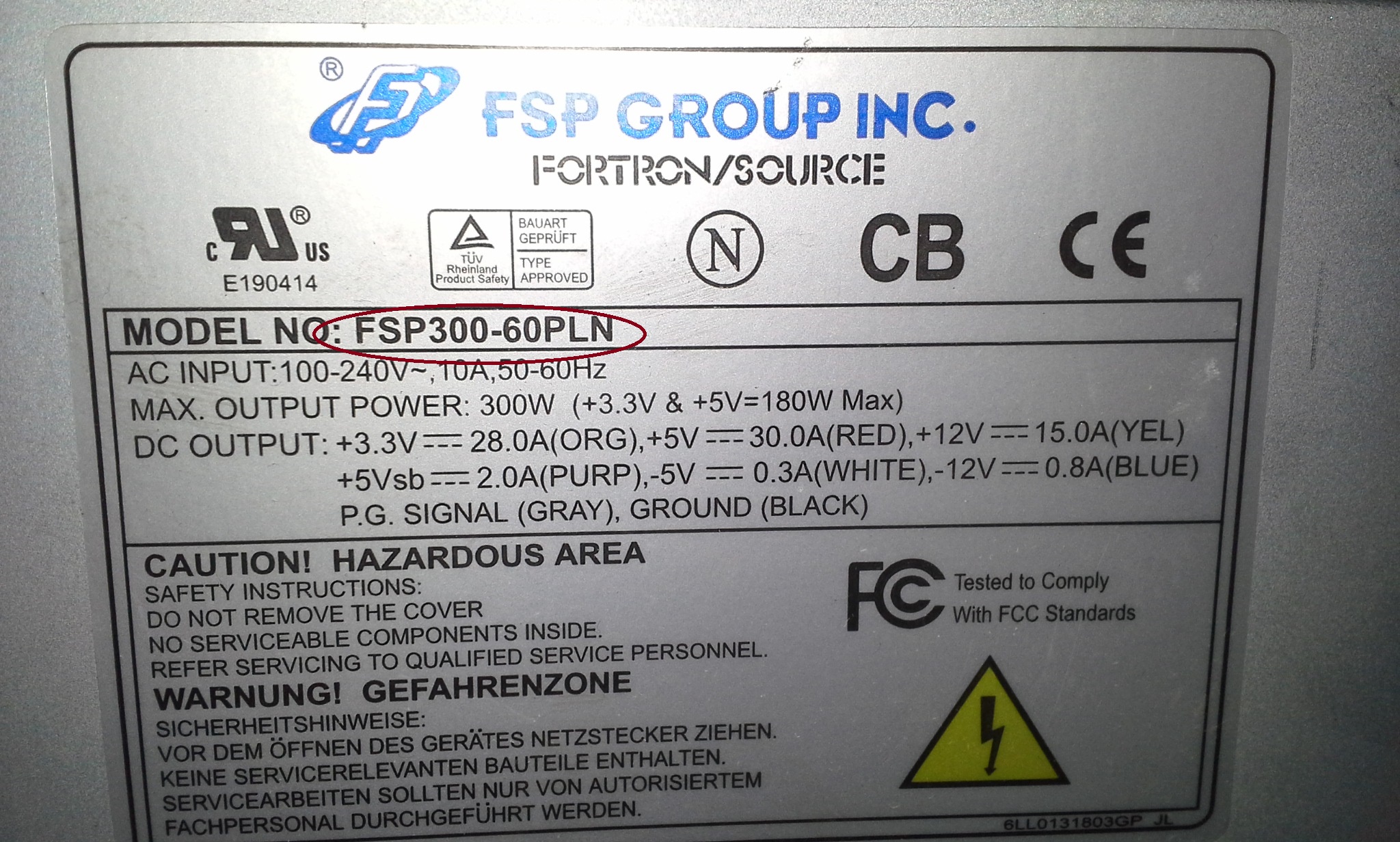

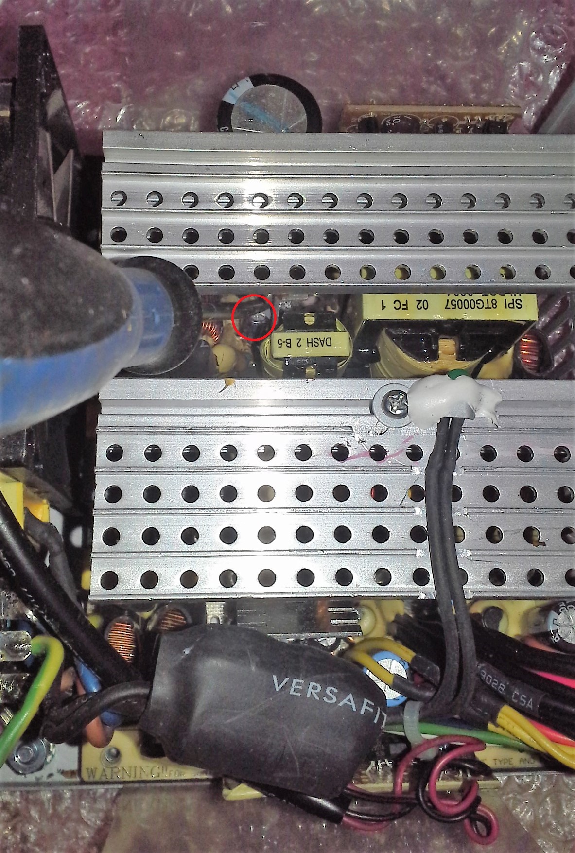

    Fortron FSP300-60PLN dead - solved.
    If You have FSP300-60PLN power supply, whitch yesterday was worked , but today don't wont start, replace in this PSU capacitor C15 ( 33uF/35V ).

    Re: Fortron FSP300-60PLN dead - solved.
    That faulty capacitor looks like Teapo SEK. I see more of those in the rest of the PSU. Definitely replace them too.
      Replace all of them, I usually get these units with bloated SB output caps, often also others.

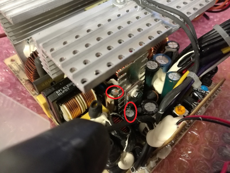

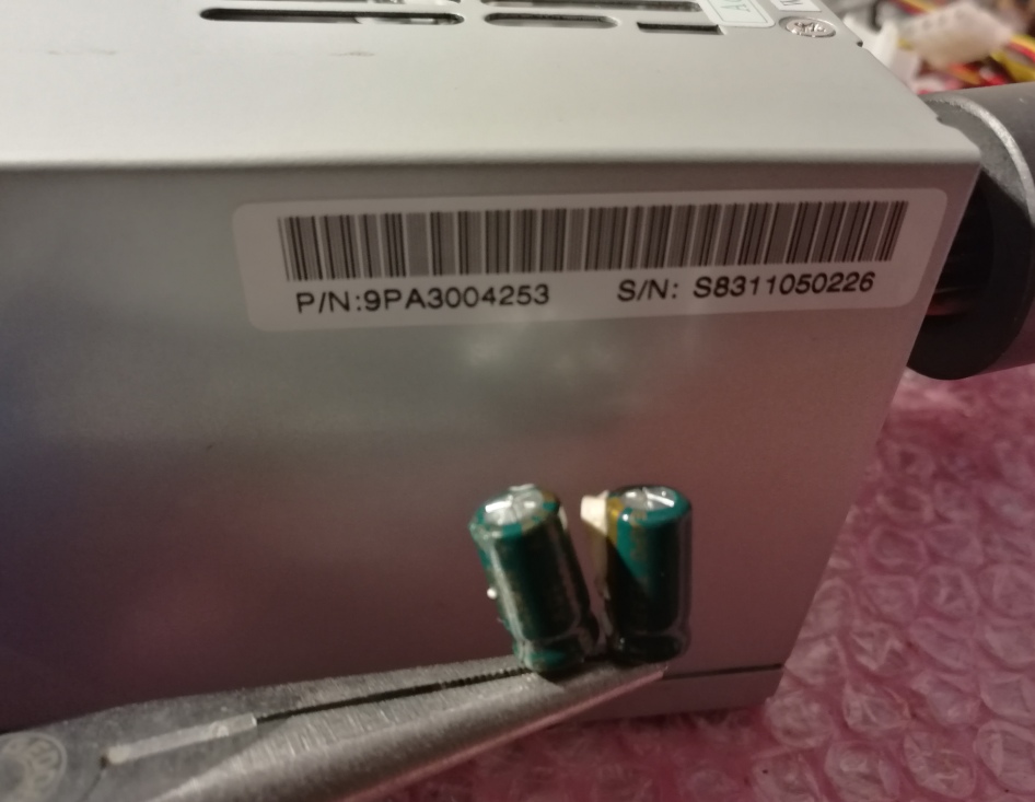

        FSP Group INC. chainged design PCB in FSP300-60PLN power supply.
        But the problem "monday morning" was the same ;(
        In new design pcb very offen bloat 2 capacitors 1ooouF/1oV.
        After replaced this capacitors PS work OK.

          Replace the other Teapo caps as well.
          Popcorn.
          • Stefan Payne
            • 1267
            Replace _ALL_ Caps that are not the main bulk caps.
            ie every 5mm/6.3mm one, every one on the secondary side.
            For that you might have to desolder either the primary or the secondary heatsink and components connected to it.
