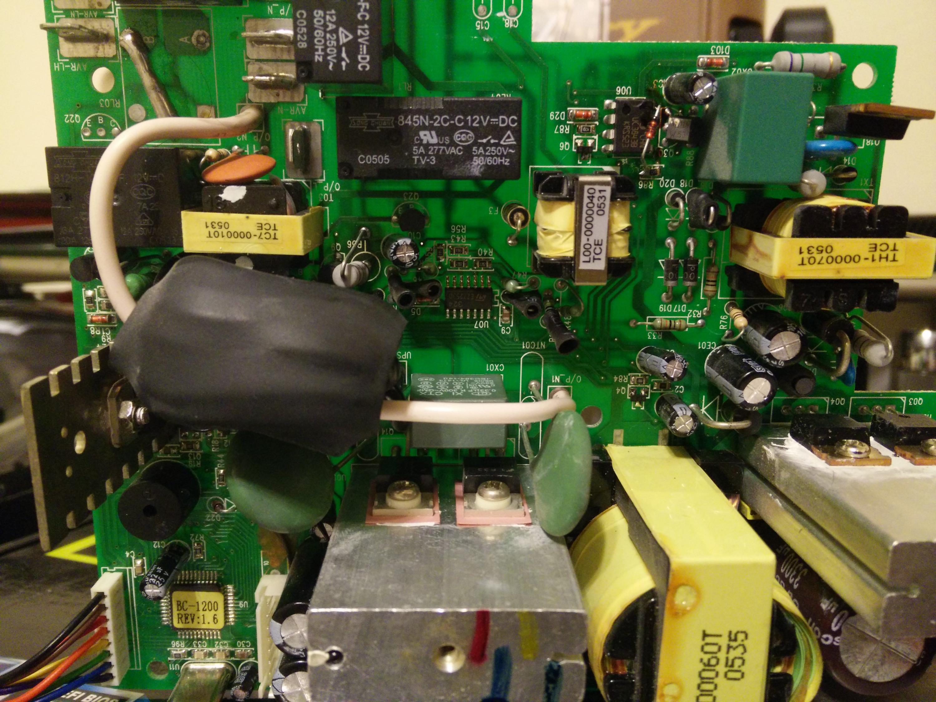

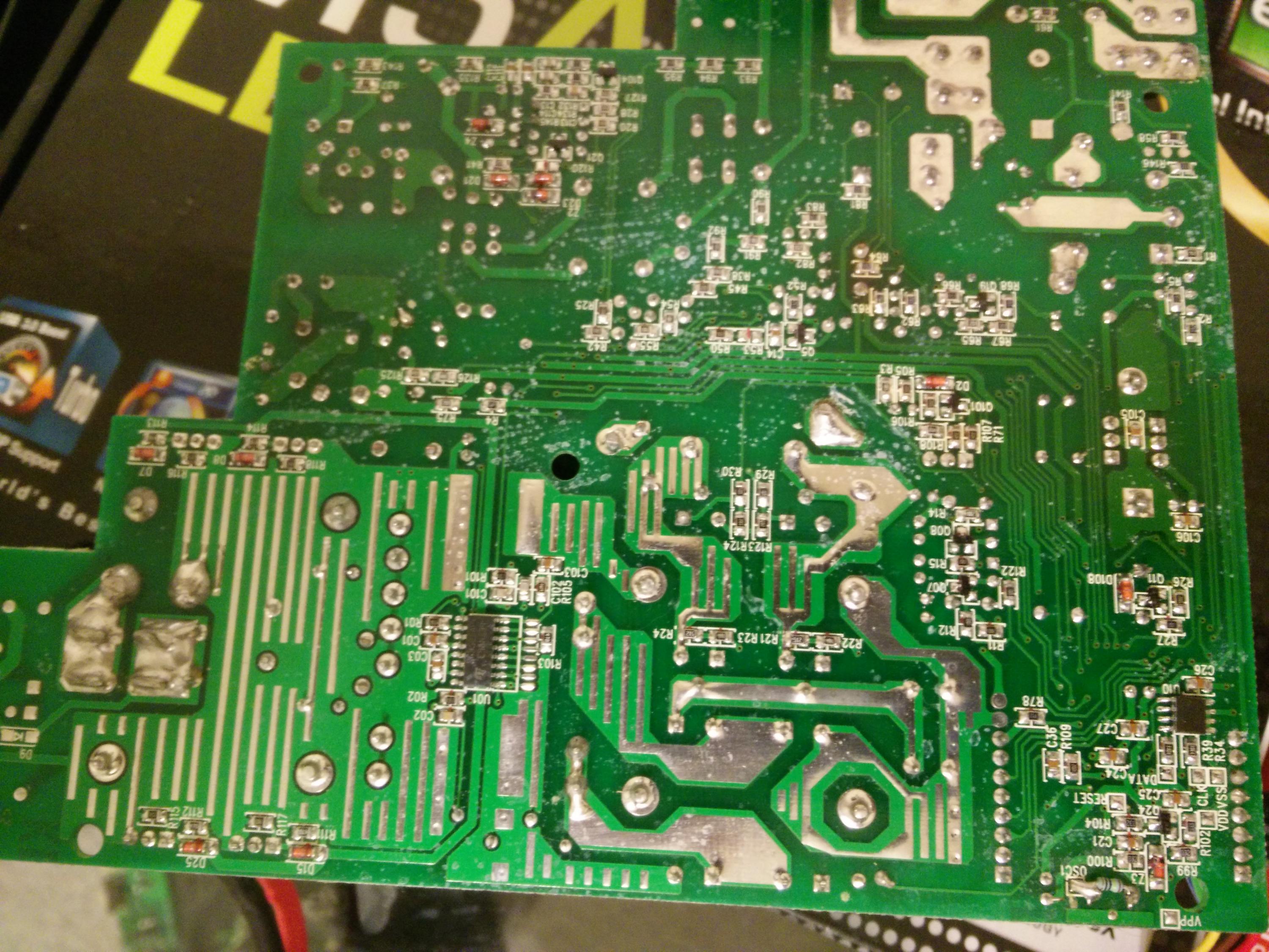

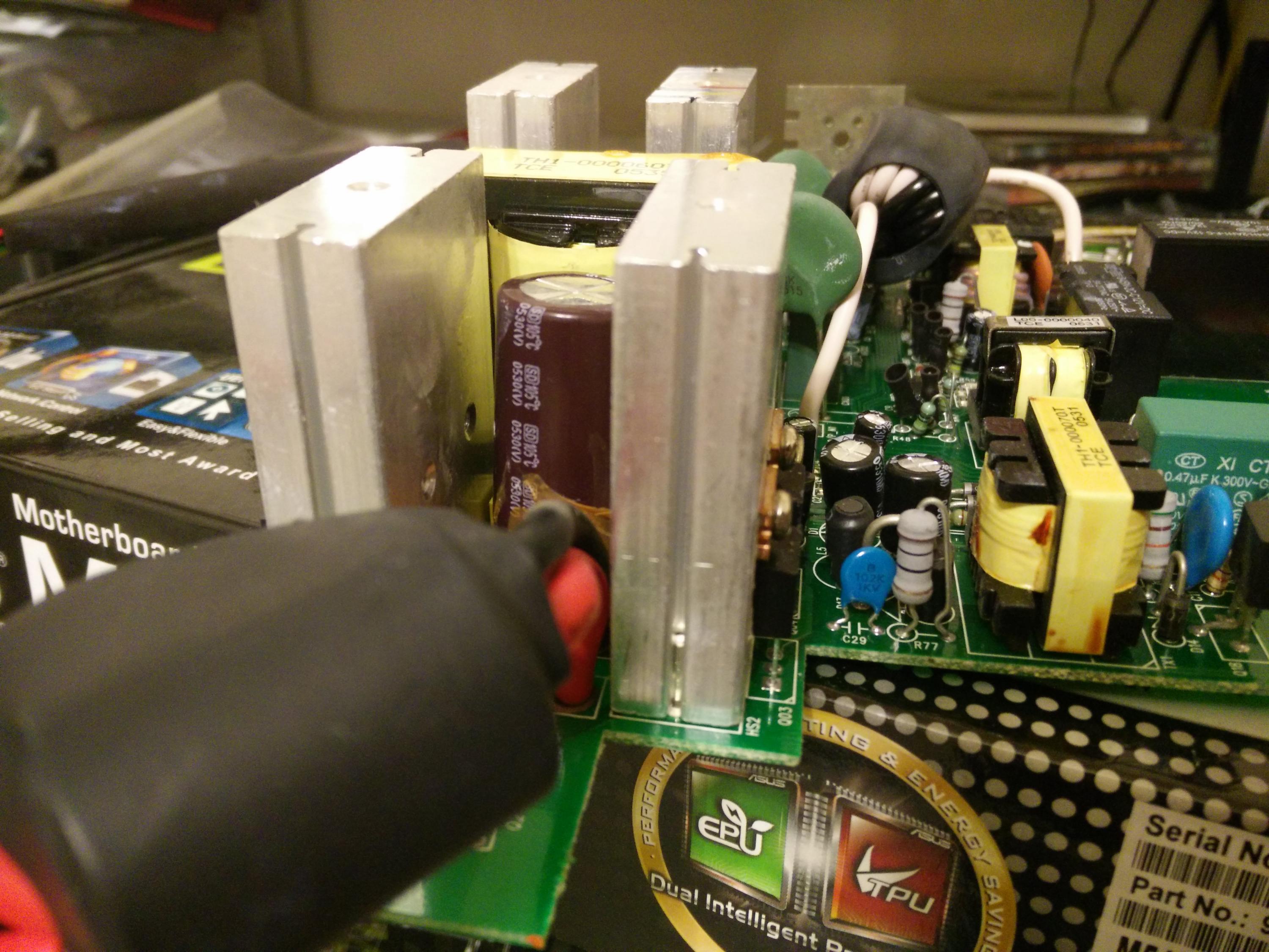

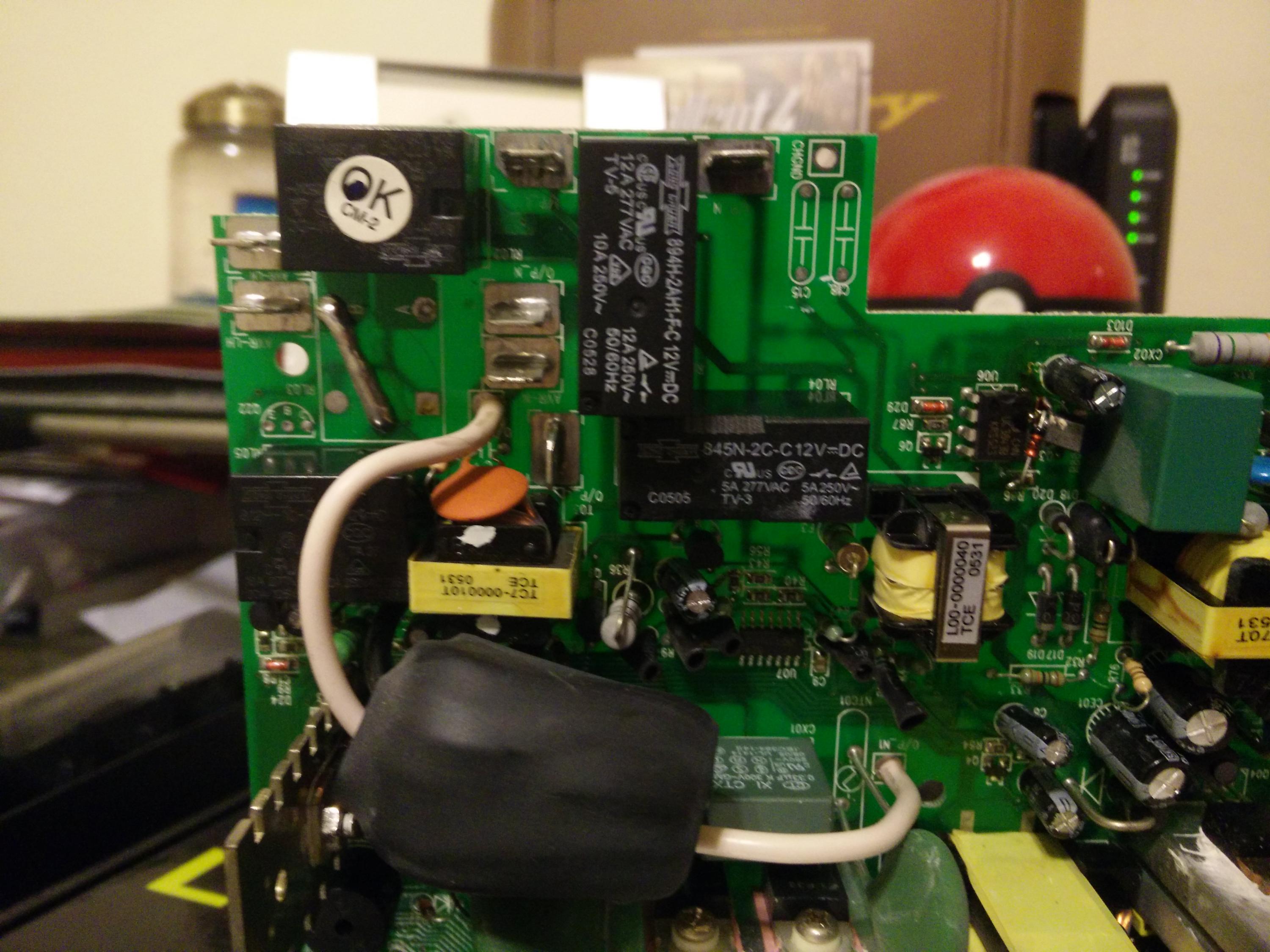

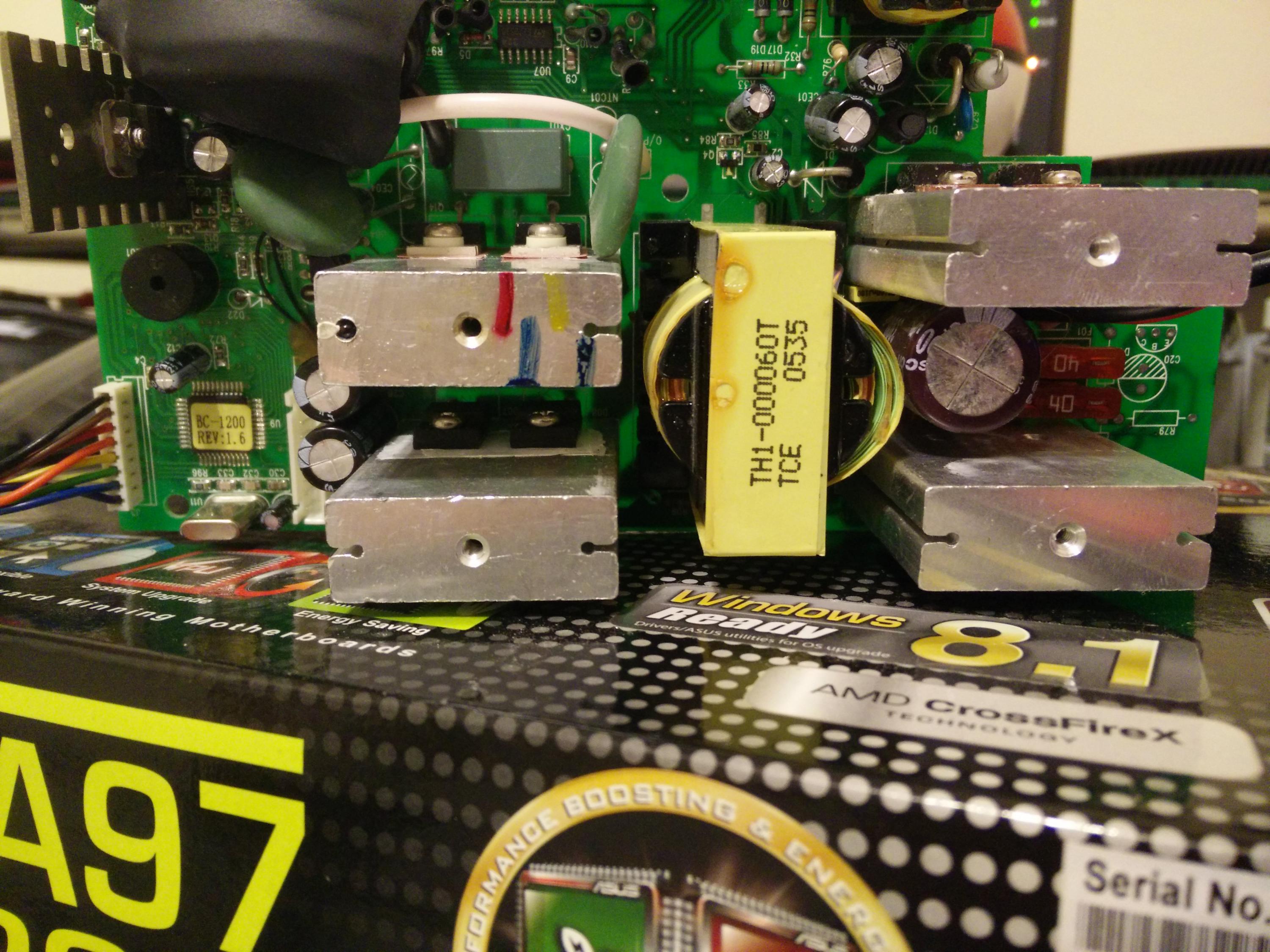

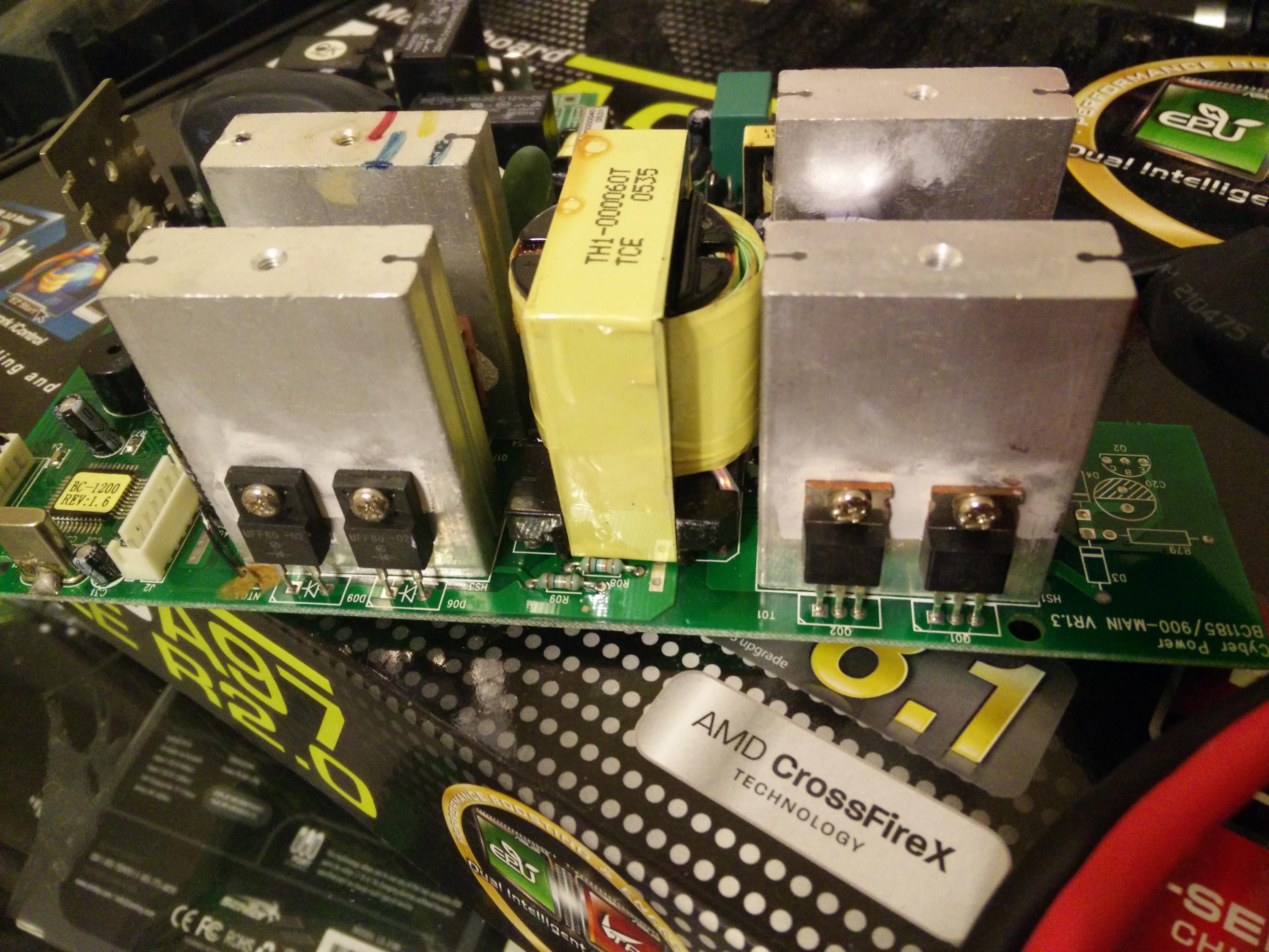

    Hello. You have no idea how excited i was to find a place that helps with this kind of stuff! Anyway, i'm having a problem with a UPS. Cyberpower CP1200AVR. So, it was working fine for months then out of nowhere would just stop switching to battery. The unit functions fine when powered from the wall, but as soon as the power goes out or i unplug it( I know its sorta of bad to do that with no ground and all, but it was for testing) it beeps and then dies completely. The battery's are pretty much brand new and they both show 13v with a multmeter, so its not them. I guess its something internal. I opened it up and nothing obvious stood out to me. No bulging caps. Nothing burned as far as i know. I just have no idea where to begin with this thing. I'll attach some pics of the main board. Thanks!

    We also need straight shot picture of the whole board top and bottom side and the whole in side of the unit, also front panel.
