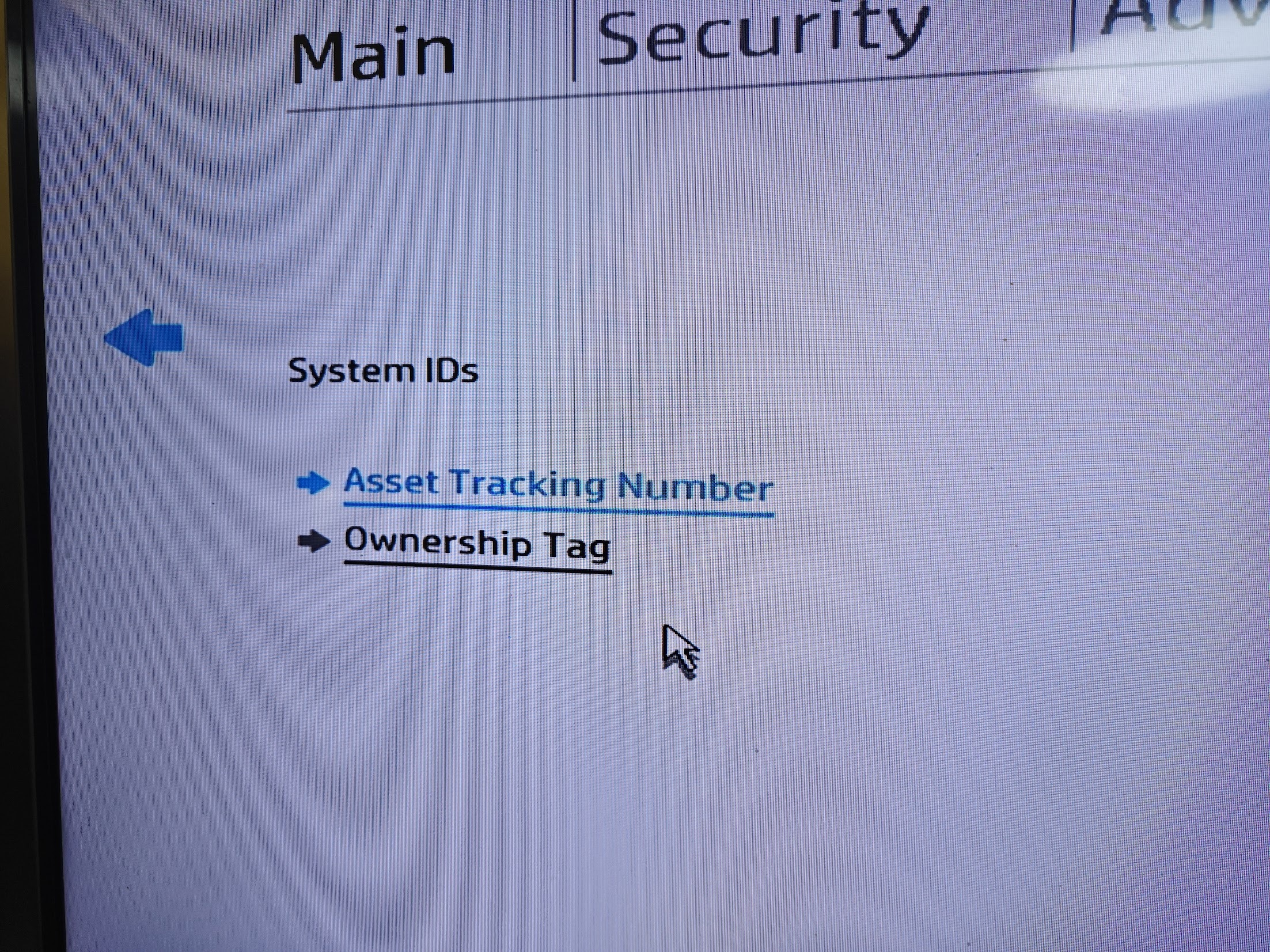

    Hi everybody !
    I bought this pc from ebay with error - There is a problem with the security device on the unit
    please fix my bios.
    Model: HP Elitedesk 800 G4 mini PC (65w)
    serial no. 8CC93326J4
    PRODUCT NO. 4KW04ET#ABU
    32- 16mb bios attached
    Thank you so much

    no more errors..thanks i updated all serial numbers in bios..because was empty..do i also need update asset tracking number?and ownersip tag?
    because both is empty Click image for larger version
    No need

      Originally posted by Echoeye83
      You’re having a software issue. Default the registry under safe mode. And, then contact HP for updates to your BIOS.
      which software.?.there was not yet windows or m2 ssd installed.just this error when i power pc.
              No need
