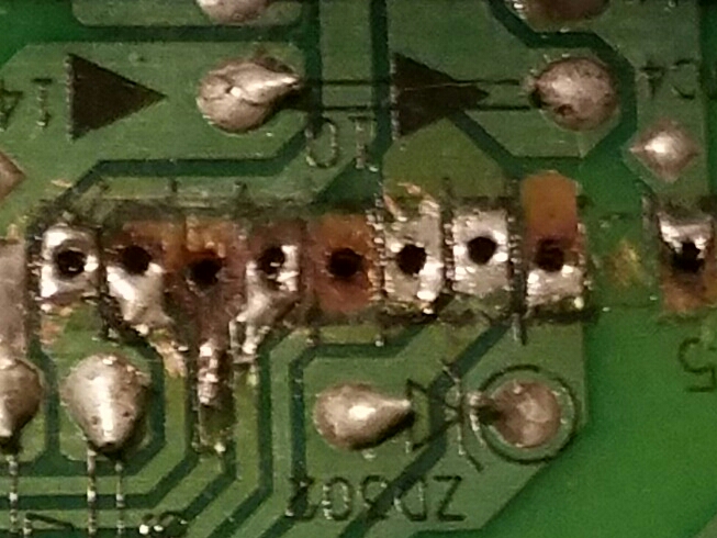

    Does the fifth pin from the left on MC301 go to anything on the power supply. I accidently burned the trace off the pcb and have nothing to solder this pin to. I cant see where on the power supply board that pin even goes though. It just looks like a single pad. Any ideas?

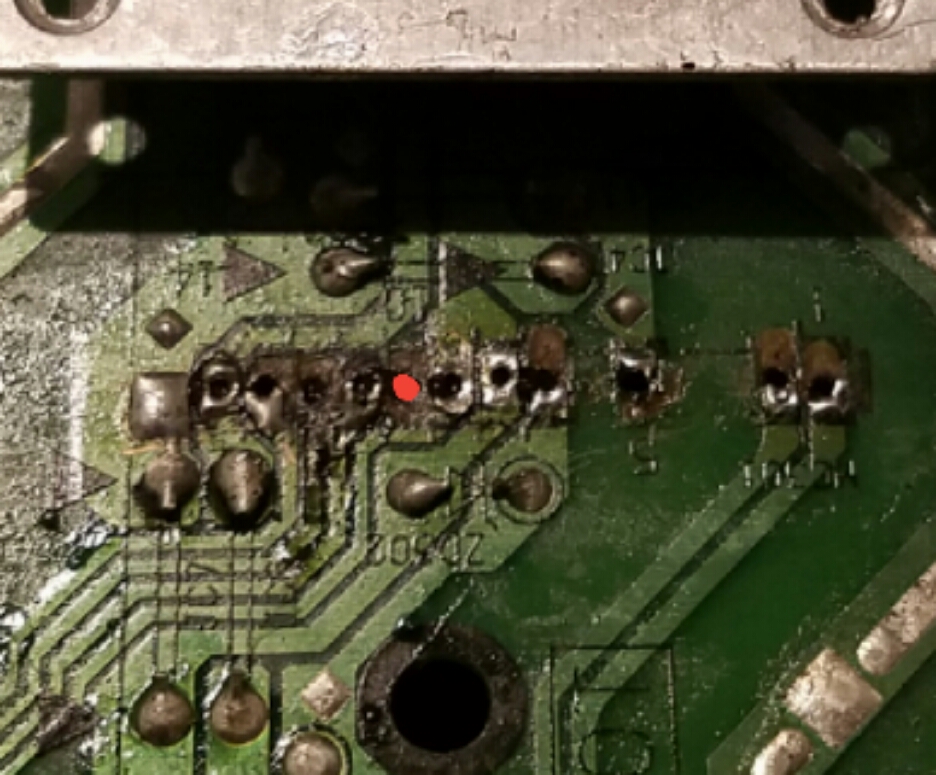

      Re: MC301 on panasonic power supply
      Here's a pic. This pcb is very damaged after many attempts at soldering and resoldering this board. However i can still get all pins to solder up with a bit of effort. The pin marked in red is the one in question. It looks like just a pad to me, not leading anywhere. However, The MC301 that solders up to this definitly has a pin with traces running to it.

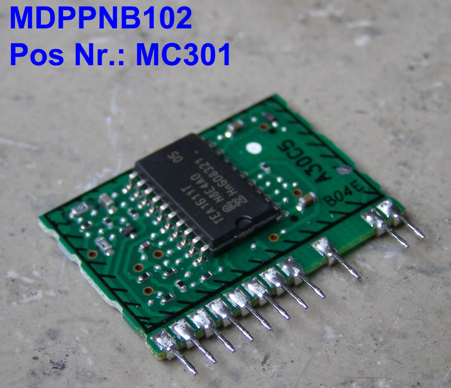

        You should be more precise, which pin number is it, 5 or 10?
        Notice that pins 3,4 and 6 are missing originally.
        edit:
        OK, it's pin 10, RESET
        I would say it's not connected to anything, but can't confirm it sorry
          Then it would be 10. sorry

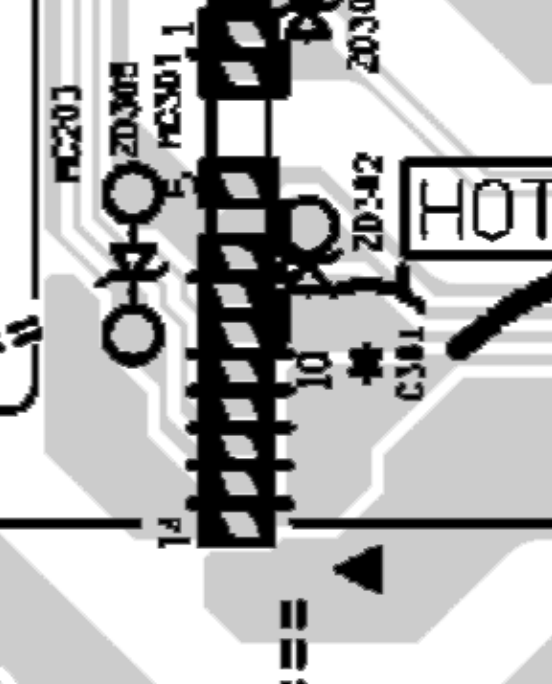

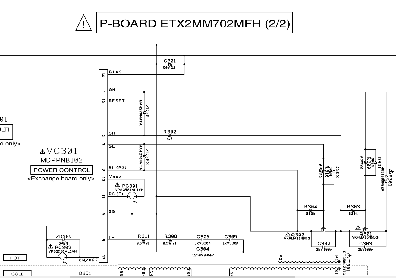

            Thanks for those schematics. However I'm not seeing where pin 10 is connected to. I can see where all the other pins go to but unless i'm looking at it wrong, pin 10 is just an island connected to nothing. Heres another picture, not much better quality but a little cleaner.
              The schematic pin 10 is also shown not being used/connected, so it is not being used in your board either.
                thanks for confirming so the trace burned off on my pcb wont make a difference
