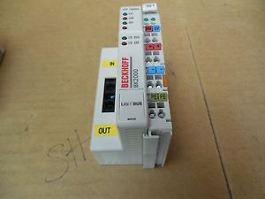

    Has anyone work on one of these units before BK2000 ?
    Or
    A Beckhoff KL2488 8 Channel Output Module ?
    Here is the problem I am having with is machine is that I am getting an light-buss error undefined
    meaning that unknown problem but if you power down the machine and power it back up It might work for awhile and then the same thing may happen two or three time that day or the next day
    Now the Beckhoff KL2488 8 Channel Output Module the LED indicators light for each channel that are lighting are very dim all the time I do not know if this mean any thing or not

      I bought a use one of these off of eBay $20.00 Beckhoff BK2000 for me to see what is inside of one I am also going to buy one of these as well from eBay 2@ $20.00 Beckhoff KL2488
      I might be able to see if it is a power supply problem or not because two of the servo drives on this same machine have already been recapped because of drive errors
      Once recapped those errors have not come back so far but it has two more drive that have not been recapped but we have a spare drive for me to have time to recapped one at a time

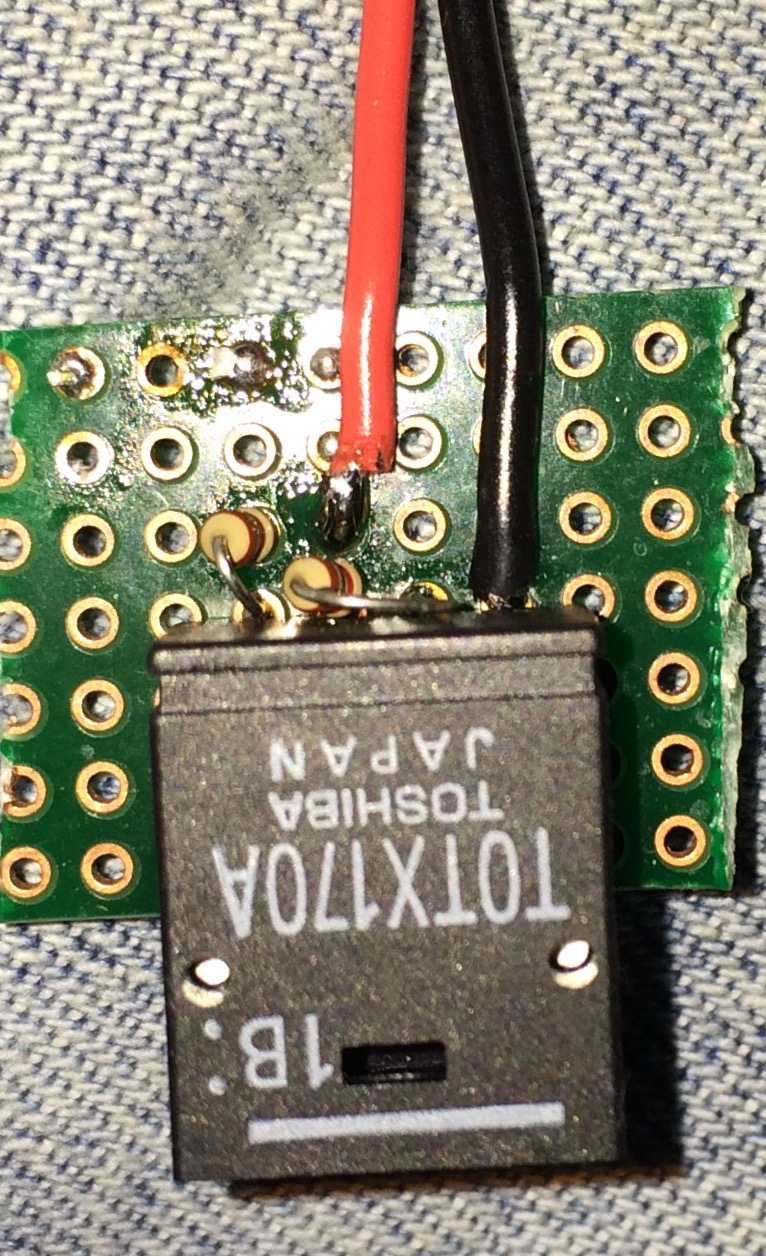

                After looking at the data sheet I am going to make a fiber optic cable tester from some of the part out of the BK2000 that I bought off of eBay
                I already built the tranmiter board and it works good now I have to build the reciver board then I can check all the fiber optic cables on this machine has and go from there

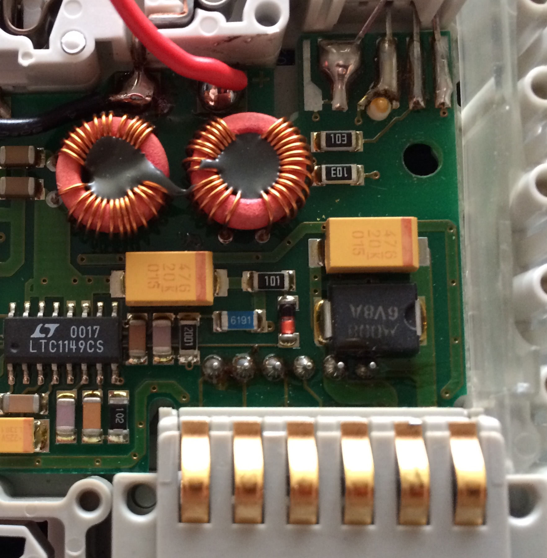

                Here is a photo of the power board of the BK2000
                I have a question about the surface mount caps on this board do these caps go bad often ?

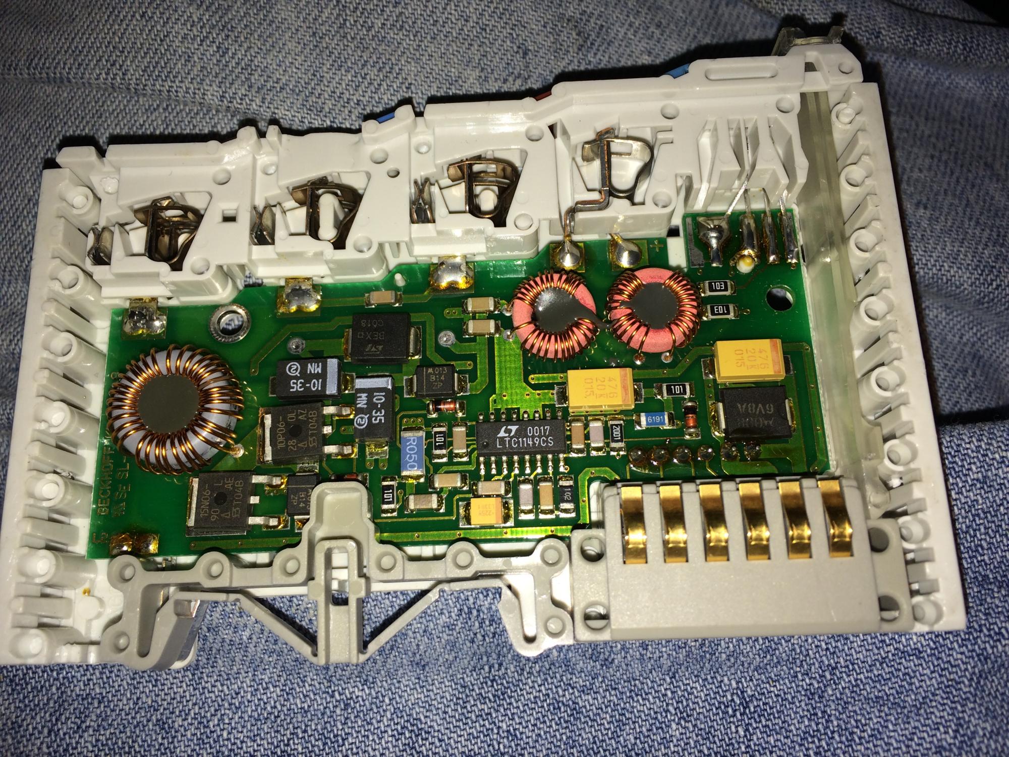

                  There are three boards in this BK2000
                  Power Board
                  Controller Board
                  Optic Sensor Board
                  Here is a photo of trasnmiter board
                  The receiver board I will build to tomorrow

                    Here is the pin out on this board from left to right
                    (+5v ) (-)(unknown) (+5v) (-) (+5)
                    The reading on the 5 volt rail are very satable at 5.25 on each one

                      Well I made the board and went to power it up with 24 volts instead 5 volts
                      It light up like a chirstmas tree
                      I had it adj for the power board on the BK2000
                      I had looked at so many data sheets that I forgot that this was 5 volts
                      Not a very good mistake i was not feeling very good about doing this
                      It been awhile that I hav done this type of mistake o well

                        show some good foto's of the boards in this thing.
