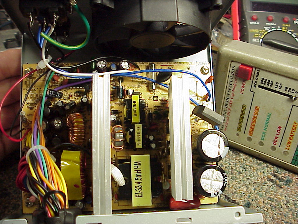

power supply hall of shame entry 1
  • kc8adu
    • Nov 2003
    • 8832
    • U.S.A!

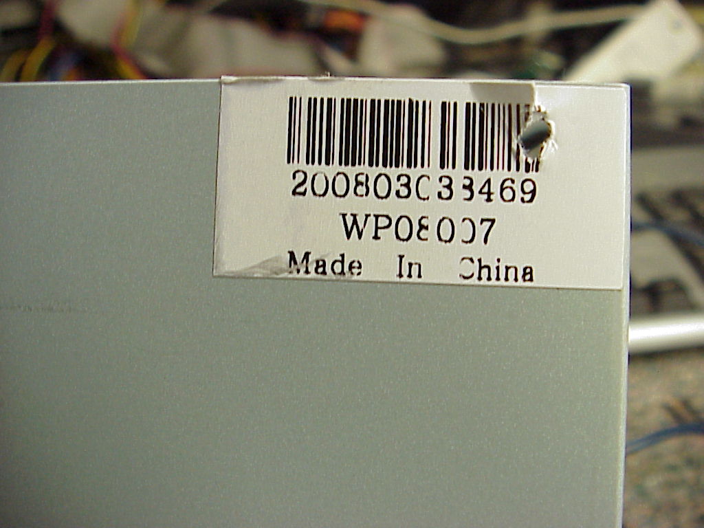

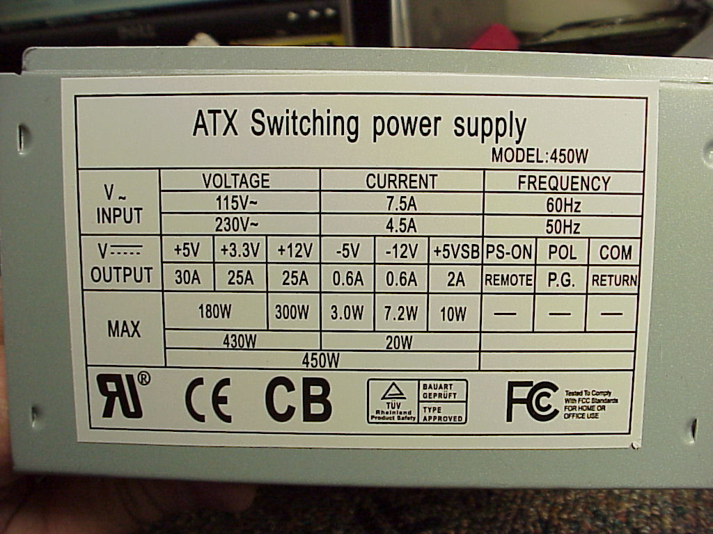

    a real loser.
    name withheld by mfr to protect them from the wrath of the fcc ,ul,csa,ect for forged certification marks.

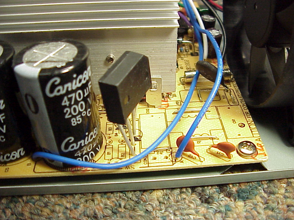

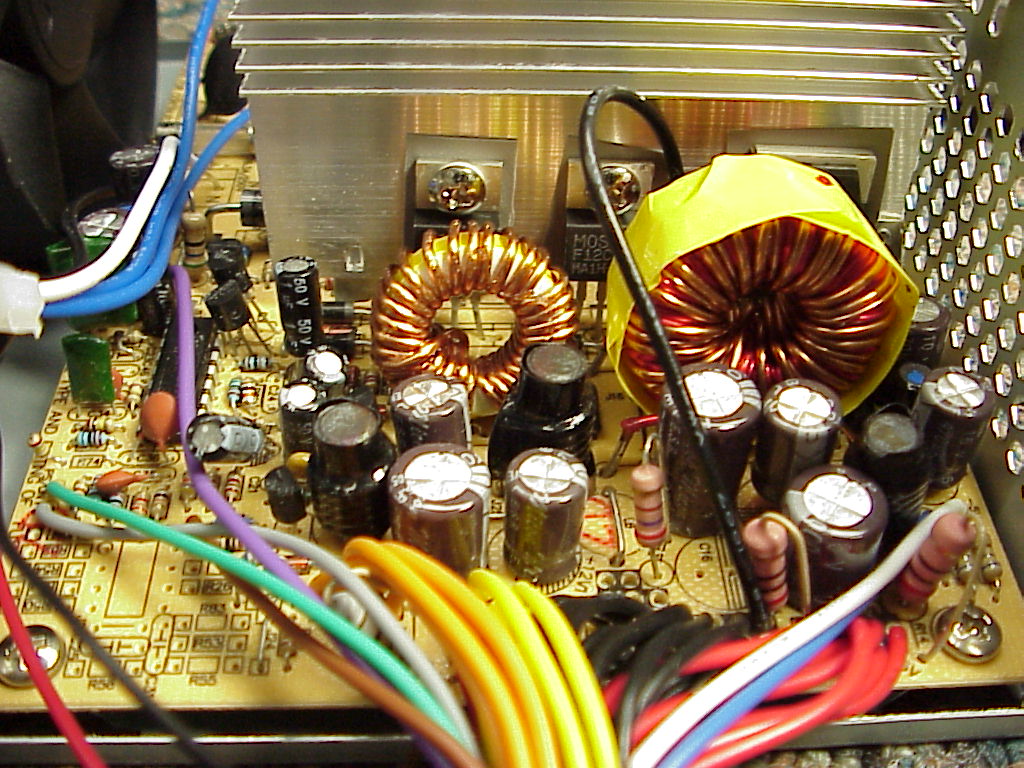

    Re: power supply hall of shame entry 1
    Craptastic. I especially like the missing protection chip and circuitry, and the complete lack of transient filtering on the primary.
    Always get a chuckle out of those Canicon caps... somebody sure got conned

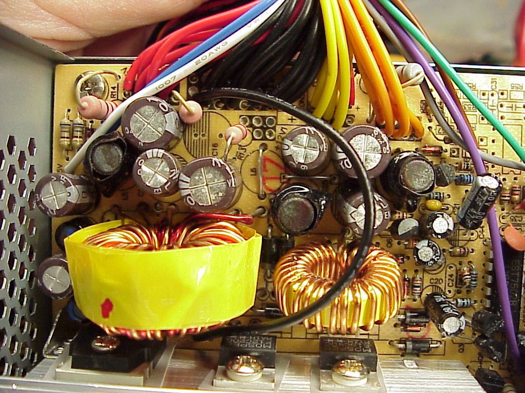

              Notwithstanding the crap L&C innards, this one is actually better than some of the fake 450W ones I've seen. At least, it seems to have MOSPEC 12A rectifiers on +12 and +3.3v, and what appears to be a TO-3P 30A rectifier on +5v. Most of the secondary capacitor locations seem to be populated. I would not be too surprised if it worked reliably at a 300W load, and a simple recap with good caps should be sufficient to keep it going for PII/PIII class machines which typically consume less than 100W.
                Actually that's not so bad for a generic 450W power supply.
                It would be fine for an older computer up to the Athlon XP/early P4 class computers.
