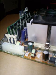

    Can a bad MB fry a PSU?
    I have a Gigabyte 7I-XEH motherboard that had some distinctively bad capacitors; it had 8 and a half years of service before it finally died (and before I learned about this problem!). Anyway, I removed it after a catastrophic failure that fried my severely overheated video card. I've spent $260 already in replacement parts, and not interested in spending too much more.
    In any case, considering the incident, is it possible that the old MB fried my PSU, by either a feedback or a short, or did I just get a really bad MB replacement? The replacement is also showing very minor signs of bad caps, which were NOT present before I powered it. The tops are still flat, but the caps are not flush with the board, and are pointed slightly every which way.
    I inspected the PSU as much as I could without opening it (by looking in the air vent). Everything seemed fine, except for one capacitor which SEEMED to be leaning to the side (but I really could not tell), but there was a suspicious brown spot on top of one of the capacitors. There were no signs of any broken vents, but again, I couldn't tell. I am not opening the PSU for fear that it may still be under warranty.
    PSU: Logisys PS480D-BK
    Old MB: Gigabyte 7I-XEH
    New MB: ECS w/ SIS 761GX/965L chipset (I can't find any actual model number)
    New MB symptoms:
    Worked fine for 4 minutes, then suddenly "died", no display signal and power light on the case went out. After second attempt, only stayed up for 10 seconds. All fans were connected and running.
    No signs of overheating; all heatsinks felt quite below normal operating temperature, and considering operating time, normal.

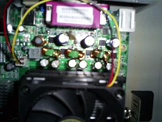

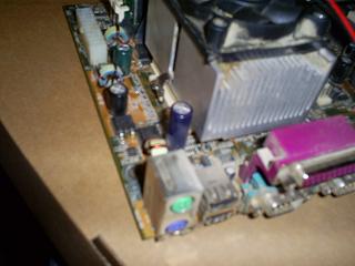

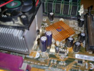

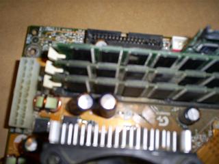

        Alright, here are the pics. Oh, and I forgot to mention, I've never done any work on the motherboard which would cause the shorting.
        NewMB.jpg - The new motherboard caps
        OldMB-Burst.jpg - Gigabyte board, showing capacitor burst
        OldMB-SideCPs.jpg - Gigabyte board, showing two swells. One is near the PSU connector, the other right under the heatsink. (In this picture, to the left)
        OldMB-Swelling.jpg - Gigabyte board, showing two swells near the heatsink.
        OldMB-SwellTop.jpg - Gigabyte board, showing the bursted capacitor from the 2nd pic leaning over (this is exactly how I saw the problem in the first place, after the computer stopped working).
        All caps are Choyo.
        The pictures are available for anyone to use, dissect, reuse, post in hall of shame, whatever.

              Re: Can a bad MB fry a PSU?
              Bad MoBo caps could kill marginal PSU by overloading it's filter caps.
              More likely hard failed video card killed PSU.
              If you killed it this way the warranty is voided anyway.
              Open and fix it or trash and replace it.
                  perhaps even bad psu eating away normally ok mobo, and then they went down together in the end, first mobo, then it overloaded the psu few seconds later.
                  important to say:
                  no, bad mobos can't fry decent psus.
                  they can fry crap psus, though.
                  • gdement
                    • Jan 2007
                    • 690
                    I think even a good PSU will suffer and eventually die from the excessive load that bad boards can cause. They do have overload protection, but I doubt it's perfect. Even if it is, just running the PSU *near* the point of overload is going to wear on it pretty quickly. My testing PSU's seem to gradually degrade, while PSU's in permanent machines last a lot longer. I can only conclude it's caused by the abuse of testing all those marginal boards. It adds up over time.
