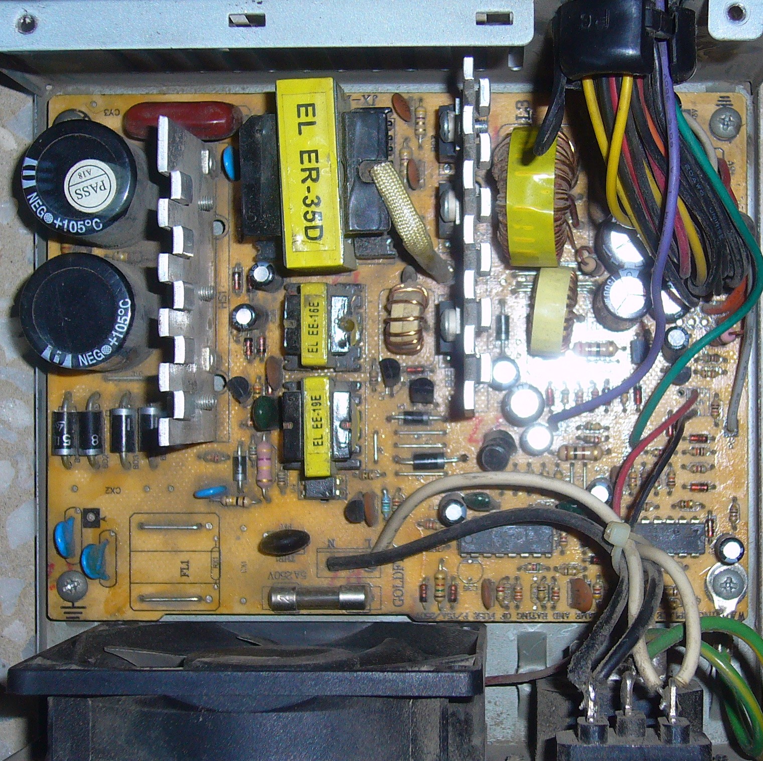

    Got a cheap supply for free with bad output 5.8 Volts on the 12 volt rail and 2.5 volts on the 5 volt rail..Iam not planning to use it with a system just want to use it for other purposes..Can it be fixed???

          Re: Cheap Supply
          Do the output voltages hold steady or fluctuate?
          If they hold steady you're probably looking at a feedback problem.
          • keyboardcowboy
            • Apr 2006
            • 73
            Re: Cheap Supply
            Output is dead steady.
            • Krankshaft
              • Jan 2007
              • 2328
              Re: Cheap Supply
              Then I'd check the feedback sampling circuits for shorted or off value resistors.
              If that reveals nothing then the issue may lie inside the PWM IC.

                Re: Cheap Supply
                Check or replace that fuse. Looks like it might be on its way to being blown. Measure voltage on either side of it to see if there's a partial drop, and check resistance through it. I've seen fuses partially fail during a power event and then only allow partial current/voltage through.

                  Re: Cheap Supply
                  No way I had that happen once too I was so embarrassed when I found it out.
                  Good observation I hope that the discoloration on that fuse is dust and not vaporized filament .
                  I've read that the theory is the fuse filament vaporizes on the glass fuse body making a resistive electrical connection across the fuse body allowing the current to still flow at reduced capacity (due to the resistance).
                  It was on a 5.1 audio amp the fuse was an axial type incased in one of the transformer secondary wires.
                  When I finally broke down and cut off the heat shrink tubing I measured a resistance.
                  If you want to do it in a safer fashion measure for resistance across the fuse.
                  Any DECENT power supply would actiate undervoltage protection in this case shutting the supply down. If that isn't a sign to junk it then I don't know what is.
                  There are plenty of cheap ATX psu's to be had that are way better designed than this one.
                  But if it's just to see if you can get it working keep posting results.

                            Re: Cheap Supply
                            How can I test the PWM,its a AUK S494P
                            • keyboardcowboy
                              • Apr 2006
                              • 73
                              Re: Cheap Supply
                              Found The Problem!!
                              it wasnt the Supply it was ME ,I was shorting the wrong wires to turn the PSU ON,instead of shorting the Power On wire with Ground i was shorting it with the Red(5v) wire.But now after fixing this the Supply wont even turn On the fan spins for a second and then turns off.

                                Re: Cheap Supply
                                hook a harddrive to it and try again.
                                many power supplies need a minimum load.
                                • keyboardcowboy
                                  • Apr 2006
                                  • 73
                                  Re: Cheap Supply
                                  No matter whatever i attach with the supply it still wont turn ON
                                  • keyboardcowboy
                                    • Apr 2006
                                    • 73
                                    Re: Cheap Supply
                                    Tested the switching transistors and the Standby voltage,its fine.
                                    • keyboardcowboy
                                      • Apr 2006
                                      • 73
                                      Re: Cheap Supply
                                      Interesting Find!!
                                      After removing the COSMO 1010 817 Photocoupler the PSU starts up normally. Iam pretty righ now about what the problem might be??
                                      • capamatic
                                        • Apr 2006
                                        • 33
                                        Re: Cheap Supply
                                        Get the datasheet of your monitoring/protection IC. If the `FPOB` pin is connected to the Opto, then the PSU starts because you have effectively disabled the output fault protection signal. It`s hard-powered on.
                                        You should be careful that your voltages etc are OK, as your PSU is now not fault protected.
                                        Consequently, if your outputs are OK, then you have a faulty protection IC or Opto.
