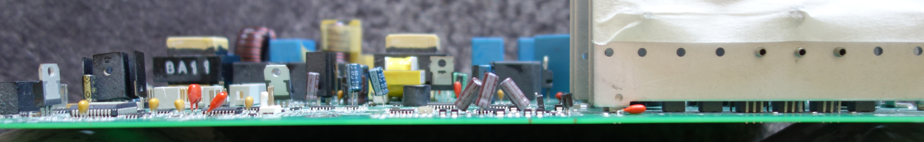

              Re: APC SMT2200i not charging
              Here we go
                Can we see the straight shot of the whole board top side and bottom side and the whole shot of the whole unit to see how the batteries are connected to the board?
                  I can't do a shot of it connected at the moment but I can put up a pic with a crap photoshop of where the wires go, battery splits the charge so one red battery goes to the top left of the heatsink, the other bottom right. The white and black on the heatsinks head off to one of the transformers and both battery negatives go each side of the heatsink onto the board itself.

                                    I reread the whole thread. You reported that none of the caps "look" swollen. Did you actually test them with an ESR meter? Does the unit charge the batteries at all (if you let the batteries drain below the 7V difference)?
                                        I don't have one & have not let the batteries drain that low as the unit shuts down when they hit 10.5v under load, that raised back up to 12v per battery or 48v total where is sat overnight doing nothing apart from saying the capacity was going up when not a lot happened as it shut down in under 2 minutes where 100% charge went down with no load to nothing in a minute.
                                        Looks like I will have to invest in a ESR meter to progress then?
                                        Any suggestions for something cheap to do the job?
