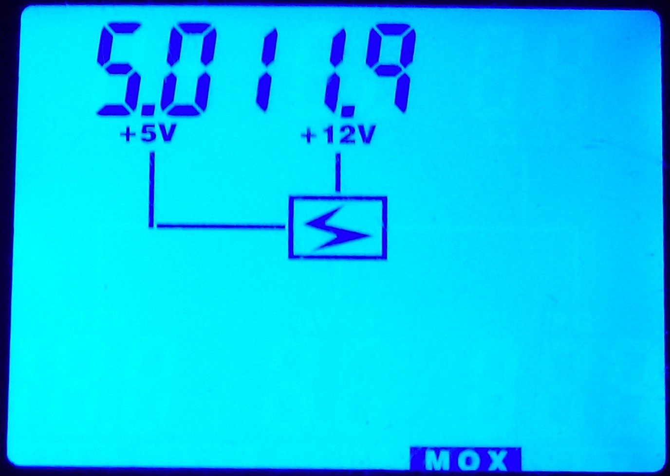

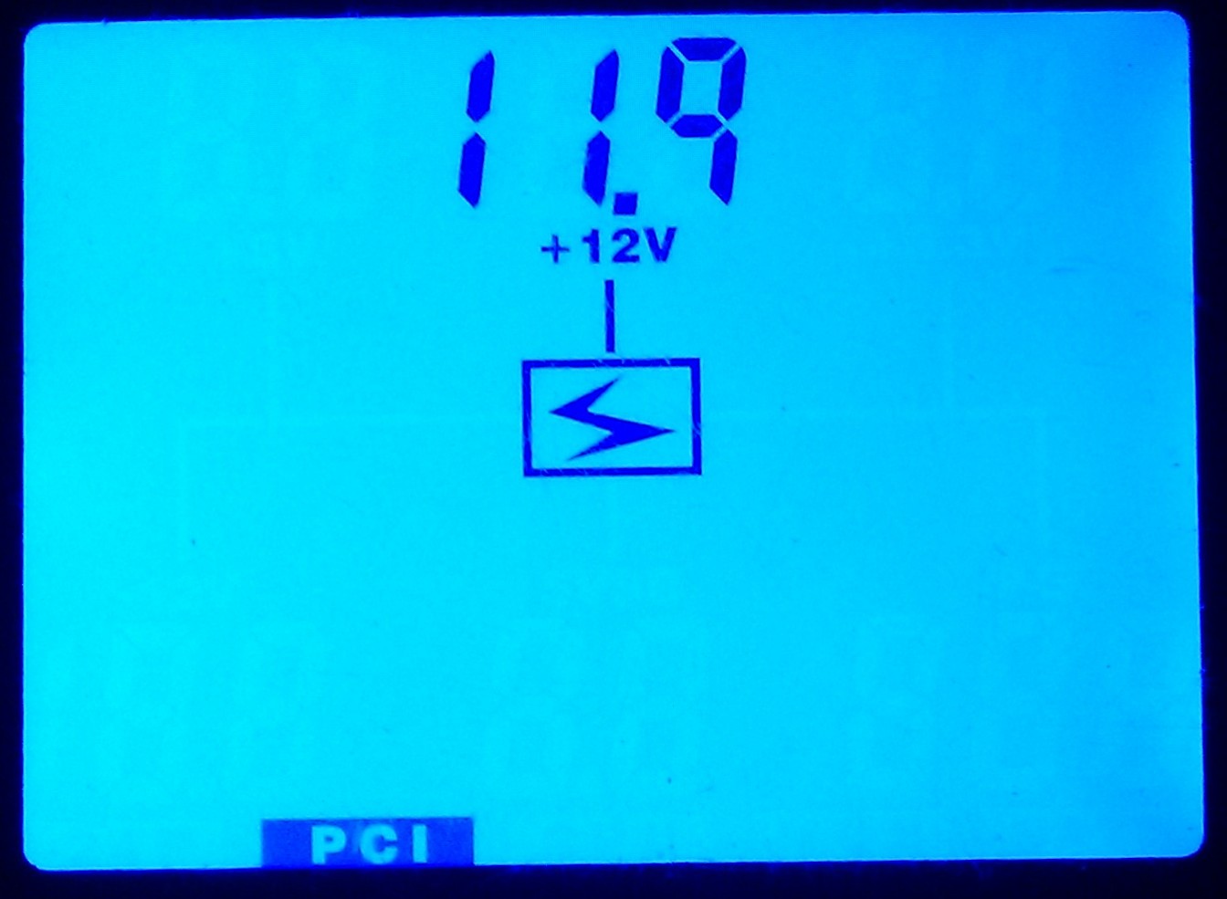

    The PSU is old , was received in good condition and the seal is intact. I did not want to open it, I just blew it with a compressor.
    Meanwhile, I used it on different systems or to test various components.
    As you can see it is a wide range of voltage source with 90 ~ 264V, active PFC and ATX2.0 standard-a fixed 24pin connector:
    http://www.coolermaster.com/service/...l/RS-450-ACLY/.

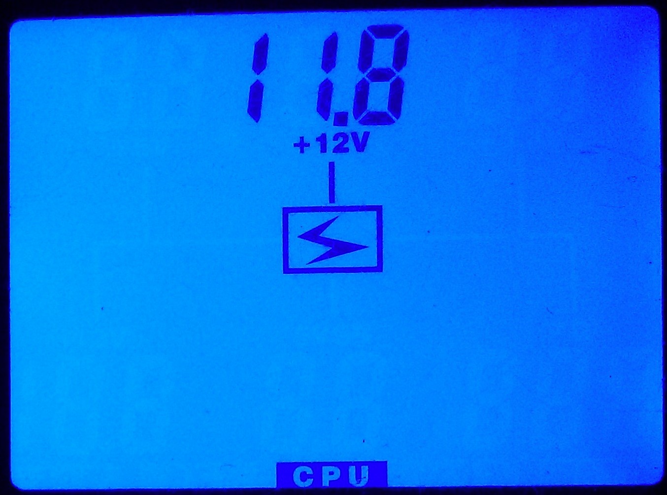

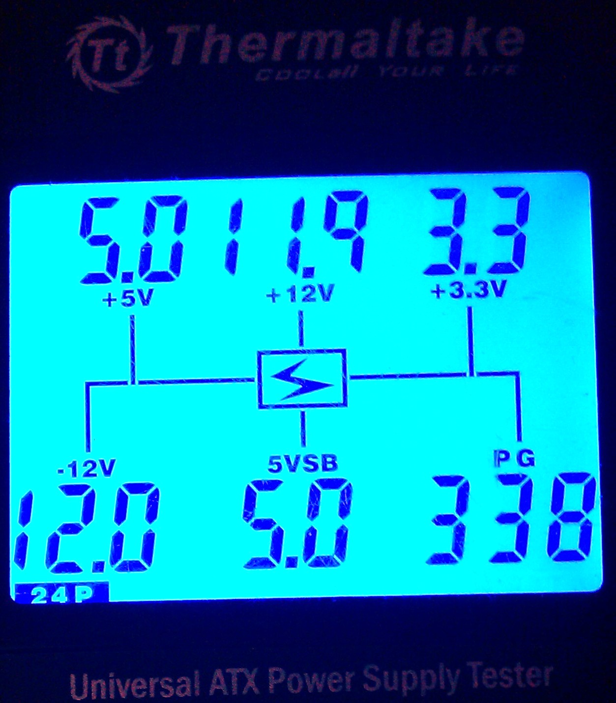

    I measured it with a DMM but with a dedicated tester - Thermaltake Dr.Power 2, and values are ok.
    Works fine, but using of certain motherboards (DFI P35T52RL BloodIron, DFI NF4-SLI Expert and other old 2 to 3 mobos) fails to power on, restarting continuously, as if a malfunction of the motherboard.
    What can cause this to occur?!
    Thanks.

    I wonder if the Power Good line is a little too low in voltage for some mobos?
    Perhaps its triggering the restarts perhaps.
      • 30991
      Re: CoolerMaster RS-450-ACLY PSU issue?
      maybe the "tester" is not putting a heavy load on the supply lines.
            That's not a maybe, sir. That is for sure .
            Those PSU "testers" are hardly useful for anything.

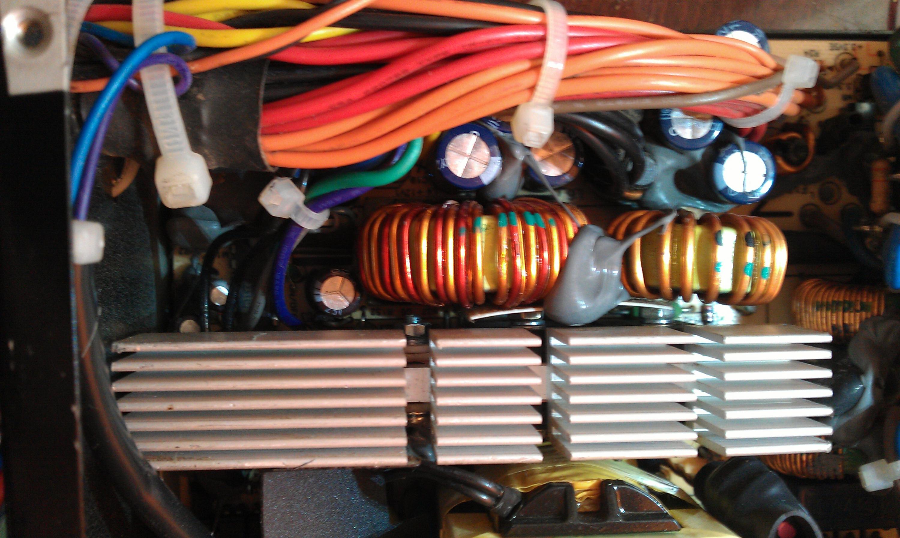

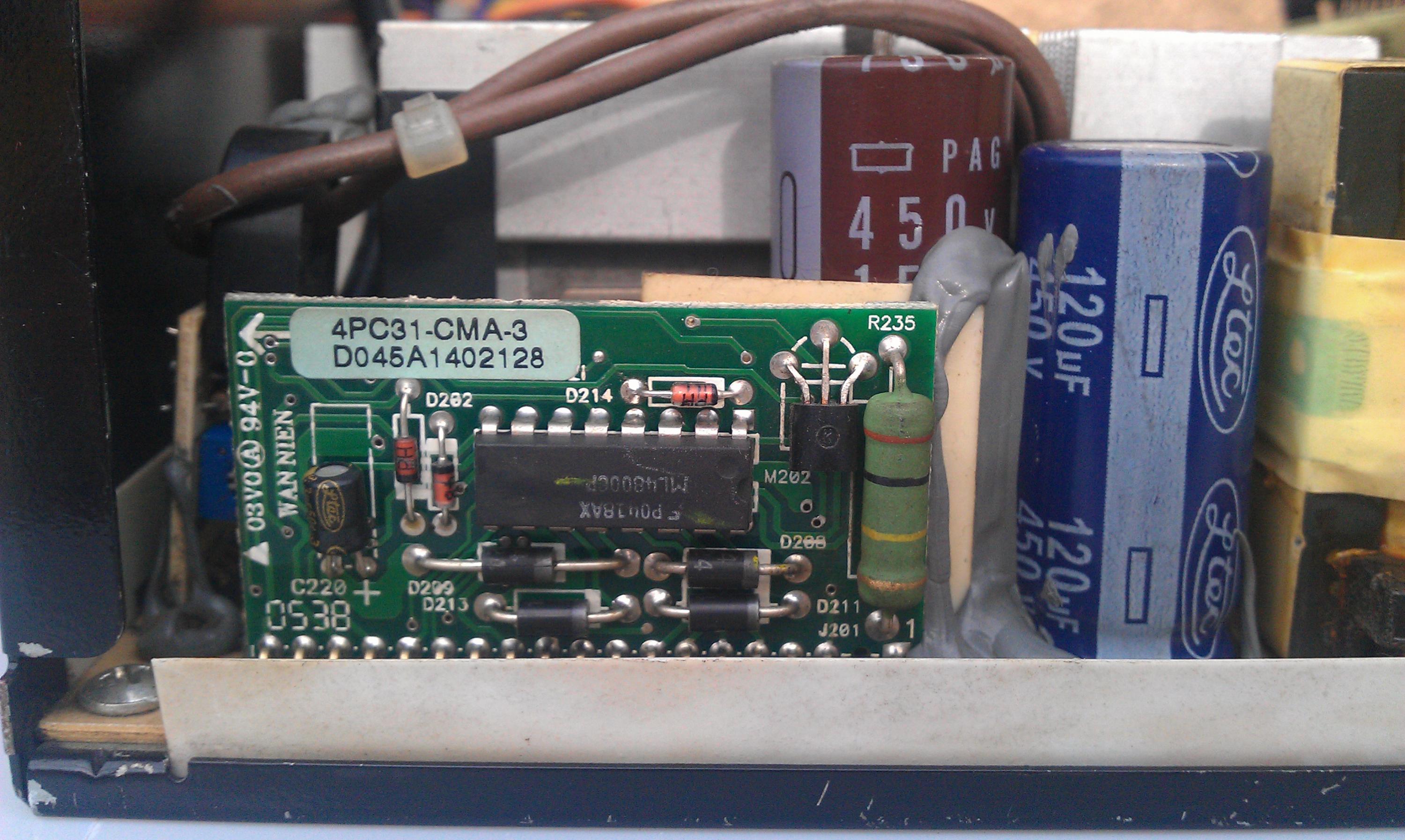

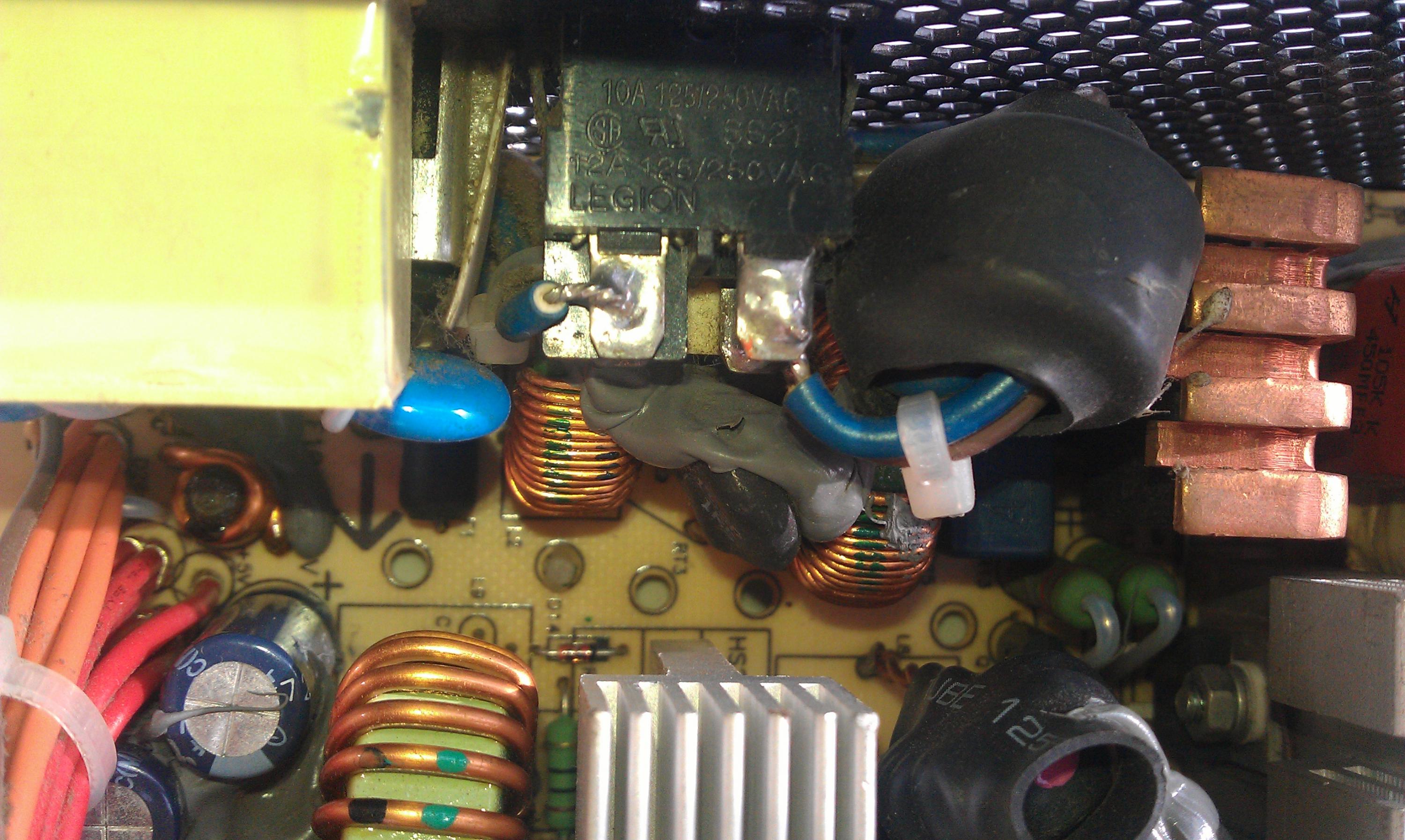

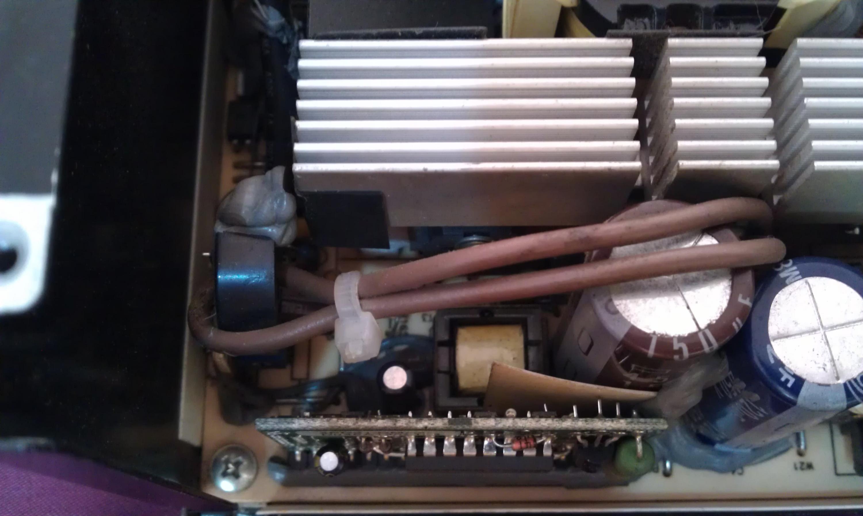

            • alindumitru46
              • Aug 2015
              • 255
              • Romania
              Yes, boss!

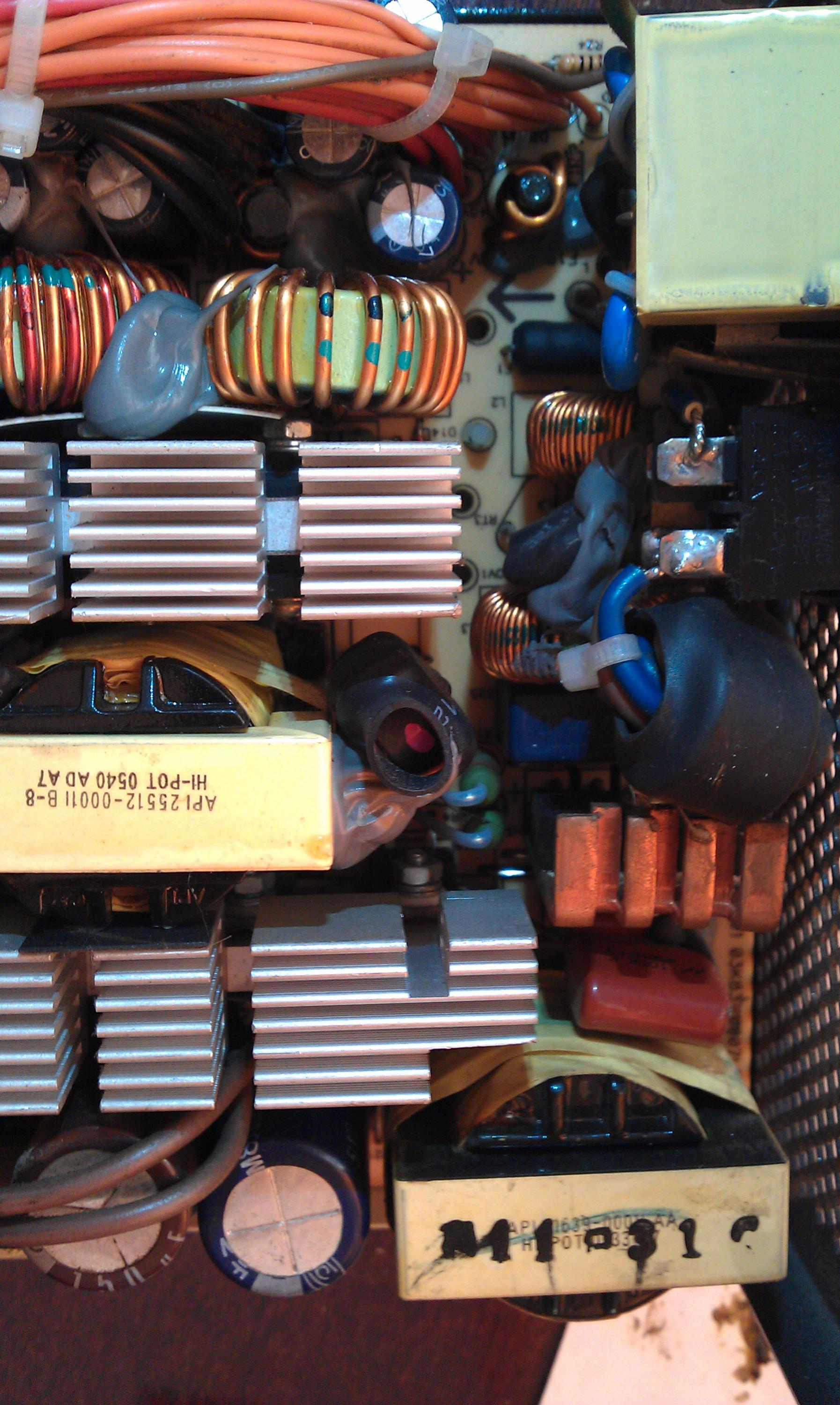

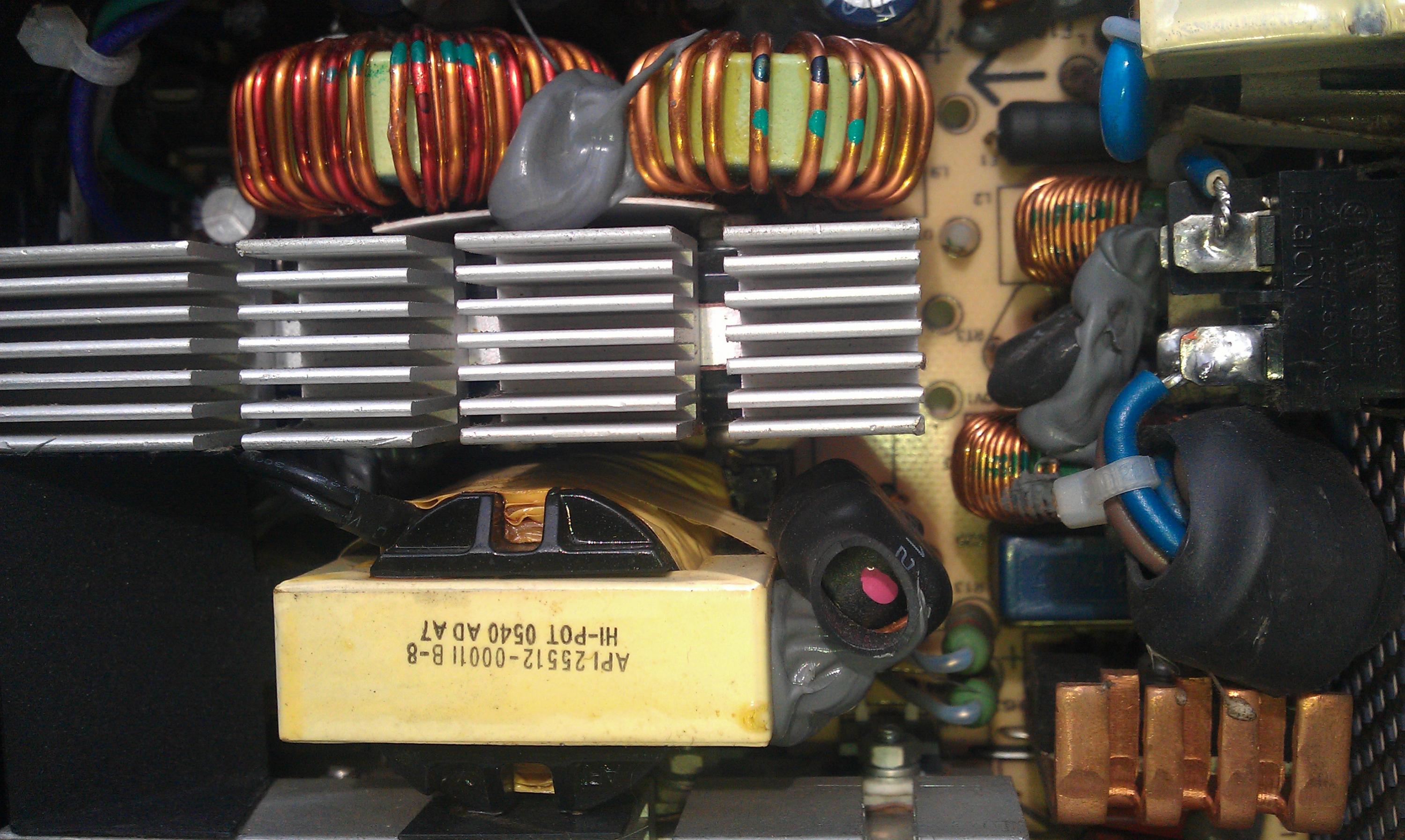

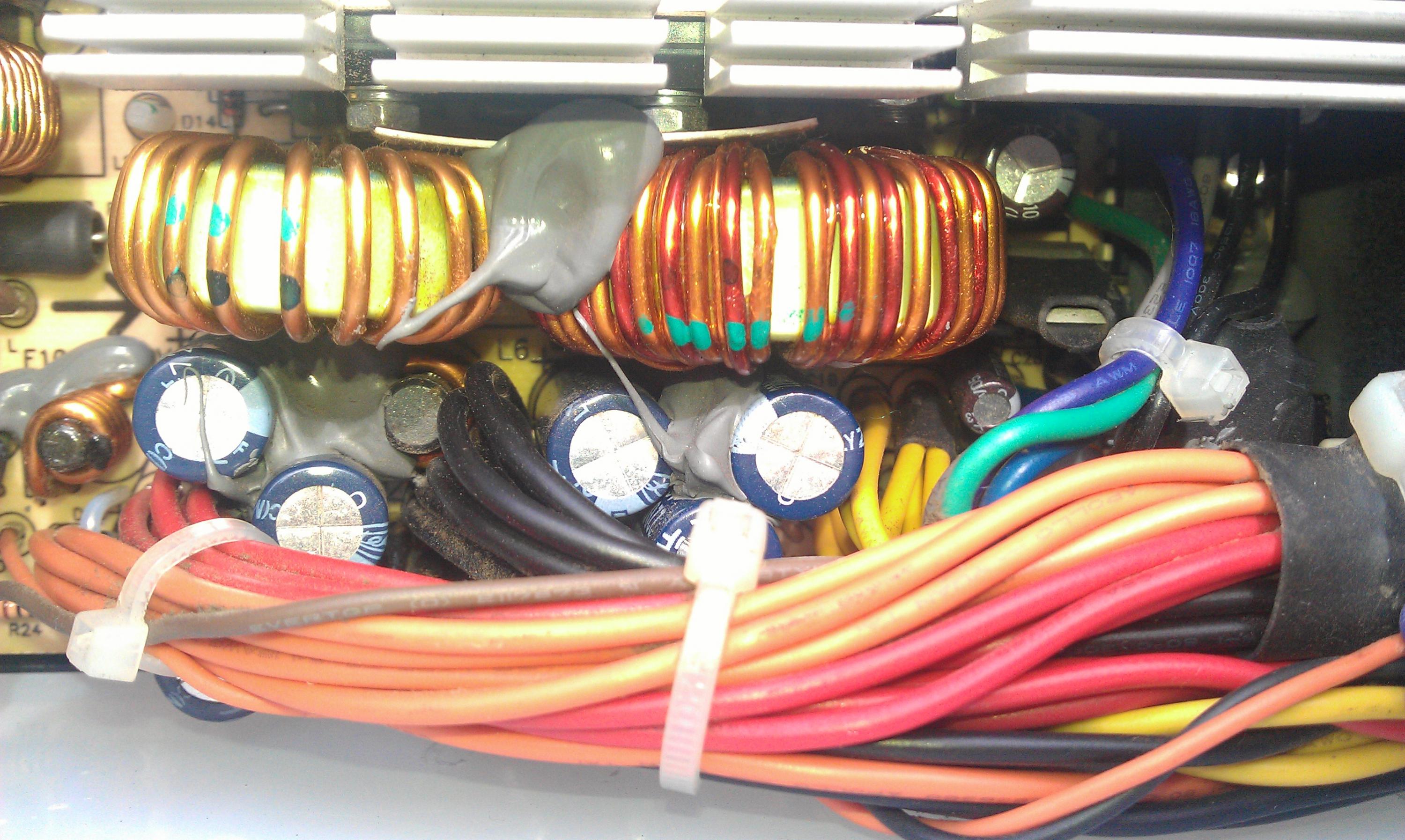

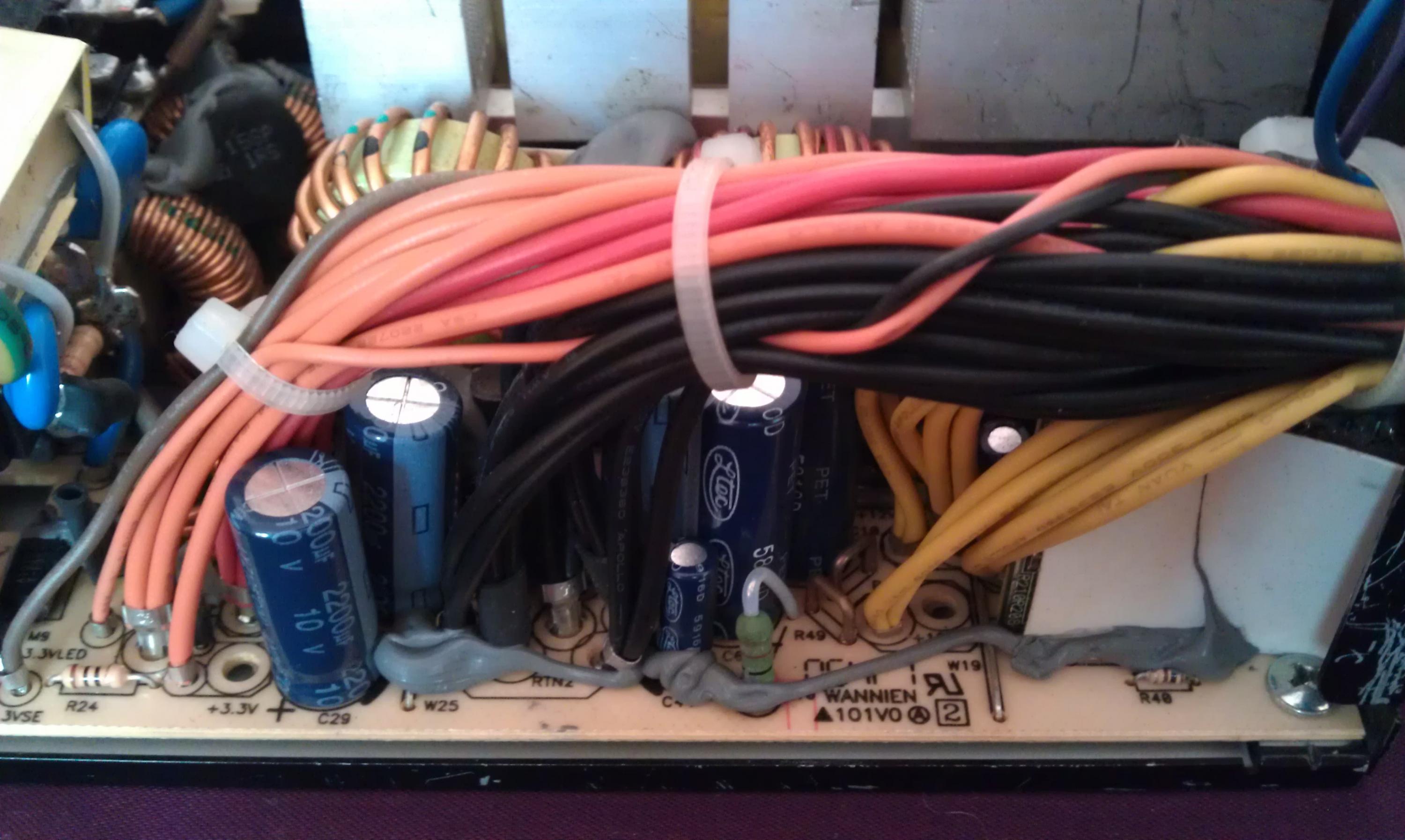

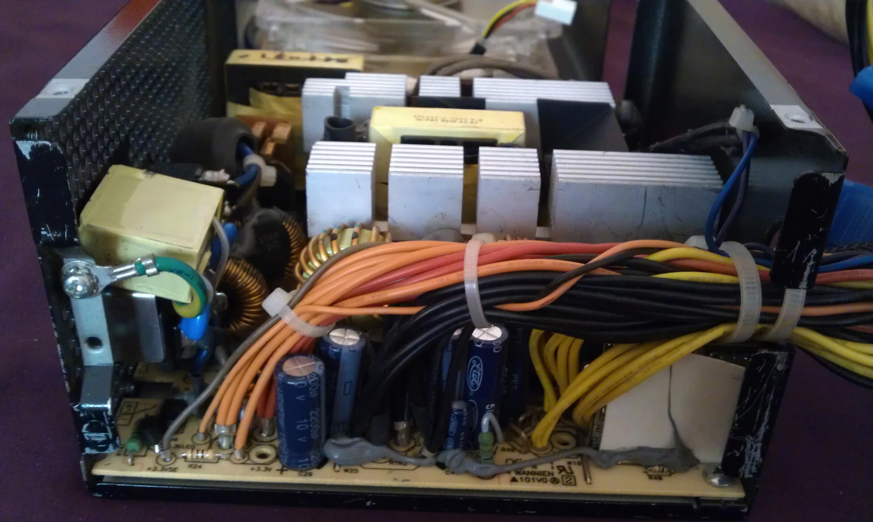

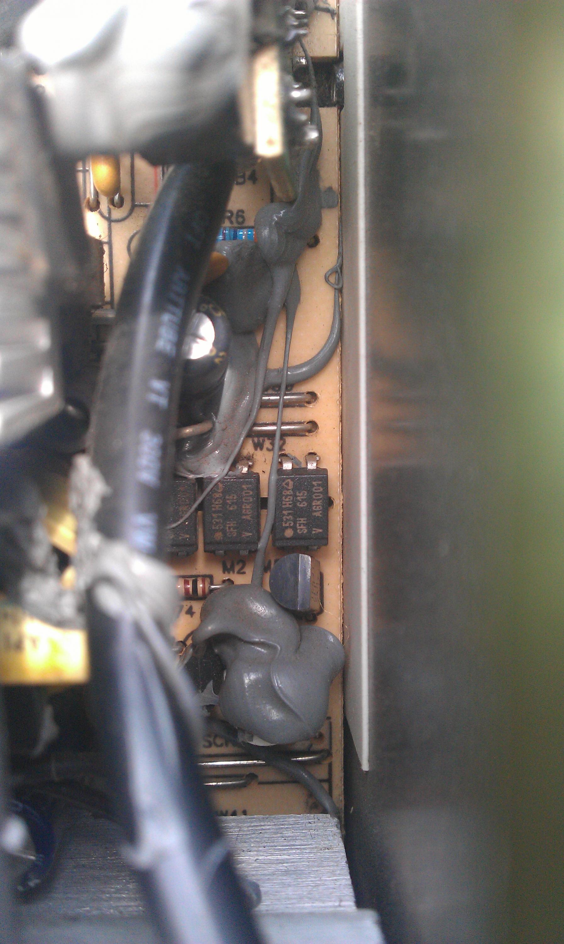

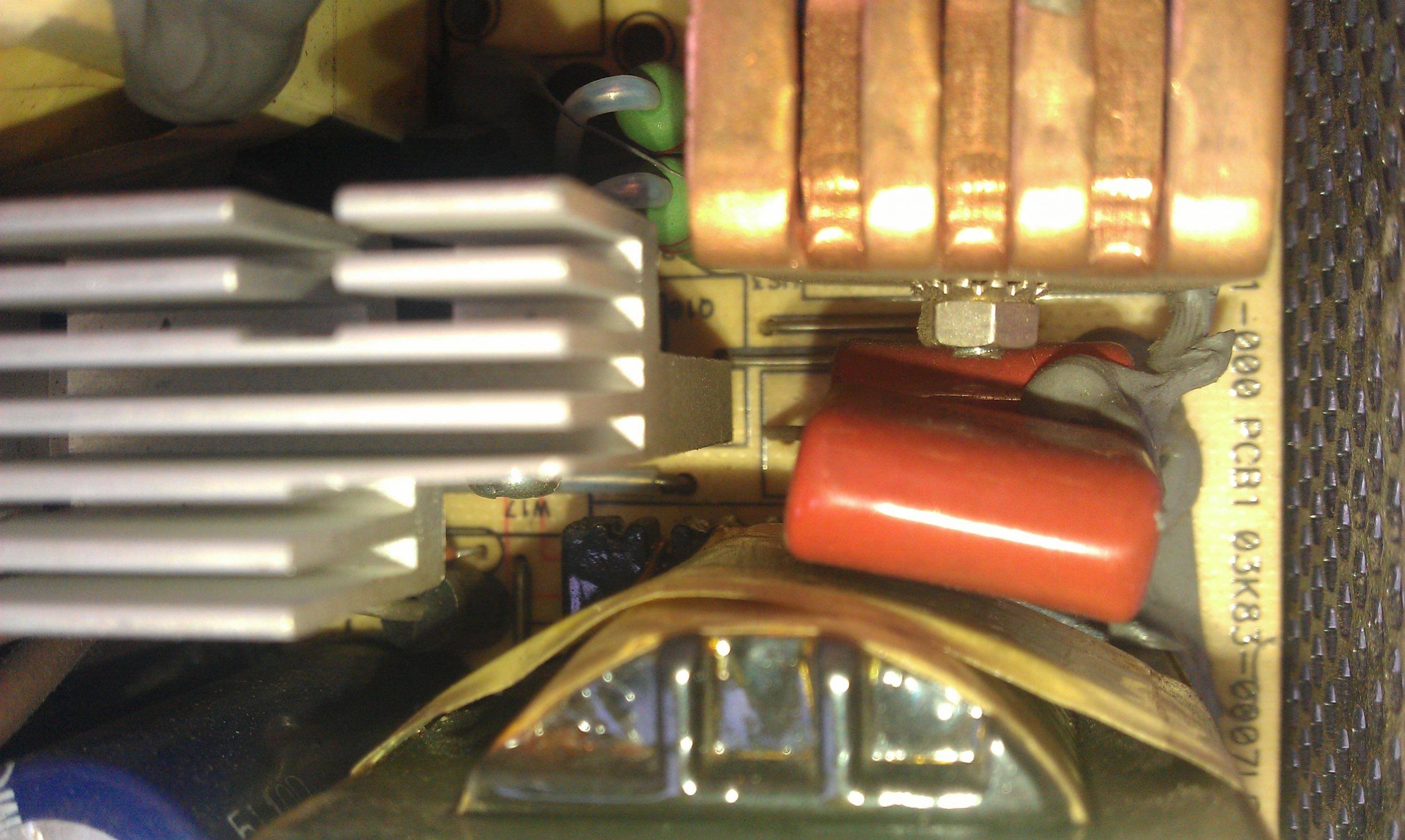

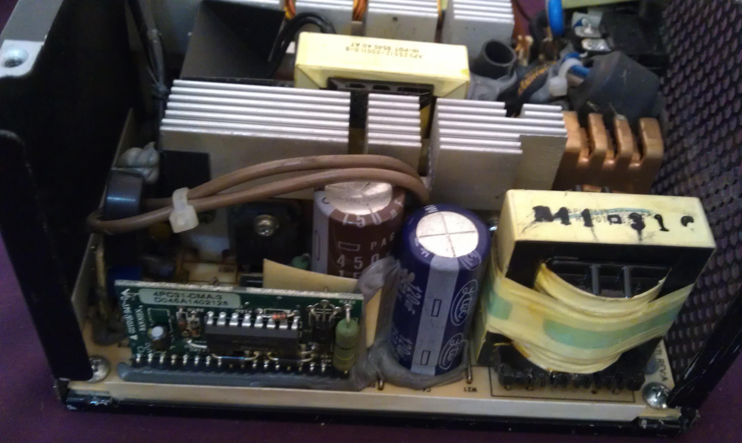

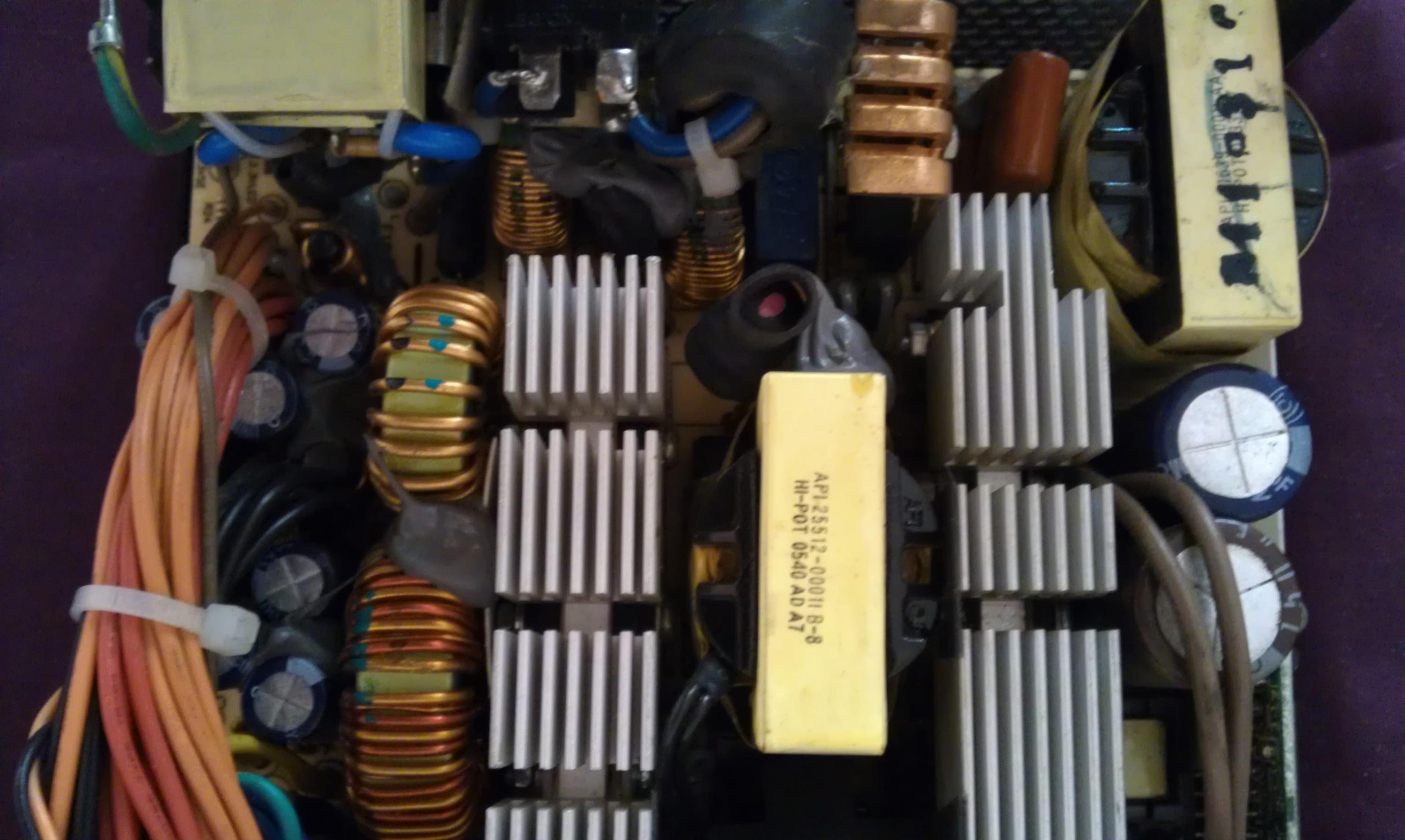

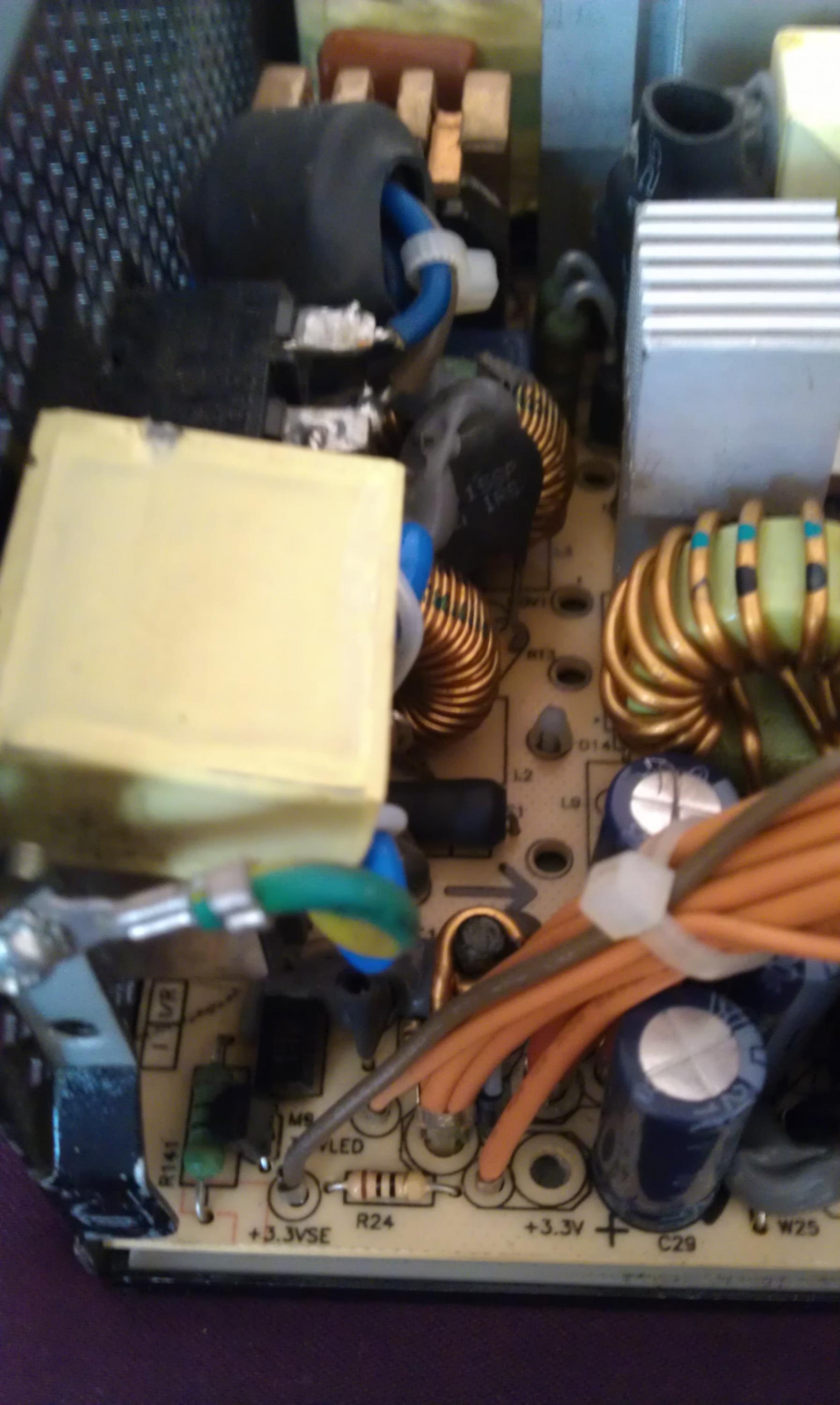

              Encouraged by @STJ, I open the PSU last night for take some shots. I was scared how compact it and I quit at this time to take pictures, although I did not see a bloated capacitor or any unusual discoloration on other pieces.
              But for a proper diagnosis I know that it is necessarily a good set of pictures.
              I tried to take some pictures right now.
                Wellp... no bad caps - at least not bulging ones. Nothing else seems obviously wrong. Perhaps change the really small caps first. Some of them are responsible for filtering power to the various ICs on the PSU, and if they are bad, they can cause the IC(s) to mis-behave.
                Or, if you don't have any of those small caps in stock, then perhaps try changing the output caps first. Ltec is not a very reliable brand... though they do better than CapXon and Teapo most of the time.
                Also, check the solder joints on the bottom of the PSU. Let us know if you find anything suspicious (or perhaps post pictures, if unsure).
                Lastly, what CPU does the DFI board have? I'm pretty sure this PSU should be powerful enough for it, but nonetheless, I am curious. And graphics card?
                  • 30991
                  put your psu tester back on the 24pin cable,
                  and load it up by connecting one of the 4pin cables to a harddrive.
                  see if any of the voltages change.
                  if not - add a second drive.
                  you get the idea.

                    I'll try a visual examination for solder joins with a magnifier. I think a cold joint can be a major issue even for a psu...

                        Ltecs, and little Ltecs are probably conspiring to take the great CoolerMaster down!
                        PG is likely dropping out (ripple or outputs out of tolerance) and those certain boards are forced into reset.
                        PS "testers" are nothing but pretty lights; who needs one when those Ltecs are in plain sight?
                        Ltec= Lousy, Trashy Electrolytic Capacitor
