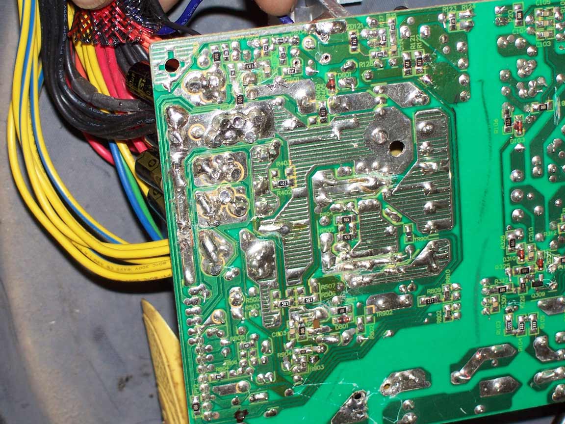

    hoping someone can ID or suggest a replacement for one found in an antec EA-500 psu:
    6 4 7
    6 L 4
    e c b
    It's a TO-92 case, the second line of #'s are spaced more widely. It's in the 5vsb ckt., I busted a lead off trying to remove some of the tan glue from it's legs.

    Re: need replacement transistor
    Google
    It's probably a 2sb647
    e c b is the pinout; emitter, collector, base
      How is the Transistor connected to other components? Good clear pictures of both sides of the board?
          My good camera is down right now, it may be able to take a better pic of the bottom - the emitter was connect to R601 on the bottom of bd., (a surface mount one), the collector was connected to R602, (15 ohms) near the heatsink, right in the area where the purple wire is.
          I removed a 220uf 16v cap, which reads ok in esr and capacity. The transistor tests ok too, both diode junctions only read one way, about 640mV.
            Their solder-wave must have been running cold, that blobby shit would have never made it past me when I did QA.
              It is pretty ugly, rather hard to make out which component's leg is sticking through where -
              I don't think it's been worked on before, I put all the scratches on it trying to get rid of some whitish powdery stuff that was between the traces in several places.
