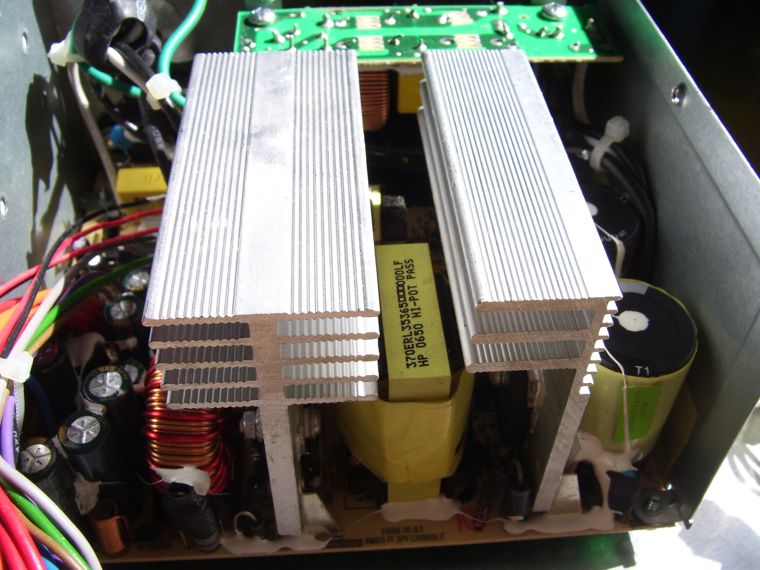

    Only get 2.8V on 5VSB, no green LED, no fan spinning (or twitch).
    Being in storage for about a year.

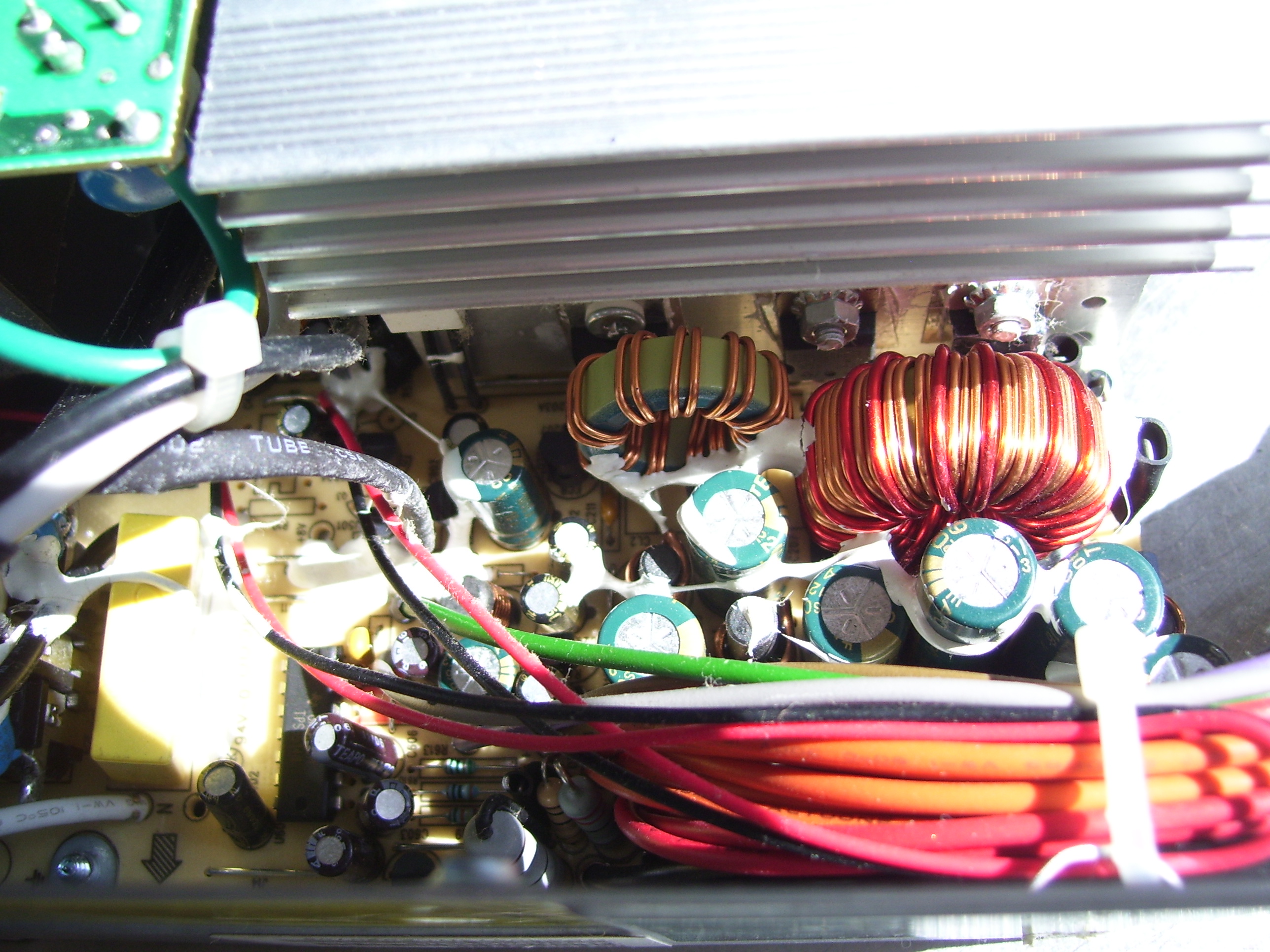

    The vent of larger green cap, to the left to the smaller coil, is slightly bulged.
    Could that be causing it not to start?
    Does this PSU have "start up" cap (whatever that is), and could that be it?

    5vsb output caps need to be checked/replaced.
    5vsb is generated with IC on this psu. Check for shorted/leaky diodes around the 5vsb circuit.

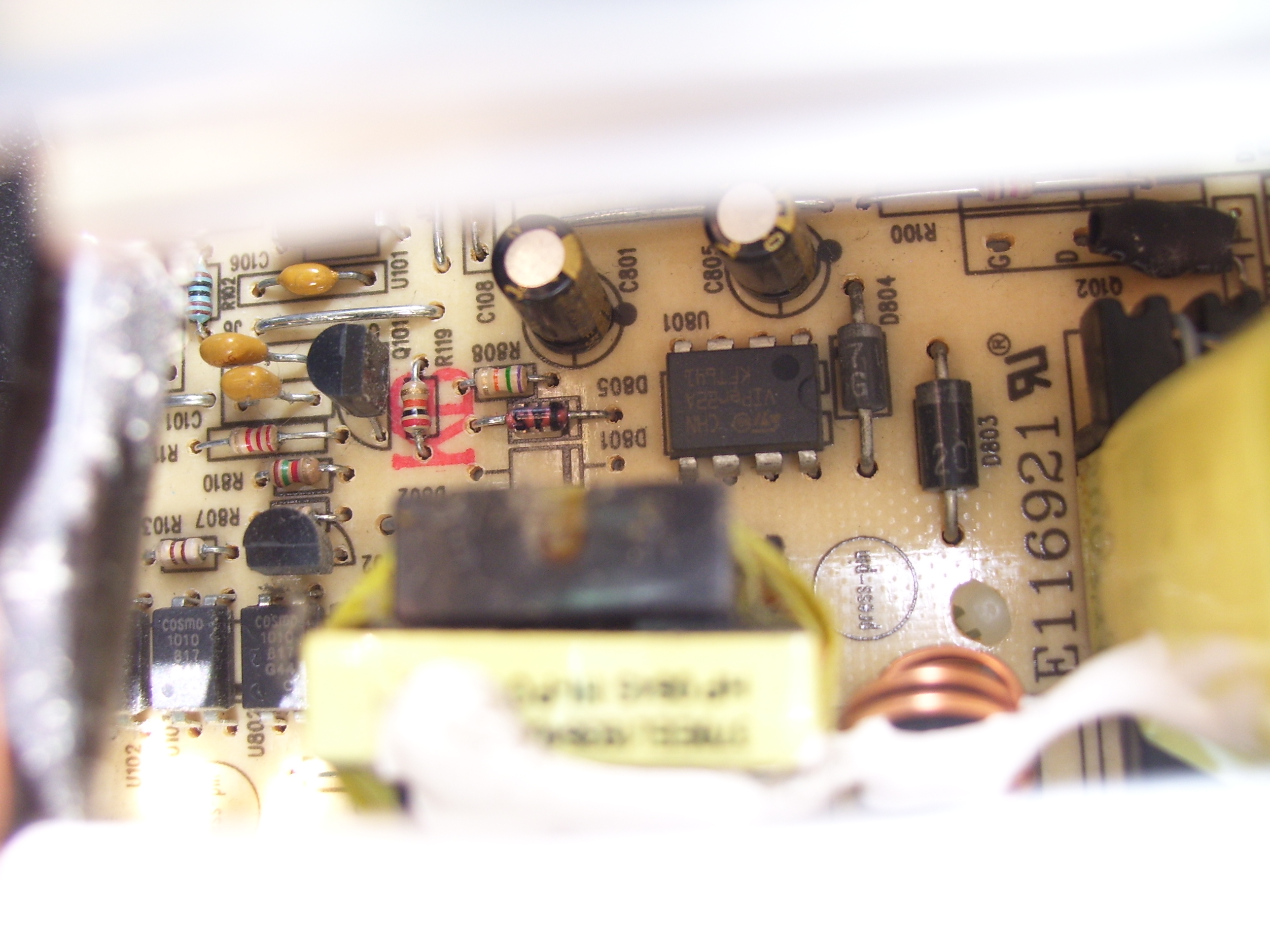

      Actually it did start, other than that you wouldn't have any 2.8v. Something is holding it back. Maybe check the feedback circuit? Last week I had a different PSU doing exact the same thing only to find out it had a bad cap right in the beginning of the feedback circuit on the secondary.

        That cap was a 10v 1000uf teapo SC, and it was bulging from underneath - also
        it meaused 400uf and 2.5 ESR
        Traced the positive terminal through a coil to the 5VSB rail.
        Replaced it with Suscon SD (does that sound good enough?) and works fine now.
        Was the 5VSB voltage feedback going to the input of a control chip, and because the output voltage was too low the chip refused to return a power good signal and liven up the other rails?
